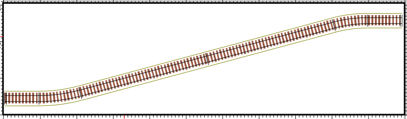

Here's an example showing a CLACK550 module with a fork, with the new 15mm margin. Technically the straight is out of spec as it's 0.1mm short of flush. I'm optimistic it will work in practice as even the CLACK300 module has a longer overhang.

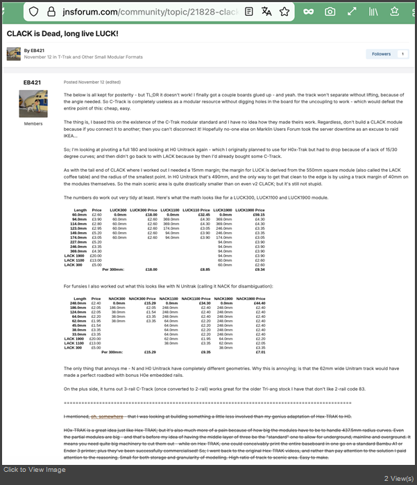

I put glue down! And my genius modular system... doesn't work.
The track connectors don't have enough flex in them to decouple without forcing the track off the boards - and I'm left very confused. I've been assuming this would work based on the existence of the C-TRAK standard which must be able to decouple in order to have existed for - but based on this, I have no idea how it could. What do the MSCD in the Netherlands know, which I don't?
Right now I'm somewhat frustrated, and I'm re-evaluating Unitrack for this; which is 2-rail only and has another annoying compromise on LACK boards (10mm -> 15mm -> 40mm) - but is designed from the start to be modular, and also meets the "readily available worldwide" clause. Mainly - it disconnects the same way it connects, so there's no issue with it pulling the track off the board.
Edit: The obvious question is. "Is anybody else seriously invested in this"?
If not, then just scrapping CLACK in favour of a 2-rail-only Unitrack based design (LUCK) would be the simplest option, and I can re-use all my 3-rail C-Track for playing with Tri-ang stock that doesn't work on TRIX/KATO Code 83.

#57 Posted : 16 December 2025 21:06:11(UTC)
Posts: 9,736
I am no expert on model railway modules, but it looks to me that the two rail guys cut their track where it crosses the edge of a module and electrically connect the tracks by connecting wires under the module. A Dremel would make short work of C-track - I used this approach on Nevw's layout for him many years ago.
Offline EB421
#58 Posted : 16 December 2025 21:47:16(UTC)
EB421
Joined: 10/04/2025(UTC)
Posts: 80
Location: UK
Again, that works - but if you're cutting the track and using traditional module joints - there's no value in C-Track. Just use Peco Code 83 and it'll be cheaper and prettier. Or; K-Track. Prettier; I don't know what K-Track pricing looks like. It also makes using IKEA shelves pointless - if you have to drill into the shelves and add alignment dowels and locking clamps - suddenly this is worse than just building a custom baseboard from laser cut parts!
The point of the idea was that it took no skill or effort, and no complexity to use. You just put it on a table, smoosh it together, and put trains on it.
I am really confused by the C-TRAK system being able to pull this off! Laugh I've emailed them to find out their secrets.
So far, no-one's claimed to be invested... can I take this as "EB421 is the only person who went out and bought shelves"? ;)
thanks 1 user liked this useful post by EB421
