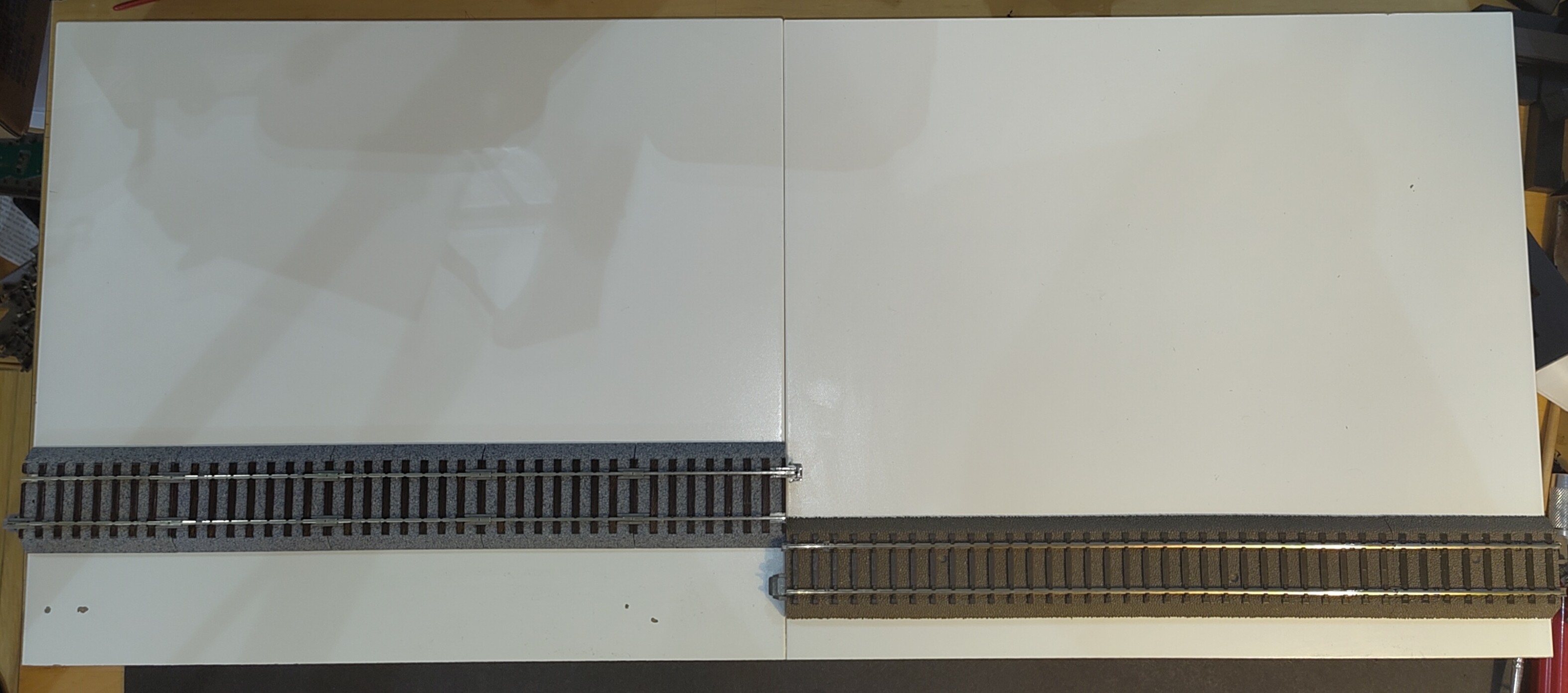

I put glue down! And my genius modular system... doesn't work.
The track connectors don't have enough flex in them to decouple without forcing the track off the boards - and I'm left very confused. I've been assuming this would work based on the existence of the C-TRAK standard which must be able to decouple in order to have existed for - but based on this, I have no idea how it could. What do the MSCD in the Netherlands know, which I don't?
Right now I'm somewhat frustrated, and I'm re-evaluating Unitrack for this; which is 2-rail only and has another annoying compromise on LACK boards (10mm -> 15mm -> 40mm) - but is designed from the start to be modular, and also meets the "readily available worldwide" clause. Mainly - it disconnects the same way it connects, so there's no issue with it pulling the track off the board.
Edit: The obvious question is. "Is anybody else seriously invested in this"?
If not, then just scrapping CLACK in favour of a 2-rail-only Unitrack based design (LUCK) would be the simplest option, and I can re-use all my 3-rail C-Track for playing with Tri-ang stock that doesn't work on TRIX/KATO Code 83.

Offline EB421
#56 Posted : 16 December 2025 20:52:57(UTC)
EB421

Source: "101 Track Plans for Model Railroaders" by Linn H. Westcott
Sadly doesn't solve the problem, as now disconnecting the short-piece pulls the track up; instead of disconnecting the next board.
thanks 1 user liked this useful post by EB421
#57 Posted : 16 December 2025 21:06:11(UTC)
Posts: 9,746
I am no expert on model railway modules, but it looks to me that the two rail guys cut their track where it crosses the edge of a module and electrically connect the tracks by connecting wires under the module. A Dremel would make short work of C-track - I used this approach on Nevw's layout for him many years ago.
Offline EB421
#58 Posted : 16 December 2025 21:47:16(UTC)
EB421

Location: UK

Offline EB421
#60 Posted : 16 December 2025 23:28:25(UTC)
EB421

I obviously ordered a few bits of cheap Unitrack on eBay to make sure my loco's would run on it - and here's what the boards look like - LUCK on the left and 2-rail CLACK on the right.
Two IKEA LACK 300mm baseboards, one with KATO UniTrack spaced 42mm from the edge and one with TRIX C-Track spaced 15mm from the edge.
Losing a chunk of contiguous scenic area is sad, but gaining enough space on the far side for a platform and low-relief station building might offset that effectively. Flexitrack can easily be used on larger boards to create a bigger diorama area anyway. Rail code is the same between TRIX and KATO, with the same outcome - my Tri-ang 3F won't run on it, but my other stock will.
And one side benefit, Unitram and OO9 Unitrack don't have complete sets for LUCK, but N gauge Unitrack does (i.e. matching the H0 track length to the mm!) and the joiners can be removed for mixing modules - so it should be possible to create a version of the standard that is multigauge, with a few caveats. Plus - the N gauge parts will mix with the other two (and flexitrack) so there's easy ways round that.
So; I think replacing CLACK with MLACK and LUCK suits me fine. Even if y'all find the magic fix for C-Track, since you're all three rail all your losing from the system is my pass-through dioramas and I just bought my first static grass applicator today - which; tells you about my skill level haha
thanks 2 users liked this useful post by EB421
