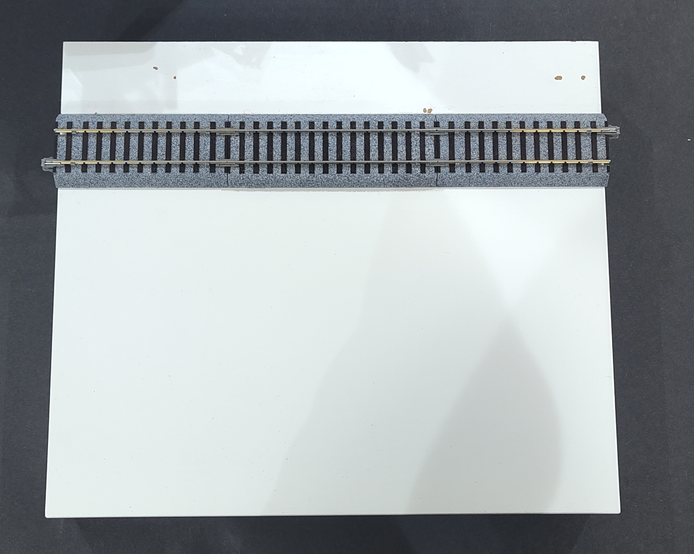

I put glue down! And my genius modular system... doesn't work.
The track connectors don't have enough flex in them to decouple without forcing the track off the boards - and I'm left very confused. I've been assuming this would work based on the existence of the C-TRAK standard which must be able to decouple in order to have existed for - but based on this, I have no idea how it could. What do the MSCD in the Netherlands know, which I don't?
Right now I'm somewhat frustrated, and I'm re-evaluating Unitrack for this; which is 2-rail only and has another annoying compromise on LACK boards (10mm -> 15mm -> 40mm) - but is designed from the start to be modular, and also meets the "readily available worldwide" clause. Mainly - it disconnects the same way it connects, so there's no issue with it pulling the track off the board.
Edit: The obvious question is. "Is anybody else seriously invested in this"?
If not, then just scrapping CLACK in favour of a 2-rail-only Unitrack based design (LUCK) would be the simplest option, and I can re-use all my 3-rail C-Track for playing with Tri-ang stock that doesn't work on TRIX/KATO Code 83.

#55 Posted : 16 December 2025 19:37:07(UTC)
Posts: 6,059
Call me old-fashioned, but I would heed this 1956 advice regarding track connection.
Source: "101 Track Plans for Model Railroaders" by Linn H. Westcott
Offline EB421
#56 Posted : 16 December 2025 20:52:57(UTC)
EB421
Joined: 10/04/2025(UTC)
Posts: 93
Location: UK
Sadly doesn't solve the problem, as now disconnecting the short-piece pulls the track up; instead of disconnecting the next board.

#57 Posted : 16 December 2025 21:06:11(UTC)
Posts: 9,748
I am no expert on model railway modules, but it looks to me that the two rail guys cut their track where it crosses the edge of a module and electrically connect the tracks by connecting wires under the module. A Dremel would make short work of C-track - I used this approach on Nevw's layout for him many years ago.
Offline EB421
#58 Posted : 16 December 2025 21:47:16(UTC)
EB421
Posts: 93
Location: UK
Again, that works - but if you're cutting the track and using traditional module joints - there's no value in C-Track. Just use Peco Code 83 and it'll be cheaper and prettier. Or; K-Track. Prettier; I don't know what K-Track pricing looks like. It also makes using IKEA shelves pointless - if you have to drill into the shelves and add alignment dowels and locking clamps - suddenly this is worse than just building a custom baseboard from laser cut parts!
The point of the idea was that it took no skill or effort, and no complexity to use. You just put it on a table, smoosh it together, and put trains on it.
I am really confused by the C-TRAK system being able to pull this off! Laugh I've emailed them to find out their secrets.
So far, no-one's claimed to be invested... can I take this as "EB421 is the only person who went out and bought shelves"? ;)
thanks 1 user liked this useful post by EB421

#98 Posted : 02 January 2026 03:36:26(UTC)
EB421
Posts: 93
Location: UK
From Team Two Track, I have found glue that works (slow tack superglue gel, who could have seen that coming), track that works (geometry has been pretty thoroughly tested now for Unitrack H0) and my printed spacers work. So (ignoring the nicks in the finish from removing the C-Track and the awful spray-glue I tried to attach it with...):
The first LUCK module - a bare LUCK300 with track but no scenery.
This is what a LUCK module looks like!
thanks 2 users liked this useful post by EB421
