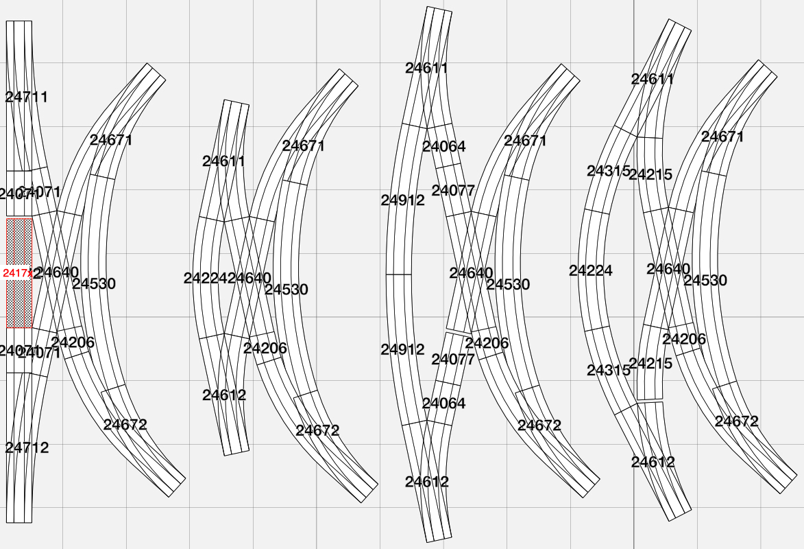

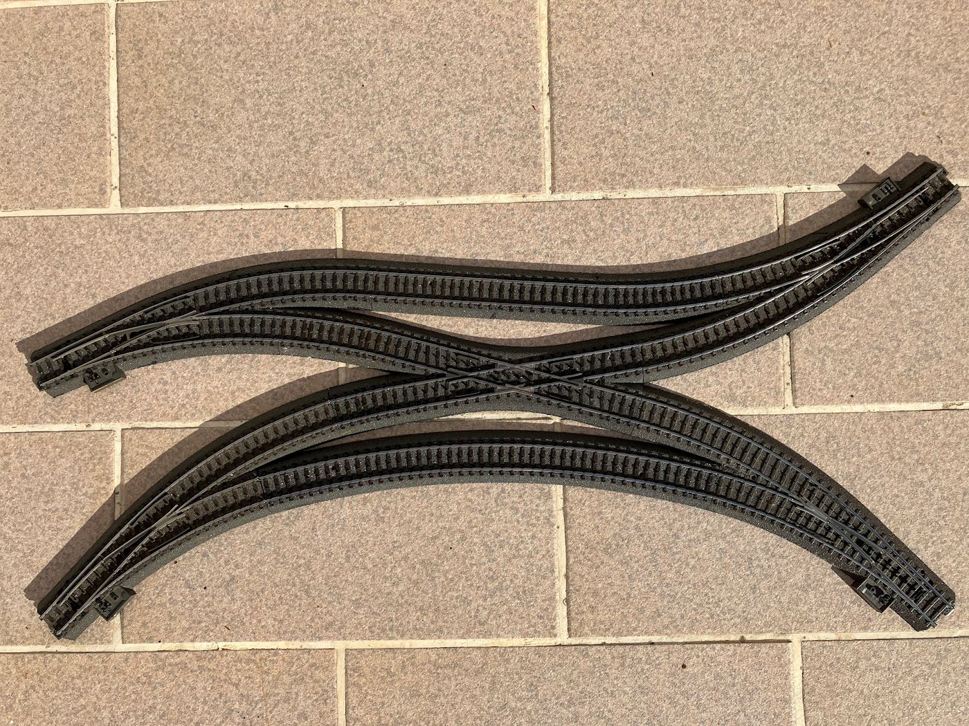

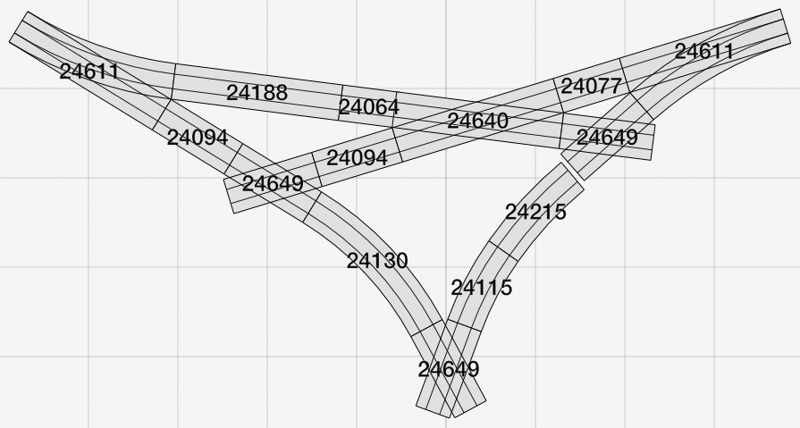

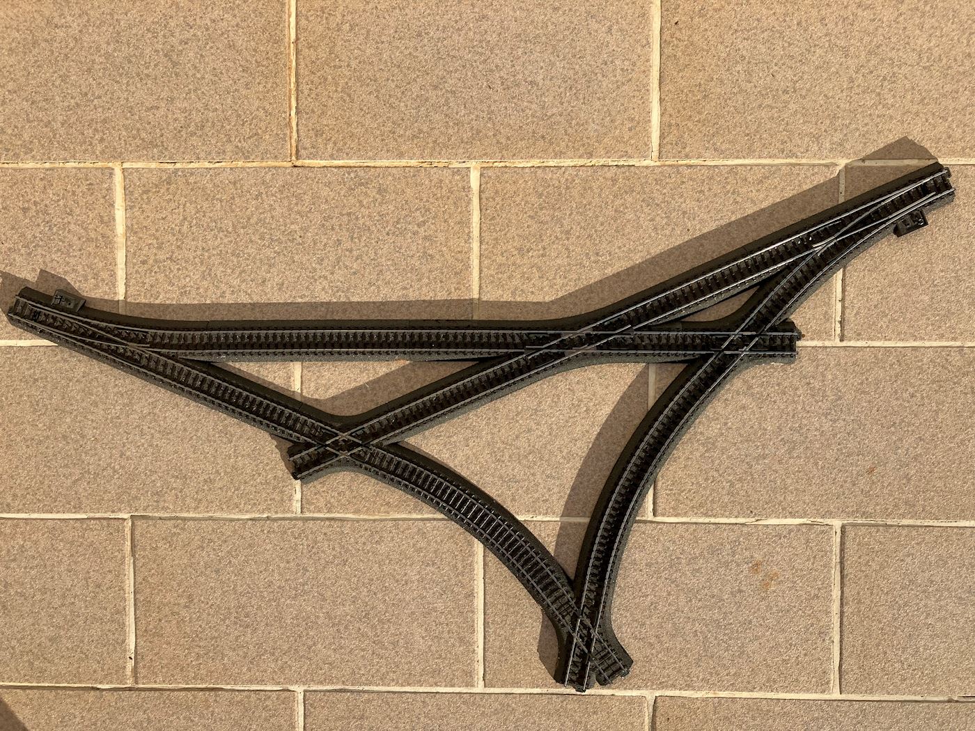

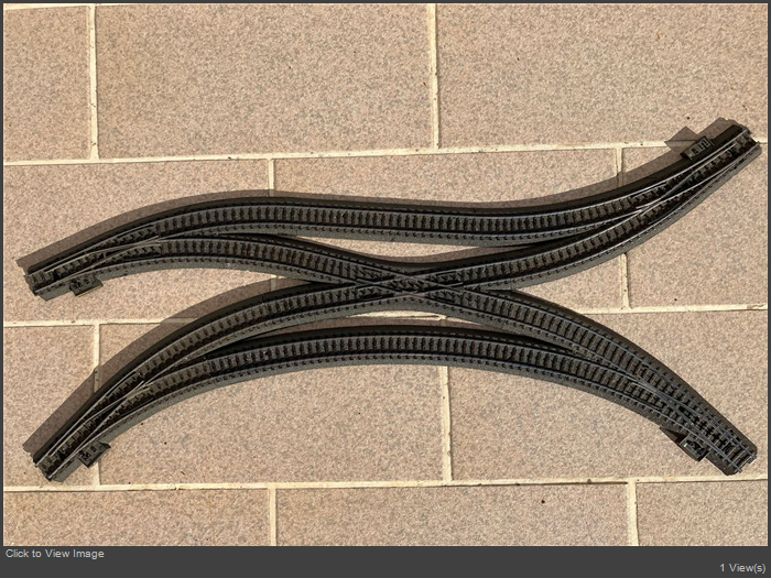

#354 Posted : 20 January 2024 15:00:48(UTC)
Posts: 6,070

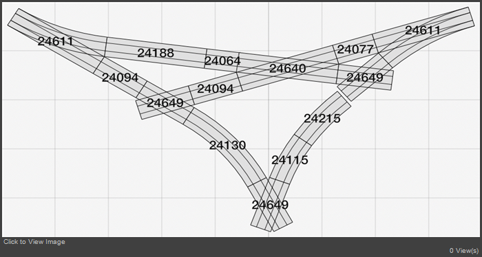

Special Hosenträger variations
See post #320 for red track "2417x"

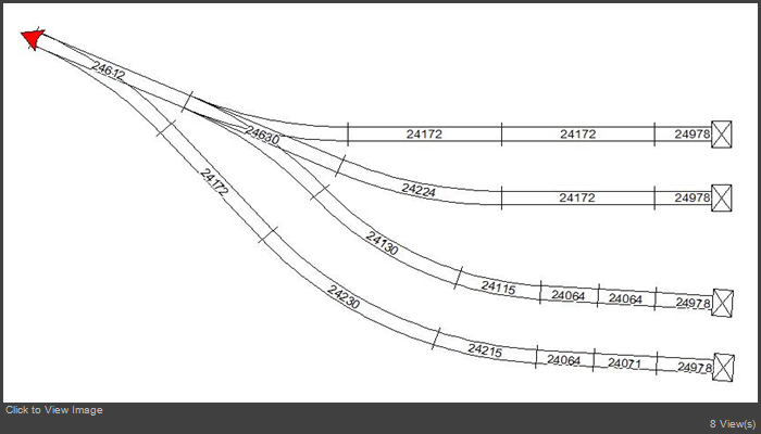

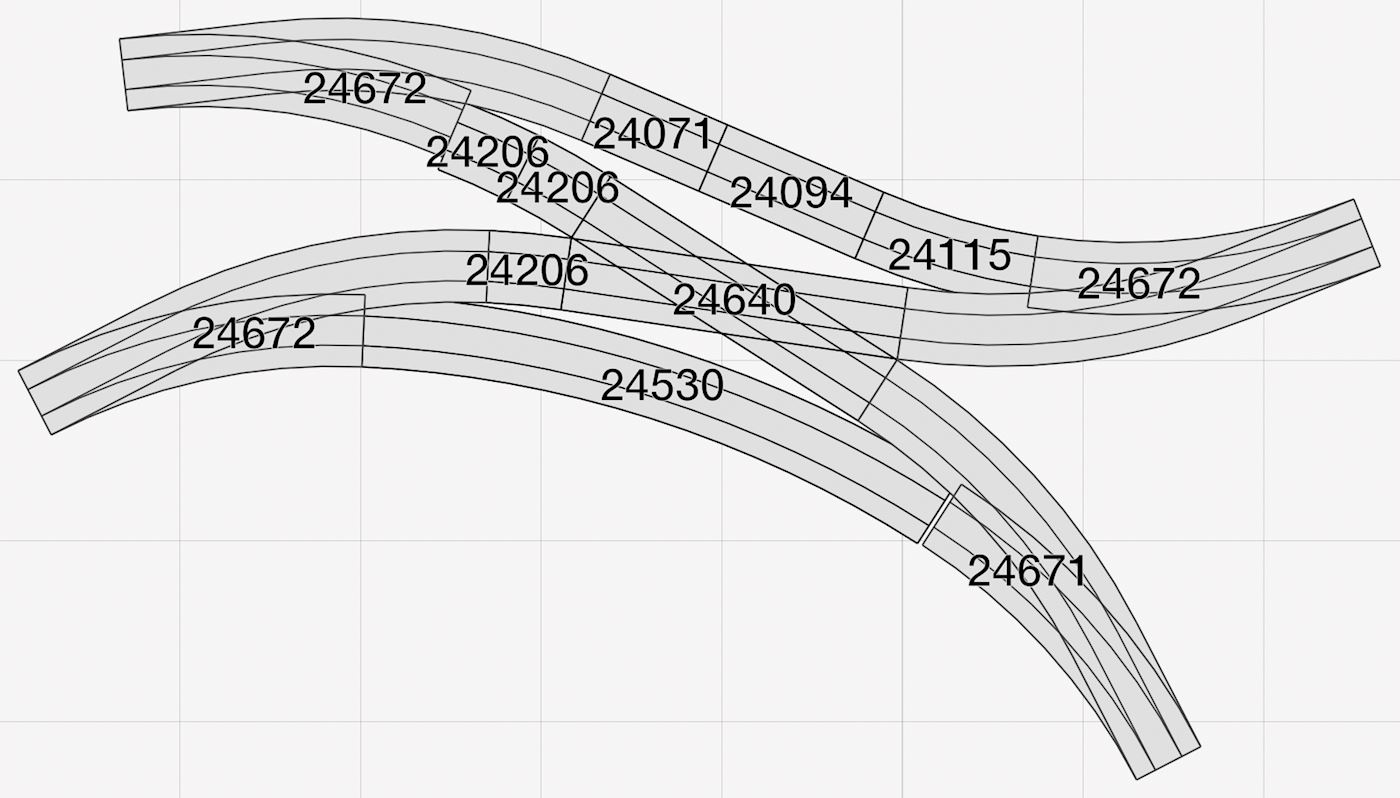

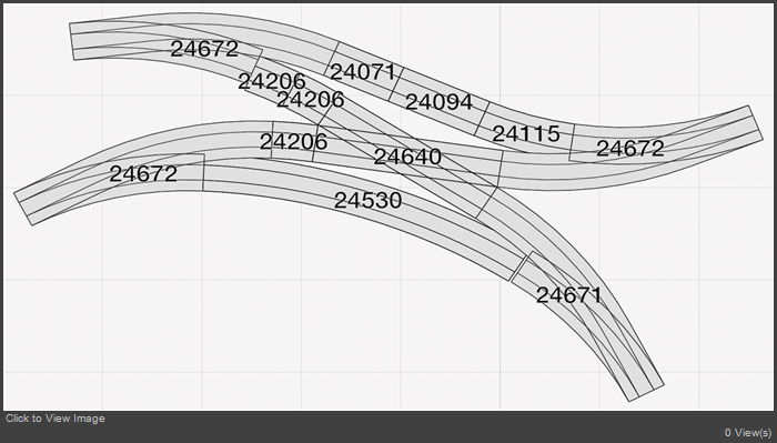

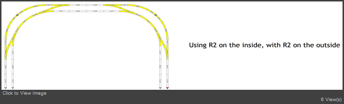

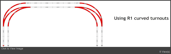

#356 Posted : 29 February 2024 02:31:01(UTC)
Posts: 6,824

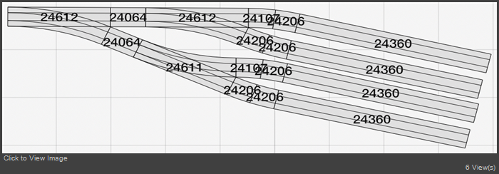

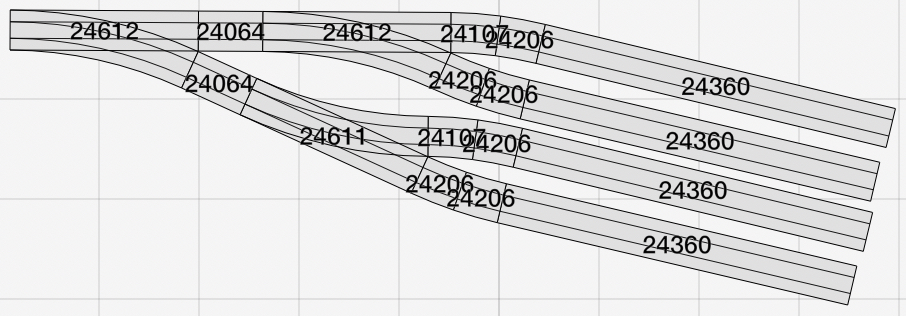

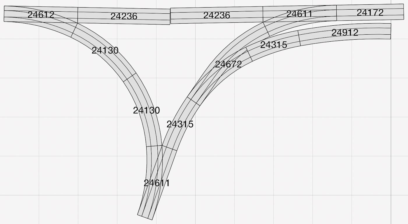

4 short sidings with alternatives -
Some ideas borrowed from this topic Sidings geometry.
Posted by Alex H
Next two images posted by PacoM

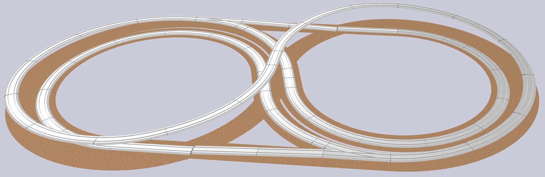

#357 Posted : 01 November 2024 00:06:06(UTC)
Posts: 6,070
Mental game on 110x190 cm.
#358 Posted : 01 November 2024 00:17:21(UTC)
Posts: 8,704
Now try the exercise of interlocking all those diamond crossings ... Blink
#359 Posted : 01 November 2024 00:24:01(UTC)
Posts: 6,070
... and on 94x174 cm.
3.5% incline & defused S-curves.
Offline rbw993
#360 Posted : 01 November 2024 02:36:46(UTC)
rbw993
Joined: 19/08/2008(UTC)
Posts: 1,099
I think you bypassed the exercise request.
#361 Posted : 01 November 2024 14:21:27(UTC)
Posts: 6,070
There, it works perfectly with one train at a time.RollEyes

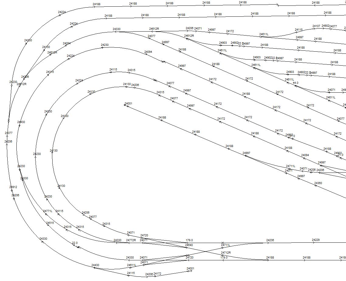

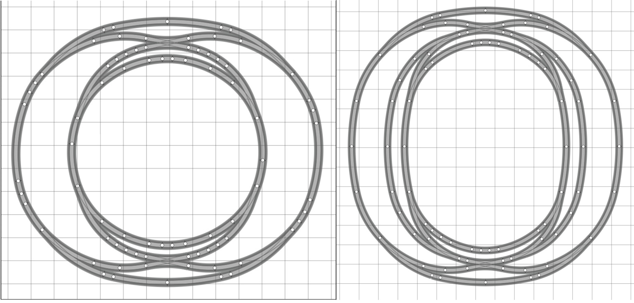

It’s the smallest single line, single level folded dog-bone.
Current layout:
The former project:
thanks 4 users liked this useful post by LeoArietis

Maybe these have been posted before?
loop
Current layout:
The former project:
thanks 5 users liked this useful post by LeoArietis

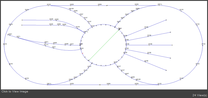

Offline LeoArietis
#364 Posted : 31 January 2025 16:47:23(UTC)
LeoArietis
Joined: 07/02/2008(UTC)
Posts: 215
Location: Lindome, Sweden

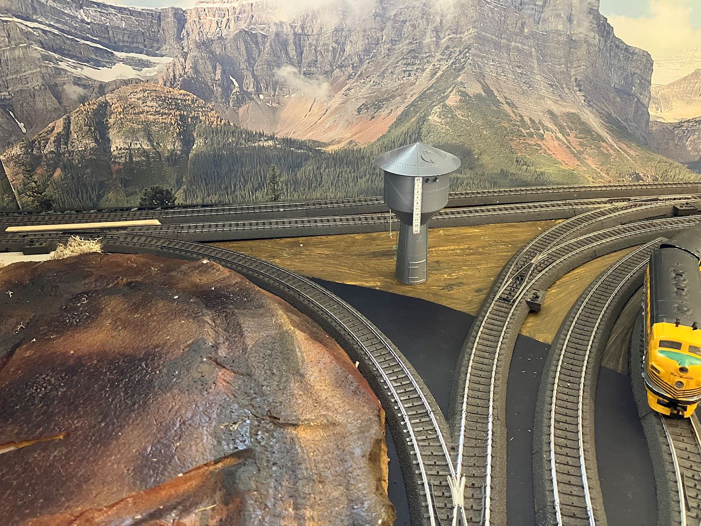

The most forgotten track piece is 24001.
End your stub track short.
tiny-layout
Marklin 24001
Bumper signal
Current layout:
The former project:

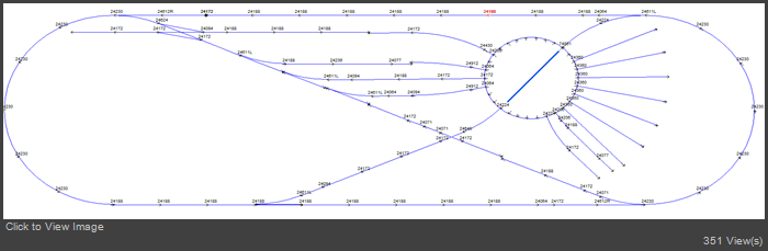

#365 Posted : 20 February 2025 16:16:52(UTC)
LeoArietis
Posts: 215
Roundhouse pretzel
When the bridge is in the right position you can use it as a loop for turning the direction of a train.
Current layout:
The former project:
thanks 6 users liked this useful post by LeoArietis
Offline dave55uk
#366 Posted : 21 February 2025 12:26:14(UTC)
dave55uk
Joined: 15/09/2023(UTC)
Posts: 148
Location: Ely, England
Think that would only work in one direction - running anti-clockwise to clockwise.
Because if you were running a train clockwise, to reverse the direction of it,
you would use the diagonal (top left-bottom right) to reverse the direction.
And then, after that, if you used the turntable as suggested, you'd be back to running clockwise again.
thanks 1 user liked this useful post by dave55uk

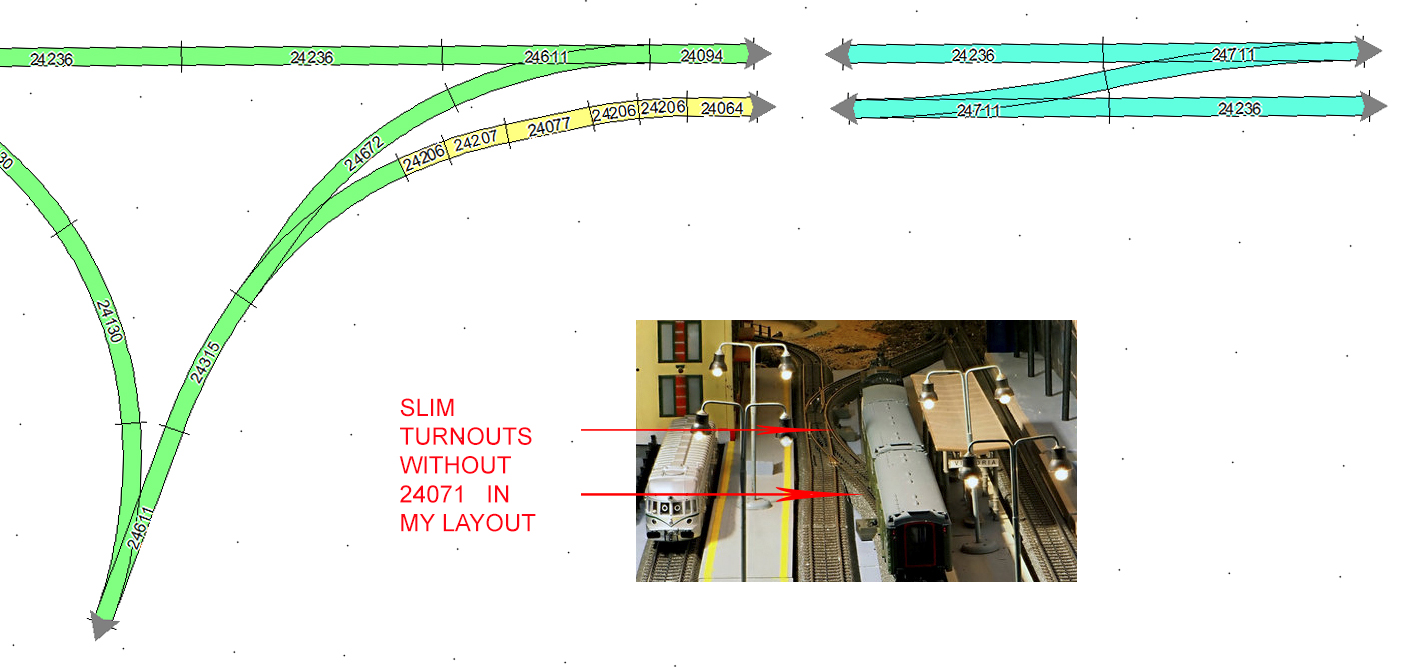

[...] How to squeeze four tracks of equal length on a 22 cm shelf with a 40 cm long throat. The double slip turnout on the right side can bet replaced by a simple 24611/2 turnout.ablaufberg2kondensiert.png
Same, same, but different.

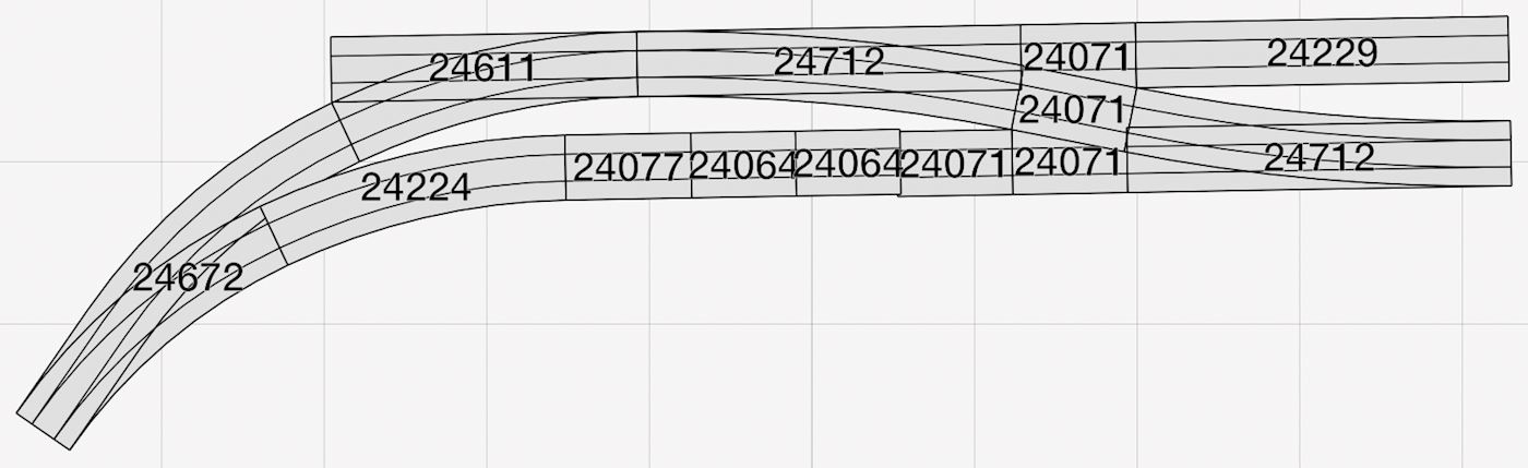

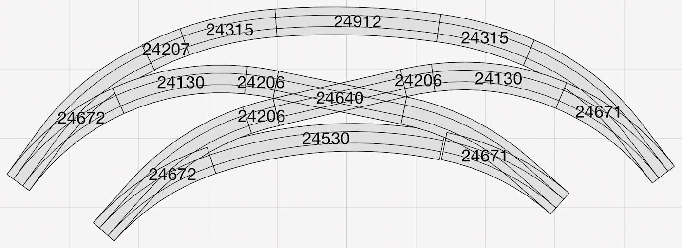

I miss examples with the now available and earlier missing piece 24720 in this thread.
Current layout:
The former project:
thanks 1 user liked this useful post by LeoArietis

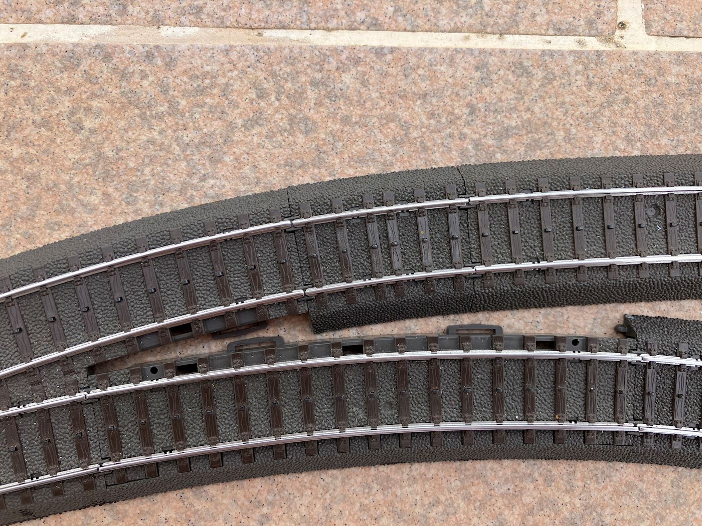

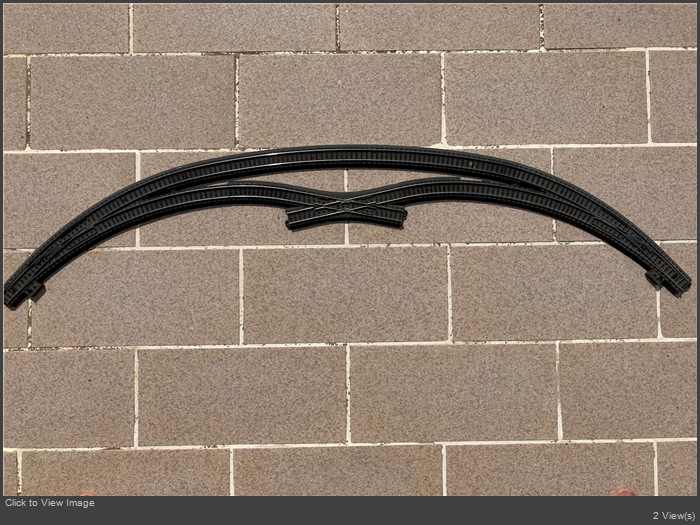

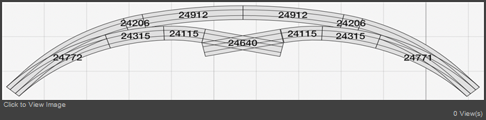

#369 Posted : 09 July 2025 19:00:14(UTC)
Posts: 6,070

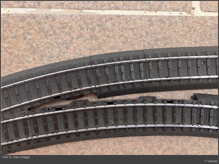

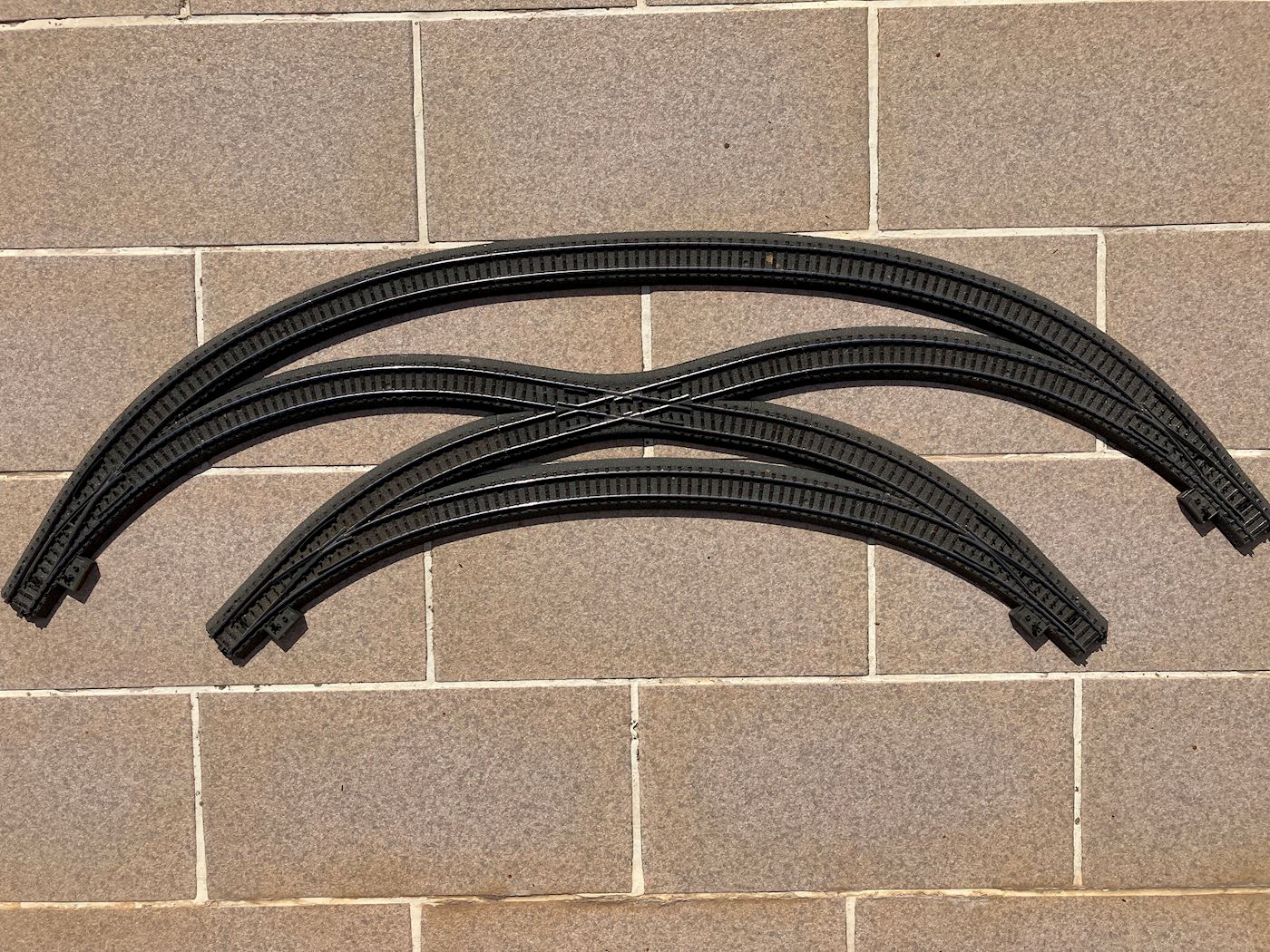

3x internet discoveries
(1) Embedded in a track plan:
https://files.homepagemo...5277/686e96b0/6b3bf4.png
(2) Frankenstein approach with a saw:
https://files.homepagemo...b40/686e97dc/a691ce.jpeg
https://files.homepagemo...ca8/686ea13c/dd4e85.jpeg
(3) Hosenträger requiring homemade straight 24176 segments (see my post #320 about 24176: https://www.marklin-user...d-innovations#post654885)
https://files.homepagemo...6eb/686f64f0/925605.jpeg
P.S., source: https://www.stummiforum....leis-Revolution-101.html
Edited by user 10 July 2025 11:27:26(UTC)  | Reason: Not specified

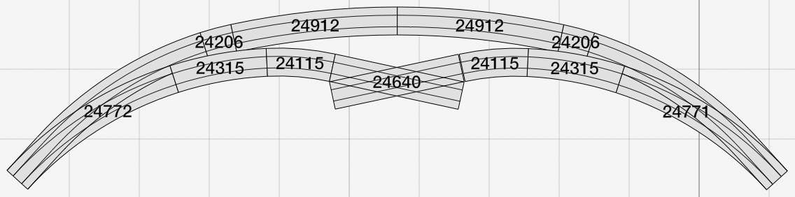

#370 Posted : 09 July 2025 20:34:28(UTC)
Posts: 3,663
https://files.homepagemo...bd8/686ea268/577152.jpeg
Click doesnt work on any of the links; "Link is only valid for a limited time", and all give a "502 Bad Gateway error".

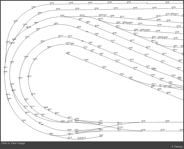

Offline LeoArietis
#380 Posted : 11 July 2025 11:34:06(UTC)
LeoArietis
Posts: 215
Alsterstreek, thanks for the search-tip! Smile, that thread in Stummi are long enough for a few rainy days! Guess it will have to shift focus now to some other track-piece and my vote would be a 3-way R9 switch and a semi-sort of flexible track and 24903 and 24906 and a short straight like around 33-36 mm.
My example:
Not special at all, a few cut to length and constructed tracks like 24515, 24903, 24906 and with the centerpiece Hosen-Träger with cut 24179, 24640.
Shows the southern part of my station entrance. Work in progress for the last 14 years and finally with the slim double crossout 24720 that saves space and one slim curved turnout and three straight slim turnouts, so that's a pretty neat investment.
Current layout:
The former project:

#383 Posted : 26 July 2025 14:38:47(UTC)
Posts: 6,070
Another Hosentraeger
#384 Posted : 26 July 2025 14:40:25(UTC)
Posts: 6,070
Compact wye
Offline dickinsonj
#385 Posted : 26 July 2025 16:25:42(UTC)
Joined: 05/12/2008(UTC)
Posts: 1,883
Location: Crozet, Virginia
Love that compact wye! That would fit into a lot of spaces.
Offline PacoM
#386 Posted : 28 July 2025 17:39:57(UTC)
PacoM
Joined: 20/08/2020(UTC)
Posts: 69
I have not been up to date with this thread for some time. I am glad to find it well alive. Thanks for that display of ingenuity.
While trying to adapt the last compact “wye” to my track plan, I have met two issues:
Firstly, the right side did not provide completely parallel tracks: after the 24672 (30º for both branches), the outer curve is 24,3º (24611) and the inner one 15º (24315) + 12,1º (24912) = 27,1º.
Secondly, the resulting space between both tracks did not comply with “MY STANDARD” measure (49,5 mm, see posts 212-217; 64,3 mm is Märklin standard by adding 24071 pieces to slim turnouts).
So that, playing with the nearly miraculous C-track pieces, I found this adaptation: Green, the original; Blue, MY STANDARD; and Yellow, the new part adapted to MY STANDARD.
thanks 3 users liked this useful post by PacoM
#387 Posted : 28 July 2025 18:30:44(UTC)
Posts: 6,070
It is true that the 24315+24912 combination meets the requirements for my Wild West depot, while a 24224 would be suitable for achieving a standard track spacing with 24071.
#388 Posted : 27 August 2025 19:53:28(UTC)
Posts: 6,070
Unearthed in another post - honorable mention #1 - “basic research” from 2014 by forum member Yisus.
#389 Posted : 27 August 2025 19:55:03(UTC)
Posts: 6,070
Honorable mention #2 - developed in parallel post for forum member km90 - “compact double-track track station throat with R3 curved turnout”
Successful reality check (24640 served as a substitute for 24620...):

Hosenträger cont'd:
Caution: Connecting the R5 piece (24530) is fiddly.
#391 Posted : 29 August 2025 20:10:01(UTC)
Posts: 6,070

The 24640 could be replaced by a 74620 etc.
#392 Posted : 05 September 2025 14:13:07(UTC)
Posts: 6,070
Eight years ago, I unsuccessfully attempted to create a curved Hosenträger without straight track sections, but only now did I come up with the solution.

#398 Posted : 10 September 2025 12:01:32(UTC)
Posts: 6,070
Also the angles do not add up.
And still it works, I’ll provide photographic evidence lateron.
The photographic evidence I announced above.
#399 Posted : 10 September 2025 12:18:50(UTC)
Posts: 6,070
A forensic analysis of Peter Clapcott's track plans reveals that the Hosenträger C track combination is intended to be as follows.
As suspected, his idea is to get rid of removable C track sidebeds to makle ends meet.

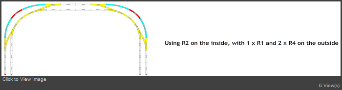

Offline Johnvr
#400 Posted : 08 October 2025 22:57:08(UTC)
Johnvr
Joined: 03/10/2010(UTC)
Posts: 1,307
Hello all
I have been mulling over some ideas for making curves for the layout, linking inside and outside loops.
It came about because I was wondering whether we could eliminate using R1 curves on the layout.
Now those R1 Curved turnouts are very handy if you have limited space. I use them on my own layout.
But let's for a moment try to achieve something useful if we eliminate the R1 curves, and stick to R2 and larger curves.

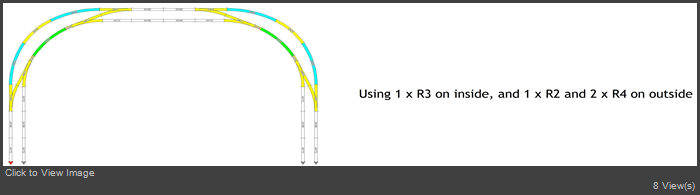

I have produced some drawings of how this could be achieved.
So, the inside loop consists mainly R2 curves, that is our base case.
I have also been keeping the 77.4 mm spacing on all sides.

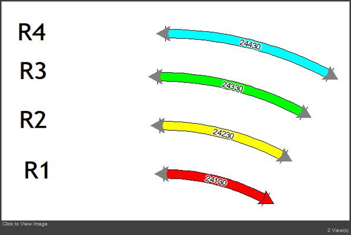

Here is the colour coding which I have used in the diagrams.
And here are the diagrams which I have constructed
So there are several configurations which you can choose from, they all seem to work well.
thanks 7 users liked this useful post by Johnvr
