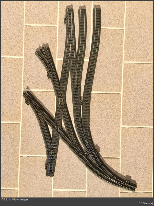

Testing the Limits:
24640, 2x 2471x, 6x 24071, 2x 24077, 2x 24206, 2x 24107, 2x 2461x, 24130 & 24115.

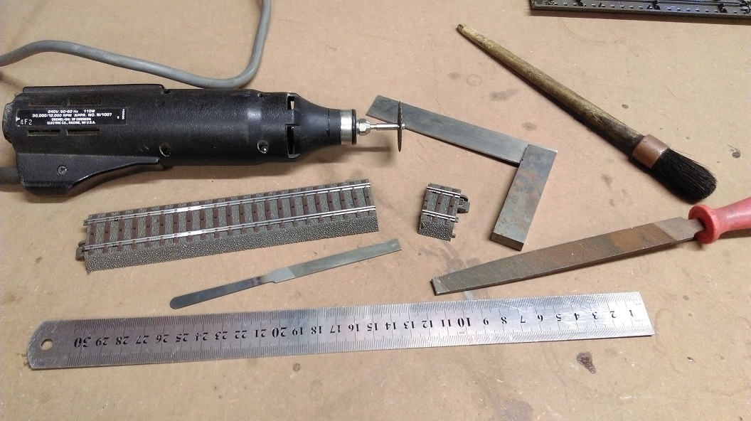

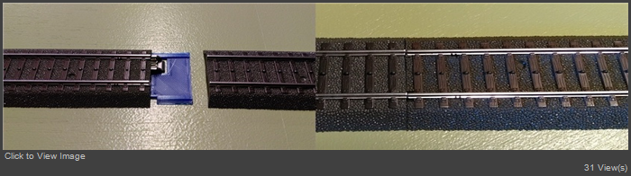

As a beginner I occasionally find myself stuck for all those short C track pieces needed for a layout. My supplier has them posted almost immediately but it can still be a few days before they arrive and then even more days before I get a chance to use them.
This is what I do when I’m stuck and impatient. I can have the track I need in an hour or so and custom lengths are easy too. My apologies to the experts who’ve seen it all before.
In this case a 24188, 24094 and 24071 were needed to make 353.3mm as shown. This can be cut from two the 24188s shown down below. Try to avoid cutting at the webs which can be in the way in the joining process – juggle the pieces used to avoid this if you can.
Cut the plastic tabs off one end of the track that will stay full length. Use a sharp knife to remove them and a small file to smooth the area. This will join with the cut end of the other track.
Cut the track to be shortened. I usually leave 0.5 mm extra and trim back from there to allow for any little slips while cutting. A small saw or cutting wheel works well – but don’t melt the plastic. For the final product to look good the end must then be made straight and square.
It is also possible to mill the end of C track if you have the equipment and go slowly!

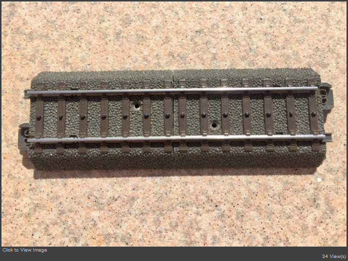

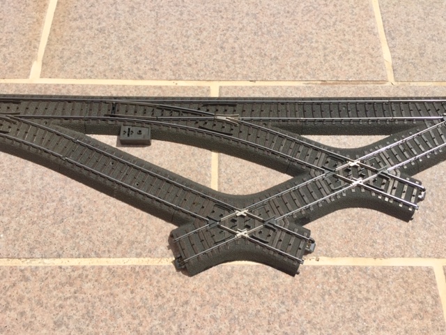

Align the pieces on a level surface with a thin straight edge against the rails as a guide. Connect the two pieces electrically and, with them firmly weighted in the correct place, join them with 5 minute Araldite (which really takes over 20 minutes to set). Be careful not to mound up the Araldite to the point where the track will not sit flat when turned over. I’m going to try that UV instant setting glue to try to speed things up next time.
There is possibility that some Araldite might leak through the gap between the two rails if they haven’t been finished flat and square. In this case just use a tiny bit of Araldite to pre-seal the gap and allow it to firm up before doing the bulk application.

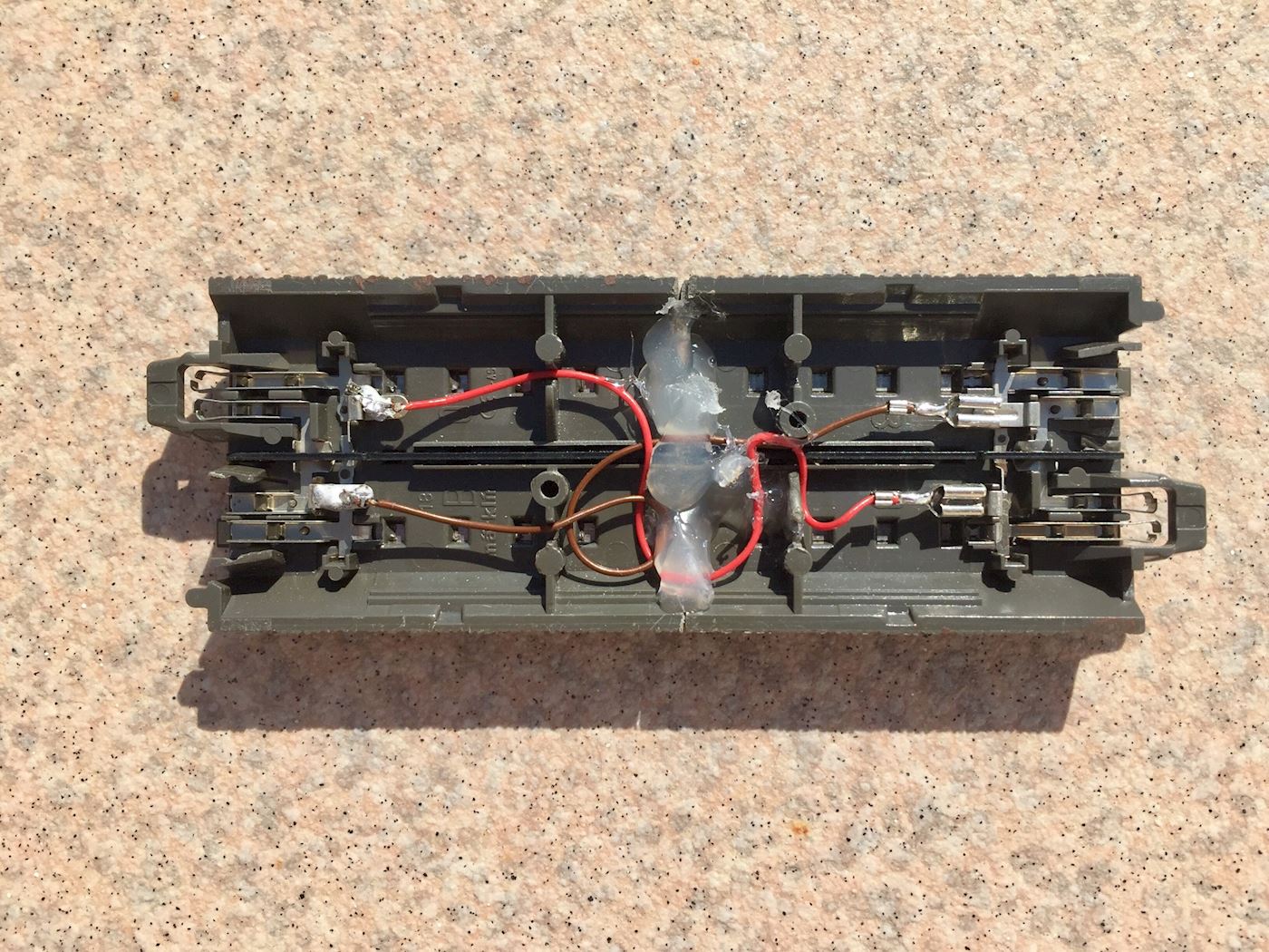

Check the finished item. Make sure it all sits flat, trim any excess Araldite. Minor leakage of Araldite can sometimes be hidden by using a grey felt pen. This is what you get – the top one is with stock pieces, the bottom one is the creation.
thanks 4 users liked this useful post by revmox

Testing the Limits:
Testing the limits of C-track bendiness! Beautiful and useful. Here's what I think you did - rotated 45 degrees just because the part numbers are more legible on the plan this way around...

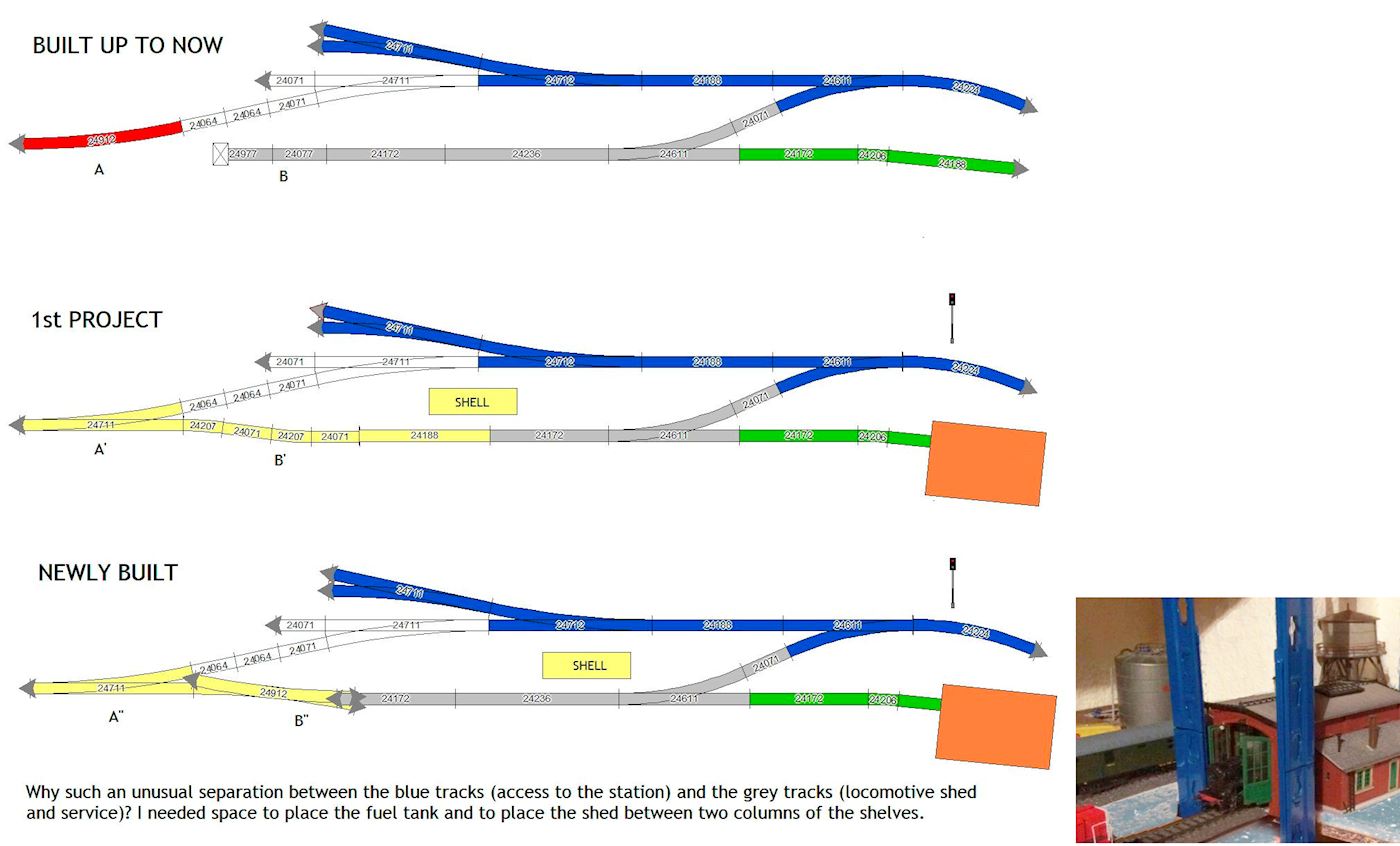

I can't work out why they have used R1 curves to come off an R2 point. I guess it makes the tracks slightly closer together, but I haven't tried to workout just how much difference it would make.

I guess the reason is, the smaller the radius, the shorter the length.
If you compare with post 216, where I use 24711/12 + 24912, the length there is 471.6, but only 282.5 in revmox/Alsterstreek solution, a difference of 189.1mm, similar to a 24188 track. That means longer space for trains in each end. My distance between track centers is though slightly smaller, 49.5 instead of 51.7.
As long as you are satisfied with the way trains look in the S curve, perfect.

Originally Posted by: revmox Go to Quoted Post
18.33 degrees is of interest because the cut misses the sleepers
It also has the advantage that there is enough rail left to use a rail joiner without interfering with the frog when fitting the next piece of track.
But it has the disadvantage that there are no 18.33 degree curve segments around.
As my boss used to say "I'll get the Black & Decker out" BigGrin
There’s also no 18.33 degree points. If you’re crazy enough to go around hacking a perfectly good point to pieces then slaughtering a curve shouldn’t be a worry.
I kind of wonder if it is somehow just plain wrong to be mangling Marklin stuff this way. I’ll bet there are purists out there who would be horrified and would like to see us banned.
Leviticus 18:28, AMPC
“Whoever commits any of these abominations shall be cut off from among his people.” BigGrin Confused

Testing the Limits:
That is FACINATING!!!!!

#288 Posted : 09 September 2021 17:25:23(UTC)
Posts: 6,070
If you want this (lower left straight gap between turnout and diamond crossing to filled by customised track segment)...
you have to do that:
The resulting C track segment counts 14 sleepers (versus the standard 24094 with 13 sleepers). 24094 would have been too short and 2x 24064 too long.
The flip side.
(Never mind the inverted cable colour code.)

#291 Posted : 27 October 2021 14:38:56(UTC)
PacoM
Joined: 20/08/2020(UTC)
Posts: 69
Trying to get the most out of my small locomotive deposit and thinking a bit further, how could I fit another parallel track in the narrow space available upto the border of the shelf? A slim turnout and a radius 2 12º curve could solve the problem. Two 24206 pieces (5,7 + 5,7º=11,4º) nearly equal the 12,1º of the 24712 turnout. Instead, I have cut by the middle a 24224 piece (24,3º) to achieve a more precise (and cheap) result, gluing later with Araldite. If you take care while cutting straight with a Dremel or similar instrument, the union is practically invisible. In order to reduce distance between tracks centres to just 43 mm and make it possible for me to place that additional track, the new turnout is followed, at its right double end, by a half 24077 piece each. It has been a success.
In the following images, I show the result with the Scarm programme, as well as the layout with commercial pieces of track.
Edited by user 28 October 2021 13:36:45(UTC)  | Reason: Correction of distance: 43mm, not 48
thanks 4 users liked this useful post by PacoM
#292 Posted : 27 October 2021 21:45:44(UTC)
Posts: 6,819
Originally Posted by: PacoM Go to Quoted Post
...... the lower design showed that, if I only bought the turnout, the 24912 curve before in its place (red in the upper scheme) could be cut in two and glued to form a soft "S". ..... Regards
Hi Paco,
Thank you for your explicit diagrams and examples.
Apart from introducing concrete-sleepered C track, Märklin would do us all a great service by introducing a half 24912, ie. a 24906.
That would save us a lot of trouble, and allow us to complete curves and transitions with a whole 90º.
Actually 2 x 24903 would be better - allowing us to complete whole 45º and transitions where the remaining curves are the standard 15º range.
Still ... we could always halve the 24906 I suppose.
It seems from your diagram that a half 24224 might also be useful, ie. a 24212, although that equals 2 x 24206.
hvc
