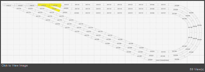

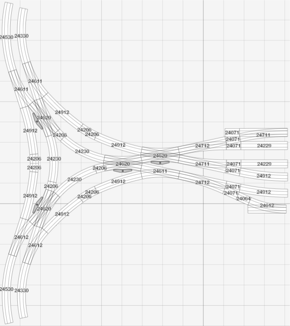

Well here are my current station throat designs. Allows for a uni-directional platform track from each direction, a bi-directional platform track, bi-directional passing track and a bi-directional freight track.
The only issue is on the left side throat there is a 24912 wide curve coming off a wide radius curved point (instead of 24315) but it was the best option there as the alternatives looked terrible. Otherwise all OK.
I am not convinced with the right side station throat with that curved point, it doesn't look terrible but not great either.
The 24611 track and the 24330 will lead to some freight sidings, as that last track (5) is the bi-directional freight track, you can see a pocket off the left side for the changeover.
thanks 4 users liked this useful post by applor

Right side with R9 switches instead of the curved switch, definitely a better look.

Just one suggestion- not better or worse, but you could save a bit of space (and make the station longer) with this...
I have abused the curved turnout geometry somewhat, but it works in practice.
- H

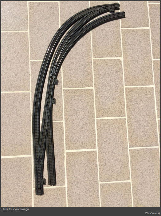

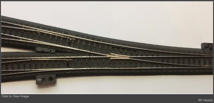

I have just joined this forum. Since I have read concerns about the lack of a three-way slim switch and the space needed to solve the problem, someone may be interested in how I have suceeded to pass from one to four tracks in just the double length of a switch.
Of course some "surgery" and cutting of the side plastic is needed. I was afraid of spoiling something when I tried, but it is really easy to achieve using just a Dremel or similar device.
I show a picture of the result, so that I am ready to explain the procedure at request.SlimSwitch.jpg

Yes it's well known you can omit the 24071 intermediate track piece to shorten the turnout distances but it involves cutting the roadbed.
Thanks for sharing your picture.
If you look at some earlier posts you can see an example of cutting the 3-way switch to also shorten the turnout distance.

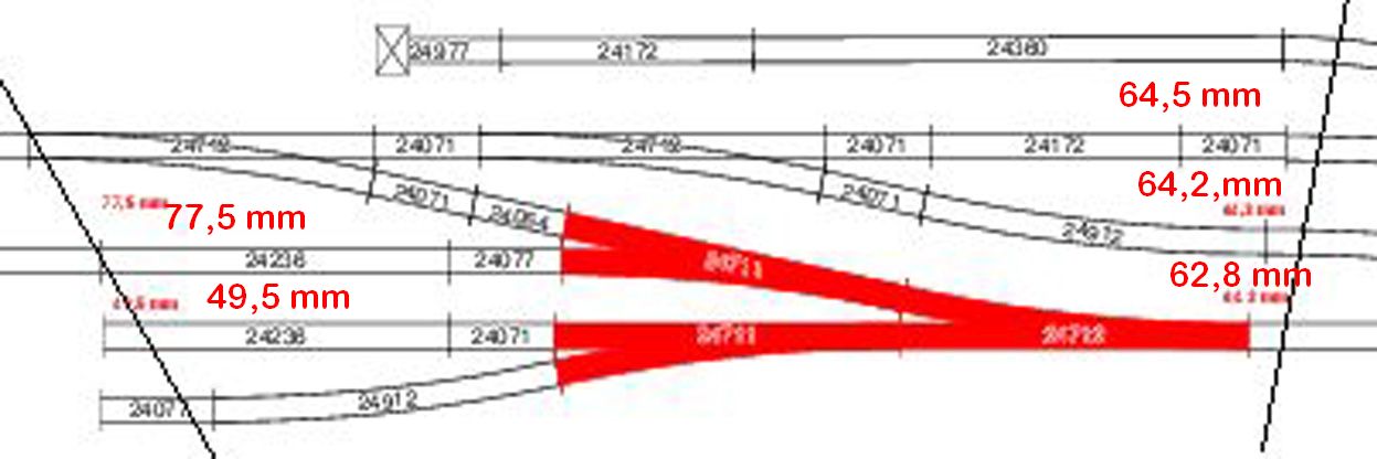

Thank you for answering, applor. I have read a number of posts here indeed, and learnt a lot from them.
The solutions I have seen (e.g. posts 101, 114, 115, 117, 119) are really useful and original, but they imply either “major surgery” (not just biting an angle of the roadbed externally but cutting through a stretch both of plastic and metal pieces and later gluing and soldering) or using tracks in R2 (as the 24630, 24206/7), or both, giving up with the charm of slim switches and their wide radius.
I find some advantages in my suggestion:
1. Four instead of three outputs.
2. Saving one switch engine, since one lever moves two switches at a time, as can be seen in the image below. This particularity, as well as not using a number of short tracks, saves money too.
3. Distance between track centres is 49,5 mm, practically true scale.
I have just modestly tried to contribute with another feasible idea.
thanks 7 users liked this useful post by PacoM

Now, I would like to show how these switches (in red in the image) may be used in an end or passing station.
The upper layout has been actually built and is inspired (a bit simplified the right part) in the end station in service in my town until 2018.
The lower one intends to show the suitable track combinations, and track separations that may be achieved with them. New straight tracks may be added where vertical lines have been drawn, so as to reach the intended length.
Regards. PacoM

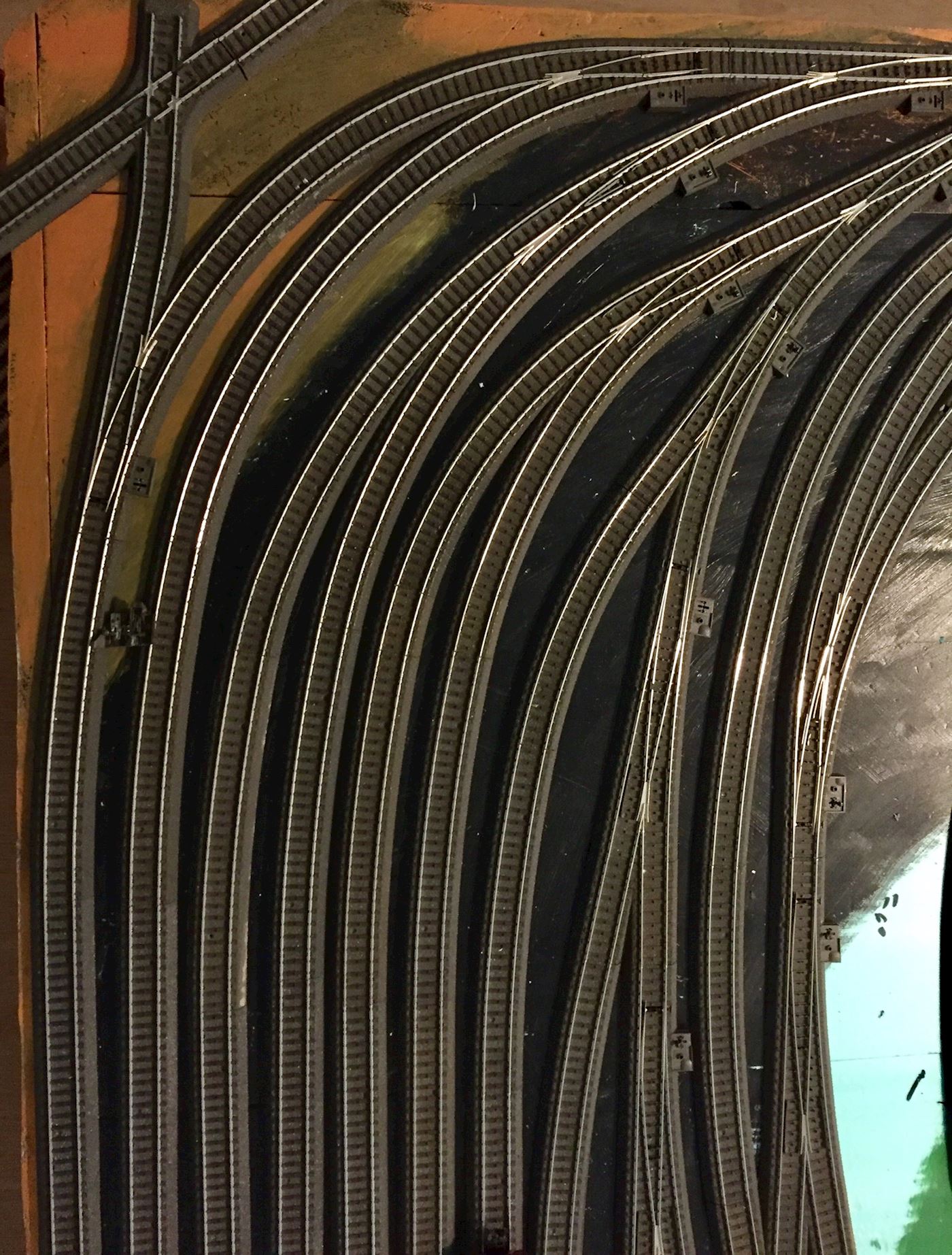

If you are not bored yet, this is another example of matching tracks. Direct through tracks are coloured in yellowStation Sllim - 2.jpg

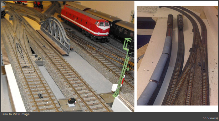

Yet another possibility for a "Y" or "triangle", inspired by Alsterstreek (and partly copied from him)Triangle.jpg
thanks 4 users liked this useful post by PacoM

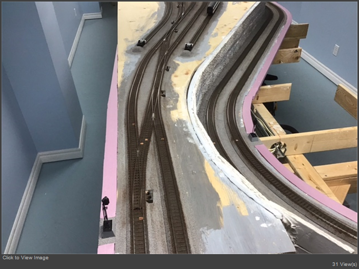

#230 Posted : 27 February 2021 13:53:19(UTC)

Defused S-curve double cross-overs:
Recipe: 2x 2467x , 2x 2471x, 2x 24912, 4x 24071, 4x 24206 & 2x 24330.
#235 Posted : 24 April 2021 21:49:45(UTC)
Posts: 3,662
This looks redundant...¿?
#236 Posted : 24 April 2021 22:19:32(UTC)
Posts: 2,323
Two ways to get from the left hand to the right hand track. Zero ways to get from the right hand to the left hand track. What does it do?
#237 Posted : 24 April 2021 22:30:33(UTC)
Posts: 8,703
That was my reaction too ...
I think the fix is to swap the left hand set of points.
#238 Posted : 25 April 2021 00:16:01(UTC)
Posts: 6,070
You think double track mainline, I think shunting puzzle (and geometry tricks). This is the „conceptual“ C track (and not a track plan) topic, after all.
;o)
Wow... tough crowd! (I still thought it was pretty).
How about:
Edited by user 25 April 2021 08:17:35(UTC)  | Reason: Not specified
- Herman
thanks 11 users liked this useful post by hvc
#240 Posted : 25 April 2021 08:57:51(UTC)
Posts: 6,070
Hurray, finally a Hosenträger with (a) a slim crossing and (b) without using a saw. Well done !

For people seeking to know the meaning of double track life: half of my post # 234 experiment with a couple of curved turnouts to swing back and forth from one track to the other.
2471x, 3x 2467x, 1x 24912, 1x 24315, 2x 24230, 1x 24207, 2x 24306 & 1x 24107 (in reverse numerical order).

Posts: 6,819
Hi AK,
The switches (turnouts) between multiple tracks have real-life application on some (most?) of the Class 1 railroads in North America.
One of the classics I know something about (Norfolk and Western Railway) routinely had passing trackage using double track switching to three tracks and after a few (3? 4? 5? 10?) miles switching back to double track.
It allowed faster trains to overtake slower trains without one having to stop.
Due to advance Centralised Traffic Control (even back in steam days), the centre track was used for trains travelling in either direction.
I am unable to find a photo on the internet although I do have some in books.
This track arrangement is quite easy to do in C track with slim turnouts.
Of course what we really need is some 6° super-slim turnouts ;-)
In the absence of that, there are a few ways to make a wonky/bendy Hosenträger with slim crossing - none are exactly what you would want...
- Herman
- Herman
thanks 5 users liked this useful post by hvc

I am looking for a solution to close these gaps, otherwise a plan for a super elegant finish to my question.
I would like to have a triple staging yard served from a single line of entry.
Happy to use R1, R2, R3, but don't rule out R4 curves either.
AK, I am hoping that you will read this and provide some innovative ideas !
RegardsBigGrin
thanks 1 user liked this useful post by Johnvr
Here's a standard geometry way to do it... given that it's a staging yard I have just used standard tracks with nothing fancy - I've changed the arrangement of the turnouts so that the inner track is closer in length to the other two (highlighted in yellow)...
Do you have a size limit?
- Herman
- Herman
thanks 6 users liked this useful post by hvc
