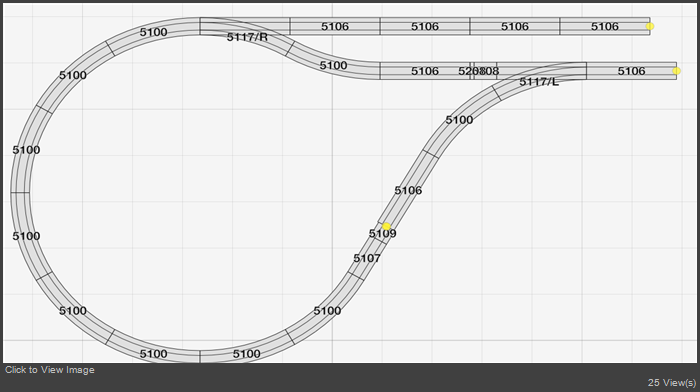

Hi guys I'm trying to put together a list of track I need for my new layout I am building. One part of this layout is a reverse loop. I have a track plan software that has marklin C track in it but for the life of me I can't get the loop to line up and connect. I want the loop to use a 24611 switch, other then that I do not care. Can anyone help me out by giving me a track plan of a reverse loop with this switch. After that I can expand it to suit my needs.
Thanks and sorry to bother you guys with something so simple but I have spent way to much time trying to figure this out.

Does this meet your requirements?
I'm not that familiar with C track as I use K track.
Gavin
Gavin
I think so it appears that all those parts are available in C-track. Thank you so much!

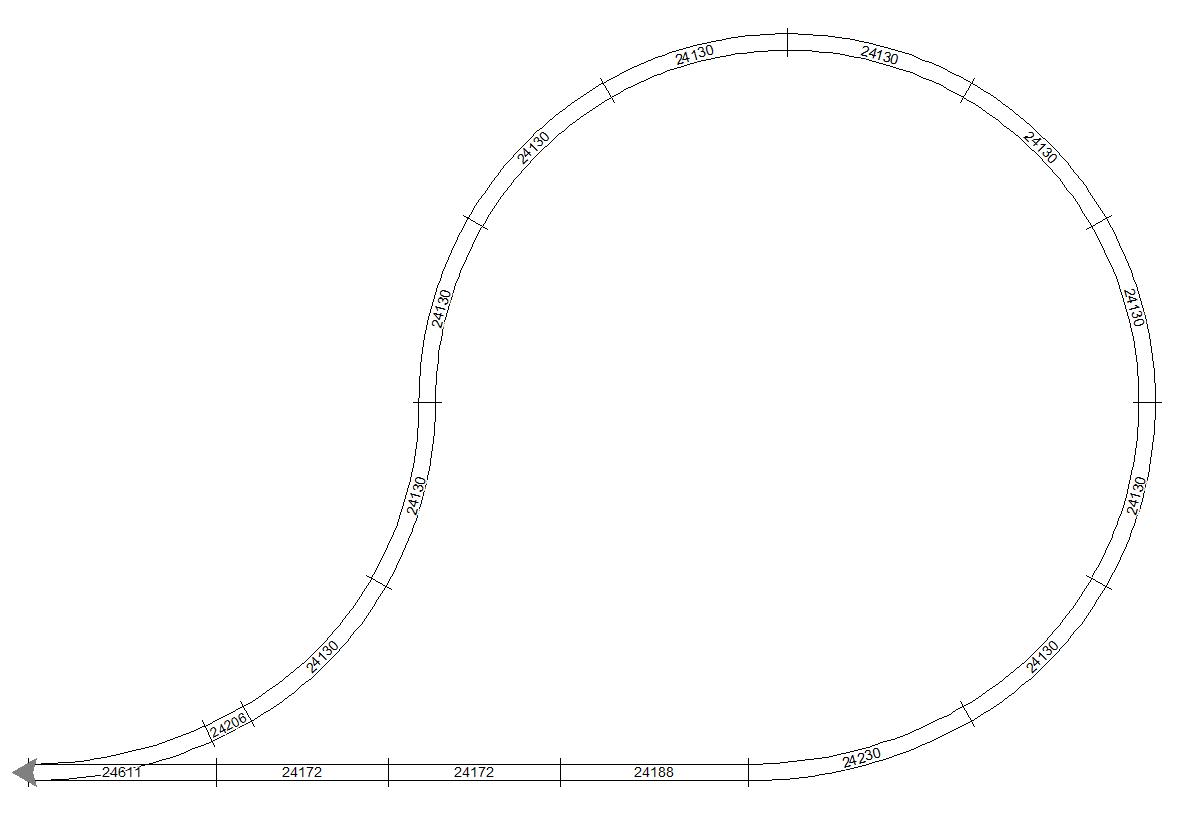

#4 Posted : 31 December 2013 09:37:08(UTC)
Posts: 15,591
S shaped double curves with 24130 are the most difficult combination for rolling stock - not even all Märklin rolling stock can handle that.
Here's a reversing loop with some straight tracks in between.
Ok I will modify my reverse loops for that design then. Thank you

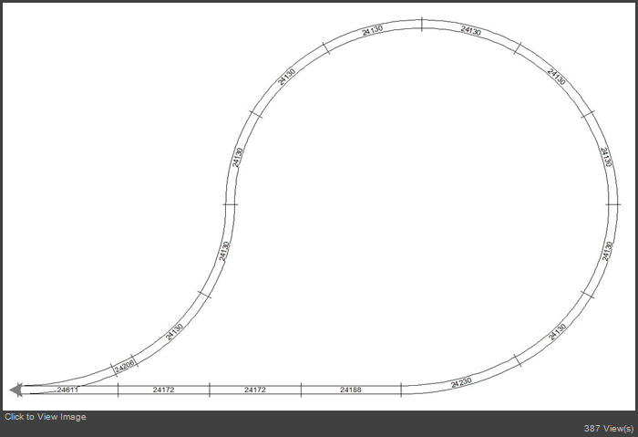

Building on Tom´s reply, here comes a more condensed and space-saving version (requiring 76 x 121 cm), even with slight easements at the beginning of curves, completely relying on R2 radius plus a short piece of straight track (24094) "in-between" in the S-curve area.
I defused the R1 S-curves of the two reverse loops on my layout either by inserting only a short straight track (either 24064 of 24077) or by "counterbalancing" a R1 with a very wide radius track, as R4 or R5, instead. This works fine for all kind of motive power and rolling stocks, European and US, coaches and freight cars, both pulling and pushing.
Cheers - Ak
Cheers - Ak
Hello, thank you for this useful discussion. Dear Alsterstreek I would like to try your reverse loop suggestion but unfortunately I couldn't understand the exact codes of the tracks from this low resolution picture. Can you be so kind and share the list of the necessarry C track codes?

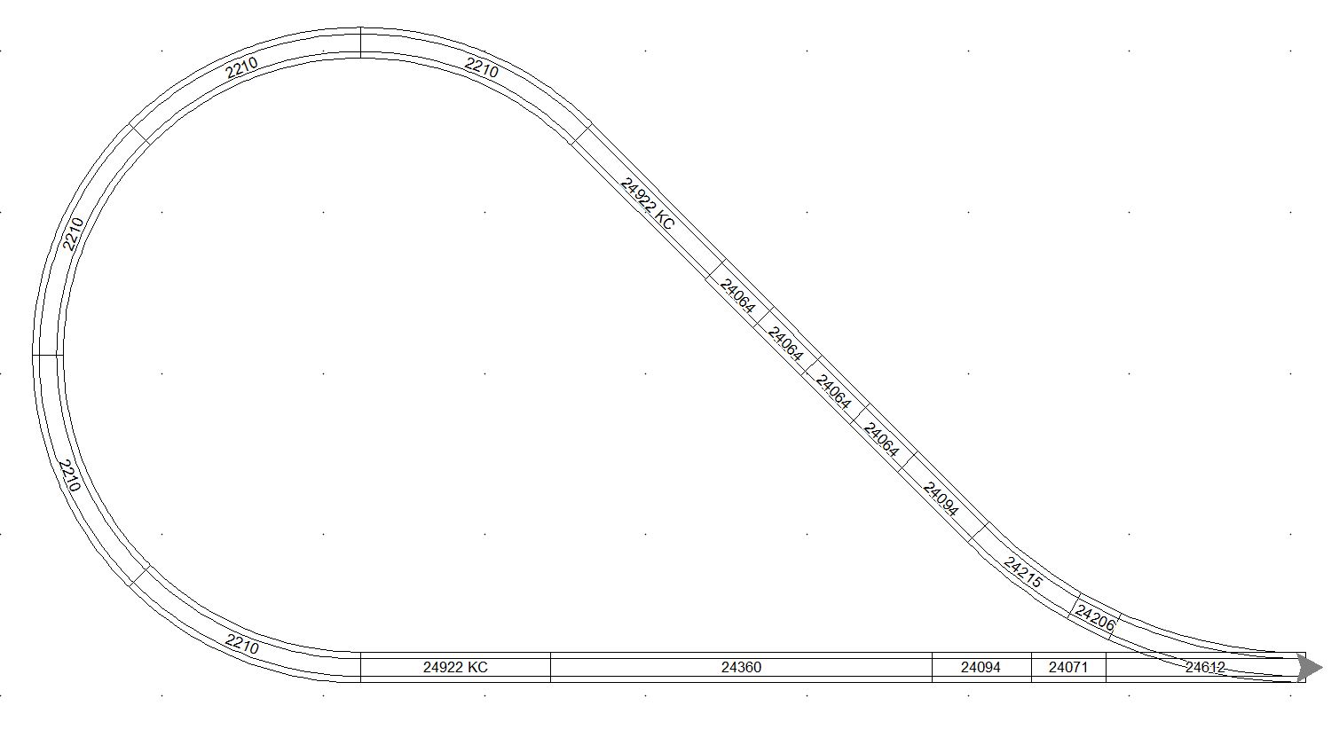

I keep a number of re-usable track patterns, including reverse loops in my library of SCARM track plans. Below are a few images of those patterns. Hopefully the JPEGs have enough resolution so that if you click on the images below to enlarge them, you should be able to read the track part numbers. Please note that all three of these patterns have a straight section of track to mitigate the S-Curve effect mentioned in one of the previous posts.
The first image is an Industrial Radius reverse loop that I needed for my layout. Since C-Track does not have this radius, I had to use the K-Track Industrial Radius track (2210), along with two of the 24922 K to C conversion tracks.K_to_C_Track_Industrial_Reverse_Loop.JPG

#9 Posted : 29 October 2020 08:56:05(UTC)
Posts: 6,118
Here you go:
24064 1
24094 1
24115 1
24130 6
24188 3
24206 1
24215 3
24230 2
24612 1
One beauty of this approach is the use of easements at the beginning of curves, i.e. the initial track piece has a wider radius (R2) than the "main" curve (R1). This improves slightly the appearance of a train entering and leaving curves. Never mind the small mismatch between the 24094 and 24230 segments, the C track has enough slack to accommodate this in reality.

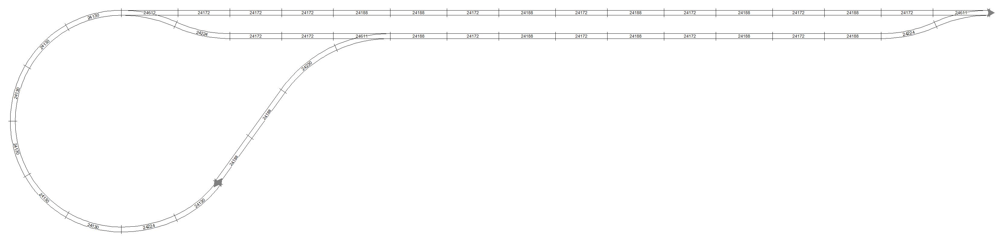

Hi all
I have a reverse loop which doubles back on a second line, and allows for two trains to pass each other in the loop :
thanks 7 users liked this useful post by Johnvr

Hi all
...and it works in m track
