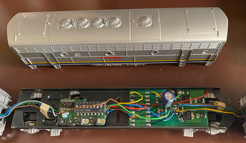

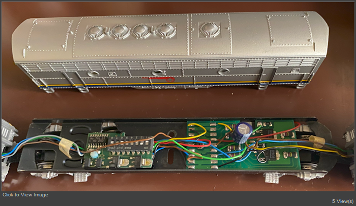

Here is an example of Märklin's way of driving two A/C motors in parallel
Here on a 2-motors A-B-A GM EMD F7 unit where you may see the separate stronger drivers for the motors
