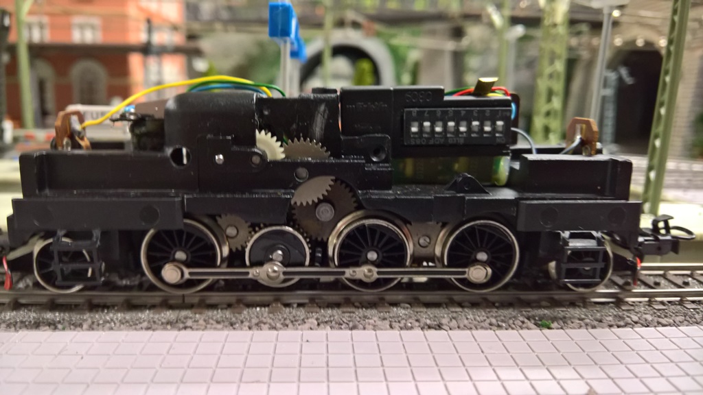

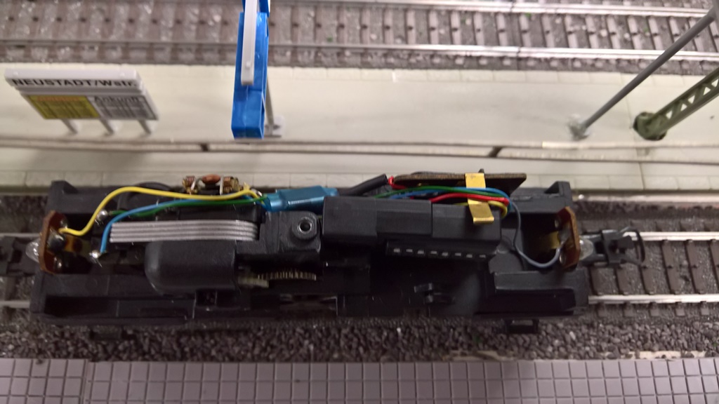

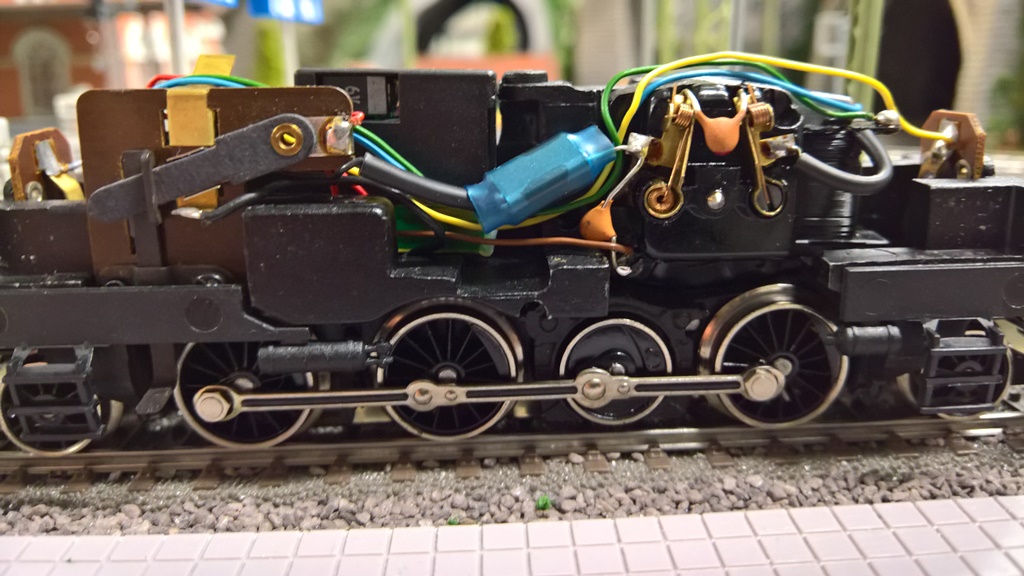

I buy recently an 3670 digital Litt D 109 e-loco.
Inside is the 6080 decoder.
So i open her, i see the 8 switches, i select the desire address and i try to add her to CS2 with the manual procedure.
Nothing... i change the address to 4 to 8 to 70 to 34 to 80 to many others ..... but nothing happents. I also try to automatic recognise the address .... but nonthing again. The CS2 refuse to recognise the 3670.
My last try was with the address 40.
Suddenly the front light turn on and the loco start running without a control from CS2.
I try the same to the opposite side and happens the same.
The motor is ok. Is running. The CS2 is ok, it runs all my other locos.
I have :
CS2 60215
Hardware Version 5.1
Software Version 4.1.2.(3)
Is someone can help me with this issue or i take my pills ?
Thank you.
WP_20161231_18_41_14_Pro.jpgWP_20161231_18_44_22_Pro.jpgWP_20161231_18_42_52_Pro.jpgWP_20161231_18_42_41_Pro.jpg
