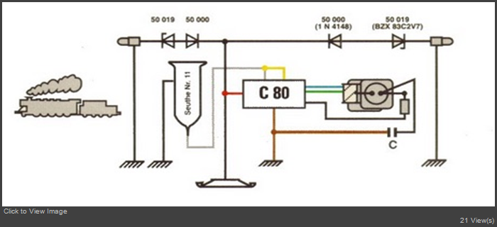

AFAIK, the 3602 indeed comes equipped with a relay to directly feed the smoke units from red/brown track power.
It may well be that the F0 output (both directions) have been used to switch the relay, and the lights are directly fed by track power through a zener diode,
as in this example (not specific for 3602, and F0 feeding a single smoke generator)
