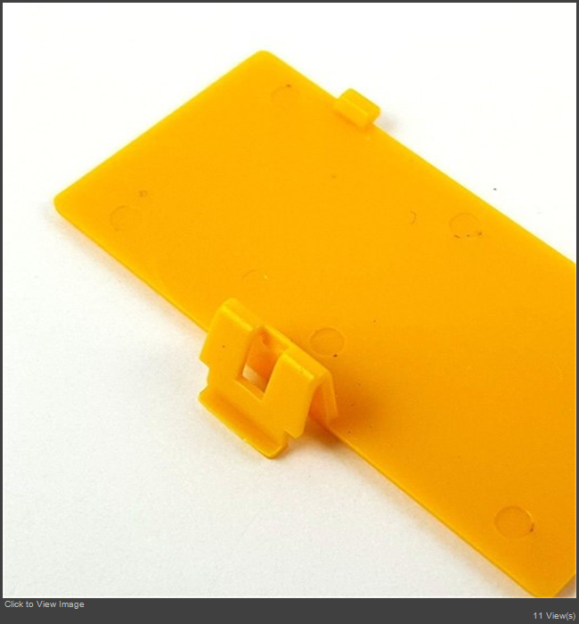

The minimum requirement (invention) would have been a battery door without screws Confused
thanks 4 users liked this useful post by jonas_sthlm
#94 Posted : 27 September 2023 12:58:49(UTC)
Posts: 4,160
Yes. However, a battery door with a clip can crack.
