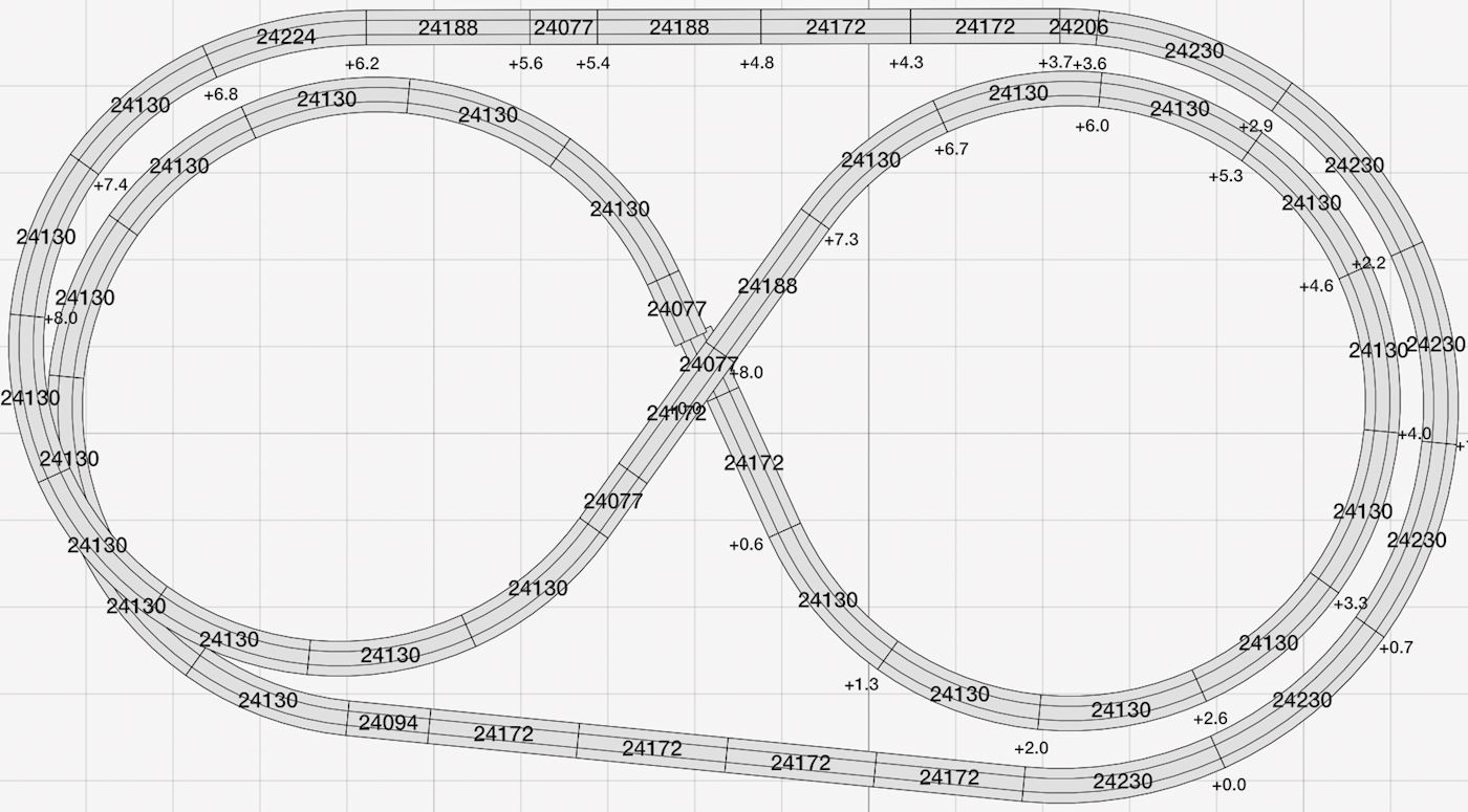

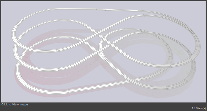

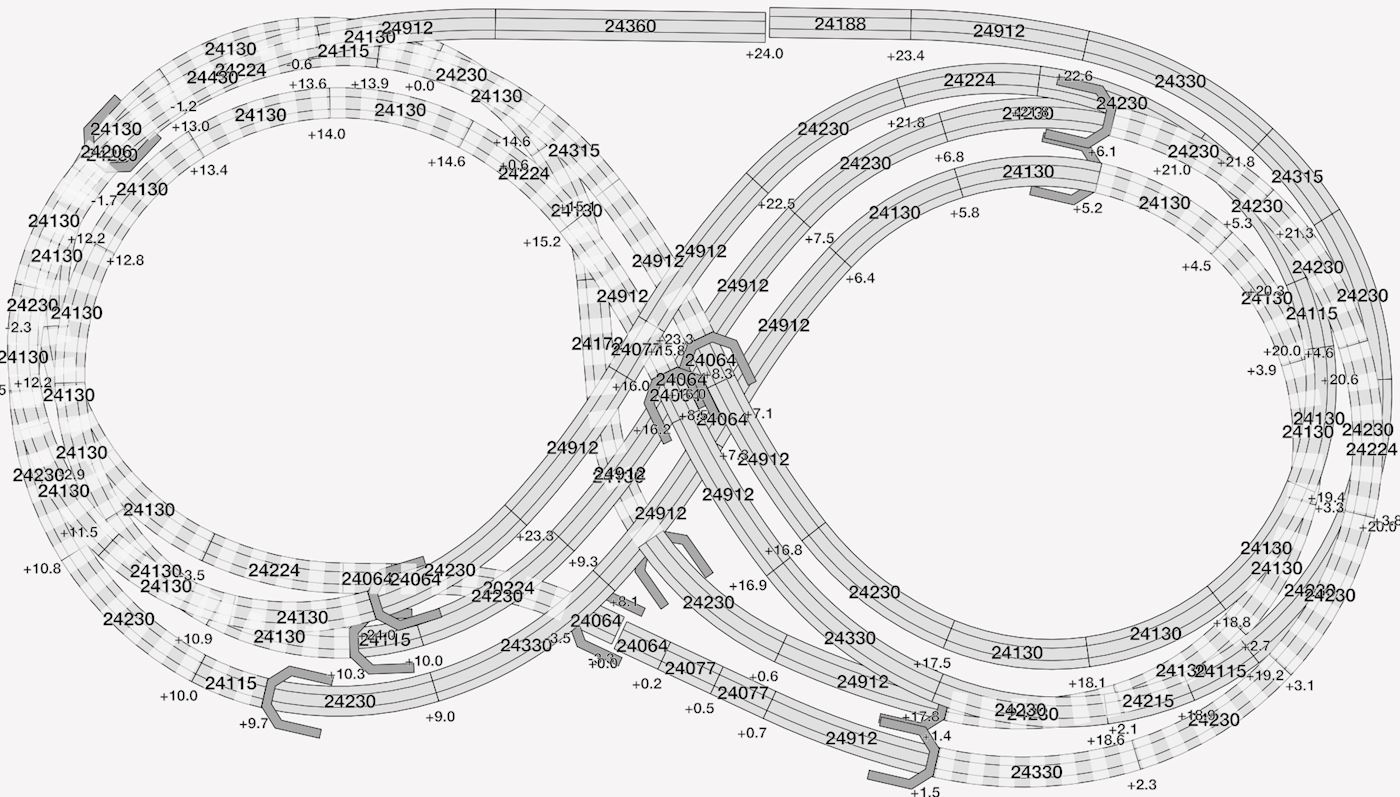

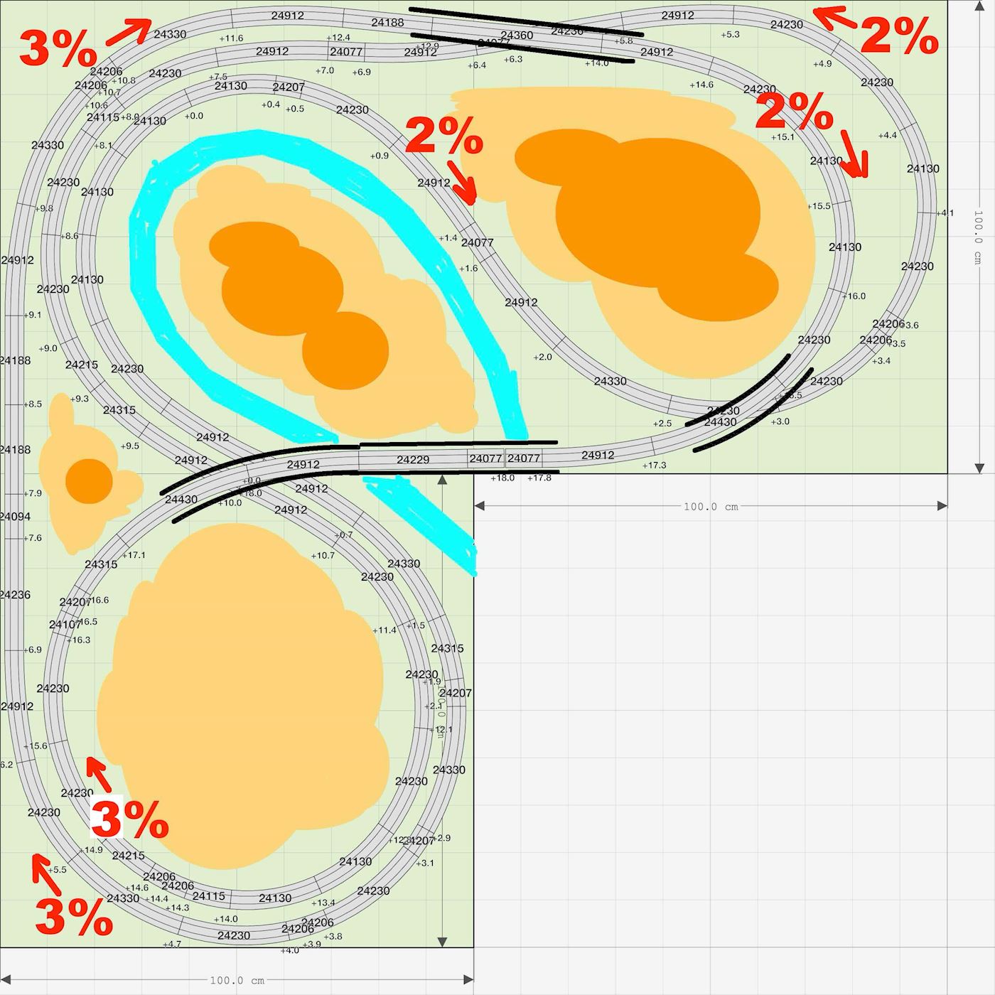

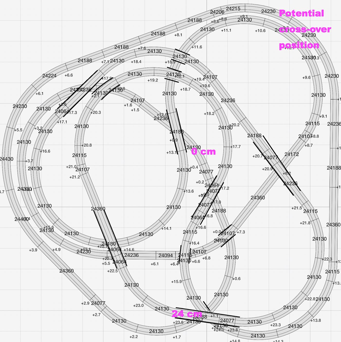

#253 Posted : 30 December 2023 22:15:17(UTC)
Posts: 6,074
L-shape mind game on 2 x 2m with transition curves, maximum track elevation 18 cm, length of track 15.5 m
#254 Posted : 31 December 2023 05:53:40(UTC)
Posts: 6,835
Hello Ak,
I like your last post #253, a very ingenious track plan indeed.
I may be missing something, but would it be possible to indicate the Zero elevation datum on that layout please?
Edit:
Don't worry I found it - the little markers alongside the track showing elevation - thank you.
I missed them until I clicked to enlarge the image.
#255 Posted : 31 December 2023 13:55:03(UTC)
Posts: 6,074
Thank you Kimball. Even though you already detected the 0 elevation, I marked it in below image.The gradients can be chosen in such a way that they reinforce the impression of a mountain railway. The gradients could be harmonized and standardized at 3% to extend the 0 elevation range.
The absolute minimum in terms of elevation would be 8 cm height - see image below. Then there would also be room for crossovers to change the direction of travel. However, this would make the concept look less dramatic.

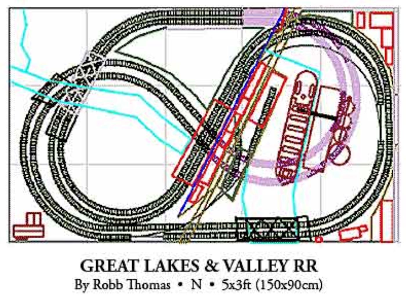

#257 Posted : 03 August 2024 16:46:29(UTC)
Posts: 6,074
Dunno if I shared this before - one of my favourite designs:
Description:
"By eliminating virtually all trackage except a winding double-track main line, Robb Thomas, from Walkerton, Indiana USA, has managed to squeeze both a credible country scene and a bustling port metropolis into a 5x3ft (150x90cm) baseboard. The port is located in eastern Ohio on Lake Erie, and the countryside represents an Appalachian valley in Pennsylvania. A diagonal backdrop separates the two scenes on this N scale railroad."
Source with some photographs (scroll down) in this 2007 publication:
https://www.carendt.com/...special-mid-month-issue/

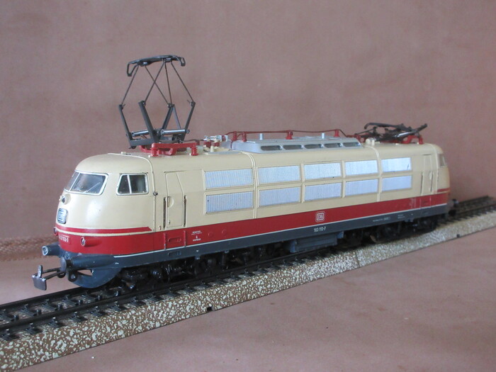

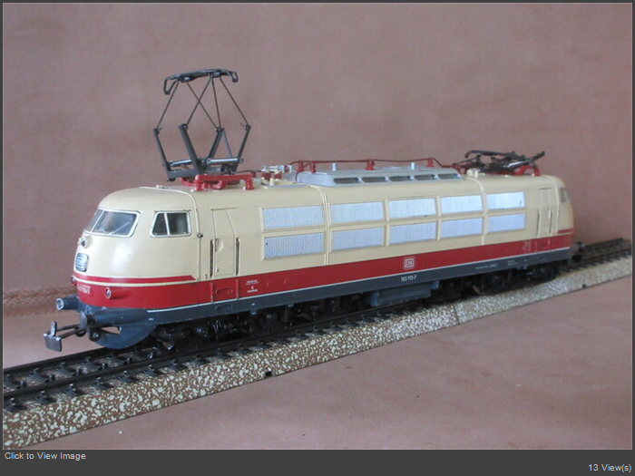

Offline hermanvk
#262 Posted : 04 August 2024 17:32:12(UTC)
hermanvk
Joined: 15/11/2023(UTC)
Posts: 62
Location: Alberta, Calgary
Originally Posted by: hermanvk Go to Quoted Post
And a video about "Breemburg Hauptbahnhof" (= Big City Station on 1.35 sqm mentioned in the previous post #250):
Amazing actually, that I also own the same four locs... even the set AND the panorama car..ThumpUp
Both electric ones.
I just learned how to have trains (same two of the video ) running on catenary..ThumpUp
red_3021_img_2364.jpgred_3016_4018_img_2367.jpgred_3054_img_2360.jpgred_3036_img_2362.jpg
thanks 4 users liked this useful post by hermanvk

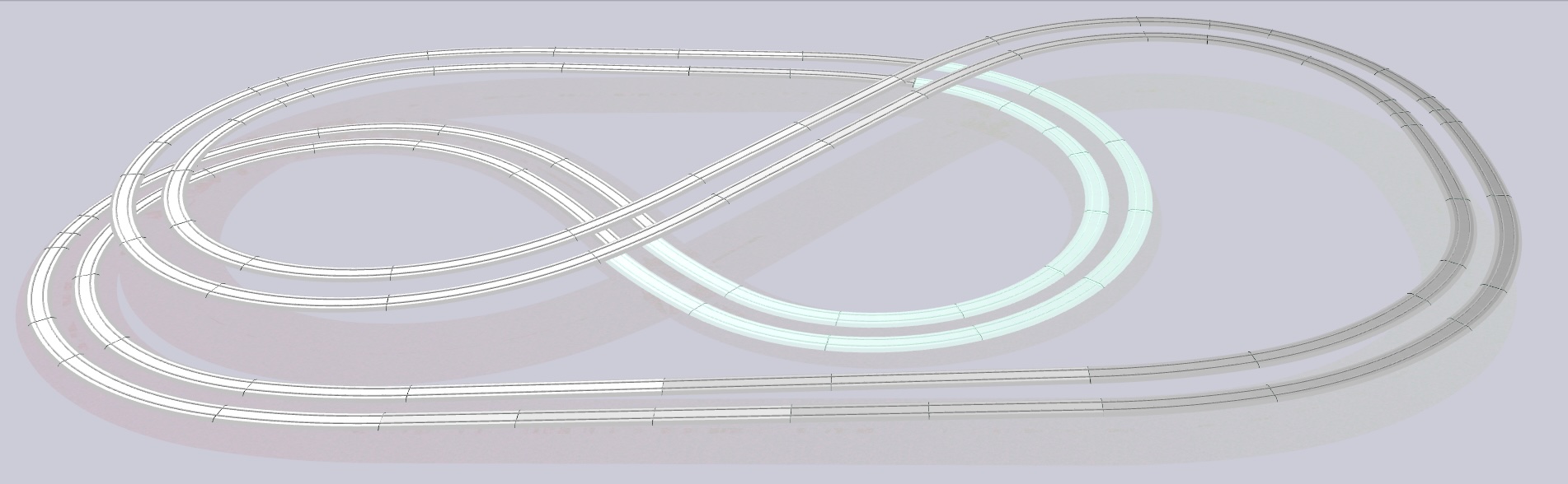

#265 Posted : 15 August 2024 20:05:24(UTC)
Posts: 6,074
Why stop here? How up can you go? Sorry, I've been drinking Cava with dinner.
Well, one could cave in to reach four levels equalling an elevation of 32 cm on a 100 x 170 cm surface (when accepting a ruling grade of 4% and and the omitting of subtleties such as transition curves).Unsure
The lower return loop is inverted.
A valley with bridges would be ideal here, with scenery obscuring some trackage in the rear.

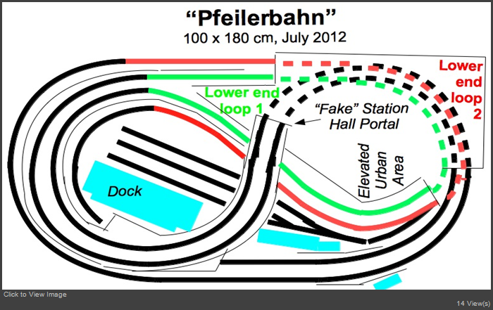

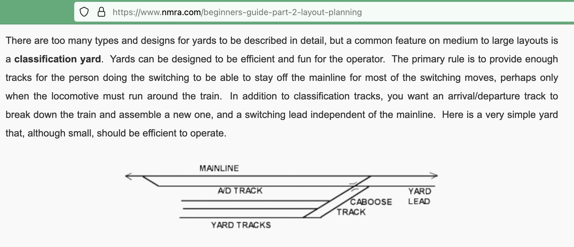

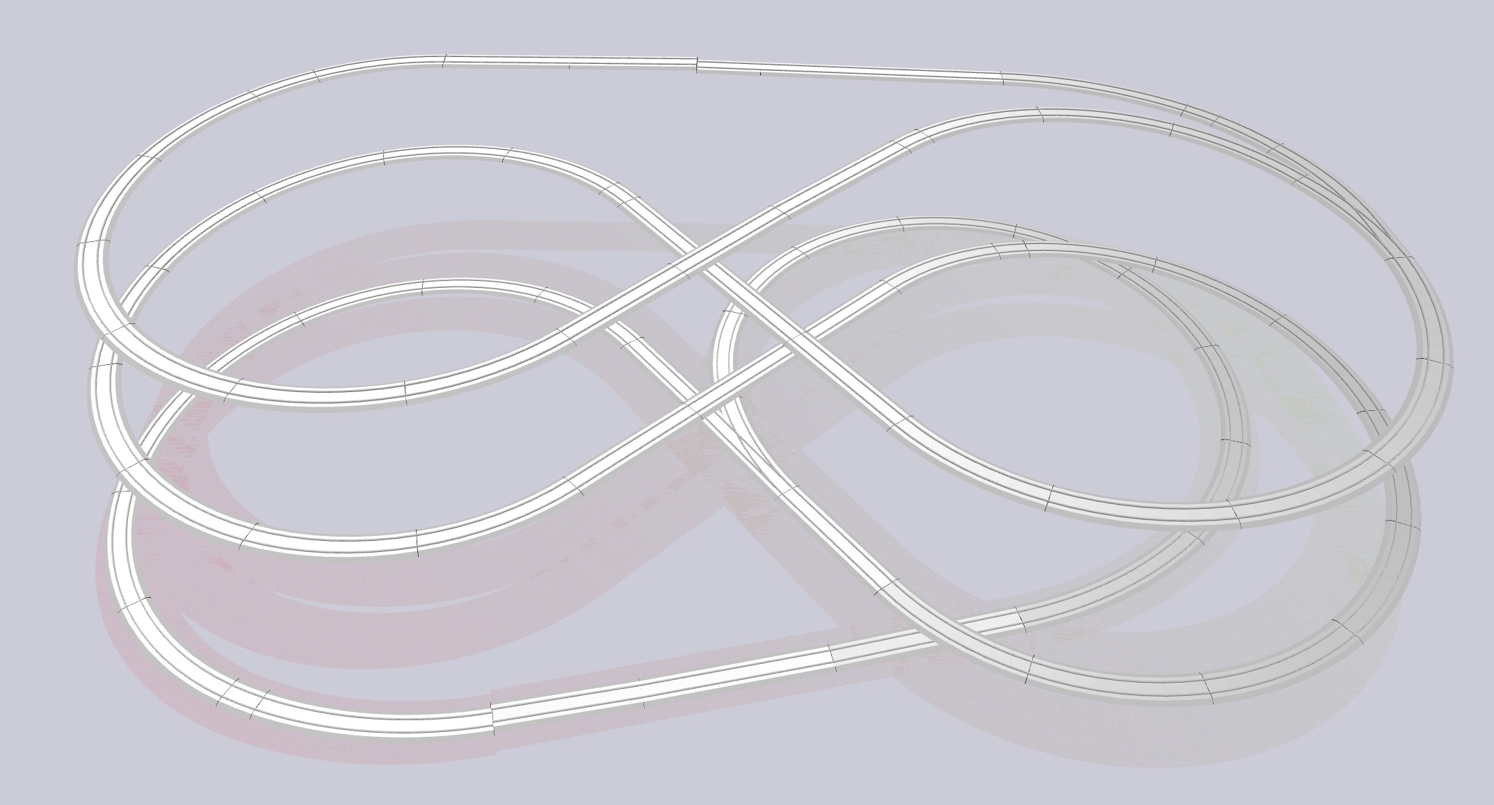

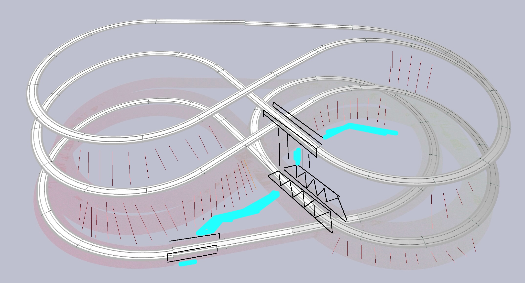

#266 Posted : 29 November 2024 19:41:03(UTC)
Posts: 6,074
This NMRA description of a basic freight classification yard caught my attention. Amalgamating the NMRA scheme ...
... with an earlier twisted dogbone concept ...
... I came up with this 4x8 ft idea:
The proximity of a big city serves as a pretext for the dense trackwork and operations of various trains. For ease of operation and minimal fouling of the mainline, the yard operates in a one-way mode. Assuming that the small classification yard is located between two larger ones (yard A and yard B) explains this arrangement: Trains originate from the distant yard A and are then hauled to the distant yard B. Freight destined to yard A is turned around - out of sight - in yard B.
The layout allows to break up a long US type freight train and serve various industries, while a passenger train could serve a suburban station (the upper deck trackage is open for interpretation and adjustments). A round trip for a train traveling the entire dogbone route measures 20 m and the arrival/departure ("A/D") track can hold a 4 m long freight train. A yard switcher can be parked on the yard lead tail track. With right-hand traffic, the uphill gradients are 3% steep and downhill slopes up to 4%
Edited by user 30 November 2024 10:11:49(UTC)  | Reason: Not specified

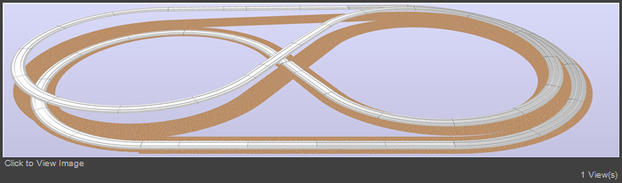

#271 Posted : 10 January 2025 18:25:39(UTC)
Posts: 6,074
For entertainment purposes, industrial switching on a simpler basis in the meantime (195 x 95 cm), curvy but no S-curves.

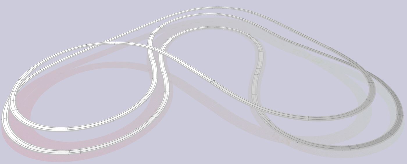

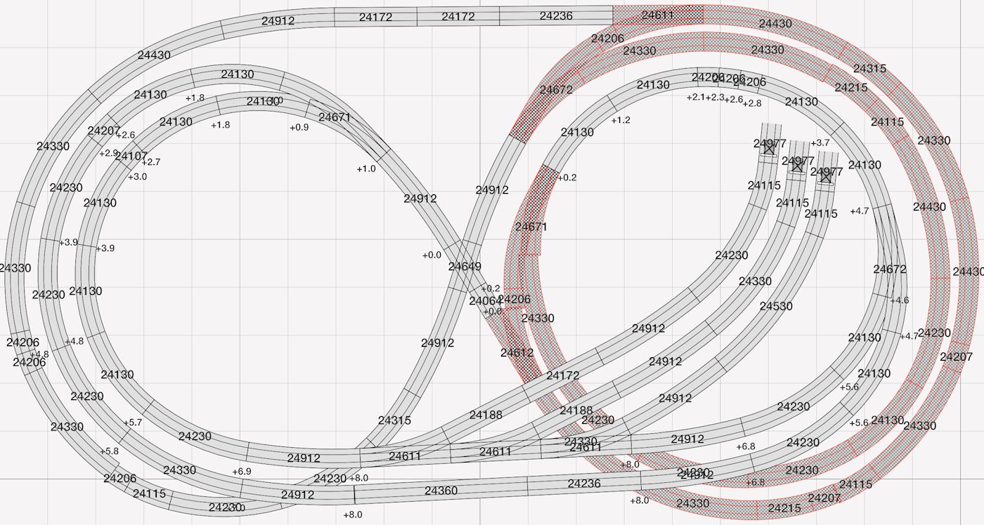

#277 Posted : 04 May 2025 16:44:35(UTC)
Posts: 6,074
Like that?
Overall track length 865 cm on a 169 x 94 cm surface, 3.5% incline/decline for 8 cm overpass clearance.
#278 Posted : 04 May 2025 16:46:07(UTC)

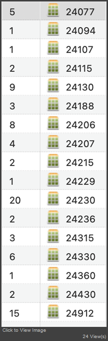

Track inventory:
4 x 24077
1 x 24094
25 x 24130
8 x 24172
3 x 24188
1 x 24206
1 x 24224
6 x 24230

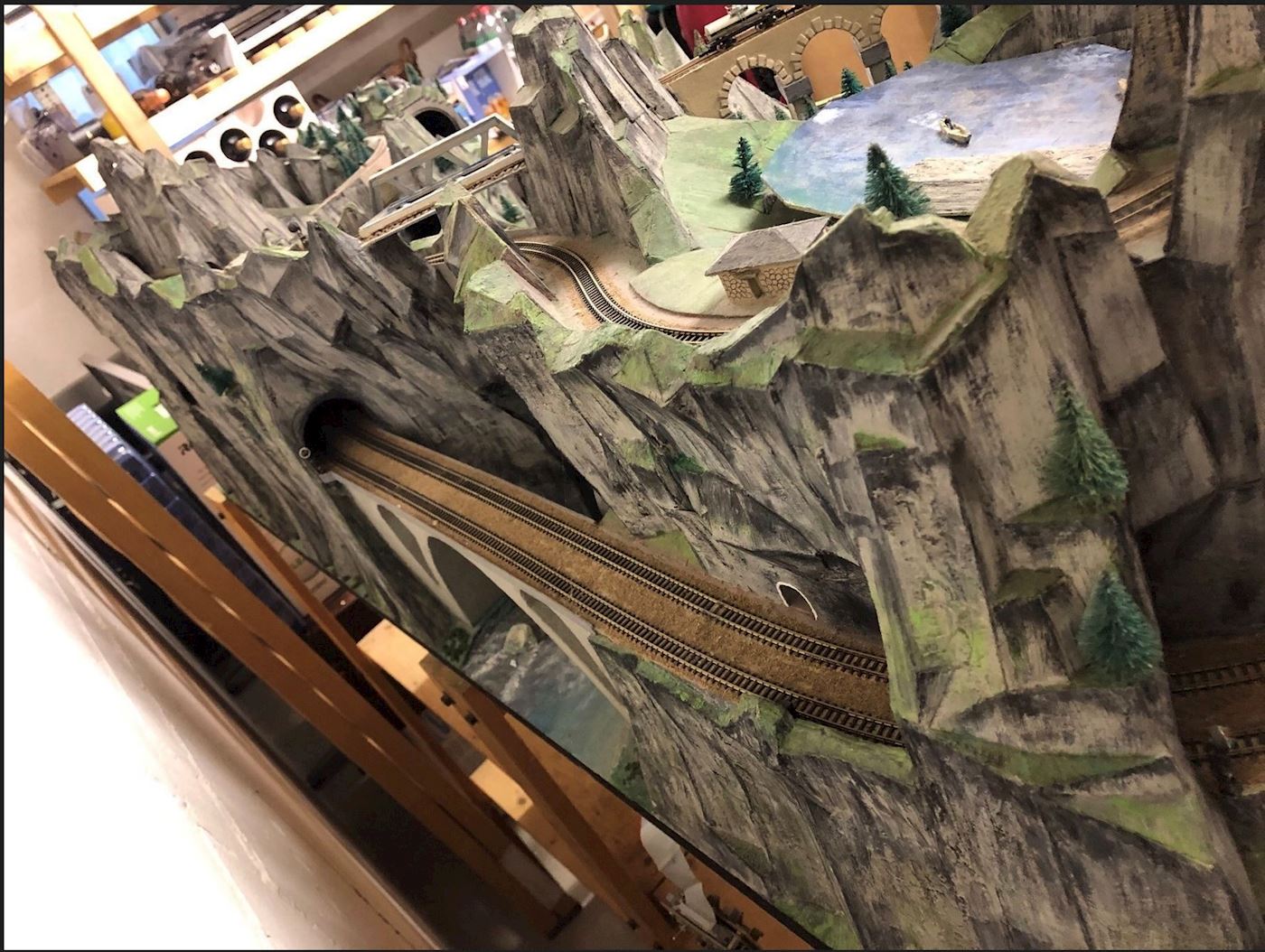

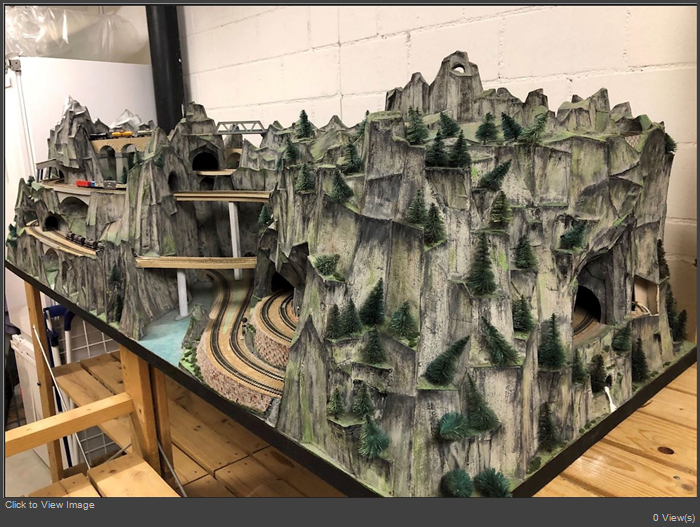

#280 Posted : 18 May 2025 14:21:51(UTC)
Posts: 6,074

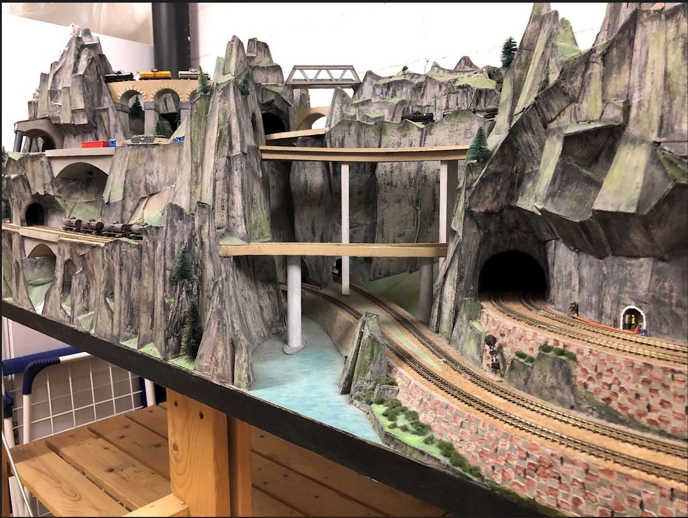

This impressive portable z scale layout with bridges, tunnels and gorges, built with lightweight materials, was once for sale in 2020 (asking price was CHF 1,200). It measured 160x 60cm horizontally. The double track line climbed 55 cm before descending again. According to the vendor, up to six trains could run at the same time and trains should be able to negotiate the gradients and curves without any problems.
Unfortunately no track plan available.
Edited by user 19 May 2025 08:07:55(UTC)  | Reason: Not specified

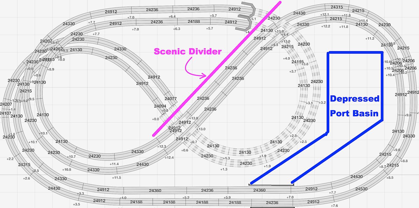

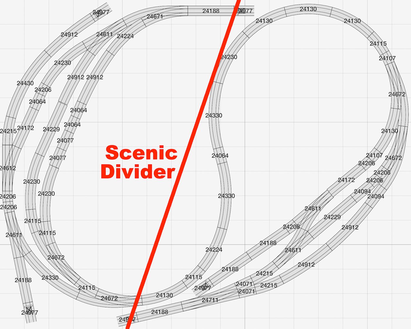

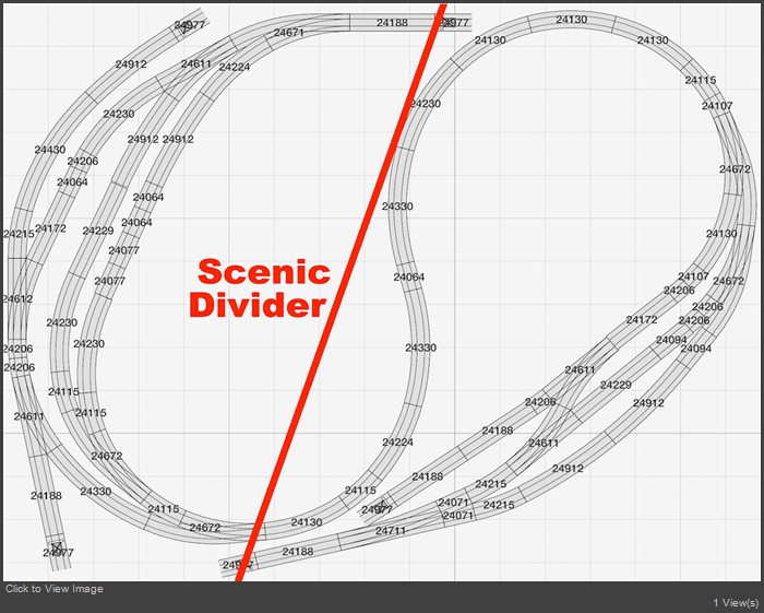

#283 Posted : 25 May 2025 18:35:04(UTC)
Posts: 6,074
Elaborating on posts #271 & #273:
189 x 83 cm
#284 Posted : 25 May 2025 22:32:46(UTC)

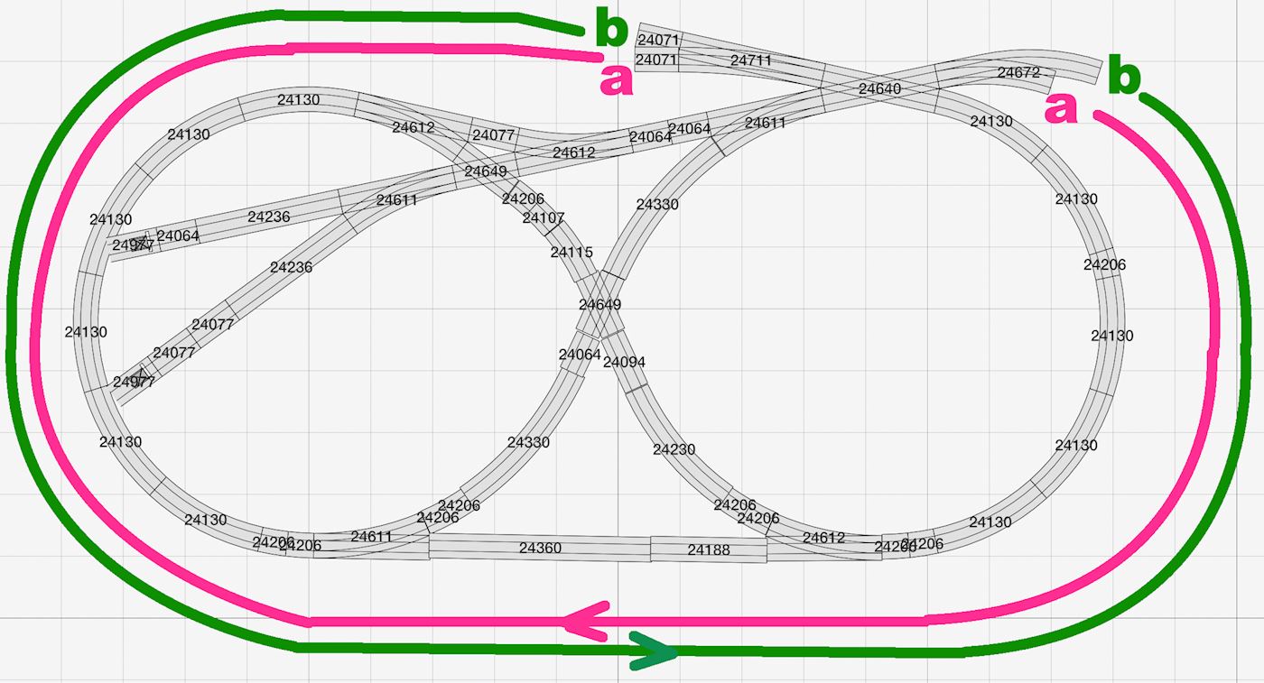

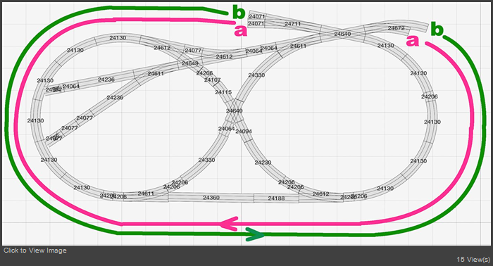

#285 Posted : 05 June 2025 13:12:24(UTC)
Posts: 6,074
Actually, this allows for an Inglenook shunting puzzle - see track section marked in red.
And shifting one of the cross-overs creates a passing loop - see track section marked in red.

#290 Posted : 08 August 2025 00:12:42(UTC)
Posts: 6,074

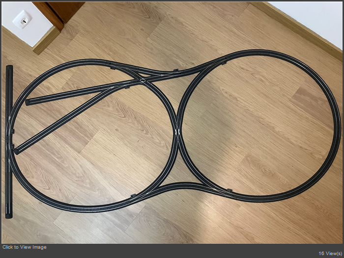

In February 2015 forum member Warorb and I admired this little Z gauge gem in this thread: https://www.marklin-user...-unusual-Z-scale-layouts
I couldn't get the concept out of my head. That's why, after 10 years, I decided to try out how it might look in H0. Since it's an adventurous mountain railway, the radii can be tight, i.e. R1. On a rectangular 165x165 cm surface, with a track length of 18 m and a gradient of 3%, it could look like this. A spur here and there could serve as yard for industries and train meets.

Pretzel Logic?
thanks 3 users liked this useful post by rbw993

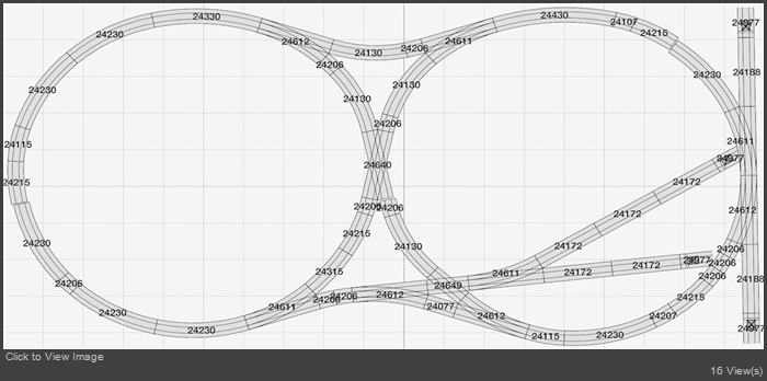

#292 Posted : 08 August 2025 15:35:58(UTC)
Posts: 6,074
Pretzel Logic?
If there was a station somewhere along the line, it could be named "Point". Like that, it would be point-to-point operations.

Posts: 6,074
Recent layout video in addition to my post #183 from December 6, 2018, about Jim Griffin's DRGW La Plata Division layout in H0 scale
#295 Posted : 30 August 2025 12:12:09(UTC)

Offline analogmike
#296 Posted : 31 August 2025 13:20:45(UTC)
analogmike
Joined: 02/08/2014(UTC)
Posts: 821
Location: NEW JERSEY, USA
I really like this style of mountain construction. It solves the problem of going strait up and still look good doing it without the use of brickwork or a crazy amount of retaining walls. It's almost prismic or crystaline. I know it's a reach but, are there any pics of this under construction??

#297 Posted : 31 August 2025 17:34:24(UTC)
Posts: 6,074
I'm afraid that's all there is, and a Google image search yields no results.
#298 Posted : 01 September 2025 15:24:51(UTC)
Posts: 6,074
I tried to recreate a Stummiforum track plan—which is no longer available there—faithfully to the original, which I presented 10 years ago in poor resolution in our thread The C track topic - ideas, uses, and innovations.
I find this 135 x 168 cm design interesting in relation to the above post #275. While the latter – actually a compact oval with a branch line – enables realistic point-to-point operation with a shadow station, the former “only” enables prototypical point-to-point operation, albeit with elegant route guidance in a very small space and still on one level, if you use a scenic divider. Alternatively, the S-shaped connecting track could be designed as a ramp to create the impression of a distance between the two stations on different levels.
#299 Posted : 17 November 2025 15:02:13(UTC)
Posts: 6,074
Further to posts #274 & 275, I wondered how much of it - when condensed - would fit on a IKEA Lack table measuring just 118x78x45 cm? Please judge yourself:

Inspired by the track plan no. 35 "Denver & South Park RR" in 101 Track Plans by Model Railroader Books, 260 x 100 cm.
It seemed promising in the book, but I'm not convinced by the result.
