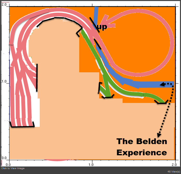

Adding some interest with the help of a mine next to the lower main line plus a high line coming from the "off"?

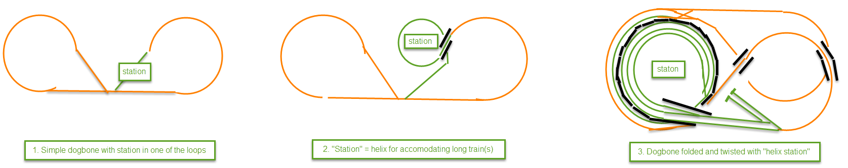

As I have to live up to my reputation, I dreamt up another ultimate layout condensation - see snapshots. Max. size 4 x 8 ft. The evolution:
1. The starting point is - what else - a dogbone. To save space - what else - the station area is placed inside one of the reversing loops. When having both loops visually separated and throwing the station loop turnout alternatively into either direction, and when viewing only the station loop area, the illusion is created that a train leaves the station to X-town and returns from X-town after some time, before leaving to Y-town before later returning from Y-town. In a similar manner, the same illusion would be created for the stationless mainline loop behind a scenic divider.
2. How to cope with long trains on a limited station surface? Coiling. On a helix.
3.Then condense the entire contraption by folding and twisting.
Finetuning:
Conceal the station helix (or helix station), display an intimidating station throat and have station tracks disappear in the scenic divider under a faux station façade and/or road bridge in front of a city backdrop (has been done before, I was told). Wham, that's whimsical model railroading. Full roundtrip form would be 20 m.
#160 Posted : 29 July 2017 15:31:26(UTC)
Posts: 6,074

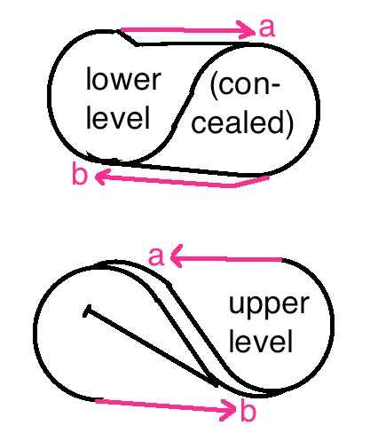

Note to myself on basic functionality of above design.
When having a dogbone with reversing loops, the latter need to be concealed for the sake of plausibility. This is eating precious space. The idea is to adapt a dogbone for making it socially acceptable to leave one or even both reversing loops in the open. A station would be sitting in the loop area instead of being located in between the loops and would still see a train departing into one direction and see the same train returning from the same direction. Both large and small layouts could benefit from this approach. Sprung turnouts allow for "mechanic automation".
Prototypical train running appearance to be reached by either concealing one blob and the hidden blob taking over shadow station duties...
... or having a "solid" view block separating both blobs.
Blobs do *not* need to be equally sized. One blob could have a train-lenght size and the other one could fill a room with book shelf right of way running along the walls. Alternatively, blobs could be stacked, twisted and folded. The "Hosentraeger"double crossover could be placed in a curve etc.

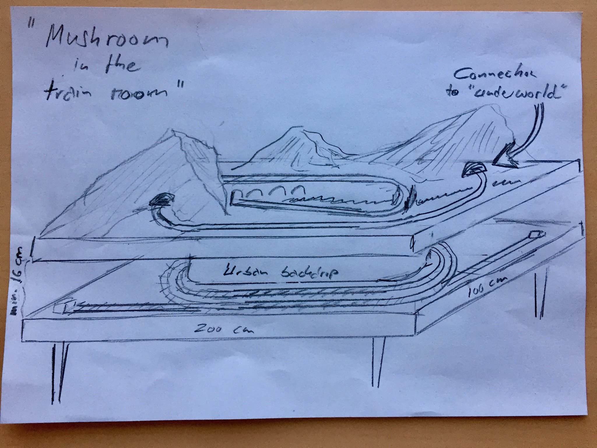

#163 Posted : 30 September 2017 14:58:28(UTC)
Posts: 6,074
Trying to combine my beloved complicated station throats with a separate landscape by combining two modules is too space consuming for my taste. So I was thinking of stacking the two modules, dreaming up the 100 x 200 cm "Train-Room Mush-Room". A basement with a visible station throat and concealed coiling area for long trains crowned by an attic with a landscaped section.

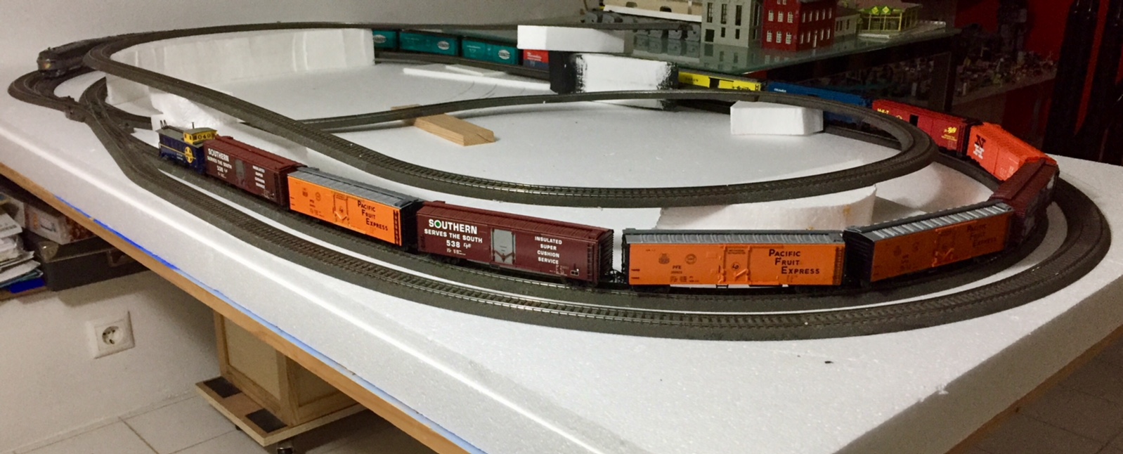

First train-room mush-room basement attempts, starting with an oval helix with sidings coiled around the latter. Mind you that eventually only the outer two sidings shall be visible, while the "distribution clockwork" inside is concealed in the support structure on which the landscaped "attic" is supposed to rest.
Then a trial incorporating the inverted return loop concept presented here:
https://www.marklin-user...d-innovations#post537826
The inverted return loop looks quite pleasant, but the overall result does not convince me. The curved turnouts behind the overpass are difficult to reach. Furthermore, the trackage looks not "fluid" enough.
Both trials deliver toy-like results, and styrofoam characteristics do nor allow for a connection to the attic. In addition, inner "distribution clockwork" turnouts are hard to reach. And most prominently, my minimum siding storage capacity requirement of a EMD F7 ABBA + 16 tin plate box cars (50 ft) + 1 caboose is not met: The inner siding capacity is one box car short, respectively.

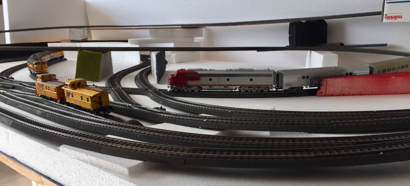

Today the breakthrough, a more sophisticated looking solution. I present Huevo depot, where Fanta Se and Grande lines merge to form the joint line to D’enfer (founded by French colonists), which is represented by the double track return blob (in the future mostly concealed). ATSF interchange to La Quinta is represented by the stub for the Mini Chief train, of course cutting recklessly through Grande tracks. The ascending line leads to Tennessee Williams Pass. The ceiling - 20 cm - of the underworld is ca. 1 cm below the loose end of high line. The styrofoam-soaked images cannot properly replicate the awesomeness of the appearance, but it is really looking good.
:o)
Oh yes, another test passed: Even the shorter inner blob track is holding the obligatory ABBA + 16 box cars (50 ft) + caboose.
Track plan.
Red = ascent to the upper world. Stub tracks still subject to change without prior notice. According to the track planner, there are considerable gaps, which I did not „feel“ when plugging together the ensemble. Further, according to the plan, dimensions are 101 x 211 cm, while I squeezed it effortlessly on a 100 x 200 cm surface.

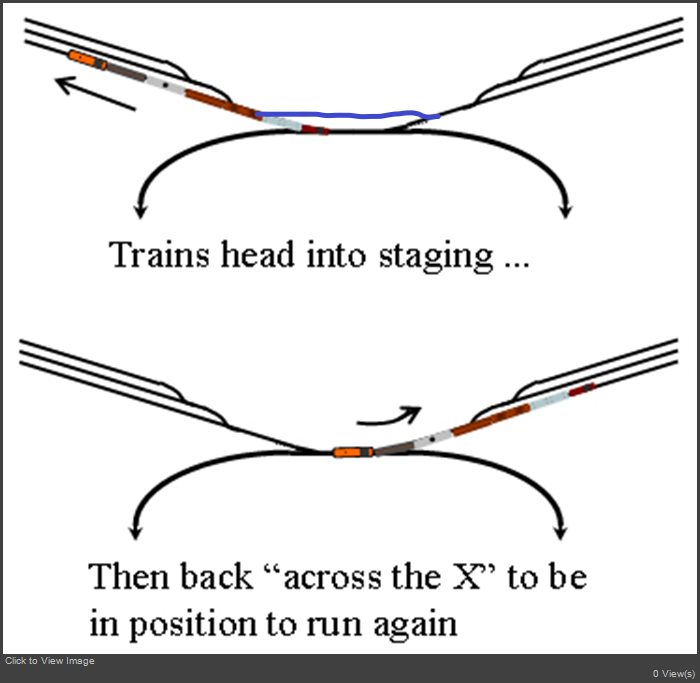

Another way to conceal a dogbone end loop:
http://www.edalon.net/mo...ellbahn-kehrschleife.htm

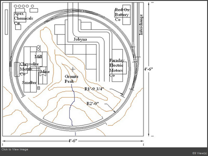

Eric Miller´s circular GPM&C Ry in H0 scale.
Track plan
Mock-ups
http://cs.trains.com/mrr...8631/2177191.aspx?page=5

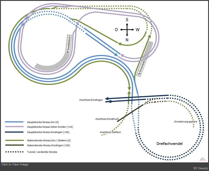

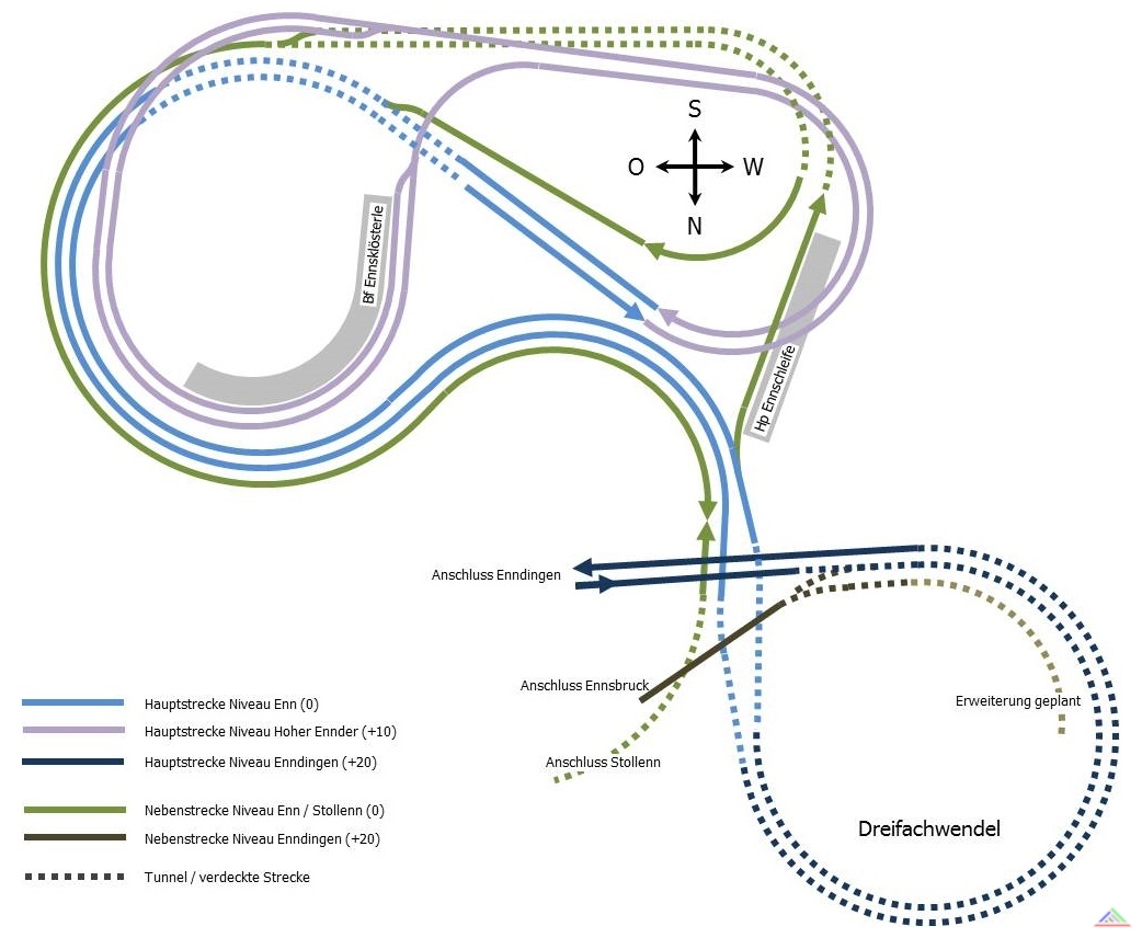

#178 Posted : 15 May 2018 12:44:57(UTC)
Posts: 6,074
Browsing through the gent's website I tried to understand the intricate N-scale track plan, which is a combination of dog bone courses.
http://www.enndingen.de/.../ennderennsbruck2012.jpg
The circles on the lower right hand side represent a triple helix. There seems to be a shadow station (covered by a visible station area?) connected to the lines pointing into the void....

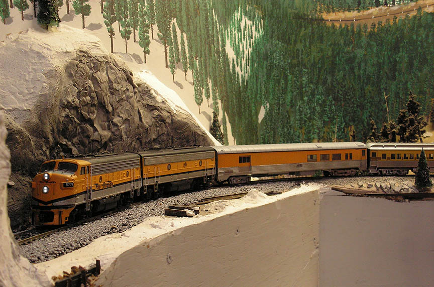

Another contender to be considered in my view. Jim Griffin´s H0 scale DRGW La Plata Division layout:
http://www.actionroad.ne...Division/LPD-Concept.htm
And he even mirrors the actual Colorado Front Range situation.
His concept of choosing an era to operate by running valid rolling stock for that period is quite interesting. Let alone his El Cheapo but artsy approach in regards to trackage, layout construction plus the semi-shelf out-and-back nolix-helix mix.
187_Vasquez-2.jpegMoffatTunnel.jpeg5771Special-Cliff.jpeg1986.jpegServiceTracks1994.jpeg
#184 Posted : 06 December 2018 16:00:05(UTC)
Posts: 3,052
I too am a big believer in building a layout where the era can be dictated by the rolling stock, not the rest of the layout. And with european locales it really isn't that difficult Some issues in cities, but thats about it. Of course it all depends how much you plan on superdetailing your layout. Since my other love is cars, I have no problem swapping out the 1/87 vehicles as well :)

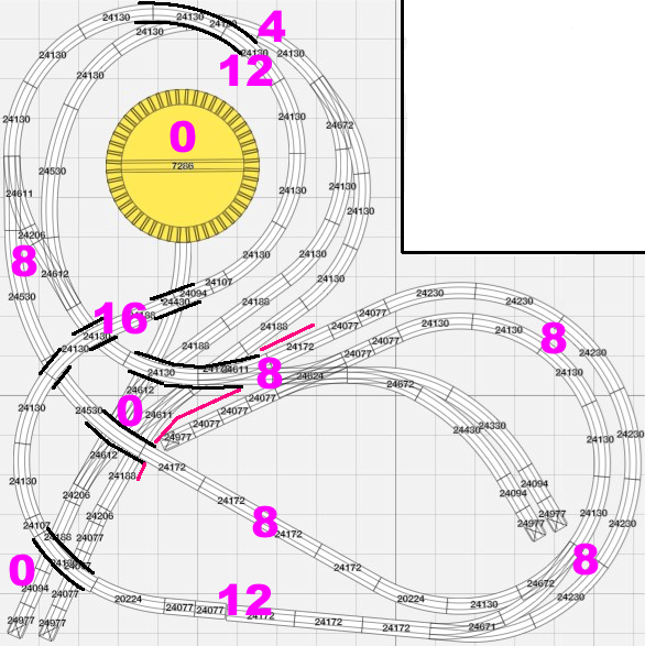

#186 Posted : 21 March 2019 18:15:34(UTC)
Posts: 6,074
Multi-level, running three trains simultaneously.
http://www.modelscenerya...el-railroad-track-plans/

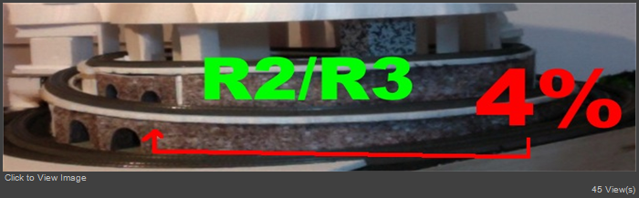

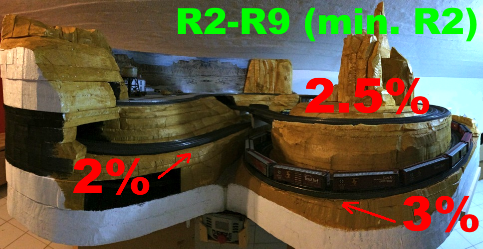

I'd like to cross-reference my below 2015 post here, since it was sitting in a dead thread while well fitting into the concept of ovals and circles.
Originally Posted by: sedgar2 Go to Quoted Post
What are people using as an acceptable grade, that keeprealism and keeps a loaded power unit from spinning wheels.
Well, depends, as everything in life. As Ray pointed out up to 5% operations run well. Curved ramps cause more friction than straight ones, S-curves are worse than continuous curves. Another factor is train length (and consequently weight to be pulled). Then, a train moving over a 5% grade looks more acceptable than one sitting on one. My experience is that 3% is the minimum for aesthetics; and with 3% there are no limits when it comes to climbing ability.
Caveat: I experienced derailing on a (tunneled) 3% grade on a tight R1 radius stretch for heavy tin plate goods trains with more than 100 axles or passenger trains more than 8 coaches only.
;o)
What are the procedured to keep the tracks from separating?
C-track: none.
Any photos?
See below. Various C-track set-ups, all ramps curved, radius used in green fonts, grade in red fonts.

The X Factor, a staging approach presented in the MR magazine in 2004.
Here is a variation with a way to avoid fouling "Desmaigne" and/or keep the exit/entry junction in view, a connecting track (blue line). I think I saw something like this in Amstrong's book.
Roger

Thou shalt not foul Desmaigne !
