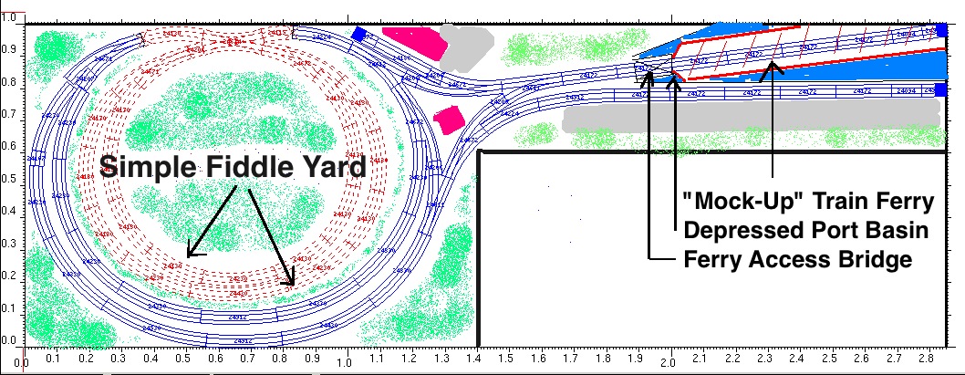

Now, the basic layout idea is to have a quayside scene with a mock-up train ferry in the background of a quay, which serves as a fiddle yard for a short international train. To the left the ferry port is linked to the single-track mainline - set in a green flat landscape, which has a gently swinging large radius curve. Northbound express trains arriving via the - fictional - lower wye track (which the former Grossenbrode ferry port on the mainland actually had), and the loco backs the train onto the ferry; subsequently, the loco uncouples and drives to the quay. Once the ferry "returns" from Denmark, the reverse operation is carried out for the southbound train, which eventually disappears for its long trip via the - fictional - upper wye leg. The front sidings are for a commuter train or serves as layover track for freight cars. When riding the mainline, the hidden loop extends travel time and allows to conceals the train, adding a level of realism and avoiding the train to chase its own tail. Trains can be short and colorful: Anything goes on 180 cm x 90 / 40 cm - see attached track plan !

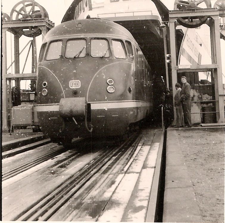

I found a historic Wikimedia Commons photo showing the single track train ferry "Danmark" in the Danish port of Gedser - see attached. The vessel is docked so tightly in the basin that for the sake of realism it is not necessary to model a depressed port basin. This makes the job even easier - and less depressing (pun intended). And it should ease the pain for some people with photographic memory to follow the thread.
Gr. - Ak LOL

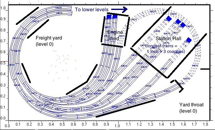

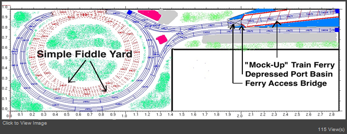

#10 Posted : 30 December 2013 09:32:41(UTC)
Posts: 6,031
Hi there,
Here comes phase 3 - see track plan:
It seems as if the bending widely accepted concepts of space and time is too overwhelming. So, let us keep the location in one country. RollEyes
By inflating the measures of the loop module to 100 x 140 cm:
(1) A modest fiddle yard could be installed in the tunnel; each siding could hold one loco plus four 27 cm coaches, allowing to have meets in the tunnel or even simulate loads in / empties out freight operations;
(2) a outer "ring siding" could be added, giving more operational potential.
(3) By stretching the ferry port leg from 40 x 60 cm to 40 x 145 cm, longer trains could be run and a real wye could be built, allowing to turn steamers and sending trains into both directions. In general, the layout would obtain a more grown-up appeal (at the cost of space though).
Cheers - Ak Smile
P.S.: To be continued / elaborated...
P.P.S.: I added a photo of the steamer "Danmark" (single-track train ferry) for the ones requiring a visual stimulus.Laugh

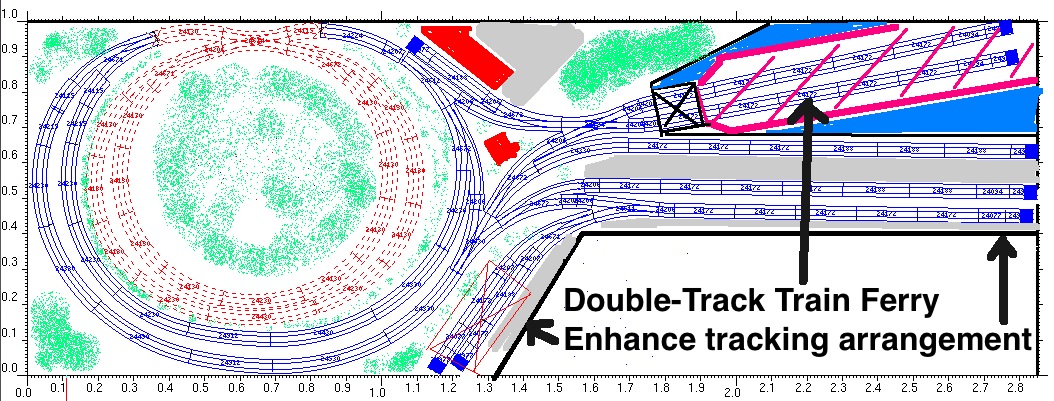

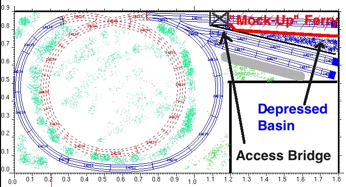

Good morning - phase 4:
A decent and self-respecting man can never have enough sidings. By slightly enlarging the ferry port leg to 50 x 145 cm and by replacing a normal by a three-way layout a couple of sidings can be added. Good use could be made of the outer loop siding as switching lead - see track plan.
Cheers - Ak

#13 Posted : 30 December 2013 23:54:06(UTC)
Posts: 6,031
Hi there,
Here comes phase 5 - split the train, double the fun:
By inflating the loop module a little bit in lower right hand side and adding 10 cm to the front of the ferry port leg, a double slip switch could be added in front of the ferry access bridge, thus allowing to have a double-track "mock-up" ferry. Further, adding a switch plus siding here and there would add versatility - see attached track plan.
Some photos of the pre-bridge period: http://www.burg-fehmarn....ssenbrode---gedser.html: Photo #11 shows a larger ferry with two train heads (actually having three tracks with the middle track being concealed by the the trains). On photo 10 the three tracks are clearly visible.
Cheers - Ak
P.S.: Now I really ran out of ideas.

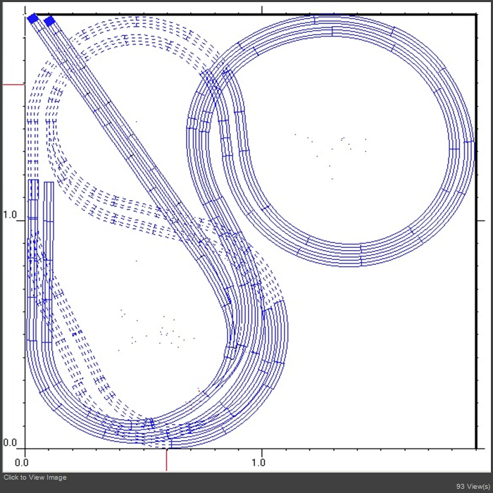

#18 Posted : 27 February 2014 10:58:50(UTC)
Posts: 6,031
After a lot of theory, the example of two "circular" layouts (I) really built, the single level 2006-7 Foursquare Circles (95 x 95 cm) and the tri-level 2013-? Thunder Mountain (100 x 128 cm) - see pic.
#19 Posted : 30 March 2014 13:09:25(UTC)
Posts: 6,031
I found a recent German 120 x 220 cm interpretation for Maerklin track of an older U.S. design for a compact 4 x 8 ft urban layout for passenger and freight operations which requires access from the front and the rear. While the U.S. approach was for a "flattop" with a town on the center divider, the German is a bi-level one with an industrial area on the center divider. In both cases the front is dominated by a big city terminal for long distance and commuter passenger trains, while the back is centered about local industry tracks and a suburban passenger station. I would change the direction of the main station layover tracks to allow for commuting back and forth between front main station and back suburban station stub tracks, and I would optimize turnout positions to extend track lengths. It is not clear what the intention is regarding the right side. To be connected to close the oval? Connection to a hidden lower basement level with a shadow station or or even return loops to change the direction of trains?
Anyway, even with the flattop approach the layout has a big operating potential. Freight trains could originate on the elevated area, circle around once and end in the industrial are next to the suburban station and vice versa. Commuter trains could shuttle between suburban and main station stub tracks. Long distance passenger trains (e.g., a "double-headed" ICE) could leave the main station, zoom without stopping through the suburban station, stop and change direction in the far hidden curved tunnel, respectively, and return from the distant destination in order to terminate the journey in the main station. Or one could just play and let trains circle.

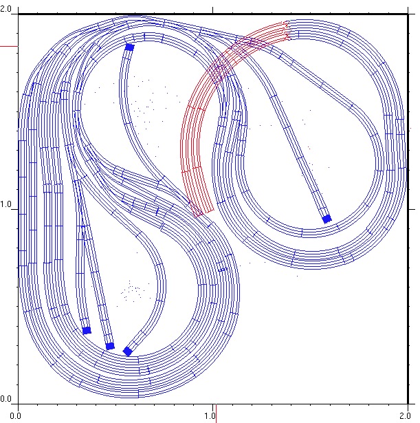

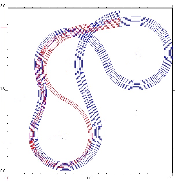

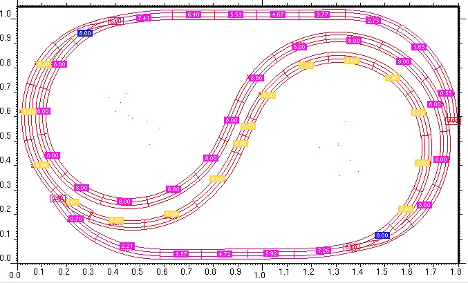

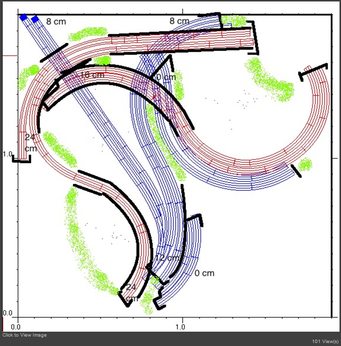

Brainstorming on 105 x 180 cm. Bi-level folded dogbone. Red = visible upper level and ramps), blue = hidden lower level.
#22 Posted : 27 April 2014 19:53:57(UTC)
Posts: 6,031
I cannot get this concept out of my head. For a long time I am planning to incorporate it, and maybe I will do so once I have to retouch or rebuild a layout for any reason. It is a space saving idea to combine long layover tracks with a "dog bone end blob". The mainline swinging over the stub tracks will obscure the ends of the latter, thus giving the illusion of more depth. There are R9 easements at the beginning of visible curves and R1 curves are almost entirely hidden; ruling grade is three percent. Sticking to the limits of a 100 x 180 cm baseboard, the two inner stub tracks can hold five to six US streamliner coaches or nine to ten US 50 ft box cars. Outer stub tracks are for engines and cabooses. Increasing the baseboard dimensions by five centimeters would allow to add another stub track. When working the stub tracks, the outer mainline track serves as switching lead. In that case of an oncoming train circling on the mainline, it would be switched to the inner track, thus returning on its own path (see plan 1). Eventually, the train would need to return to the outer track at the top of the grade.
(One option is shown in plan 2, which proposes the second "dog bone end blob" on top of the lower one, thus closing the circle; the latter is not satisfactory enough for me, since I prefer a longer mainline run, but the option reflects the intended operation concept.)
Unsure Wink RollEyes

Offline Irish Rail
#24 Posted : 30 April 2014 10:20:05(UTC)
Irish Rail
Ireland
Joined: 04/03/2014(UTC)
Posts: 123
Location: West Cork
Have been watching your ideas with interest as I have exactly this problem - how to fit an "interesting" layout into a confined area. In my case max is 2.4m*1.2m (slightly larger than your ideas here).

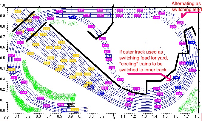

The latest version looks interesting, but one thing confuses me - the two red arrows point to "hidden reverse loop" but the tracks seem to end. Are you suggesting that they be connected by another loop? There doesn't seem to be sufficient height clearance on the at the arrow on the left. Or maybe I have misunderstood.
thanks 1 user liked this useful post by Irish Rail
#25 Posted : 30 April 2014 12:47:27(UTC)
Posts: 6,031
Thank you for the flowers.
Indeed I am suggesting to connect the "loose ends" to another loop. I do have a "full" track plan reflecting that, but did not post it since it looks confusing with the overlaying layers (one blob above the other). There should be enough clearance between the layers, namely a minimum of 7.5 cm for diesel and steam operations. Of course the spots where one track dives under another are crucial and critical. Layout construction experience proved that this manageable. In the worst case, one track with a larger slope has to be designated for descending trains only, while the other one with a lower grade is reserved for ascending trains. In any case the grade on the outer "R3" curve is below 4%. The concept is meant for right hand traffic. So, for left hand traffic the layout needs to be mirrored. The stub track in the middle of the upper blob is optional. It might be used to pretend the throat of an urban station; when extended under the "city", it will be long enough to hold three coaches.
I attach an embellished track plan which might clarify.

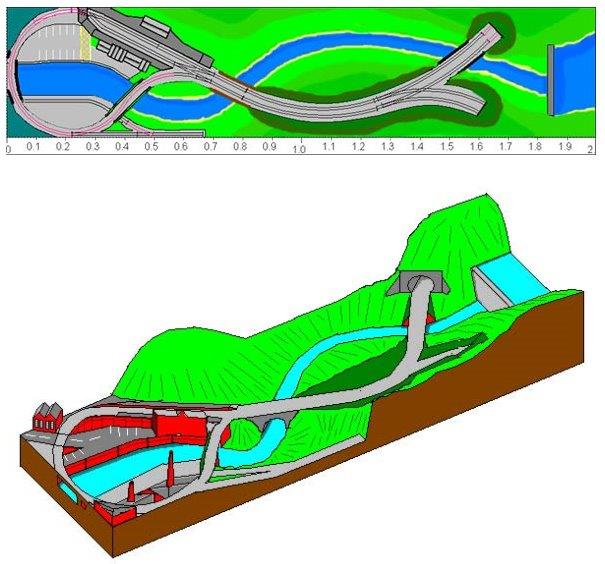

And now in 3D!RollEyes
I built a 1/10 scale model of the layout trackage (thus 1/870 so to speak).

Another iteration of the lower level, improving appearance and functionality of the return loops. Yes, there are actually two balloons on the lower level linking Union Station to three destinations: two on the same level and Rotten Pass at the long end on level 4. The narrowed track distances require careful track laying of the shadow station area curves...
RollEyes

Thank you. Below is the XTrackCad part list (which is indicative only since experience shows that needs change during actual construction) for all four levels: Should be roughly 30 m of track.
Wink

As pointed out earlier, the curves in the shadow station area are demanding, and only a hands-on test with coaches would show if it is really feasible to squeeze five circles in there. It is always possible to play tricks on the C track geometry, which is easier with parallel straight tracks than with parallel curved tracks.

#41 Posted : 03 July 2014 02:55:31(UTC)
Posts: 6,031

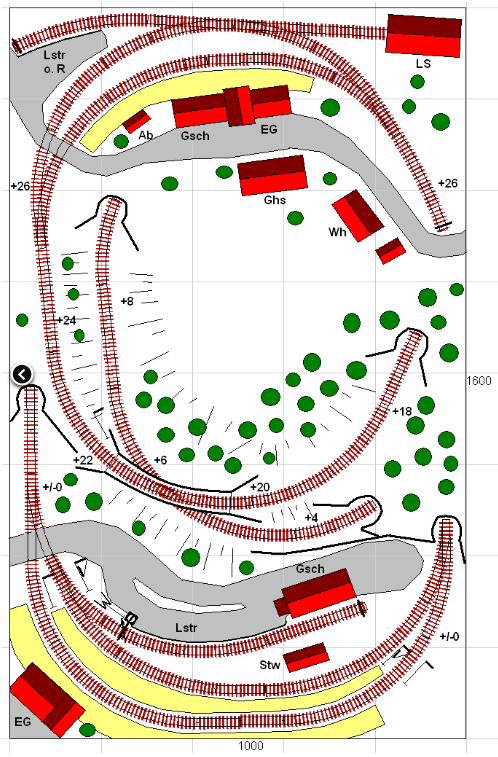

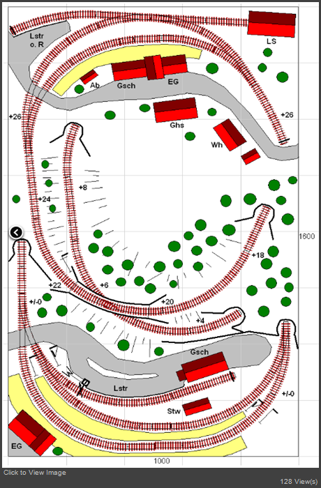

Now: Here comes the finalist. Shadow station "de-crowded", all turnouts accessible (at least from the side) without trouble, S-curves defused, no tight R1 curves in visible areas (graciously ignoring curved turnouts), tunnels minimized (following FD directive). It is a two-faced design, mainly for watching long train runs on the landscape side with the "Rotten Pass" towering over a deep valley as well as offering switching and shunting potential on the city side (working title: "Sam Diego"). Since there is a view block between both worlds, it is only possible to see either side. Therefore, there are two reverse loops on the lower level, so when working the station one has not to wait ages until a train returns from the mountain pass run (which cannot be supervised on the city side). On the other hand, when staying on the landscape side to guide a train during the mountain run, a train can safely return via the shadow station without any intervention, just reappearing without much delay near the creek at the valley bottom. I do not intend to automize operations. For ease of maintenance, the shadow station has open sides. The single track mountain pass tunnel and the double track sloped tunnel below the former can be reached by removing a low relief building on the city side. If I made up my mind, this would be the approach to be followed...
Blink Mellow Confused Bored Wink Woot
I attach the usual collection of plans (red = elevated):
1) lower levels;
2) upper levels;
3) all levels;
4) artist´s perception.
#42 Posted : 03 July 2014 02:58:55(UTC)

I detected a really cool compact (100 x 160 cm) multi-level layout plan for M* C track. It is a single track main line complete with visible station and hidden shadow station (three tracks) on the ground level plus a branch line climbing up to a small terminus on level 3 - quite a long run for a short train. Visually very attractive. The main line level is easy to construct, while the branch line is more demanding. Still it is possible to play on the ground level while the upper level and landscape construction is still under way.
Source (with track library):
http://www.moba-trickkis...p;total=353&start=21

This would be nice as a secondary layout where you can run all your small engines with short trains. The branch line is especially attractive, and I would love to have the space to include such a feature on mine, but in the space I have available it would cover up too much of my main line.

Another idea which I find aesthetically appealing: Long twisted bi-level mainline run without a single turnout. The N-scale layout is supposed to support two PC monitors placed inside the two circles, respectively.
http://www.moba-trickkis...mp;total=64&start=40
#48 Posted : 17 December 2014 13:18:38(UTC)
Posts: 6,031
And the final contribution (for today that is):
Actually not compact regarding the length - I reckon in HO scale it should be 3 m long - but conceptually interesting, an N-scale plan which is easy to construct with a lot of landscaping potential.
http://www.moba-trickkis...mp;total=64&start=42

Neither circle nor oval, but space saving design for "big time" shunting.
:o)

I like that idea, Ak. Any idea what sort of dimensions it would require?
I'm currently trying to come up with an overall layout plan/theme and shunting/freight operations would suit better than passenger or rural scenery. But space is limited and I will be using M-track. Would there would have to be an exit to a fiddle yard or shadow station?
