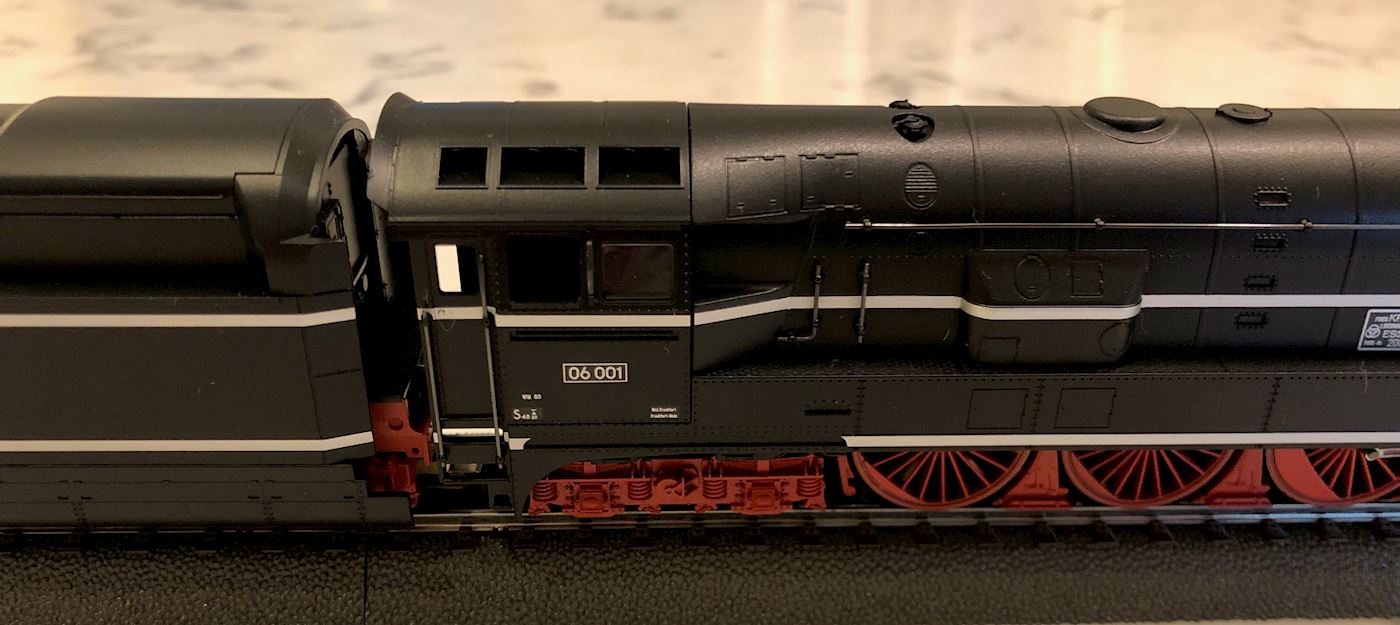

Is there any excusable and logical reason why the Märklin design of the BR 06 includes a removable engineer's cabin made of plastic (which leaves an unsightly gap against the metal body of the boiler), while the Brawa BR 06 comes with a solid body from boiler to cabin? - Go figure!Confused
Armando García
Offline dickinsonj
#79 Posted : 21 January 2023 02:06:54(UTC)
Joined: 05/12/2008(UTC)
Posts: 1,883
Location: Crozet, Virginia
Inquisitive mind...
I can see modeling the cab in plastic to reproduce even finer detail than the best metal castings do. I prefer metal loco bodies myself, but plastic looks great on the layout.
The bulk of the loco is metal, heavy and substantial, and nicely cast, with just that one plastic component, so I am quite happy with mine. I also do not have a detectable gap between the cab and boiler. It looks just like the panel seams cast into the main boiler body.
Maybe a production variance on some models?
[img]http://[/img]
Armando García
thanks 3 users liked this useful post by Armando
Offline dickinsonj
#81 Posted : 21 January 2023 15:39:02(UTC)
Posts: 1,883
Inquisitive mind...

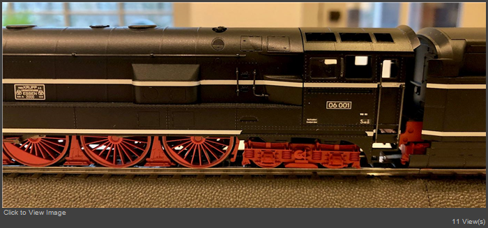

Hello Armando,
Looking through the critical eye of my phone camera I find that the gap in my BR 06 is similar to yours after all. My mistake.
You are correct that there is a visible gap between the plastic and metal parts, although it is within a tolerance that I can accept.
When viewed at the distance I normally view HO models, it still looks fine to me, but I can see what you object to.
It is not unreasonable to expect better from Märklin considering the cost of their top models.
Also, the tender shell on the Brawa model is made of metal.
Definitely, an astronomically expensive insider model which is not one from Märklin's top drawer.
That top drawer seems to be increasingly out of reach these days.
On the bright side, it is at least from a Märklin drawer and not made by another company. That may be the best we can hope for going forward. I am just glad that I have so many quality models and have cut way back on adding to them.

Marklin has been using plastic cabs for decades. The more times you remove them, the looser they fit, and the holding tabs can break off. If light doesn't show through the seam, I'd leave it alone. Otherwise, I'd try black tape around the inner cab sides. This one probably has screws.
This plastic cabin has no screws. It is pushed-on.
Is there any logical explanation why the cabin has to be a different piece made of plastic? I would understand it if this locomotive had been a standard BR 44 or BR 50, and Märklin would consider making many different issuances of them with different road numbers. But there were only 2 of BR 06. Possibly, the only logical explanation is that eventually they will come out with number 06 0002. So, economy of scale, at the expense of both aesthetics and quality.
