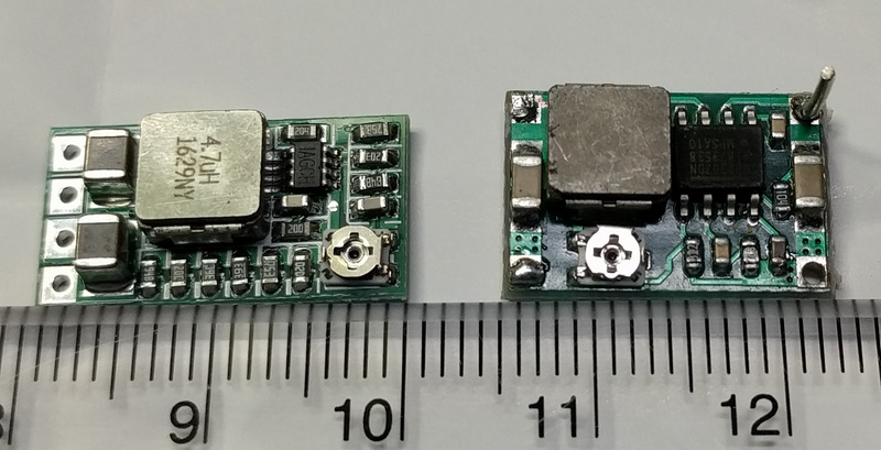

hi Dale,
I tested my regulators; input voltage 17.5V, output voltage 7.5V, without load. Below is the result:
MP 1584 drew 0.3 mA
Unkown chip (they erased the marking) drew 1.5 mA
MP 2307 drew 2 mA
MP 1484 drew 7 mA
Out of 10 MP2307s, I got one which drew 40 mA and very hot quickly. This is quality control problem; it use bad inductor. I replaced the inductor, and it drew 5 mA (still a bit higher because I don't have better inductor). The inductor is very important to the efficiency.
If your regulator drew more than 10mA without load, then most likely the inductor is low quality.
Buying from eBay is always hit-and-miss, look at the photo below; the regulator at the top (MP1584) use better quality inductor than the rest (it was also more expensive than the rest).

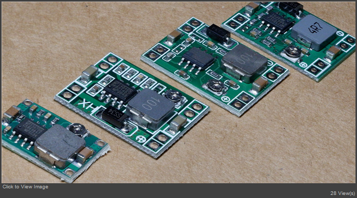

#162 Posted : 13 July 2019 04:40:24(UTC)
tiono
Joined: 09/02/2010(UTC)
Posts: 234
So I decided to see what replacements I could buy - how can one guess which are good and which are bad....
Impossible to know the quality just by looking on the photo. But you may see the telltale sign. The important component in switching regulator which manufacturer sometimes cut-corner to lower the cost; is the inductor. Therefore try to guess (from the photo) whether the inductor is crappy or good.
Inductor manufactured by well-established company usually has marking (value marking such as: 4R7, 100, 330, etc), the letters are crisp and clear, not blurry.
Also look at the molding of the casing, whether it is as good as Marklin's metal body locomotive, or looks rough (some of dirt-cheap inductor does not even use molding, but merely sandwiched with ceramic plates and resin filling). Those dirt-cheap inductors never pass any quality control, so the result will vary widely, like playing jackpot, if you're lucky, you may get excellent quality on very low price.
Look at the photo below. The inductors on three regulators on the left, were made by the same manufacturer, notice the sandwiched plates and same contact pin. These are cheap inductors. While the rightmost regulator use a good inductor, molded casing with crisp lettering. Those three regulators cost me less than $1 each, while the the good one cost me almost $2.
thanks 2 users liked this useful post by tiono

Offline tiono
#164 Posted : 13 July 2019 14:22:12(UTC)
tiono
Posts: 234
I have looked at the data sheets for the MP1584, MP2307 and MP2315, and any of these should work satisfactorily with no or minimum load, although the problem with these modules is probably that the module designers have worked on the basis of supplying maximum current (3A in all three cases) and used components best suited to that market. This may mean that the components are sub-optimal for very low currents (especially the inductor), not necessarily that the components are of low quality (although that can be a factor, especially for the capacitors).
Another problem is very likely the layout of the printed circuit board. This can have a considerable effect on how the converter works as there can be some significant switching currents going where you don't want them, even under no load, which can produce the sort of effects being described in this thread.
I purchased those cheap regulators from eBay. Whenever I got a regulator which became hot quickly and drew more than 10mA of idle current, then I replaced the inductor. It work fine then.

The 5 modules are in a single strip and each one can be separated easily with a bit of bending.
The inductors are marked: 4.7uH 1629NY
These modules are in fact even smaller than the MP2307 based mini DC-DC converters I initially tried.
(Drok on left and MP2307 on the right)
Test results
with 17.5 Volts input
no load 10V output (default as shipped): 0.79mA
no load 7.5V output: 0.71mA
12 LED strip 0.41mA load @ 7.49 Volts 1.25mA!
Those measurement match their consumption rating of 0.85mA plus the 0.4mA load -> 1.25mA
I have only tested one so far, but these, and the company, look like a winner!
We essentially have a solution that consumes about 0.5mA per lighted coach with an overhead of about 0.85mA per train!
Edit: these cost $8.99 for 5 from amazon.com and arrived in 2 days. So $1.80 cost per pickup shoe.

Finally you found a solution. Seems as the Droking regulator use MP2315 chip and good inductor (probably Vishay 4.7uH IHLP-4040ED-5A).
Can I conclude the following:
- buying cheap regulators from eBay most likely will get lower efficiency than it should.
- good regulator will not be the cheapest ( less than $1 from eBay versus more than $1 from Droking)
- good low voltage buck regulator shall draw idle current (without load) of less than 1mA (I have regulator module which consume only 0.3mA)
My personal standard:
< 1mA = good
1mA to 10mA = not so good but still usable
> 10mA = not good/low quality, will heat up quickly
well, I will purchase some from Droking as well.
