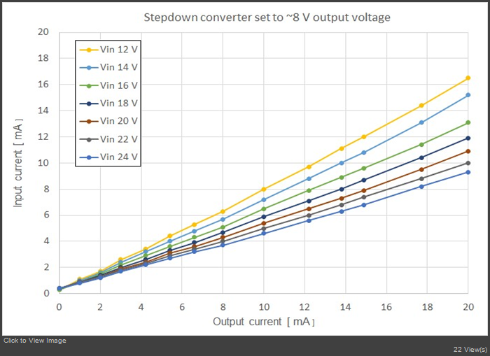

As the capacitor buffer is feeding input to the voltage regulator, is it the case that as the capacitor discharges to a certain point, the voltage regulator no longer can provide its requested output and shuts off the load effectively, thus not further discharging the capacitor, so when the power comes on again, the capacitor still has a some charge in it and thus needs much less current to top its charge off?
That would be my suspicion as well. I think if you measure the voltage across the capacitor at the point where it drops from 9mA to 0mA you will find the capacitor voltage is equal to the LED voltage at normal (or possibly slightly reduced) brightness. So once the LEDs stop conducting the capacitor is loosing minimal charge.

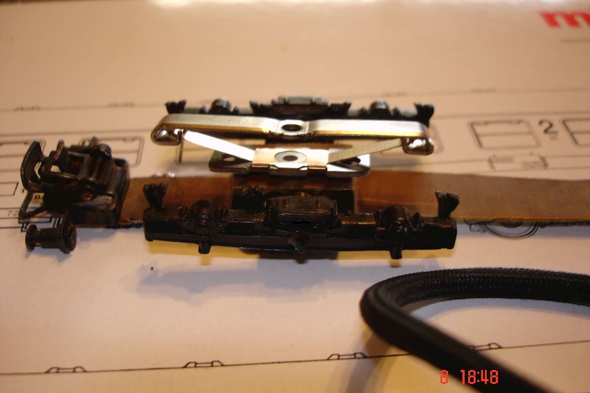

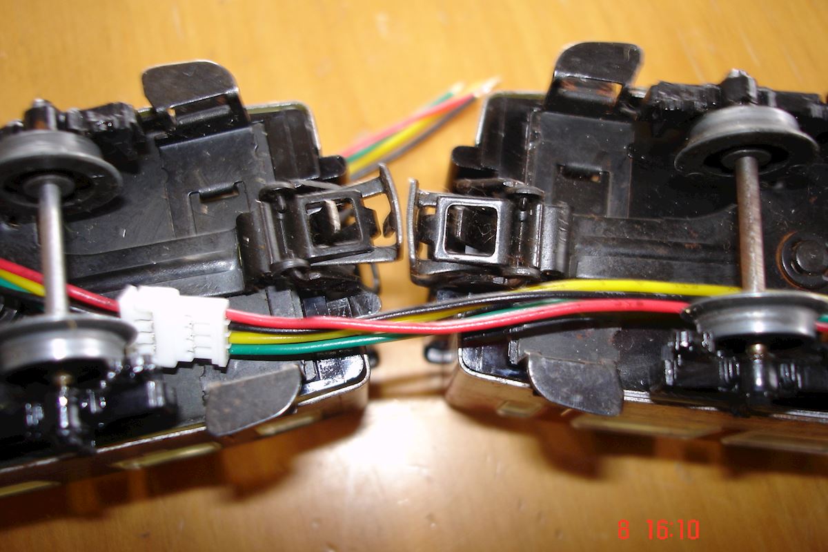

so, now I am turning my attention to very small plugs.
Ideally I want something that will allow them to be daisy chained so that the next coach, pickup, and flicker module can be plugged together as needed.
as small and flat as possible.
Something like this:
I am thinking it is best to run wires along the underside of each coach and run the wires to almost the middle of the next coach. Essentially creating a bus for teh power along the underside of the train. Anti-flicker modules and LED lights are then added as needed.
tiono has suggested the search "mini steckerset 2 polig" on Ebay but I looked on ebay.com and ebay.de and did not find them.
The Roco 40345 is an actual coupler and not what I am looking for either. Many of my old tin plate coaches do not even have NEM pockets.
Even the small JST plugs do not seem to daisy chain, so I may have to go for a 6 pole socket into which I insert 3 plugs, and connect the positive and negatives of teh 6 pole socket together....
or small solder pads on a small board.... perhaps with room for the pickup shoe diode....

How do you hope to allow for flexibility, especially with those tin plate carriages because they swing a long way sideways when changing direction. [ mind you, I do run M track ].
I also have a lot of analogue locos, and would like to be able to run something like this on either digital or analogue. One of my 280 trannys puts out 29 volt AC in the reversing pulse, and when converted through a bridge rectifier, steps up to nearly 50 volts. I presume then it would be better to have a master coach set up for digital and another set up for analogue.

Since I expect these installations to be pretty permanent, perhaps soldering onto a small board would actually be the simplest:
Imagine a tiny circuit single sided board like this:
(R1 and D1 to be positioned vertically next to C1)
This board can be used as follows:
1. Populated with C1, R1 and D1 as anti-flicker module, rightmost three pairs of solder pads cut off, supply wires soldered to remaining pair.
2. Populated with C1, R1 and D1 as anti-flicker module, rightmost two pairs of solder pads cut off, LED module soldered to one pair and supply wires soldered to remaining pair.
3. Unpopulated onnector board glued to underside of coach, allowing wires to be soldered on to pads from adjacent coach, previous coach, flicker module, LED module
4. Connector board glued to underside of coach, pickup shoe soldered to C1 positive, and D1 in place. Next coach, anti-flicker, and LED modules connected to solder pads.
In other words, a single multi-purpose board that can be cut down as needed. It would be very flexible in use. If there is lots of space, as in a baggage car, use one to handle the flicker and a nexus for all the connections. If space is limited, use just for the flicker module in the bathroom, and run wires from it and the LEDs to the underside to connect with each other, and power, etc.

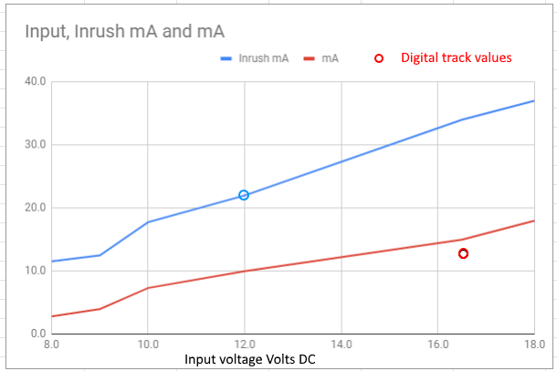

I measured the inrush and stable current draw at various input voltages.
The lines on this graph shows the inrush in blue and stable draw in mA.
The two circles represent the inrush and stable draw when using the digital track current (going through a single diode, so about 17.3V half wave)
On the workbench I cannot see the light output changing until I get below 4mA where it drops off rapidly. That is not to say that two coaches running at different levels wont look different from across the room though. I suspect they will look different.

Nice. It would be interesting to add a line to the graph with its own axis that depicts for the various voltages how many milliseconds of light is produced when you pull the carriage from the power supply.

While waiting for various new bits to arrive, I have been playing around with the physical side. Mainly with the 24 mm coaches. The connectors I mentioned above are not too big, and if the leads are placed in the bogies above the axles, and feed along one side of the couplings, then the movement is not too great, especially when the wires feed up through the floor, are bent towards the end of the coach. The wires are not so obvious either. I used a pair of 5 wire couplings which i had, to do the experiment. I haven't looked at coaches with the close couplers yet as i think that would be a bit different.
Some time ago I worked out how to fit LED's into an analogue loco using micro a bridge rectifier and micro CCR.[ they were so tiny you could get 15-20 of them onto your little finger nail and nearly needed a microscope to read the polarity]. It worked, with the exception of a reversing switch for the lights. I have to fiddle around using a mechanical mechanism working off the reverse switch and that is not an easily reproduced in the tiny space available on that 3080 Loco.
The other thing I have been pondering, is if two pickup shoes were used on the master carriage, would that reduce the flicker effect.
Dereck

#127
Posted :
08 June 2019 06:20:15(UTC)
Retweet
Joined: 20/01/2015(UTC)
Posts: 1,205
Location: Kerikeri
Hope you mean these.
I haven't worked out how to fasten the wires to the bogies yet but I don't think that will be difficult.
I did have a look at some of the later close coupled, 8 wheeler couches but think I will leave them alone at this stage. I couldn't get the body off the frame without putting too much force on the middle area so left them alone. I'll stick with the older metal ones for now.
My design for securing pickup shoes to the bogies. Solid fixing and reliable.

#128
Posted :
08 June 2019 19:23:43(UTC)
Retweet
Posts: 4,049
Thanks for the pics.
I am hoping to use smaller wires, and I only need two.
Can the plug be seen from the side when on track?

Posted :
09 June 2019 00:35:34(UTC)
Retweet
Posts: 1,205
Location: Kerikeri
If the connector is secured between the wheels it wont be seen. Also, those wires don't stand out unless you get really close [The carriages are quite close together.] so I would suggest running both wires on the same side. Just make sure you leave enough for when they are "stretched " to their utmost. I would even allow a little movement in the wires in the next bogie and after they come through the hole in the carriage, bend them towards the end of the carriage and allow them to be free. Those wires aren't too big, and if you are concerned about flexibility, you will see that there is not a lot of movement when set up properly.. If you buy the same ones I am getting, they come with the wires attached. Save unnecessary work. I used those 4 wires as an example as I didn't have a 2 wire set. Making a couple of little brackets to hold the wires in each bogie might be tricky Dereck

Posted :
07 July 2019 20:40:34(UTC)
Retweet
Posts: 4,049
quick update:
I had an electronics friend visit for the weekend and I showed him the project. I had to start with explaining what DCC power is like and what the requirements were, but we soon got to testing my circuit and as simpler one.
The main takeaway, so far, is that the DC-DC converter is using about 15mA.
The strip of 12 LEDs arranged in 4 sets of triplets is using 1mA at 7.5 V
The DC-DC converter does a very good job at maintaining the brightness of the LEDs during short power losses as it maintains the 7.5V output very well, (but is its using 93% of the power).
We did come up with a circuit with almost no significant inrush current, (without the DC-DC converter), but the LEDs dim noticeably during power interruptions, so out next step is to look for a small modern voltage regulator that supplies 7.5 to 8V at very low output currents (< 10mA). This would allow a bunch of coaches to be powered with a single pickup shoe, and one anti-flicker module.
My current layout:
https://cabin-layout.mixmox.com
Arrival and Departure signs:
https://remotesign.mixmox.com
WWW
BLOG
User Profile
View All Posts by User
View Thanks
tiono
#131
Posted :
08 July 2019 03:56:32(UTC)
Retweet
Joined: 09/02/2010(UTC)
Posts: 234
Are you using MP2307 chip ?
The datasheet said; maximum idle current is 1.5mA (not 15mA) without load. Probably your measurement was incorrect.
If your LED consume only 1mA at 7.5V, may be a linear current regulator will be a better option.
Example of 1mA current regulator diode is: 1N5299UR or 1N5298UR
This is a small CCR (the same size as 1A diode), max voltage is 100V, max dissipation is 0.5W
Assuming the voltage after rectifier is 18V, the LED need 7.5V, then the CCR will drop 10.5V and dissipating 0.01W
Total power consumption, including the LED, will be = 18 * 0.001 = 0.0018 watt
Of course this is assuming your measurement is correct that the LED consume only 1mA.

Your DC-DC converter looks strange. I have one similar based on the MP1584 IC (bought from Amazon) and input current without load is less than 1 mA.
User Profile
View Thanks
now that my meter fuse has arrived, I will also measure a second one, and at different loads.
You should get something like this. Maybe not the same stepdown but likely similar

#149
Posted :
10 July 2019 21:34:24(UTC)
Retweet
Posts: 4,049
perhaps we are not talking about the same thing...
your graph is input mA vs output mA and looks logical.
I am talking about the actual
consumption
of the DC-DC converter, not its input current and I am not sure if that is the same thing. As I see it, if I connect the DC-DC converter to a power supply, its available current is only limited by the power supply. If that supply could only supply say 10mA at 12V, the DC-DC converter could put out 12mA and 8 Volts.
I am measuring the total current drawn by the DC-DC converter and its load of 1mA. Input current available is many Amps.
