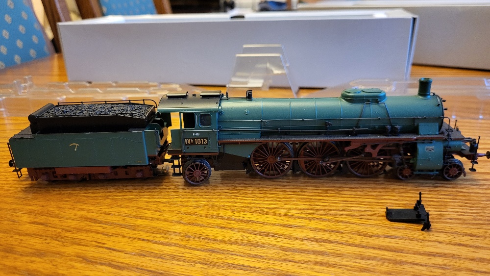

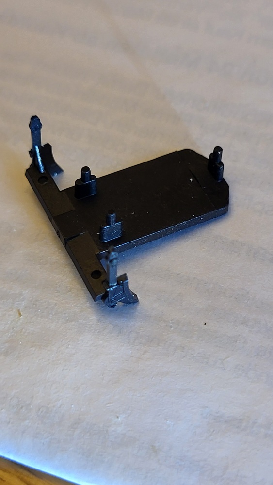

Today the box arrived with this lovely model (# 39022). The model is in a near mint condition, however, I found this piece of plastic and I can't find where it came from. Any idea?

Underneath, somewhere. Or maybe a firebox moulding/fitting in the cab?
Puzzled as you are,
Osoraku

Somewhere under the loco, I think under the wheels under the cab Cool
I'm 99% sure the two "half-moons" are brake shoes Cool

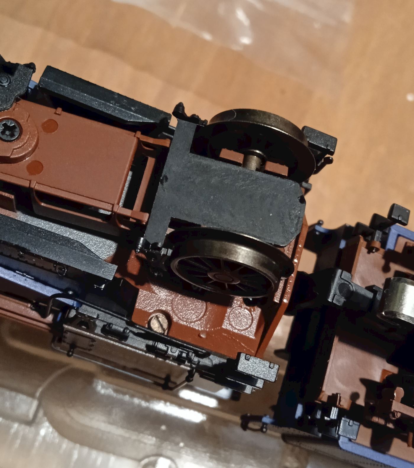

The 39022 Operation Manual (p. 29) on the M site shows an underside view which has an outline like this part underneath the rear-most wheelset. Like Purellum suggested, it's likely the brake shoes. The image of the lok on the M site shows shoes on the front side of those wheels while the image in Ben's post doesn't seem to have them.
Good luck!
Brian
thanks 2 users liked this useful post by ccranium

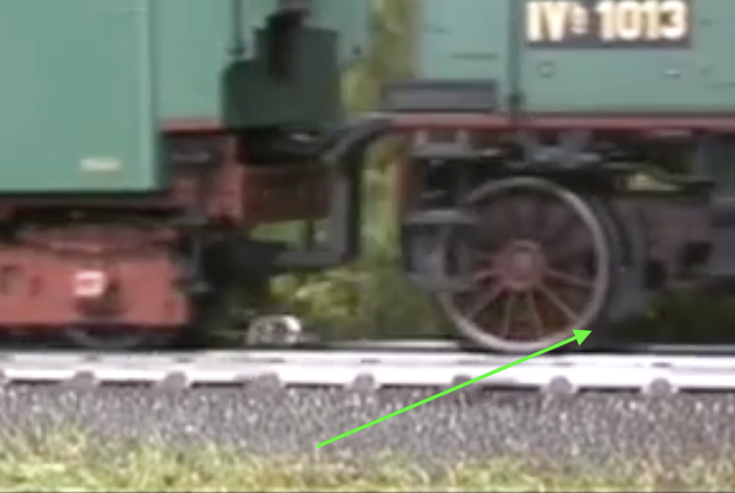

My guess is that the part comes from the trailing wheel under the cab, which should have a brake shoe on the forward side. The piece should pop in under the trailing wheel as can be seen in this screenshot from Brunellorosso's video.
Video here:

Can you turn your locomotive upside down?

Please note your loco was 39021 blue livery (39022 green livery) Both are same number on cab side.

Thank you, I was looking at the front and couldn't understand what is going on.
Video here:
Thank you. I guess that you are correct.
