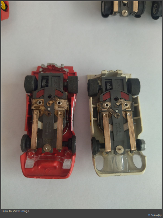

All work well with 12v/4A DC power adapter(regular use each car on separate tracks).
Can 12v/2A will be enough too?
Also next questions-any recommend site for spare parts?
I have these cars that had drifting effect when try to run and of course they don't run.Only spin the back wheels on place.
I don't know even the models/types of the cars/chassis.
Video:
https://www.youtube.com/shorts/tukXO2ia8tM

#6 Posted : 19 April 2025 19:41:28(UTC)
Posts: 3,688
From what I see on your video, tires and sliders need replacing (Tire gum is hardened, sliders have grooves)
By serach "Faller AMS ersatzteile" I found this
https://slotcar-online-s...e/faller-ams-repro-teile
Probably you may find more as there are many Faller AMS enthusiasts in Germany
