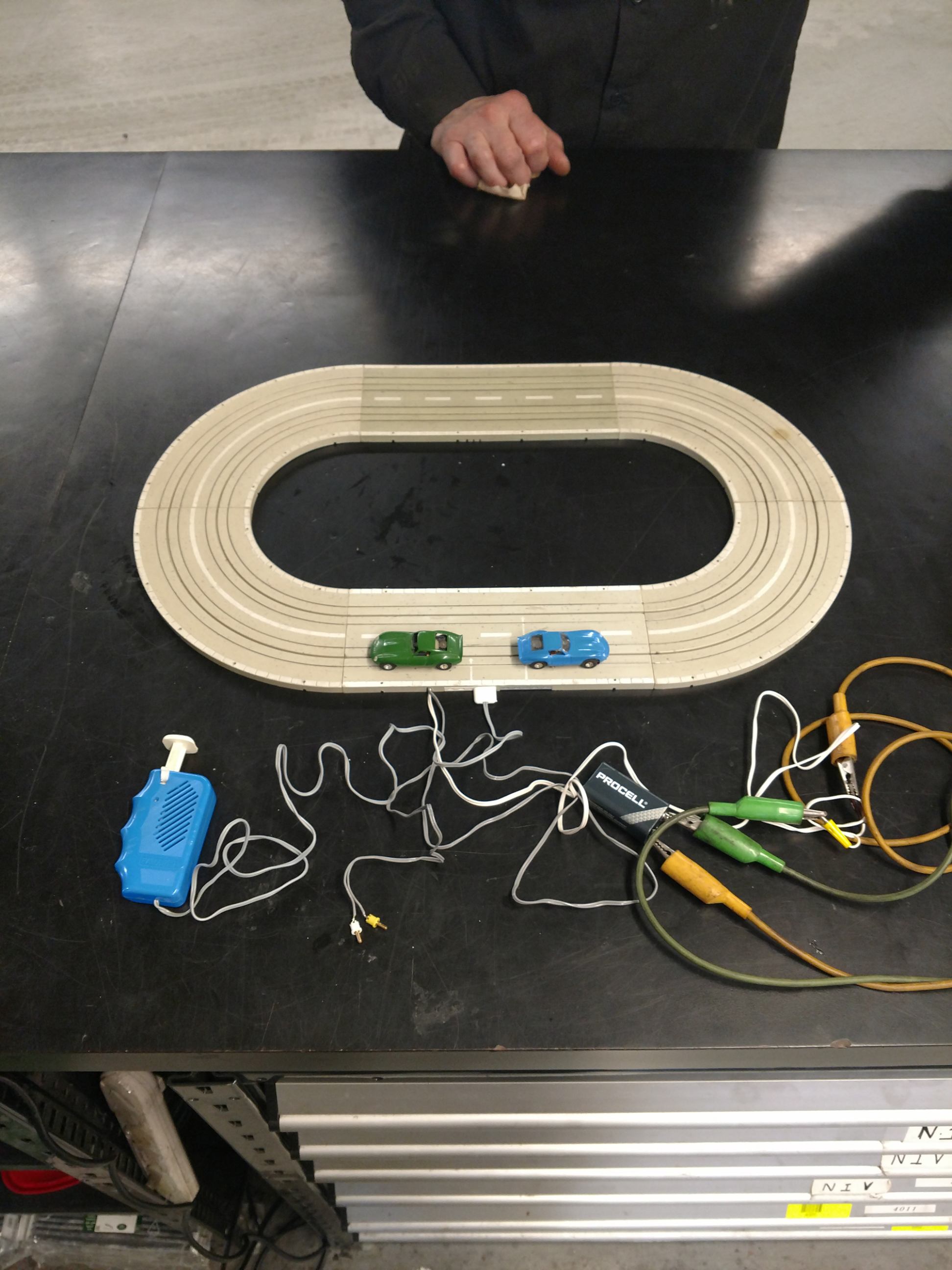

I set up a small test track and ran it both on 9 volts and the 6016 on DC. The two cars run n opposite directions only and nothing else happens when switching the polarity on either power source.
I still need to get the one that goes in reverse to work more reliably. So further news will be coming on that one. Please see the attached pictures.
Thanks for all the help!!!

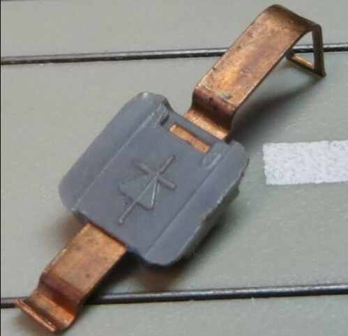

What is and what purpose is the little disc on some of the cars?
And what are the two electronic items on the feeder track?
Thanks all, Lance

The disk I suppose is a rectifier to be used when AC is used to control 2 cars on the same track.
The rectifier is I think selenium and can be either a disk to be inserted in the Block motors or with a slider to be used also with flat motors
The rectifier is only to be used when 2 cars are needed on the same track, one car uses the negative part of the AC current and the other one the positive side
The speed controllers must be fed in all cases with DC current.
The rest is explained on the Faller AMS Post 2 Technik which I have but in German language
The components under the feeder track are noise suppressors (capacitors) to reduce noise on non-cable TV

Wiring diagram from 1967 catalogue...
4702 track with Power Input
Sorry, I mean to comment on this also, the little disc is the interference suppressor for Radio & TV. Not probably much of an issue these days with modern tech because they usually filter out anyway but anything that sparks can cause issues.
Interesting I note it was not referenced on the exploded view for some reason, shown but not described.
Hope this clarifies
And I already answered via Jean's post re the selenium rectifier plates built into the track section.
FALLER did attempt to make this somewhat clear with some little details that are easy to miss.
1: The guide pins come in a variety of colours. Black & White, Red & Green. Some also have a small pointer. Red & Green point opposite directions.
2: The magnets are coloured. Black and Red for earlier versions, then Green and Red later on. You must match them correctly.
3: Some chassis versions have a small hole underneath through which the magnet colour can be easily seen.
So, in theory, by simply turning the car over, you can see just by the pickup which track and direction it 'should' run.
Note also that FALLER had two very distinct types of operation;
RACING and TRAFFIC
Racing is obvious, and is what most people expect upon seeing a slot-car. Two or more vehicles, driving side-by-side, independent control, may the best man win!!
Cars designed for racing have a gear ratio to match.
Traffic on the other hand is primarily for model-railways, although if it quite possible to build an elaborate city or suburban scene with no railway and the cars are the focus.
Either way, the aim with Traffic operation is to be running in opposing directions but still with independent control.
And... at much slower speeds so the chassis for Traffic operation have a lower gear ratio. Cars with Racing chassis simply cannot run smoothly at slow speeds.
And and.... some cars are also designed to be able to run backwards in the Traffic mode.
So you have to determine which is the default direction your cars are set to, and which you prefer to run. Some simply run better than others
And just when you thought you had it nailed !!

If you turn the square selenium plates on the cars upside down does it run in the opposite way?
How did the selenium chips on the track work?
Lance

Reversing the selenium plate will not change the direction. What it changes is which cycle of the AC wave is allowed through (or blocked) - both mean much the same thing.
This is explained in the previous attached pages, specifically the "Half Wave Principle"
Maybe easiest if you break a chassis down to the most basic form, a simple DC motor. Fortunately, that is easy. Just remove the Selenium plate. But be sure that the contacts which were separated by the plate are now actually touching.
I'm also assuming the chassis does not have any of the pickups with the built-in selenium plate fitted (you showed a photo of one in an earlier post)
Your DC power source (Battery or Trafo) will have + and - terminals. Connecting these to the pickups will make the motor run one direction. Now reverse those wires, the motor will run the opposite direction.
If you have the power source connected so that the chassis runs forward, there is one other way you can make it tun in reverse without swapping the connection polarity - swap the magnets! As easy as that.
For the purposes of this discussion, it might be easiest to decide to let the magnet placement determine which direction the vehicle will run. And that's all fine and simple, and would work very well.
But it has one limitation, and that's to do with the way FALLER wire their track feeders.
Some feeder tracks have a pair of wires for each line, and the lanes are electrically separated. But, earlier track made the two inside rails of each lane to be common. Why this is important is because of the so-called 'squeeze' or bottle-neck track section. This has one lane avoiding a small moulded 'roadwork' area. It's a novelty piece, but by design the two inside rails are in contact at the closest point. I only mention this because if you have this track section, but want to have totally electrically isolated lanes, you're out of luck. It's one or the other. But if you don't have the squeeze section, it won't matter.
Where I can, I will generally refer to the most recent design system, and note as required if there is anything for older systems that should be taken into account.
Ok, back to the vehicle direction. If you want to run all you cars on DC, then you can simply ditch the selenium plates altogether, one controller per track, DC source power, very simple.
Any vehicle that runs in the wrong direction is probably better to open up, and reverse the magnets. But if you prefer not to do this, you can just keep note of which vehicle/s run backwards and reverse the wiring polarity instead.
On the other hand, if you want to run the cars off AC, then you will need to install the selenium plate. It really depends what you want to do with the setup, either traditional slot-car racing or included into a model railway.
Going back to how AC works, here's a very rough description. The current alternates 50 times a second (for 50Hz countries). Therefore the output from the Trafo on the Brown and Yellow wires is 'positive' half of the time, and negative the other half. This is why a DC motor will just hum or buzz on AC, it's working, but is changing direction 50 times a second. Using the selenium plate prevents one half of the current getting through, so the motor sees it as very much like DC (purists and electrical engineers will jump all over this but it's very simplified).
With the selenium plate installed one way round, the vehicle might respond to the 'positive' half cycle. But by simply flipping the selenium plate over, it will now respond to the 'negative' half-cycle. Do not confuse this with Polarity, they are not the same thing, but each can affect the other.
You asked about the selenium plates in the track? - this is one thing to watch for. In the original design, there is normally a selenium plate in each vehicle, and one in each controller. Later designs did away with them in the controller, especially the hand-throttle types you have so the 'control' selenium plate was incorporated into the track instead.
For the half-wave system to work fully as designed, you need a selenium plate for each track lane, and a corresponding one in each vehicle.
Phew, it's real easy to demonstrate one on one, but a written explanation needs a lot of words, or simple diagrams, such as those I posted previously
Does this make any sense? Have I over-explained, or missed something out?
Please keep asking, there is no such thing as a dumb question. Some people get it right away, others get it when explained in a different way but experimentation with your setup is probably the fastest way to learn, just makes notes if anything you change so you can follow the cause and effect.

Reversing the selenium plate will not change the direction.What it changes is which cycle of the AC wave is allowed through (or blocked) - both mean much the same thing.
Hi Cookee and all
Reversing the SIDE (not the orientation) of the selenium plate, will force the motor to use the other half of the AC current BUT by doing so the DC motor will turn in the other direction so, depending on the motor type (flat or Block) the magnets will have to be swapped between each other, or the motor must be removed , rotated 180° on its axis and then re-inserted into place.
Those selenium rectifiers were the rage during the 50s and early 60s past which Germanium and Silicon diodes (1N4007 and the like) were ubiquitous
