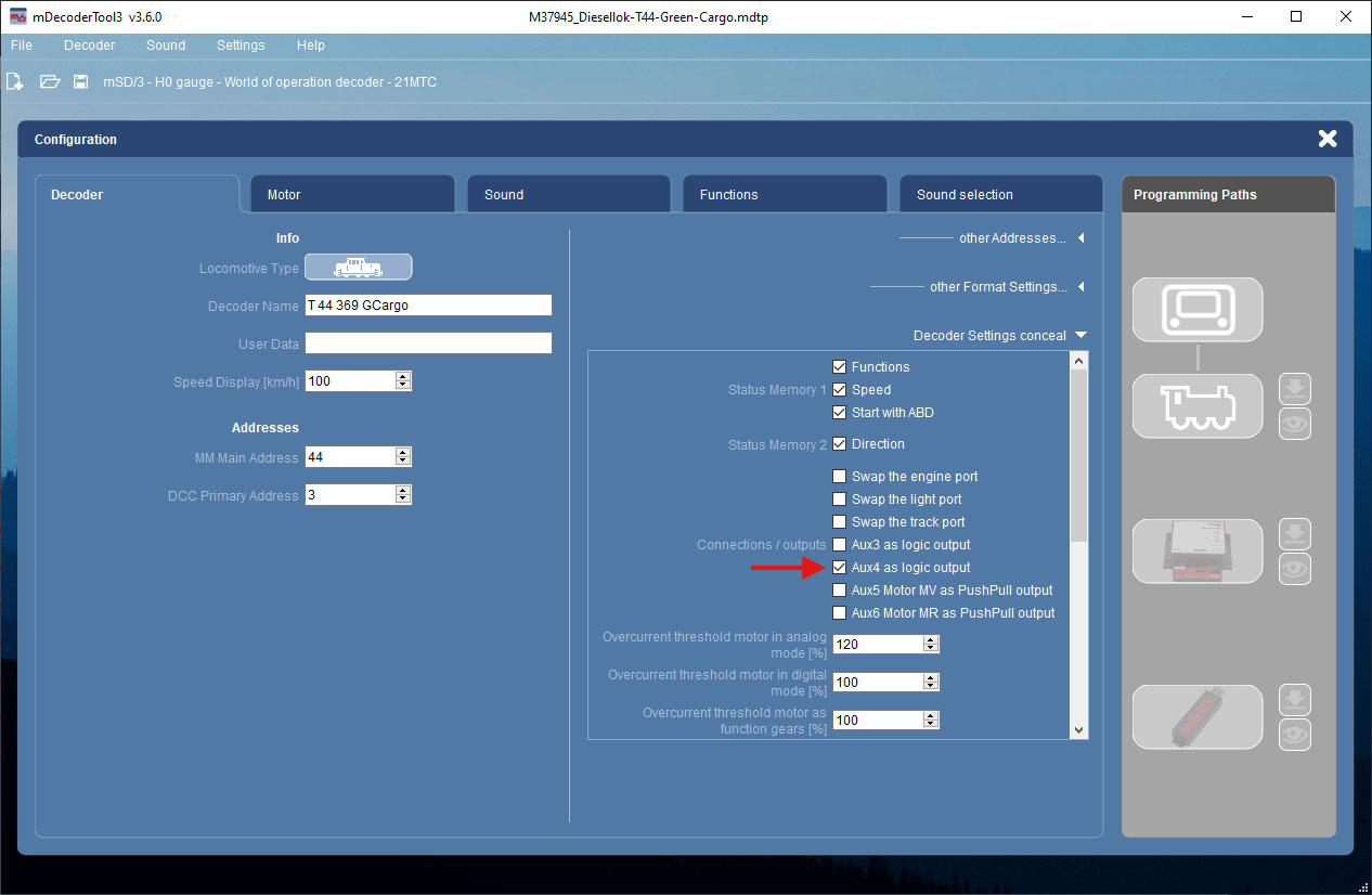

Remember that all engines like 441 002-3 HR "Croft" Art. 39894 doesn't us both AUX3 and AUX4 for C-Sinus motor....
This one has its High beam light on AUX3 and C-Sinus only on AUX4... original assembled decoder was LP V.3.0 M4 21MTC with sound modul in the old good days Huh
Decoder: Märklin mSD3 21MTC Art. 60975 (sound project M39867_BR189-RRF.mdtp)
Speaker: Märklin 20mm 100 ohm Art. E100622
thanks 2 users liked this useful post by jonas_sthlm

Yes its need to have logic output or use mSD3 then you can decide... so in the old days M4 and now MKL.
I am using AUX3 for cabin light and on some other T44 telex....
Remember the both side telex needs to be connected in series on AUX3.
thanks 3 users liked this useful post by jonas_sthlm

Regarding logic and Aux 3 and 4. I set them to be logic functions under "function mapping" with the Lokprogrammer and active as this in the following states:
Stop,Forward - Stop, Reverse - Drive, Forward and Drive, Reverse. So hopefully the Sine controller is safe. Wink

The Lokprogrammer takes care of assigning AUX 3 and 4 as logic state AUX-es. So you don´t have to know the exact CV´s.
I have used an MKL decoder already with great success, so I guess I´ll be fine. We´ll see.

39894 (2008/2009) 441 002-3 HR "Croft" - logic outputs needs even for AUX3 to get the high beam to work
37940 (2008/2009) T44 - needs only logic outputs on AUX4 and AUX3 is free to use
37941 (2009/2010) T44 - needs only logic outputs on AUX4 and AUX3 is free to use
37943 (2014/2015) T44 - needs only logic outputs on AUX4 and AUX3 is free to use (M replace PCB and motor after this model)
Perhaps there is a reason why they chose to make it possible to have different settings on the outputs in mSD3 decoders.
Its 14 years ago sense I replace my first T44 for ESU LS4 M4 but now all has got mSD3 decoder....
