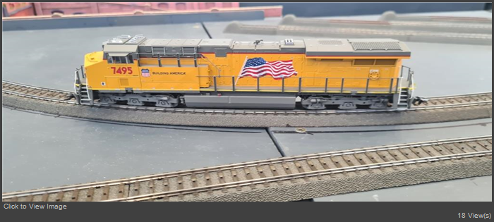

Hi all!
There are alot of negative posts about these models.
I received my 38441 the other day. I've only tried it this morning and found out that my unit gets stuck in a normal R2 K track right hand turnout. It only gets stuck riding the cab front to the turnout and running on the switched track. The surface isn't perfect supported. I will investigate but I have a guess that it's the pick-up shoe getting stuck in the rail. Maybe it's too much tension in the pick-up shoe.
It works fine when turning the loco running backwards and no problems at the other right-hand switch.
It works perfectly on my K track slim turnouts, even 4-way. I will do more testing.
The same setup with perfect flatness and also next step is with lanterns and also catenary.
The model is huge compared to German models. It's almost as long as the Big Boy without the tender and the front.
In the picture attached with the normal R2 turnouts is the switch in the middle that the loco gets stuck at.
thanks 3 users liked this useful post by klarinettmeister

I've had 38440 for several weeks now, and 38441 arrived yesterday.
I've ran 38440 around a friend's layout which has many turnouts and curved turnouts and the loco ran with no problems. Two weeks ago we had our Railex exhibition to which we took our Club's H0 modular layout. Unfortunately the loco didn't get very far around the layout but not because of track issues but because someone built a module with a low hanging arch bridge (a non Marklin one) which the loco could not get through through being too tall for the bridge!
It was relegated to yard duties driving between a storage yard and turntable module, which consists of lots of turnouts and a few 3 way turnouts. It traversed everything fine all weekend with no issues.
Shot of the yard part of the layout
thanks 6 users liked this useful post by Bigdaddynz
