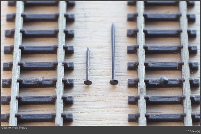

Location: Sydney
The Marklin nail is 0.55mm x 8.5mm 1.25mm head ∅. The Peco nail is 0.60mm x 14mm 1.5mm head ∅.
The Peco nail head does look a touch large on the sleeper, but it is acceptable.
Pre push a nail through the sleeper hole with the sleeper pre warmed in your hand, as holes are a bit tight, or at least warm up a touch with hair dryer, you don't need to over do the heating. If you need holes in other sleepers pre-drill with 0.5mm drill bit in a pin vise.
Because the Peco nail is so long, if you need push it into a timber base you will need to pre-drill holes or you will end up bending a few nails & breaking sleepers getting them in. You don't need the nails in so tight like a masonry anchor.
You can cut them shorter, but file or Dremel a point.
P.S. What gradient do have at the back. If you raise all the track a bit, then lower the lower rear track to split the gradient between the upper and lower level. Any gradient more than 2.5% will give you headaches later on. Just avoid it like the plague.

Marklin nail left, Peco nail right.
I have a few old Marklin nails and they were 5.5mm long. Depending how tough the timer is, a 0.4mm pilot hole for the Marklin nail will help.
Also use a nail punch, trying to hit the nail directly will cause you not to hit it square.
