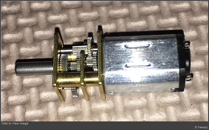

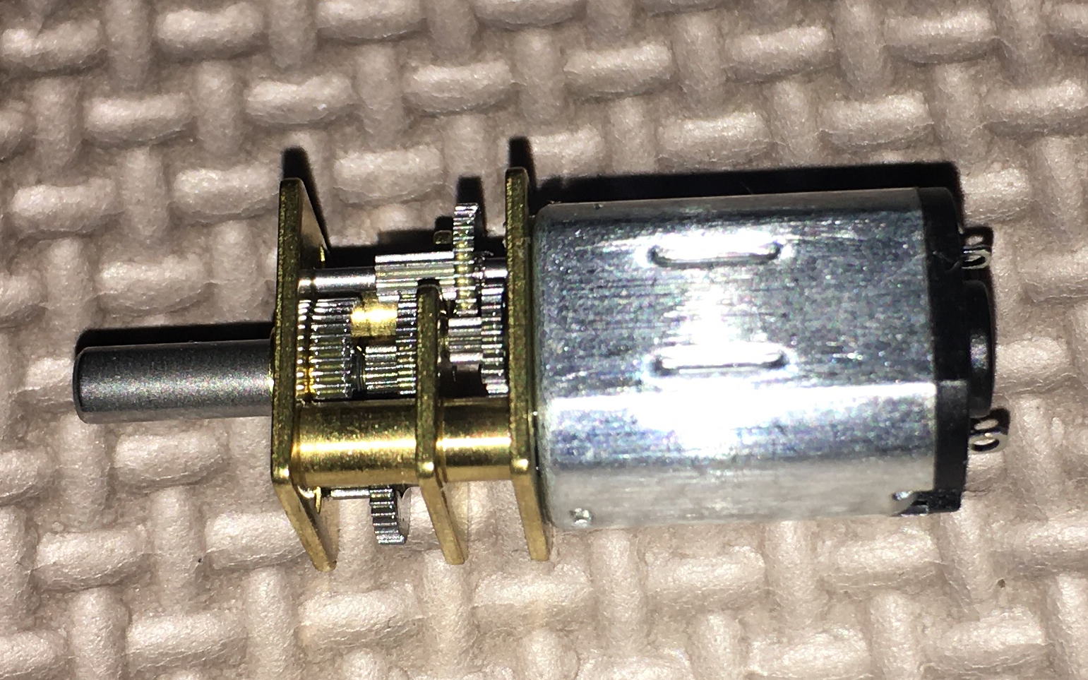

#3 Posted : 23 January 2022 14:51:07(UTC)
Posts: 3,694
Hi Peter
You may find it easier to fit DC motors like the Faller 180722 https://www.faller.de/de/de/Prod...cm.at/Getriebemotor.html
I purchased mine in China for less than 5 Euros
Here is one https://www.ebay.de/itm/18439516...ef1be:g:k0EAAOSwYh5hwFie
Total length of 35 mm (including the axle), 4 mm Diameter axle, start rotating at 6 V, powerful
Unlike with a servo, you can use the motor axle directly to fit to the crane cabin.
With a servo you need to construct a solid and low friction axle for the cabin. Then all is simple but most servos are rotating only 90° with little torque.
Here is an example of the implementation on a bridge to stop and direct traffic on a Car System using 2 servos. Video of the underside of the bridge. Control using an ESU SwitchPilot 3 Servo

Yes such an engine would fit well, the question is what speed to choose I thought in that case 20 rpm or lower rpm for rotation of the crane, i found Dc engine on Aliexpress
Hi Peter
