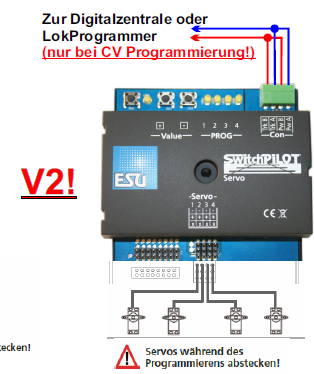

I only have LokProgrammer and ESU Switchpilot Servo connected together but when I have to test servo in Drivers cab
and then select the turnout control panel and set the correct switch address and switch number and then press GO,
but nothing happens when I press A or B I can read and write CV.
I have an AC adapter connected to LokProgrammer
What am I doing wrong
Regards Peter

Have you looped the lokprogrammer wires in parallel on the switchpilot servo from the 2 digital input wires to the 2 power feed inputs so that all 4 terminals are connected?
Ie. the switchpilot servo has 4 connections- 2 wires for digital input and 2 wires for power. You have connected from lokprogrammer to the digital inputs which lets you read/write to the switchpilot but for the motor to activate you need to loop the digital input to the power feed as well (lokprogrammer to power the servo too)

Hello
Thanks for your help it works now, I found this
