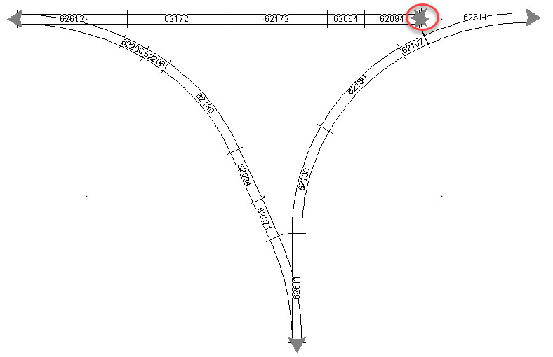

I'm using SCARM software for planning an HO Trix C-track layout which would include a wye configuration to turn entire trains. Repeated attempts with the currently available Trix trackage utilized by that software's database have left me utterly frustrated and convinced that such an arrangement is impossible. The attached file depicts the closest I've come to achieving my objective [there is a gap measuring "only" about 0.4 inch (10 mm) between roughly aligned sections #62115 and #62224].
If this is indeed the best possible arrangement would it be feasible for me to consider bending/forcing those two track sections together?attempted wye configuration.jpg

I do not use SCARM but your image appears to show an ignorance of the 62206 (5.7 degree) make-up piece that is used to bring the 24.3 into a modular 30 degrees.
the most basic Wye would be ...

Thank you so much attempted wye configuration 2.jpgregarding use of a #62206 curved section, which I utilized in my latest attempt to create a wye having just straight track along the top side. However, I still can't find the proper section that will close a gap between a #62064 section and a #62611 turnout [see attached file]. What's your suggestion?

Thanks! The configuration depicted in your second image- -all straight track across the top with two slightly curved legs below- -will work out fine in my planned layout.
I'm baffled; look at the first image you provided. The track section in the left leg located between the #24071 straight and the #24611 turnout appears to be 064 [this number is partially overwritten by 24130 in the right leg of the wye]. That's the abbreviation for #24064, the Marklin equivalent which has the same length as the Trix #62064 section in my last SCARM drawing. Every other track item is identical...yet the left leg of my wye won't close! That said, I spotted something rather "curious" in your first image: The #24064 section located in the top leg of the wye is actually shorter than its assumed counterpart in the left leg. Could the person who drew this image have inadvertently mislabeled the latter piece of track? If that is indeed correct, then this configuration cannot be put together as shown.

.... something rather "curious" in your first image: The #24064 section located in the top leg of the wye is actually shorter than its assumed counterpart in the left leg. Could the person who drew this image have inadvertently mislabeled the latter piece of track? If that is indeed correct, then this configuration cannot be put together as shown.
Hi Bob,
At least you have something to work on.
Is the "longer"piece an 094, not 064? I am sure that is the problem.
I have never actually tried installing the first two images. I did the last one OK.
If you discover what is mis-printed I would appreciate knowing about it.

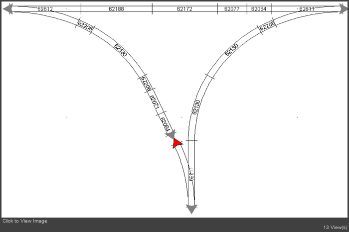

Very interesting, Kimball...because when I implemented your changes, the resultant SCARM-generated drawing shows both a gap and a misalignment between the curved 206 section and the 611 turnout [see attached image].
The reliability of- -i.e., how close to reality- -any computer simulation output is a direct reflection of its inputs [GIGO- -garbage in, garbage out]. One cannot deny that the "real-life" configuration you assembled works. Therefore SCARM's computational and/or drawing algorithm must contain a "glitch" that enables it to indicate perfect track loop closure for my proposed Trix/Marklin wye configuration.
Did you try laying out my proposed track configuration; if you did, how well did the tracks close and line up throughout the entire loop?

Kimball,
Just for the heck of it, I placed the two left-leg 206 curves together in my SCARM-generated configuration per your assembly variation noted above. I agree, this change should not alter the leg [and other configuration] geometry. Oh but it sure did: As shown in the attached image, a gap/misalignment is now present between the top-leg 904 straight and the 611 turnout. This result provides- -at least to me- -incontrovertible proof that a SCARM algorithm and/or input parameter(s) is/are incorrect; indeed, you very well could be right about the criticality of how precisely the track angle is specified.
I'd like to document the new, track-tested wye configuration you helped determine in a new Forum post and credit you for your effort. Are you OK with that? I'd also be willing to notify the SCARM development team of these findings so they could modify their software to prevent the type of "false-positive" track loop closure we uncovered [there also may be others not yet found].

Hi Bob,
That is all fine with me, it adds to the knowledge base.
But just noticed your latest diagram retains the old errors. Make sure to change upper right 107 to 206.
And change lower left 071 to 077.
Regards placement of the 206 peices, I figured either end of the 130 position is sort of more symmetrical and in a way a slight transition.
Hi Bob,
Thanks for catching the above-noted two errors, Kimball. Please verify that the drawing shown below is the configuration you assembled. Unless I can make my own drawing [using Word or some other software], I'll post this SCARM version with a caveat to ignore the encircled track mismatch.
BobG100
#19 Posted : 15 June 2020 01:16:30(UTC)
Posts: 6,775
Hi Bob,
Yes your last SCARM drawing is how I assembled the Wye.
Have a good evening.
