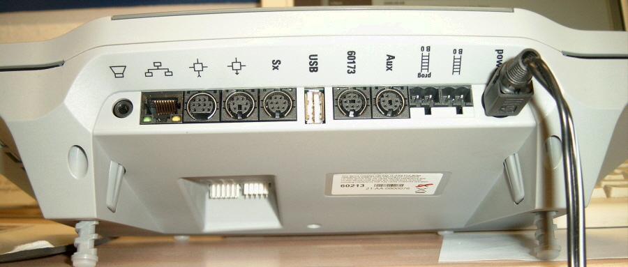

Hi guysCool
this is the back of my 60215:
Output 60173: the connection of my booster refuses to enter it
The pdf of the 60175 says something quite different: another output than the 60173 but the symbols don't seem to be identical but I think the output to use is the one immediately after that of Network Pc
exit 60215 for 60175.pdf (226kb) downloaded 54 time(s).
Or it is necessary to use a special connection for the 60173 output and the 60175 cable ???
I repeat, my cable 60175 does not enter
Thank you

Hi, Serge!
Count the pins. Do pins and pin layout match?
Maybe you have to use more force - but do this only when pins and holes match exactly.

Hi, Serge!
The CS3 uses a symbol where the CS2 had the text "60173" or "6017x". But in both cases these are the same 7-pin sockets.
Thank you Tom Cool
You need an explanation of what I did:
I have 2 x 60145 and 3 x 60126 for the 2 x 60175.
The direct connection of the 60175 in the 60215 is correct.
It is the connection of the 60126 that is different: the pins are arranged in a different way.
I want to do 60175-60145-60126-60215.
In this case, I must use the connection beside the ethernet connection
This is what I think. And you ?
Merry Christmas and Happy New Year Tom
This is what I think. And you?
Yep, the CAN bus uses 9-pin plugs and the socket next to the LAN socket.
Devices that connect to the CAN bus use 7-pin plugs.
There are four 7-pin sockets on the sides of each Terminal and one 9-pin socket for daisy-chaining of terminals with or without the 60126 cable.
There is the main CAN bus with 9-pin connectors and there are short branches to CAN devices with 7-pin connectors. The CS2 has both types of connectors - and you can connect a Terminal and a Booster directly to the CS2 at the same time.

... I repeat, my cable 60175 does not enter ....
As mentioned please check the pins are not bent
Photo please!
Not wanting to confuse, but to add some perspective , historic and current.
EVEN from day one the "60173" label on the 7-pin socket was a misnomer.
This is , and always has been, a "Device" port and functionally equivalent to one of the four device ports on a 60125/60145 Terminal.
As such it could/can support a MobileStation (any flovour), albeit with the addition of a 60124 (7pin to 10 pin adapter)
Since then we have had additional devices
- 60174 - booster
- 60175 - booster
- 60128 - 6021 Adapter
- 60883 - Link S88 (L88)
Any of which may connect to the so called 60173/6017x/UserPostedImage port
When bringing the CS3 into the discussion, one other point of note is that the ...
- 60226 "CS3" has TWO such ports
- 60216 "CS3 plus" (like any CS2 60213/4/5) has ONE such port
(And ,yes, even after 2 years marking has not fixed the 60833 typo)

Please read my comment ° 3 : I'm talking about the pins of the 60126 which are different and that's why I'm going to use another output: the one immediately after the Ethernet one.
All is confirmed by Mike, my dealer and Tom

Yes....as long as the booster is connected directly to the 60173 connection on the back of the cs2. That was my flash. But I looked for what you read ... nothing found.
My mistake is that I stubbornly wanted to work with the connection beside the Ethernet (internet) connection , for 2 boosters connected 2 x 60145.
