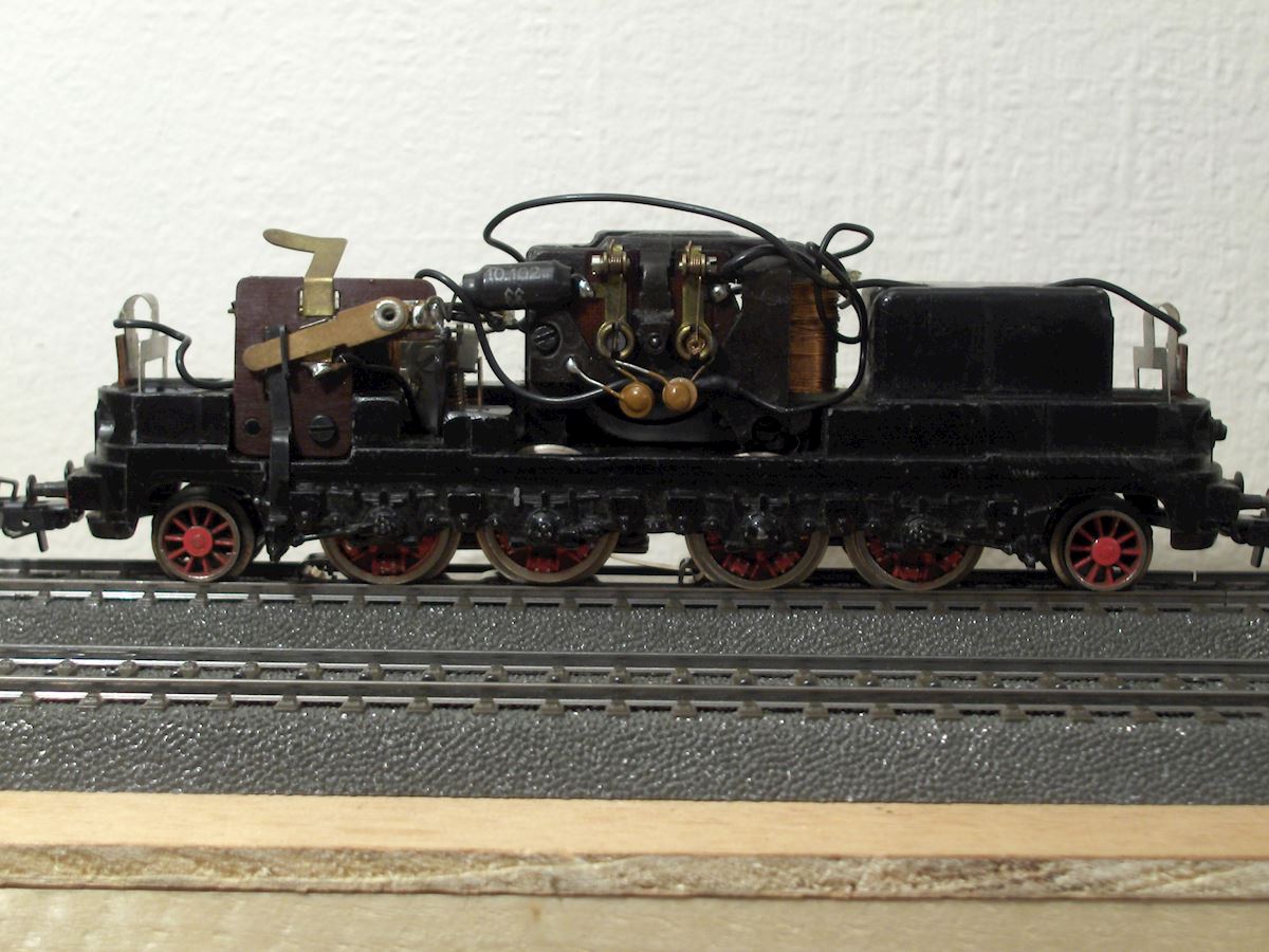

So,
let's start.

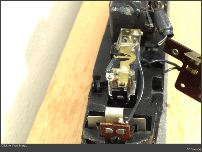

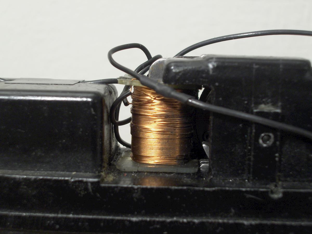

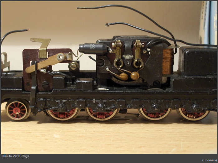

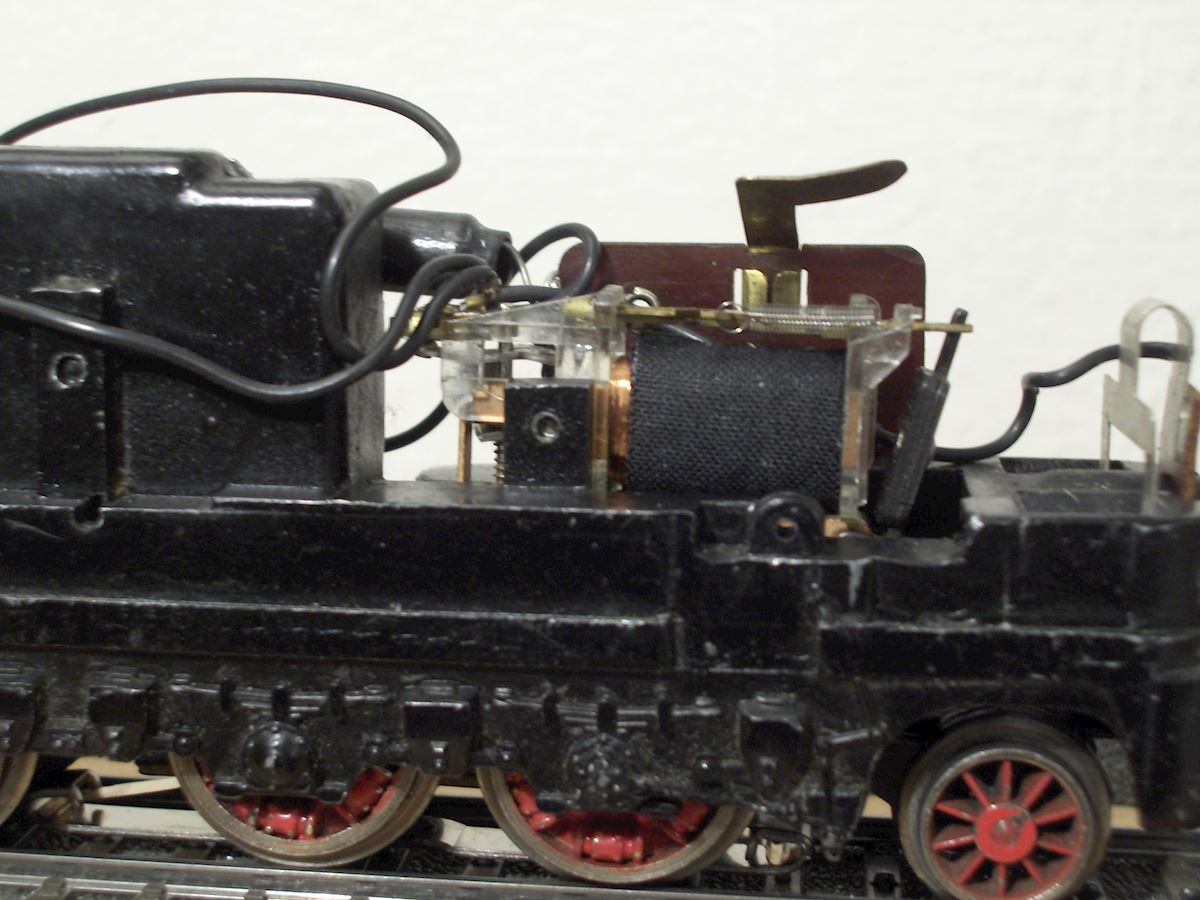

When I first put the lady on tracks, when feeding AC current, the loco was not moving.
I heard buzzing noise, lights blinking, well something wrong...
I thought it was a faulty reversing unit spring.
So I removed the loco body and saw this supernatural thing,
taking place instead of the reversing unit:
thanks 6 users liked this useful post by TrainIride

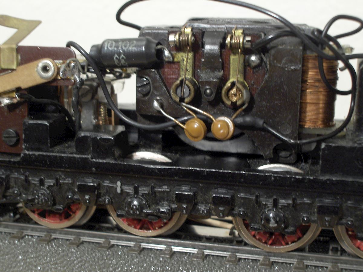

#4 Posted : 10 December 2016 11:50:15(UTC)
So,
let's start.
(snip repeated image)
yep! 3 rail DC.
Very popular in France Laugh
Edited by moderator 07 February 2017 02:25:11(UTC)  | Reason: Not specified
thanks 6 users liked this useful post by jvuye

using a 9V DC battery between pickup shoe and wheels,
in one direction, and then in the other, showed me this weird component
was a kind of rectifier that was selecting one of the motor coils, depending on the current direction.
The wheels were turning OK in both directions with the DC current.
So let's remove this and see what's left in the loco :
thanks 5 users liked this useful post by TrainIride
Offline TrainIride
#6 Posted : 10 December 2016 12:01:08(UTC)
TrainIride
Joined: 23/10/2010(UTC)
Posts: 2,084
Location: FRANCE
So,
let's start.
yep! 3 rail DC.
Hi Jacques,
Do you know what it is exactly ? a relay, a rectifier ?
Edited by moderator 07 February 2017 02:26:02(UTC)  | Reason: Not specified

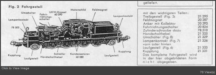

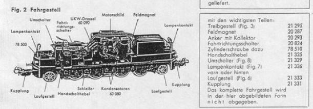

Give her back a heart:
fahrtrichtungsschalter #20824 needed
Done !
#8 Posted : 10 December 2016 12:58:07(UTC)
Posts: 14,922
all the numbers you see on the spare part list you must add a "0" at the end your spare part number than becomes 208240
Offline TrainIride
#9 Posted : 10 December 2016 13:16:49(UTC)
TrainIride
Posts: 2,084
Location: FRANCE
Thank you John for the information,
now I have this table to fill ....
thanks 3 users liked this useful post by TrainIride

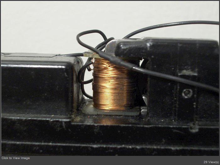

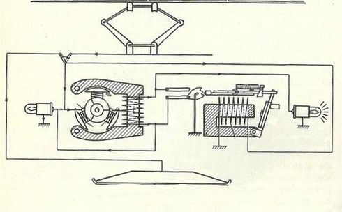

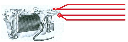

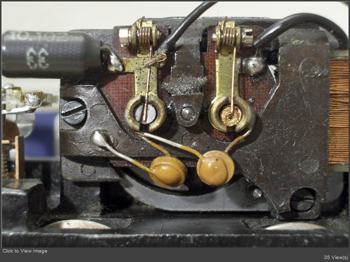

And now the thing that intrigued me a lot.
20824 or 208240 wiring is like this :
thanks 7 users liked this useful post by TrainIride
Offline TrainIride
#11 Posted : 10 December 2016 13:30:41(UTC)
TrainIride
Posts: 2,084
Location: FRANCE
But it's written in then catalog that this model has reversing lights.
And the reversing unit has only one switch Blink .
So, how did Märklin engineers do to reverse lights and loco direction with only one switch ?
After many enquiries on internet
(and I would like to thank all the people who have posted these informations)
I found the documentation.

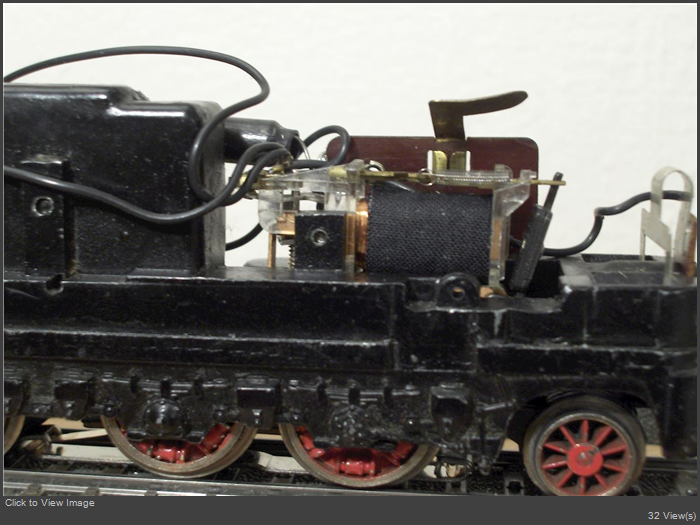

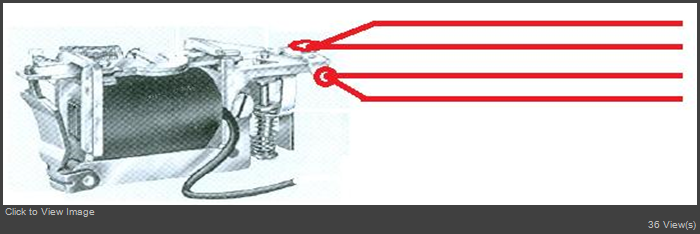

So, to summarize this,
we use the opposite motor coil to feed current to the light bulbs.
Regarding documentation, it can only be done with old motor coils,
maybe because of a lower impedance.
The current for the bulbs must be lower than the current for the motor.
This way, the current fot the bulbs can be considered as a "leakage current"
With more recent motors, the magnetic field mus be totally cancelled.
So for the 3024 :

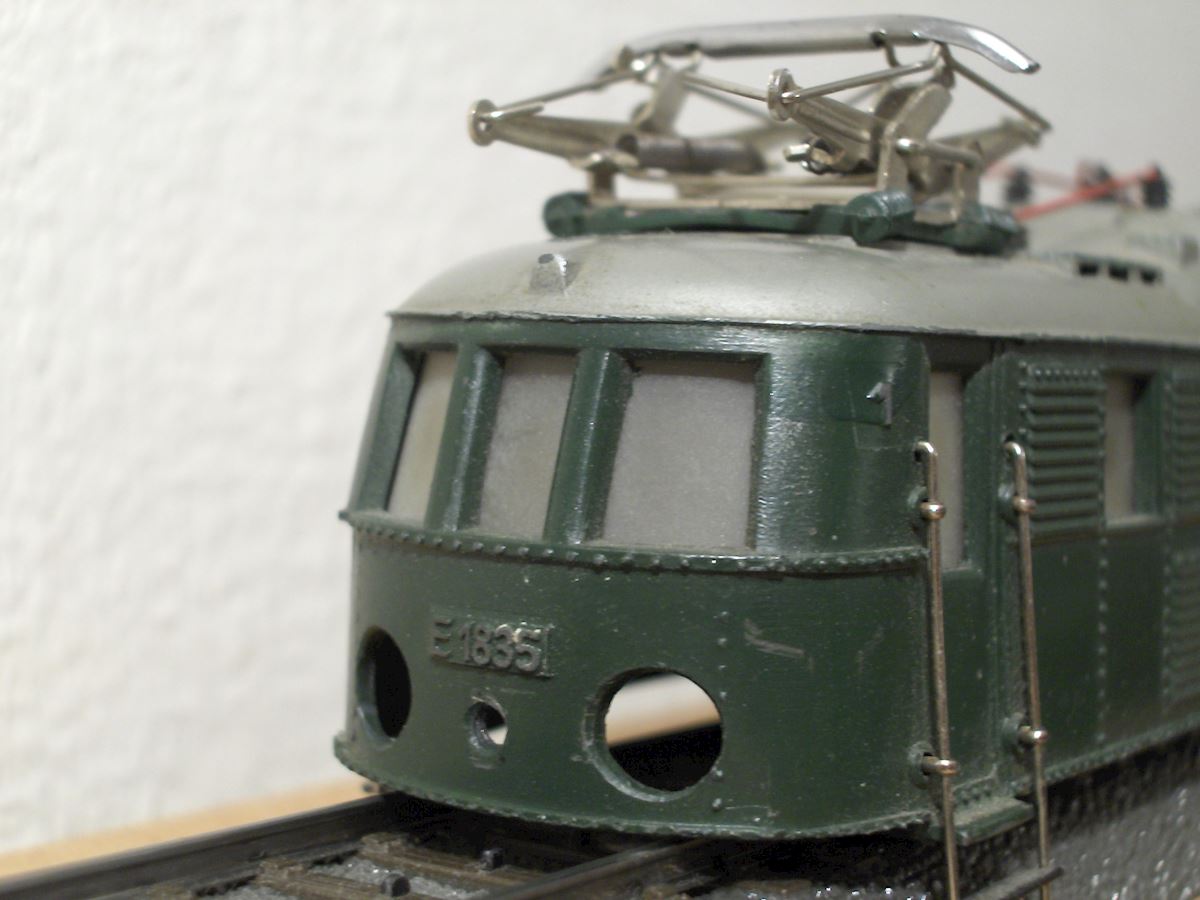

To remove the body
The loco has two sides BigGrin
Side 1
Side 2
They are different
Side 1 is where the body is labelled "1" and where the chassis has the selector for catenary feeding
thanks 4 users liked this useful post by TrainIride

Gently remove each bulb holder by turning the front screw.
The screws from each sides have different part numbers :
Do not mix them !
On side 1, the body has a small center hole :
On side 2, the body has a wider center hole :
On side 2, the body fits in a chassis kind of nose:
So to remove the body, it is necessary to slide the body horizontally a bit to extract the nose:
This one is a bit damaged ....
On side 1 chassis, there is no nose:

#19 Posted : 10 December 2016 18:15:46(UTC)
So,
let's start.
yep! 3 rail DC.
Hi Jacques,
A double diode (=rectifier) in fact. To make it compatible with 3 rail DC systems (e.g. JEP)
#20 Posted : 10 December 2016 18:20:30(UTC)
So for the 3024 :
In fact, it uses the dual wound coil as a "poor" (= inefficient) 1:1 transformer. Wink

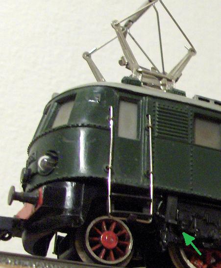

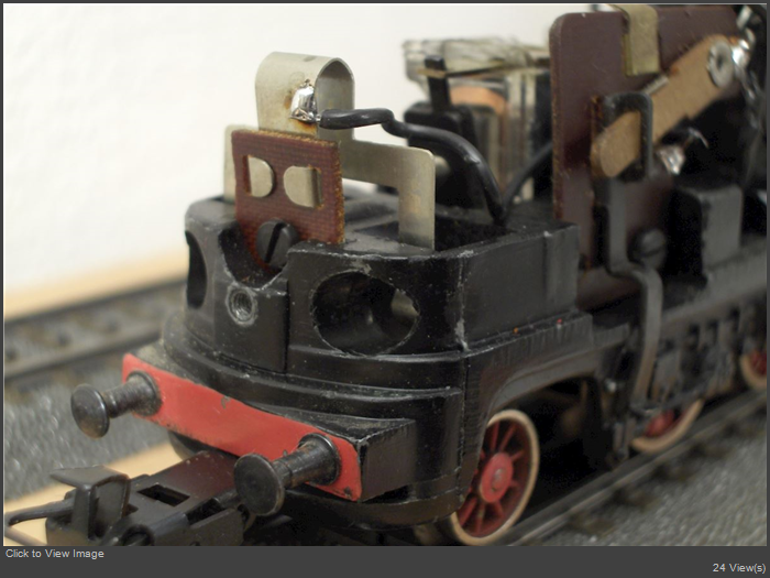

Well, now the body :
Inside, no contact plate for the catenary power !!! Blink
I did not find any information on this. Crying
So If you have one ....

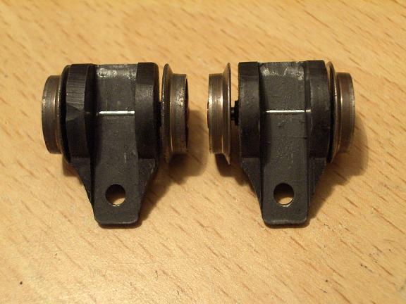

#60030 and now 600300
the question is :
"is there a special place for the copper mesh ?"
The answer is "YES" found in the Service Manual:
There is a straight spring for the graphite one that press to the notch.
There is a bent spring that needs to enter in the mesh center.

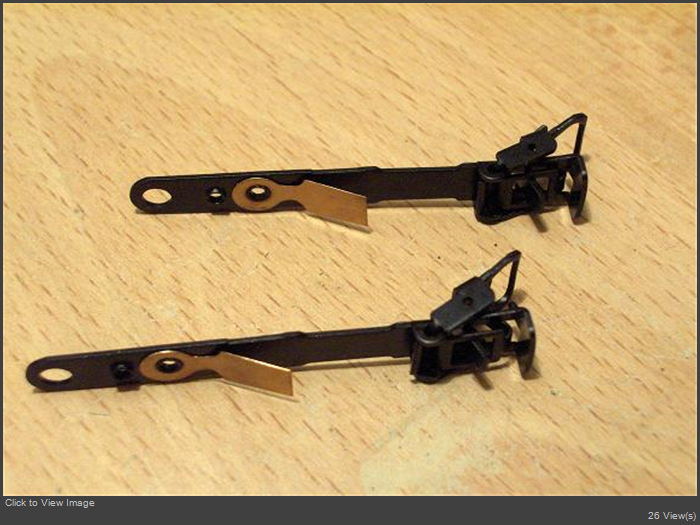

Now replacing the front and back couplers.
#201331 or now 2013310
the flat spring will press (enough ?) upon the front wheels to avoid derailment .
Due to the shape of these front gears,
the wheels will follow the coupler direction, and vice versa

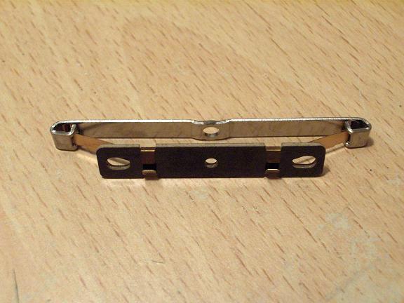

...And the new pickup-shoe
the unavailable #7174 is replaced by a #212010
even if the pickup shoe previously mounted on the loco seemed inappropriate,
the new one look a bit too long, (hoping this is the good part number, I had it in a box without reference)
The old locomotive uses a very thin contact plate to collect the current from shoe.

Location: FRANCE
Well,
I wanted to take pictures of the wiring inside, but I found that the pictures were not clear enough.
So I decided to create drawings to explain the method.
1. At first, we need to solder a pair of wires on each poles of the reversing unit.
It is easier to to this before installing it, and by this way,
we do not have to touch the reversing unit too much.
Offline TrainIride
#38 Posted : 14 December 2016 21:02:53(UTC)
TrainIride
Posts: 2,084
Location: FRANCE
2. we need to solder the black wire of the reversing unit on the catenary switch :
Offline TrainIride
#39 Posted : 14 December 2016 21:07:15(UTC)
TrainIride
Posts: 2,084
Location: FRANCE
3. we need to connect the motor coils to the reversing unit.
For each coil, a test must be done to see in which direction the wheels are turning :
Offline TrainIride
#40 Posted : 14 December 2016 21:11:41(UTC)
TrainIride
Posts: 2,084
Location: FRANCE
4. the lights.
Once we have located which coil is which direction,
we can connect respectively the corresponding bulbs to the opposite coil Blink
And that's it !
thanks 8 users liked this useful post by TrainIride

Now the wiring diagram is clearer,
Let us have a look to the inside.
Not a lot of wires, thanks to the common ground chassis ThumpUp
Offline TrainIride
#42 Posted : 17 December 2016 16:28:10(UTC)
TrainIride
Posts: 2,084
Location: FRANCE
Even if the reversing unit is "viewable",
You can understand it is better to solder on it before installing :
See the two pair of wires upon the reversing unit poles:
Offline TrainIride
#43 Posted : 17 December 2016 16:31:33(UTC)
TrainIride
Posts: 2,084
Location: FRANCE
The motor coils wires left after dismounting the rectifier were too short.
I used heat shrink tube to insulate the connections with the reversing unit cables.

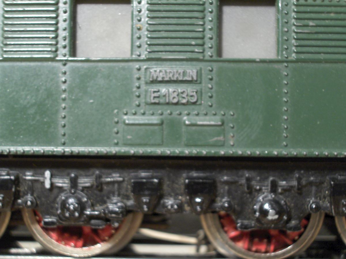

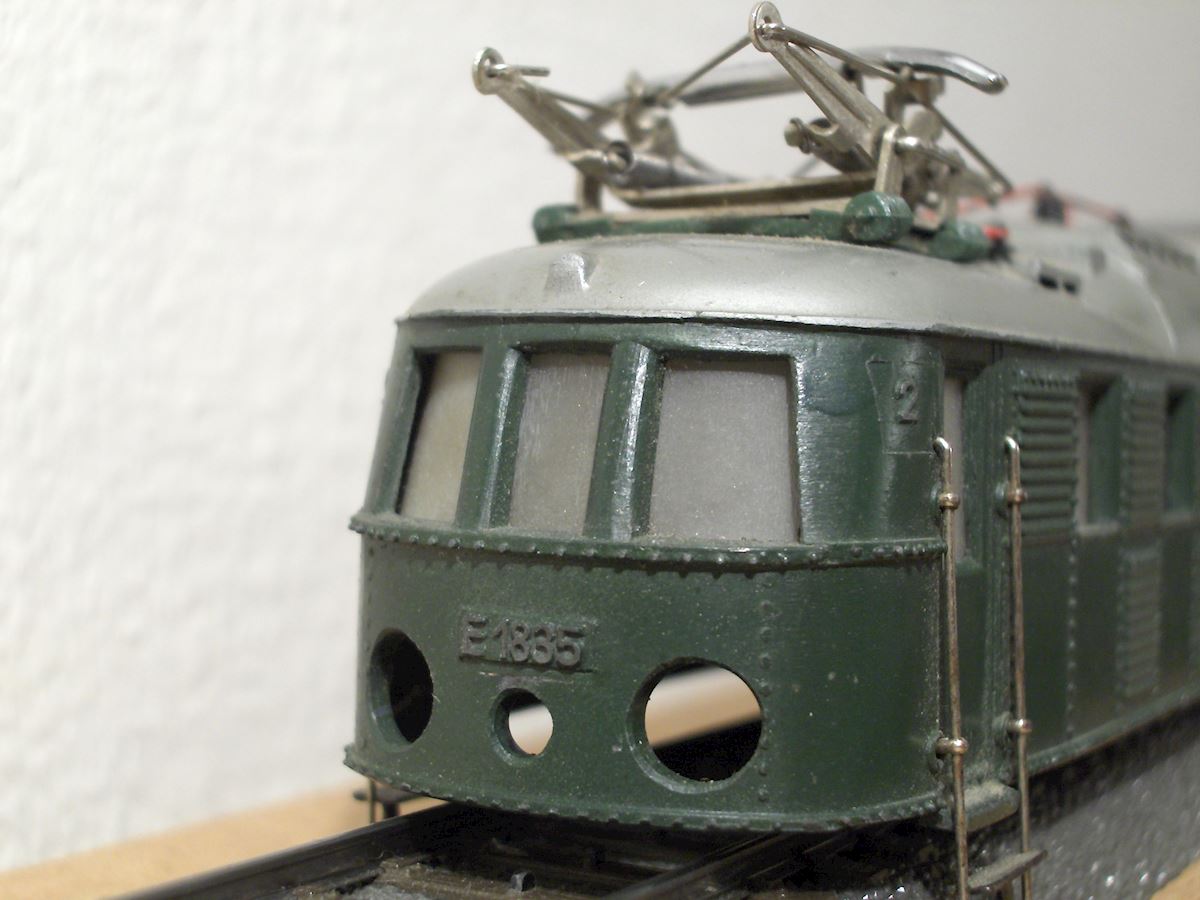

Now the wiring is finished,
just a look at some outside details
The "Bicycle" logo on sides 1 and 2 :
"MARKLIN E18 35" on one side :
"3024E18 35" on the other side :
