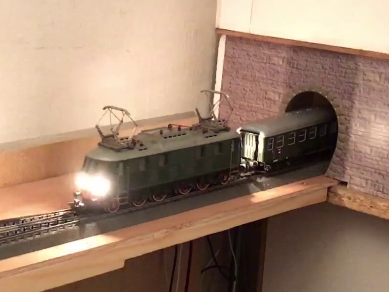

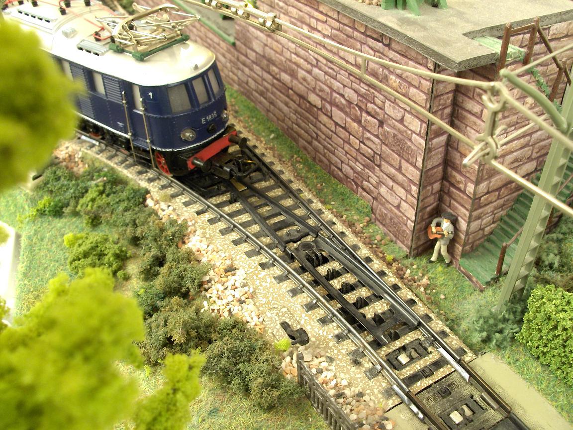

Originally Posted by: TrainIride
A bit noisy, maybe because of the rotor gear teeth
And great both flashing lights when reversing due to this special wiring.
Both coils are "opened" during this transition, so both coils are feeding current to the bulbs...
And see how the loco appreciates wide radius C-track turnouts !!
I love this video.
Nothing is like the feeling of "I've done it".
The noise is normal .
Old lady grinding teeth...
Gears of older Märklin loks were mostly stamped, not ground
If you had luck, the gears on you new loco would have been cut with a fresh die....otherwise the profile was mostly off!
Gears are noisy because of improper tooth shape and alignment problem (angle and distance)
That noise will reduce while "running in" is an urban legend.. busted!

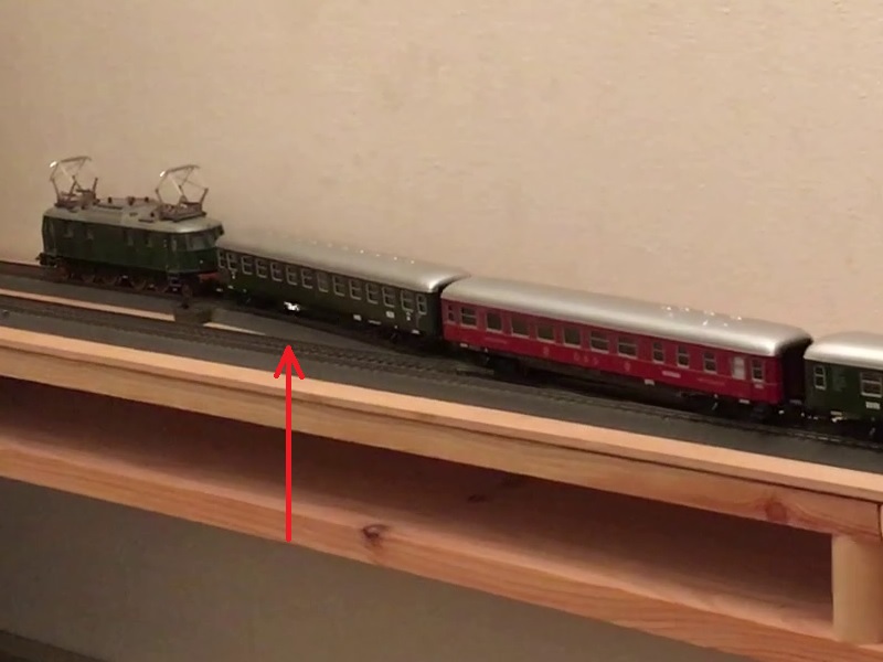

Looking at the video: I have the impression that the second axle of the first coach is probably a bit out of gauge (too wide or too narrow) due to the sparking.
The rule is 13.8 mm between the inner flanges of the wheels. Tolerance is +/- 0.1 mm. And of course the wheel should be running true!
Congratulations on a job well done both execution and documentation!
I love this video.
Jacques
Hi Jacques,
Thank you for your kind words,
it is such an honor to have congratulations from an expert like you !!
Well, I did not know about the gears manufacturing.
Thank you for sharing this very interesting thing.
So that's why some of my locos are "almost silent"
and some are growling much more, even after oiling.
You have watched the video very carefully to see the spark
under the first coach when passing upon the wide radius turnout.
You can only be right. I will check that axle.
By the way, on these old tin plates recently received,
I still have to adjust the coupler height, another sparks source upon turnouts...
As you said, I'm really glad I did this job...
Now I can show my loco to my Christmas guests.
See how the happy loco makes blinks again after all this time:
I love these lights and the Buzz of the reversing unit
But there are still small things to be done to refine the work.
I have to find the missing parts for the catenary connections under the roof.
The wire from the pickup shoe is way too short, I have to replace it,
this will give me the opportunity to unmount the contact plate under,
and maybe the axles.
I have just now noticed that sometimes, the big wheels of the second axle without gear - a second axle again ! -
were not not turning so well. I think the axles have to be oiled a bit by the inside, or some old dust to be cleaned.
I'll check it soon, when unmounting the pickup shoe, the contact plate, the shortest wire...
And also the pickup shoe, I'm sure it will need some fine tuning to slide smoothly upon M-track turnouts...
Best Regards
Joël

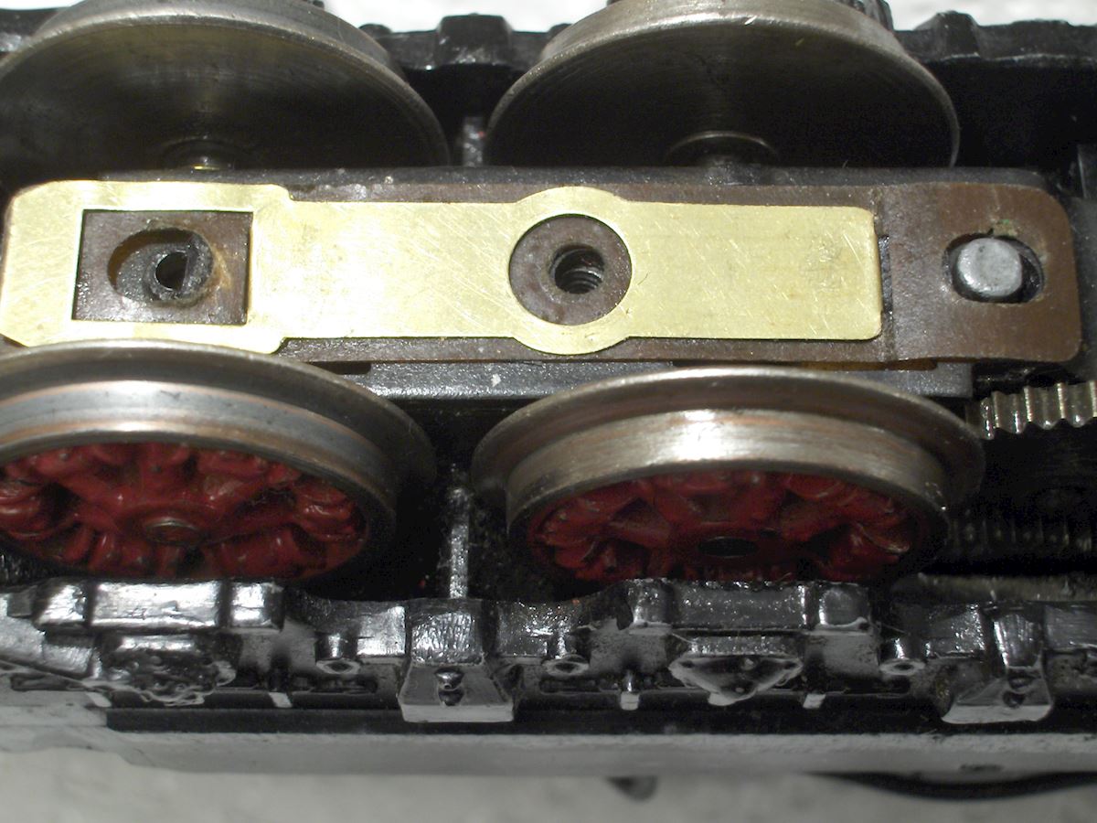

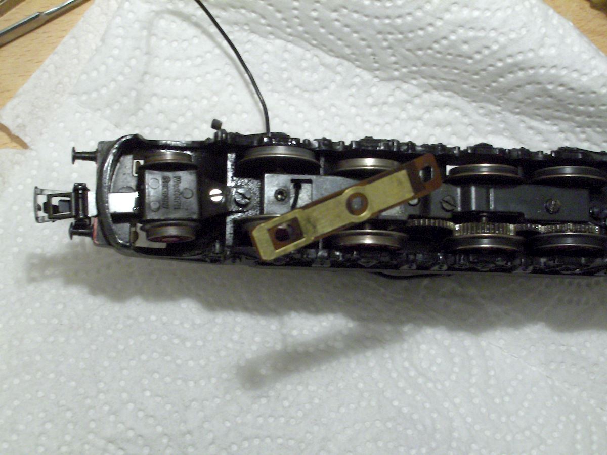

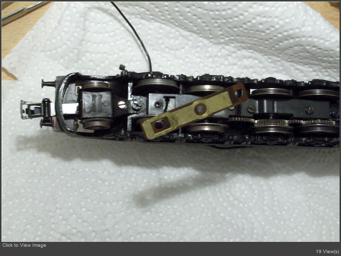

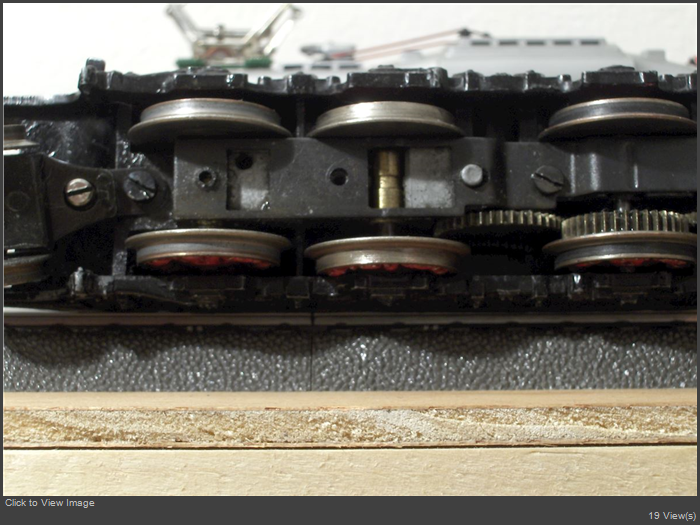

Well I started today to check the axle that was not turning so well,

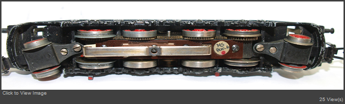

in fact this axle can move a bit vertically, as it is "clearly" written in the 1958 catalog:
"Swing link suspension to the second driving axle
to take up track irregularities and keep both wheels on the rails"
In my case there was no "suspension"
So I decide to remove the pickup shoe, then the control plate,
and for this to unsolder the too short wire that brings current to the loco.
I discovered a great quantity of dirt that was blocking the suspension.
So I cleaned a bit this part of the body, and it solved this problem.

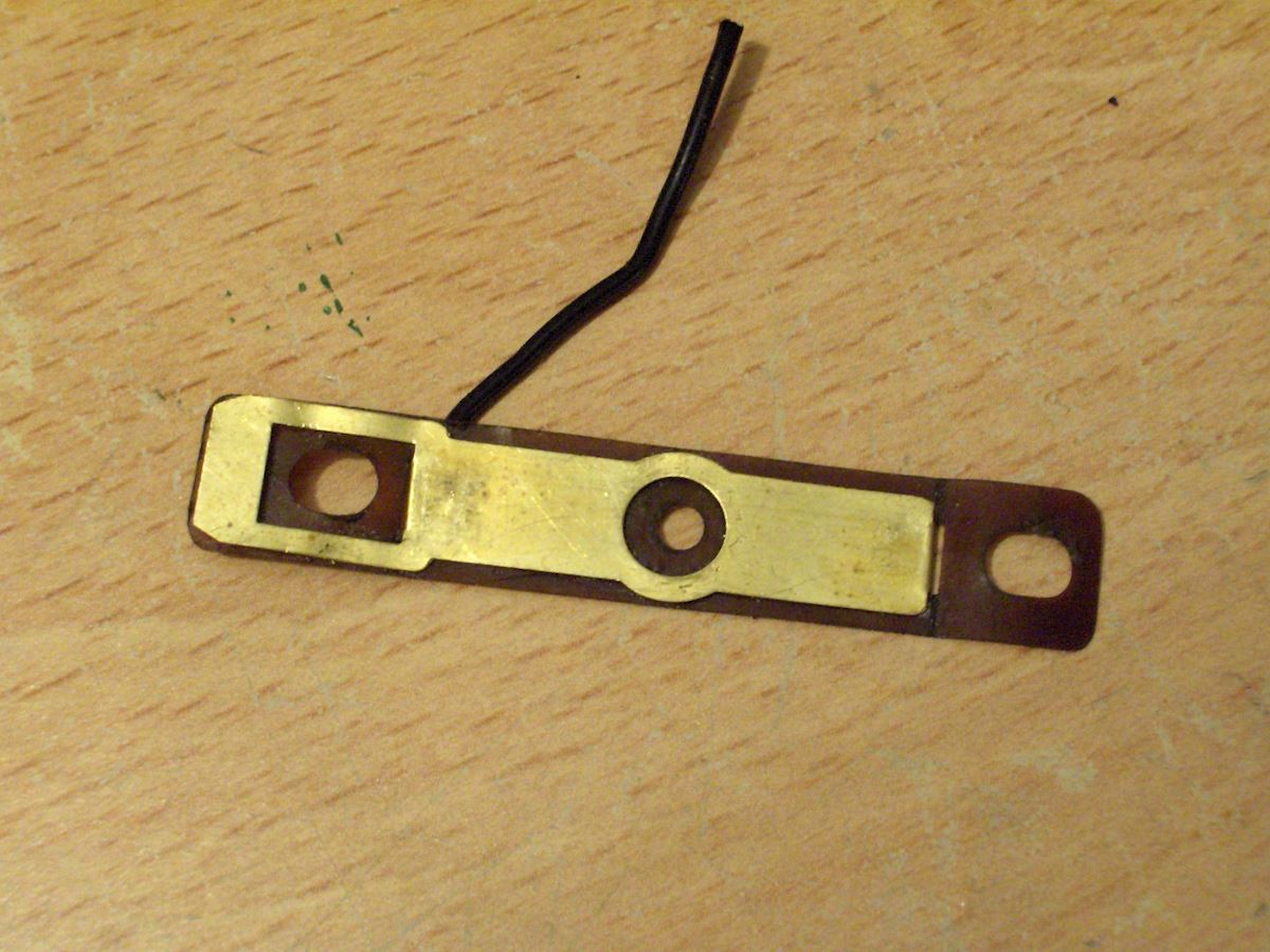

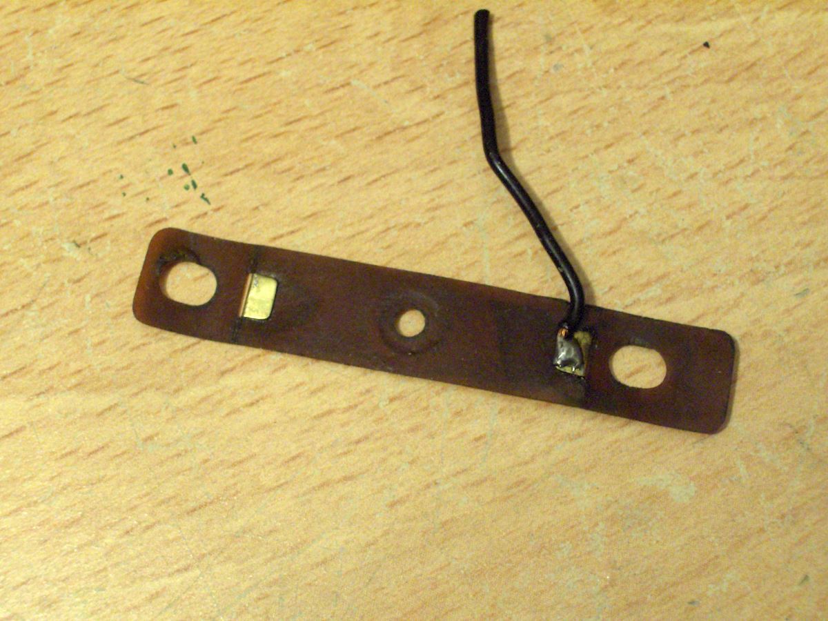

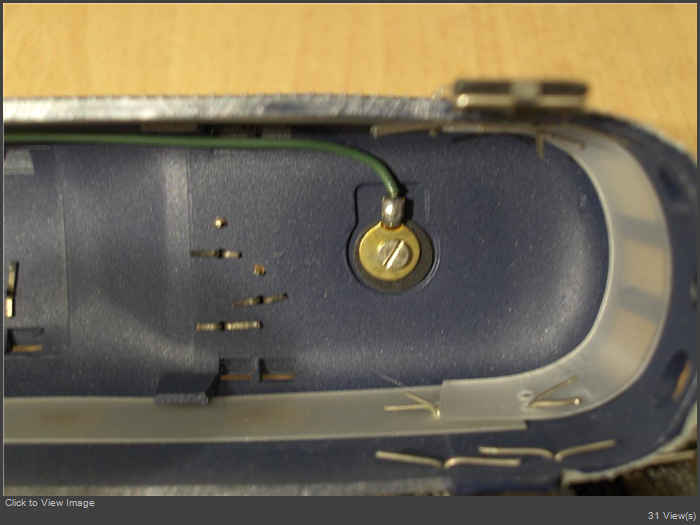

But, when I mounted back everything and try the loco on the tracks, the loco was in short circuit !
The dirt was insulating the contact plate from the body !!
This contact plate is very old and fragile.
And so thin that now it can bend too much, this way in contact with the chassis.
Let's have a look :
side of the pickup shoe:
side of the chassis:
where is the short-circuit ? :

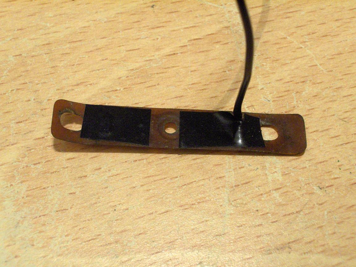

I have planned to fit a thin plastic sheet between the chassis and the contact-plate,
but not enough time today - and no thin plastic found yet
But now that I have soldered a longer wire, I can unmount the plate easily, so no more access troubles.
So for today, it will be adhesive tape for the insulation and more rigidity:

Let's have a look :
I think the short circuit is between the tab that is soldered and the chassis. I would remove the wire, clean off all the solder and redo the joint with a freshly stripped end on the wire, using minimal solder. You should be able to get the solder blob significantly smaller.
Also check carefully how that plate is sitting on its two location pins at the ends. Notice that the holes are slotted, make sure it is pushed as far to the left as possible as it looks like the brass lug could contact the chassis at the right hand end. Two ways to fix that, depending on how the screw hole for the pick up shoe lines up with the chassis: -
gently file the left hand end of the insulator so it can move further left
gently file the chassis on the right hand end of the right hand recess so the brass lug can no longer touch it.
Thank you for these helpful tips
I started to insulate the "solder" side (right side) of the plate.
But the short-circuit was also on the left side.
I suspected the plate to have a weak point at left to be almost cut, this giving it to much flexibility.
But I will try your advices soon !

the picture above needs one more part, an insulation plate without any metal parts, later produced locos had a deeper cut into the frame, thous preventing it from short circuiting.
I totally agree with you John.
I will try to find a thin insulating thing to put in between.
I really don't understand why the engineers had choosen a so thin and bendable and fragile plate.
This is the Achilles' heel of this so strong loco.
In this so solid chassis, there could have been room to put a thicker bakelite plate,
at least as thick as the one used for the pickup shoe .

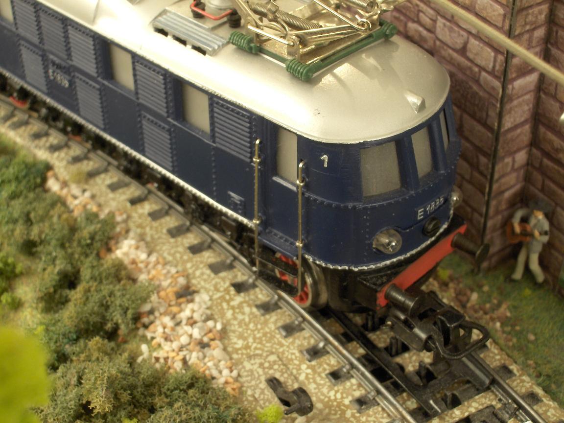

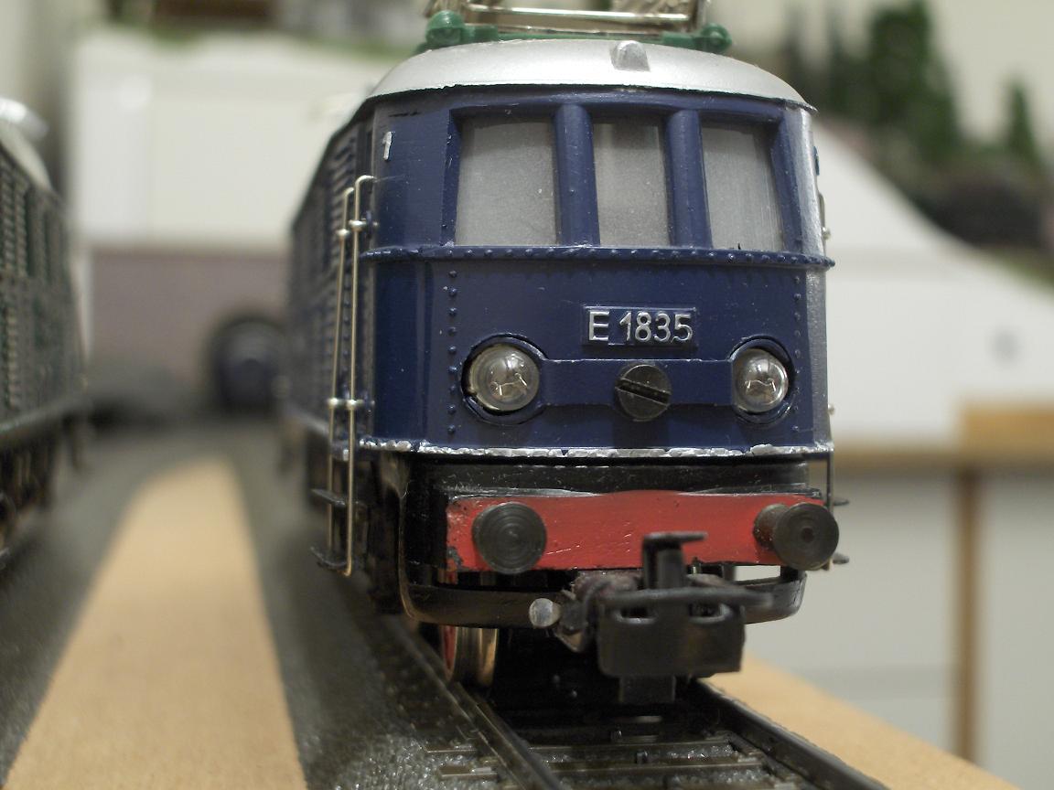

Soooo,
Every E18 brings its own stories and tales,
This blue one is in perfect condition and runs OK straight from the no-box.
Just a few oil drops to add...
I've heard, before, about the problematic relationships between 3023/3024
and the M-track turnouts. I had no problem with the old green 3024, after
bending up a bit to the chassis, on each end, the pickup shoe,
to give it an almost invisible kind of "banana" shape,
and after adding some spring pressure on the small back and front wheels.

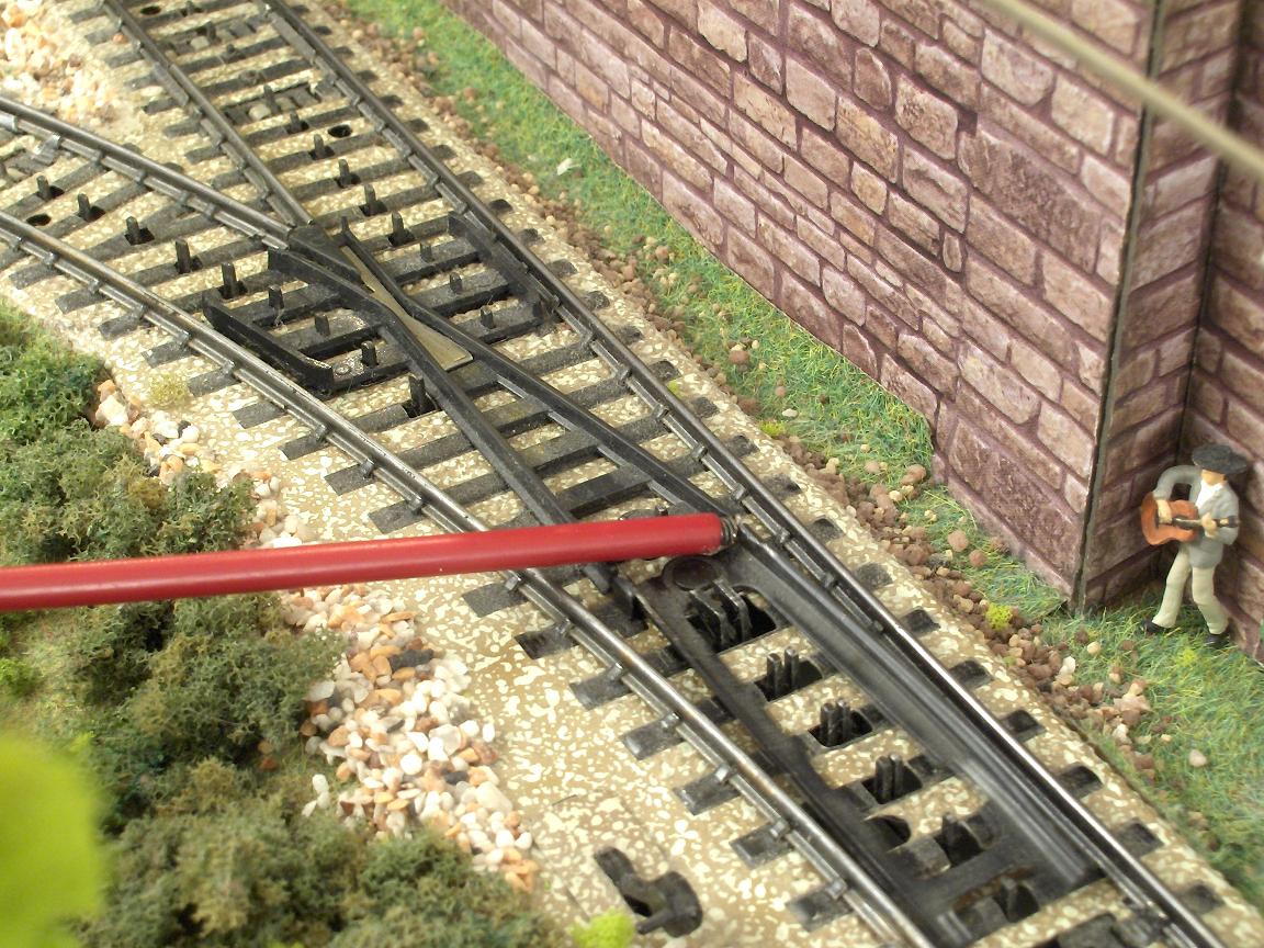

But This shiny blue 3023 surprised me derailing every time on only one of my layout turnouts
After 30mn of tests, the problem was solved .
It was indeed a relational problem, in this old time of great tolerances
the context:
the loco comes back to the turnout, from the deflected track.
the turnout is well positioned.
When the logo goes upon the turnout, the small front wheels pop off the tracks without any reason !!
The solution is there:
The big wheels of the loco, with its huge weight, give some pressure on the moving parts of the turnout.
And you can see the rails moving an pushing the front axle aside !
The proof:
Just press lightly to this point of the turnout,:
And you will see the rails moving !
So after bending back a little bit the rail at the problem point, no more problem !

#64
Posted :
08 January 2017 20:32:59(UTC)
Retweet
Posts: 8,718
Some of these problems can be very hard to diagnose, but you seem to have found a new problem that I haven't come across before.
But is the guitar players music that bad he really needs to go hide down the tracks ???
2 users liked this useful post by kiwiAlan

#65
Posted :
09 January 2017 15:48:39(UTC)
Retweet
Salut Joël!
Just looking at the last picture of the blue loco passing on the switch, it looks as if the front axle/pony wheel may have some gauge discrepancy.(?too narrow?)
If you can, using a caliper ( aka in French "un pied à coulisse") measure the inner spacing between the wheels .
It should read 13.8 mm. A little more is acceptable up to 13.9, but less than that becomes a problem very easily on M track switches
Let us know!

TrainIride
#66
Posted :
14 January 2017 22:02:48(UTC)
Retweet
Joined: 23/10/2010(UTC)
Posts: 2,084
Location: FRANCE

14 January 2017 22:19:27(UTC)
Retweet
Posts: 2,084
Location: FRANCE
Salut Joël!
Let us know!
Bonjour Jacques.
You are absolutely right, as usual !
the inner space of the wheels of the blue loco are a bit less than 13.8, and this is valis for all wheels of the loco !
I have trouble reading on the calliper, but lets say about 13.74 so just a bit under 13.8.
So I've compared with the green one, and this time the inner space of the wheels is more than 13.9. and also for all the wheels. Maybe it was adjusted to run better on 3rails DC tracks.
Do you know if I can move the wheels without damage (bending wheels or axles) by hand, or do I kneed a special tool (like "the Puller") .
I will see if I need to do something, because for the time, I have not yet noticed any derailment problems associated with these non-compliant tolerances.
Thank you again for your participation. It's a great help for me .

#68
Posted :
16 January 2017 19:00:51(UTC)
Retweet
HI Joël
The only proper way to adjust the spacing is using a wheel puller, and adjust the spacing using a wheel press and a special gauge .
Any other technique like praying on the side with a scredriver or pressing with a vise almost always leads to wobbling wheels.
And with the long wheel base locos like the ones in this topic, the wobble becomes very annoying, at least visually.
The proper tools can be found here:
https://www.fohrmann.com...ciaux/roues-und-essieux/
But of course if you don't live too far, You could come here and I'll adjust this for you.
Feel free to PM me.
Jacques

TrainIride
#69
Posted :
21 January 2017 17:47:43(UTC)
Retweet
Posts: 2,084
Location: FRANCE
HI Joël
Feel free to PM me.
Jacques
Hi Jacques.
Thank you for this great link. I will see if I have to make this investment,
I think it will be absolutely necessary if I continue to get old locos.
But I was so happily surprised to see how both green and blue E18 smoothly ran on the C-Track part of my layout,
despite their bad wheels space tolerances, that I wonder if I will not rework the "historic center" part
of the actual layout and renovate the rails ...
It's so nice to see these locos running fluently as in the previous video
, as they were made for this ....
I had planned to extend the section with C-track and to keep about only 50 percent of the M-track M part,
Now I'm thinking to keep 0 percent of it
We will see...

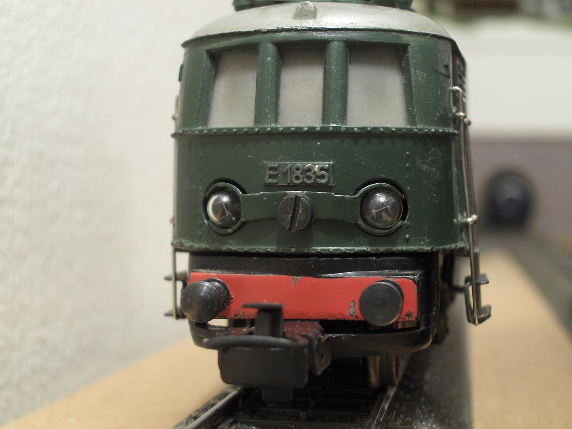

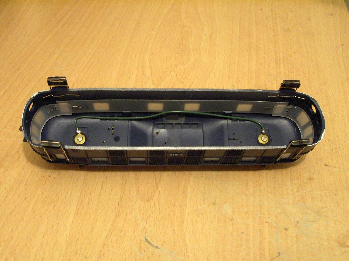

Now a little focus on my recently purchased blue one.
Sold as a 1965 model - aka the famous HAMO - AC version ...
But there is no Hamo stamp on it.
For me, this one is rather a 70's/80's model from spare parts - #3923
Well I am not yet sure, I have to investigate more.
At fist I was looking fo a solution to complete the under the roof catenary wiring of the 1959 green one.
So let us have a look at the blue loco under the roof :
Surprising isn't it
I was expecting a kind of brass plate to connect the two pantographs together,
with a camel shape to follow the roof bump...
So...
If there are here some 3023/3024 owners, please have a look under your loco's roof,
to see if this is the original solution from the factory, and tell me !

#71
Posted :
29 January 2017 16:39:52(UTC)
Retweet
Salut Joël
I confirm: it's apparently the "official" set up for the overhead connection.
My 3023, 3024 and MS 800 all are fitted in the same way.
And from memory, all those that passed through my shop for repairs and conversions were build that way.
Hope this answers your question

TrainIride
#72
Posted :
05 February 2017 14:58:26(UTC)
Retweet
Posts: 2,084
Location: FRANCE
Salut Joël
Jacques
Hi Jacques,
Looks like this model was born at a technological transition time...
So it will be easy now for me to completely complete the green lady wth a wire and two electric lugs.
Nevertheless, I wonder why this wiring was removed by the previous owner,
because it was not interfering with the DC conversion
Thank you for your helpful answer.
Best Regards
Joël
Hi Joël
I don't know for certain why someone would remove the connection between the pantographs, and we don't know the whole life history of your loco either, so we can only speculate.
In any case at least one pantograph would be connected (
If it was assembled from parts of the series that Märklin put on the market in the late 70's and that dealers assembled (my dealer in Brussels assembled hundreds of them, and still today has a few 3047 and 3046 on inventory!
!) , maybe someone forgot to put that wire.
I confess it's perplexing since earlier locos like my 1951 RSM 800 had an etched connecting plate between the pantos , mounted with a layer of insulation already.
Luckily this slimper solution has no detrimental "cosmetic" consequences ....
it's still a pretty loco, (at least IMHO) and that's the only thing that counts, really.
Bon Dimanche
Jacques

Hi Jacques,
Bon Dimanche !
For sure we will never know the entire story of this loco,
but I am always happy to achieve knowledge on my marklin models
As you talk about "assembled from parts" ones,

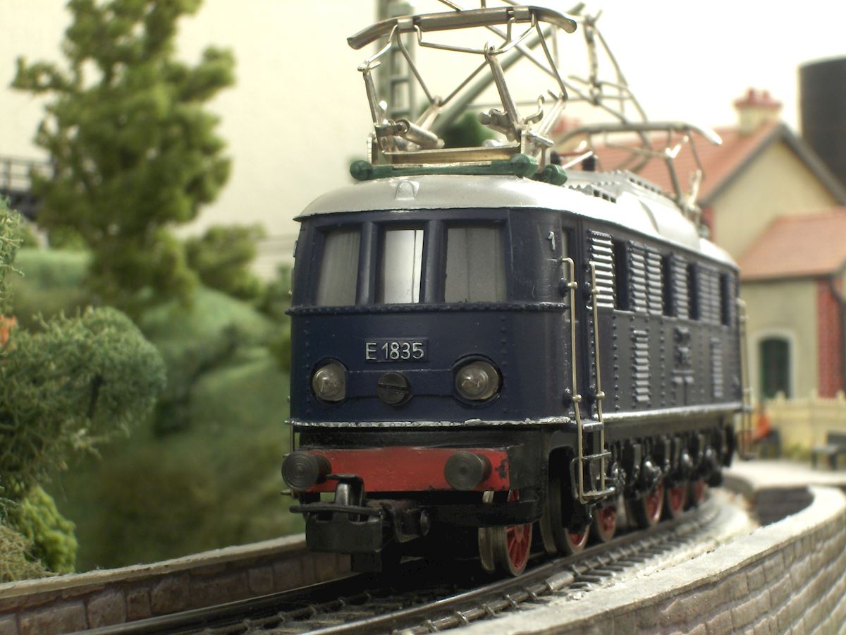

it gives me the idea to start a comparison of my two E18,
again to discover more about.
At left the green one received in a 3024 - 03/59 dated blue box
At right the blue one unboxed, sold as "from 1965" which I supposed to be an
"assembled from parts in the late 70's" aka 3923.
Best Regards
Joël
Marklin HO - M track & C track - Analog mode -
https://www.marklin-users.net/TrainIride
my channel :
https://www.youtube.com/user/2mes2mains
WWW
2 users liked this useful post by TrainIride
dominator
User Profile
View All Posts by User
View Thanks
TrainIride
#75
Posted :
05 February 2017 18:11:18(UTC)
Retweet
Posts: 2,084
Location: FRANCE
The green one has a "convex" left buffer and a right flat buffer.
The blue one has two flat buffers.
The green one has no silver paint on the body
The blue one has a silver line on the bottom of the body, and the "E1835" is silver painted.

The green one has a pale grey roof.
The blue one has a shiny silver roof.
See more soon...

Green one= original, assembled @ factory. Never had silver paint
Blue one = From parts, assembled locally. Always had silver stripes.
But doesn't matter. They are both beautiful

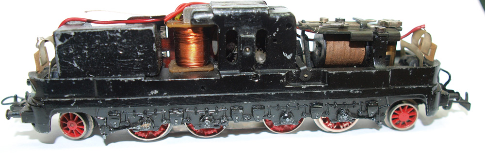

Now let us see what differs inside the two locos:
inside the 1959 green 3024
inside the recent blue 3023 see how the motor cover is completely different
inside the recent blue 3023 the choke (UKW Drossel) is also different
and we have a nice view on the gears !

Since we mentioned the MS 800 and its differences, here are a couple of pictures.
Major difference is that all 4 axles are powered, although only the external ones carry the weight of the loco.
No flanges on the middle drivers, this long loco negotiates the 360 mm radius without any trouble.
Also note, under the brushes, the friction driven switch that performs directional light changes.
It is driven from the central gear shaft in the lower part of the transmission.
From memory that light inversion gizmo was first used on the CCS 800 in 1947 , then on the RE 800, TP 800, TT 800, ST 800, DL 800 and DT 800.
I haven't found/seen evidence of it on any other loco since.
Maybe someone knows?
All driver axles powered, you can barely see the "friction gizmo" on the other side of the big central middle gear
Heavy equipment!
And the original connection between pantos. Note the little piece of insulating cardboard on the contact side..
Jacques

Hi Jacques,
Thank you for posting these nice pictures of your MS800
This enlarges the family !
I have well noticed this very inventive light reversing system !
And also the axle you have replaced, as it is thinner than its neighbors
And maybe you have also replaced a screw - hexagonal head ? - on the right front truck...
Best Regards
Joël

Very good observation Joël!!
At the time when I replaced the front pony wheel (because of creeping zink pest) I didn't have the right one, so I used one from a steam loco valve gear set !
Time for a small correction of this capital sin!!
Thanks you for being so attentive!
EDIT: Fixed !!

Hi friends,
for the 60th anniversary of Lady 3024,
I finally decided to replace the grey rotor with used teeth, with the green one yo can see on the picture.
Still have to add the missing inside wire for catenary power _ I have received the corresponding sockets,
and maybe re adjust the wheels space, I have done it a bit, but maybe not enough.
Please enjoy Lady 3024 running on the layout:
Best Regards
