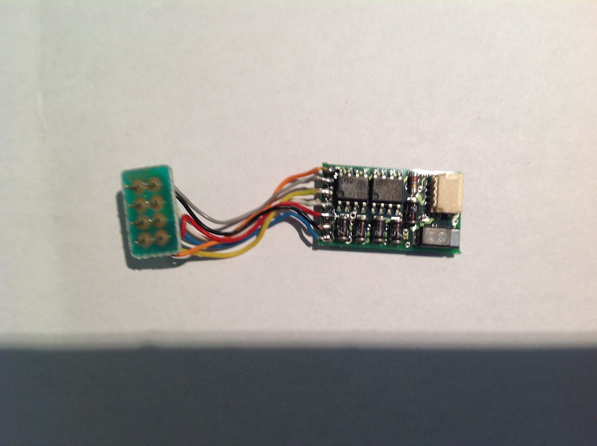

Offline nero328
#14 Posted : 24 August 2013 00:13:07(UTC)
nero328
Joined: 24/02/2011(UTC)
Posts: 21
Originally Posted by: nero328 Go to Quoted Post
I tried to write value 1 into CV 59 but I get the message back "No loco on track." Bad decoder? Or am I still missing something?
With DCC, the feedback from decoder to controller work by increasing power consumption - most decoders turn on the motor for a short period of time to acknowledge a programming instruction.
"No loco on track" could mean there is no connection between decoder and motor - or power consumption of the motor too low to be detected. Or loco not on the programming track, but on the main track?
To read CVs using DCC you need a programming track (without any turnout decoders or other devices connected to that track).
Maybe the loco has one of the fantastic AnDi decoders (73500, not 76500): no DCC, only MM, no automatic system detection (must be configured for either analogue or digital operation).
You wrote it's a 76500. How do you know?
Did you ever look at the decoder? Can you post pictures of it?
I'm fairly certain that I have the loco on the programming track. Also, the loco does work in analog mode. Would it work in analog if there were no connection between decoder and motor? The decoder number 76500 came from the manual that came with the loco. I'm attaching pictures but I did not see any other identifiers.
I have a Bachmann decoder I was going to try in place of the Uhlenbrock - can I do so without causing problems?
Thanks again to both of you for taking the time and effort to help me sort this out.

#15 Posted : 24 August 2013 09:03:41(UTC)
Posts: 15,443
That's the idea of NEM sockets: swap decoders without hassle. You may have to adjust the load regulation parameters of the decoder for perfect running.
Train should run with the default settings.
The decoder probably is an Uhlenbrock 76500.
The only mode that cannot be disabled is DCC programming (you can disable both MM operation and DCC operation - even both at the same time).
That's the CS 1 reloaded DCC programming screen:
DCC Programming Screen
Choose "Programming Track", write 1 to CV 59, ignore the error message, and then try if the loco responds to address 3.
Or try the Bachmann.

Offline eroncelli
#20 Posted : 27 August 2013 14:58:34(UTC)
eroncelli
Joined: 16/02/2011(UTC)
Posts: 124
Location: Bergamo - italy
Just a try: most recent Uhlenbrock decoder can be reset to factory default by writing 8 in CV8 (older types required 1 in CV59).
