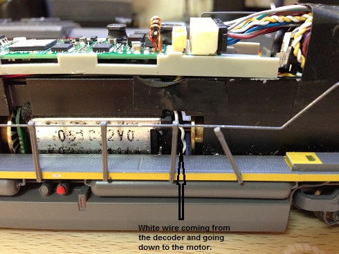

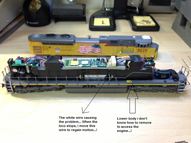

Here are some images.
First one is the SD70 without the upper body. I am trying to remove the part of the body surrounding the motor to access the lower part of the motor to check the contact with the white wire...
SD70 openned
Here is the white wire i need to touch when the motor gets stucked in order to move again... The lower connection of this wire must be the problem but no way to access it...
White wire

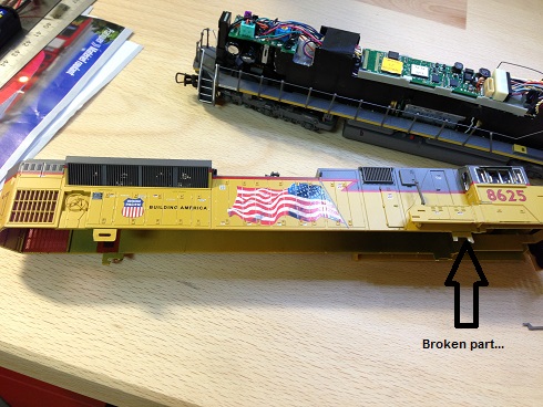

Below you can see how the upper body is fixed to the lower body. You need to squeeze the upper part to remove it and to avoid the kind of damage i did...
Damage
I hope this is understandable...?

Ok, it is possible! you need to remove the big board in the center then you'll see 4 screws, I think you'll need to take of the couplers as well. This video should help.
On top of that, this one should help you to take the body without braking any more tabs.
Let me know how it went.
thanks 1 user liked this useful post by Iamnotthecrazyone
