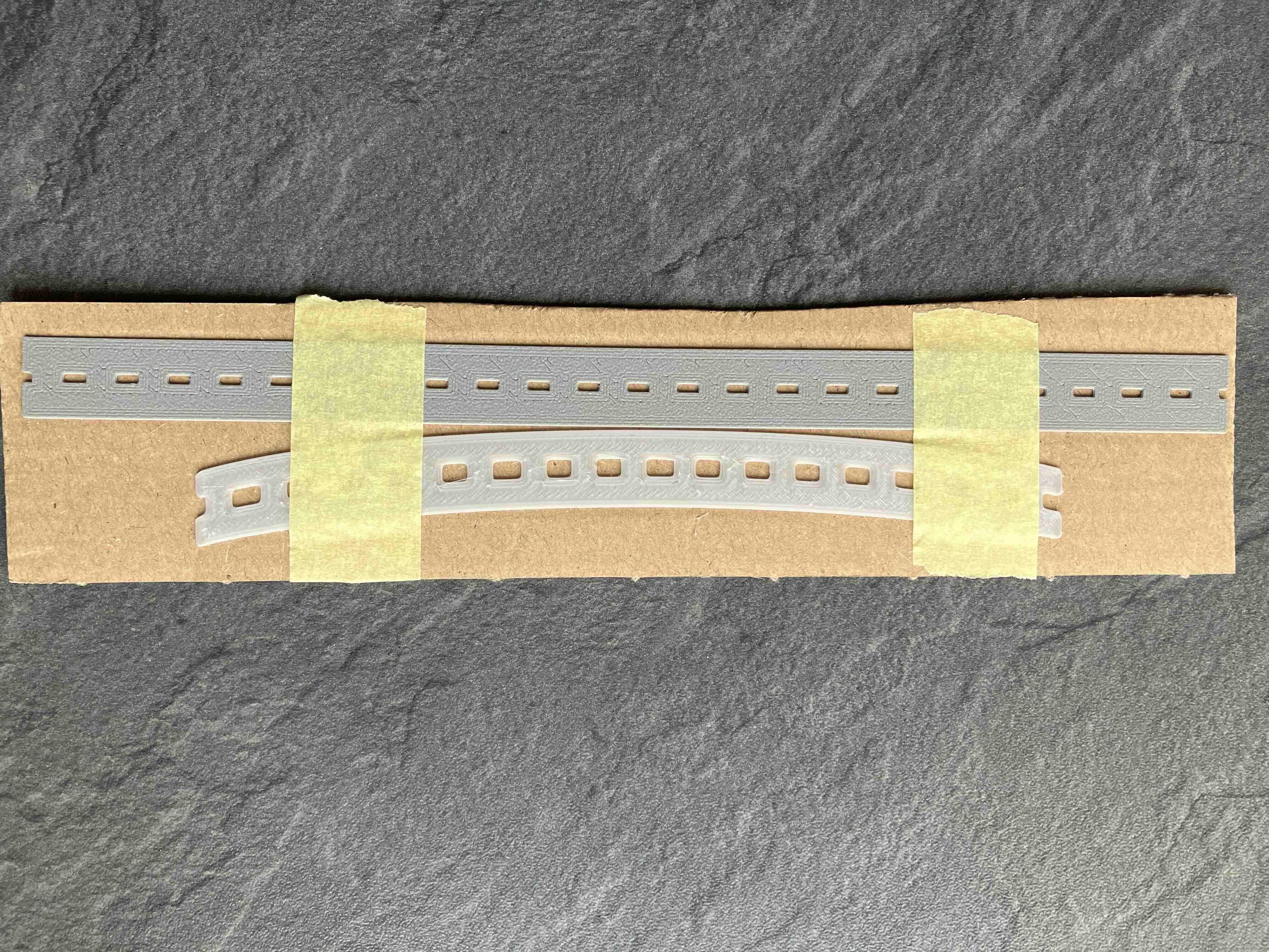

Online Alsterstreek
#21 Posted : 07 March 2026 14:43:23(UTC)
Posts: 6,117
A German eBay seller offers custom-made fillers for Märklin H0 track, both straight and curved. Unfortunately, he is only shipping within Germany.
Link:
https://www.ebay.de/sch/...p;_nkw=m%C3%A4rklin%20h0
I bought from the seller 188 mm straight and 129.5 mm R2 curved versions - see image.
