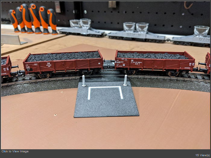

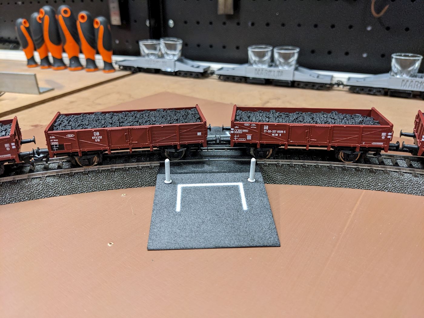

Here's a prototype road grade crossing for compact layouts or in older rural and industrial areas where the large Marklin item would be problematic or out of place. Also an issue if the way your scenery is set out requires the road to cross the rail lines on a curve - so versions for R1, R2 are also in the mill.
Held in place by C-track screws underneath the white guide posts for Volvo drivers. The bits between the rails are glued in place.
Sorry, the parts were all painted separately as they came off the printer - not in batch like they would be in a final product.
Having knocked this one up I can see a few improvements to be made - but it may be some time before I can back to this project.
Here's the zipped stl files. 3D design on TinkerCAD - user revmox.

Note to anyone printing the files - some parts are printed upside down to avoid having to use supports. Set top and bottom infill to 0 or 90 degrees to get a much better appearance than the default 45 degrees.

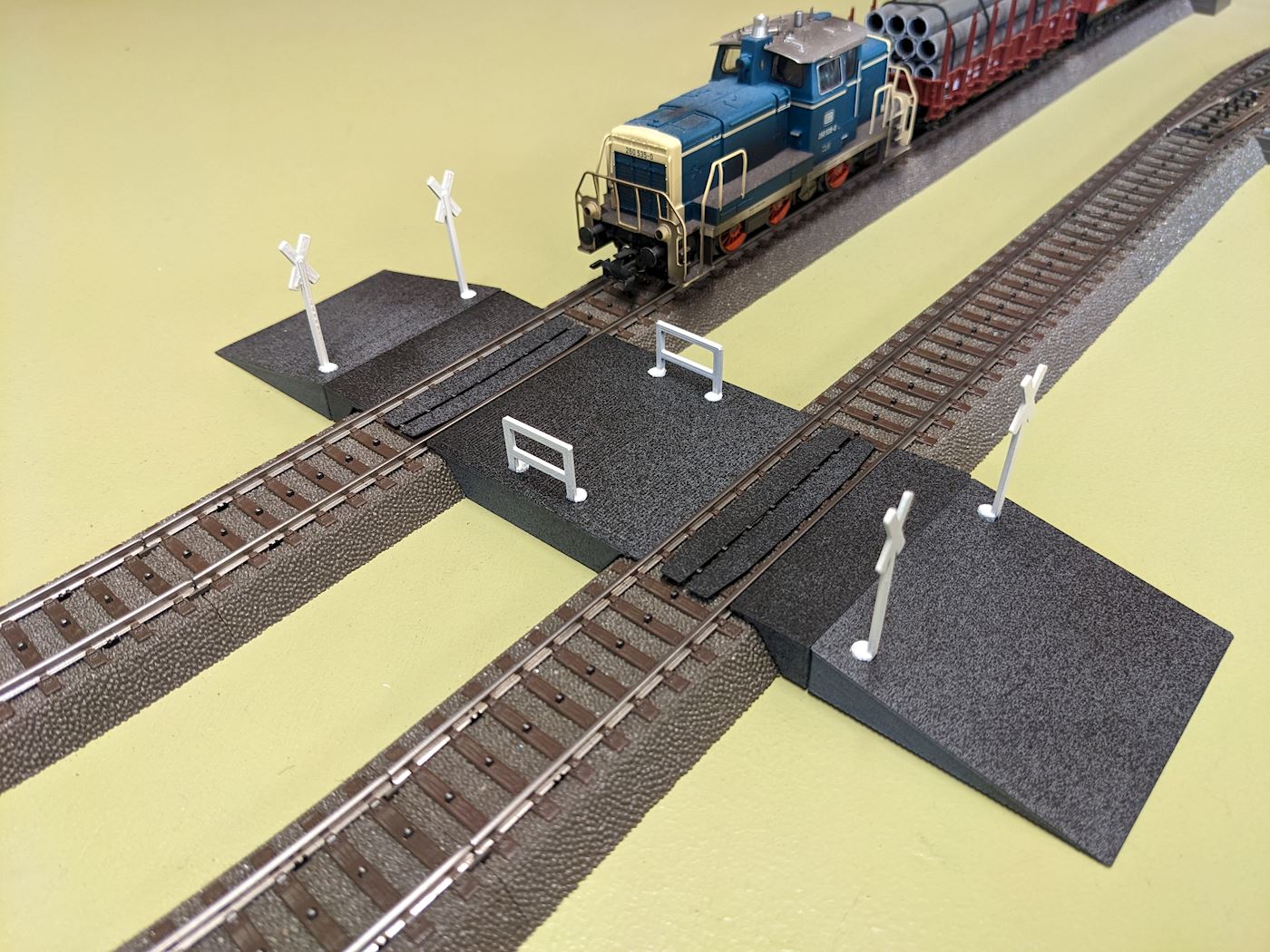

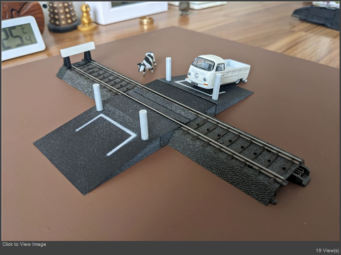

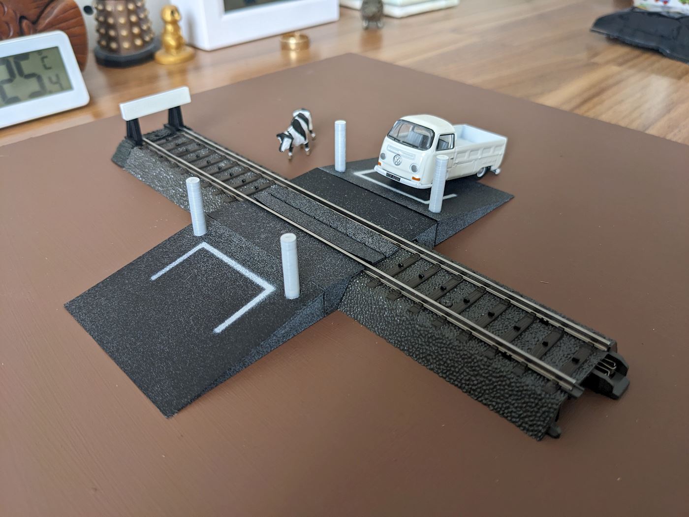

New version with easier mounting and now includes single and dual straight track, single and dual R1 - R2, single R3.
For what I'd guess we'd call an unguarded crossing in Australia - going back 50 years to when there was a lot less regulation and apparently the general population was a bit brighter.

Clearance to mounting hole centres is 8mm with 22cm coach on R1.

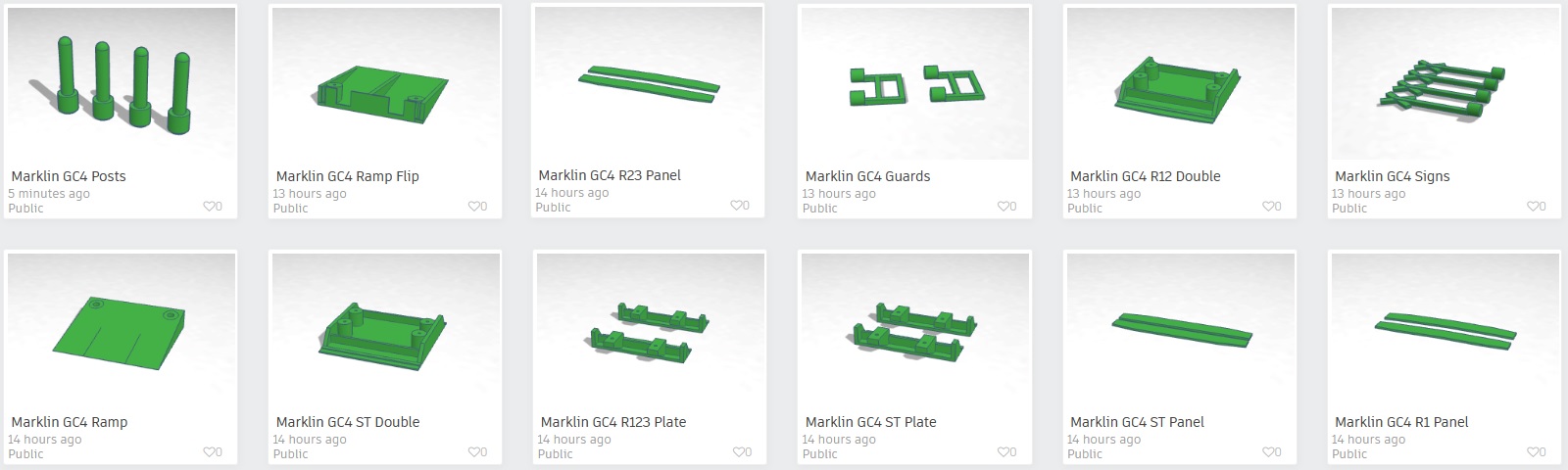

Files below and 3D models public on TinkerCAD - see original post for notes.
Hopefully all 12 stl flies in this zipped folder ... ?
