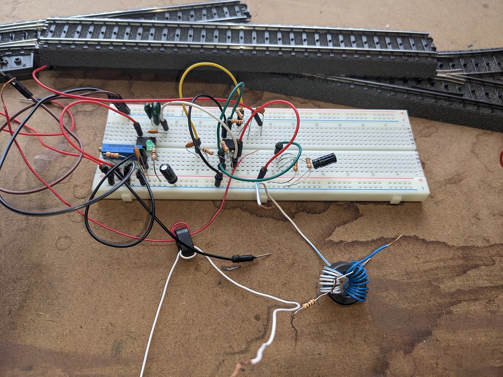

As a side issue to the CAN control capability, does anyone have a full circuit diagram of a track box - any version. I have searched several times both in English and via gleisbox schaltplan and found what looked like promising links but no luck - but usually just dead links or access barred.
Also, cables for the track box can sometimes be found cheap on eBay or Amazon under 10 pin S video cables - if you get a male to male version you get two usable project cables for the price of one.

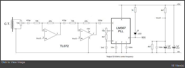

Thanks for sharing but what you present here uses an RDS component (SAA6579 or PT2579). These components are difficult to find today and expensive.
I tested the MFX feedback with these RDS components and another schematic but I couldn't isolate the useful information. So I gave up on the piss.
I was very interested when you published this schematic that didn't use RDS components. Is this the wrong way to go?
If not, I'd be very interested if you could provide some clarification, particularly on the choice of coil.
I'll then try to implement it and share my results.
MFX feedback is the only thing missing from my otherwise perfectly functioning power plant.
https://www.marklin-user...es-without-CS-2-3-or-MS2
Christophe
Thanks,
Yes, some work has gone on in the background to eliminate the need for a dedicated RDS chip and a transformer. I am working on a method to do the extraction using common MCUs or even a common-as-muck Arduino Nano as an RDS co-processor - seems quite promising so far. Getting the signal to feed into it without using a current transformer was the issue. The ZXCT1009 is cheap and plentiful - even down here, close to the South Pole.
Once the RDS carrier is cleanly extracted you can sync into an edge in the early part of the waveform, shift timing by quarter of a pulse (4.75uS), then sample every 9.5uS at the centre of the pulses. If the second part of the waveform stays in sync with the first then you have a 1, if it reverses you have a 0. Then it's just processing ...
Cheers.

revmox
Thanks for the feedback. Can you give me more details on the electronic schematic that would be suitable.
Is the schematic obsolete???
I have the skills and equipment to decode binary signals. But not enough electronics.
I know that the MFX return signal can be analyzed either by an Arduino, an ESP32, an RP Pi Pico or even an ATTiny.
If I could have the schematic of this feedback part alone, I could make a great contribution, and the control unit I've proposed is open source and works very well. It would be a great plus for the community.
Thanks in advance.

Hi Christophe,
I’ve posted the gleisbox information here as it might in some way be useful to people working through it. I’m not trying to produce a train controller – RDS is just an interesting technical puzzle for me to solve that seems to be an obstacle for those that are.
The circuit using the 567 tone decoder works but is NOT recommended – it uses a current transformer and these are always difficult for others to replicate. It has a high component count and either needs 1% components or some decent electronic equipment to set up the PLL centre frequency. The tone decoder output momentarily drops lock when an RDS phase reversal occurs and this is what must be detected. If you want to push ahead (and obviously you have seen my previous posts) then the only information you are missing is the transformer. Unfortunately, it has gone out with the trash, as I’m cleaning up in preparation for moving house but it used the same unknown core from my glory box as shown on the right in the picture of the bread boarded circuit, 17 OD, 10 ID, 5H, 2T primary, 8T secondary loaded with 10 ohms as best I can recall.
It would seem the far better approach would be to lean on Marklin’s mass produced method that is working satisfactorily in so many gleisboxes. Tracing the gleisbox path from the current monitor chip to the RDS chip MUX input should provide what is needed – and also give the possibility of overload protection to those that don’t already have it. Here’s a copy of some private chatter that may help you if you go down that path, it works on the bench detecting 1s and 0s from an RDS generator.
I’ve used an Arduino Nano, with the more advanced platforms you gain many, many things but lose that level of visibility and control. (My staff used to call it the “Rule of 4” – 4 cores, 4GHz, 4GB and 4 obscure, deprecated libraries to turn one LED on in 4 seconds. Defence contractors, who charge by the line, just love it).
First, I’ve written a program to lock into the initial RDS waveform edges – then shift by a quarter of the RDS period 4.75uS to place sampling at mid-pulse – then sample every 9.5uS to capture the phase of the RDS signal. I then take 30 samples pre the phase change point and 30 samples post the phase change point. This gives a tolerance of tens of microseconds in response time for the loco decoder. If >27 of the samples in Sample 1 are in phase with the start then I consider it a valid RDS start (allows for some noise), if >27 of the 30 samples in Sample 2 are also in phase then I consider it a valid RDS logic 1, if <3 of the 30 samples in Sample 2 are in phase then I consider it a valid RDS logic 0. If those overall conditions aren’t met then I consider the reading invalid. Easier than focusing on the exact point of phase reversal. I’ll christen this the Mox Method and work on seeing if it comes together in the real world.
Good luck with your project.

You're enlisted then! I got the code running and tested (TCP & UDP versions) as well as I can with what hardware I have at the moment. You can download it from the github repository. The pins to use for the feedback connections are documented in the README for it.
The main problem is how to hook up feedback devices: neither board offers easy connections. (I tested the hardware with breadboard jumpers and Rocrail reporting the feedback.) Male breadboard jumpers work best with the Joy-IT board and female with the Waveshare board.
I worked out a way to get sensor feedback into the Raspberry Pi using the header pins on the Joy-IT board. The Waveshare board could be attached similarly. Tests OK with Rocrail and JMRI.
feedback setup image
Another way to get sensor feedback into the Raspberry Pi pico (RPP) without a breadboard+jumpers is through this board. It provides breakouts of all the RPP pins with screw terminals and plugs into the headers on the Waveshare board.
Osoraku
Edited by user 06 May 2025 15:14:33(UTC)  | Reason: Added image of connected feedback devices & JMRI testing; also add breakout board image
thanks 1 user liked this useful post by osoraku

And don't buy consumer detectors. They're easy to make and much cheaper to DIY.
https://www.locoduino.org/spip.php?article359
thanks 1 user liked this useful post by bobyAndCo
