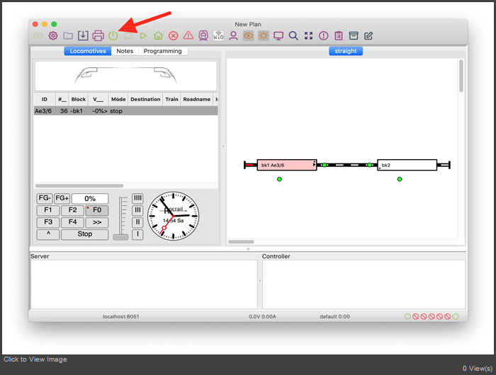

Good news! Everything is working and I am up to the point of connecting to Rocrail.
I had a little stumble, when I forgot to change the pin assignments for the waveshare board in the TCP-CAN.py file. I was too focused on getting the wifi working - I needed to set up the new MRR VLAN on the switch so that the pico would get the correct IP address. I keep my networks isolated.
If I have some time tomorrow, I will figure out Rocrail (I normally use WinDigiPet) and try the connection.
Hopefully, there will be an s88 pico pi solution so that I can try automation on the test track.
One question. Now that main.py is loaded on to the pico. Will it autostart when I start the pico, the track box and Rocrail?
Yes.

Things didn't go great, but the problem seems to be Rocrail or my understanding of how it works.
After I started the track box and before Rocrail.
After Rocrail starts it starts chatting away. If I press F0 for a loco in Rocrail you can see F0 in the messages, but nothing happens on the loco.
I thought it might be a mFx problem, so I tried a second loco and set it to MM 13 (it does not have mFx) and it would not go either.
All the testing was done without using the MS2 (and with the Pico-wave set to "master" in rocrail.
Any thoughts?

The trace shows that Rocrail is talking to the RPP & Gleisbox.
Is the power button on in Rocrail? Is the loco using the MBUS controller with the name you gave it for the RPP?
Osoraku
Online xxup
#81 Posted : 17 May 2025 10:33:42(UTC)
Posts: 9,953
Originally Posted by: osoraku Go to Quoted Post
...Is the power button on in Rocrail? Power Button? There's a power button?
Is the loco using the MBUS controller with the name you gave it for the RPP? Yes
Osoraku
I deleted all the old code from the pico and my computer, and followed your new instructions. It recognised the waveboard automatically, which means that the only file that needs to be edited is the one with the WiFi information.
Looks like your code works fine and the problem is with Rocrail. I will spend some more time on that side of the problem tomorrow.

This turns on the juice to the track - gives the Gleisbox the SYSTEM GO packet (pressing the red STOP button on the MS2). The Gleisbox, in your packet log snippet, reports a TRACK current draw of 0.00 A and an idle loco should draw about 10 mA.
Osoraku
thanks 1 user liked this useful post by osoraku
