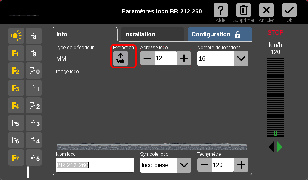

I put my Intercity mfx cab control car on my bench track with my 6021 control. It wouldn't light up with the factory mm address 29. So I booted the CS 3 to check the address and it is 10. It didn't work with that address on the 6021 either. After looking on the rear of the 6021, 3 of the 4 dip switches were on. After I set the 4th switch on, it worked with address 29. I guess the expanded format wasn't set on.
Why not use the CS3, disable the DCC and MFX protocols and then ask the CS3 to find the address?
Here is how the CS3 can extract the address of a loco installed on the programming track
#4 Posted : 24 September 2024 13:31:45(UTC)
Posts: 4,177
Thank you both 😊

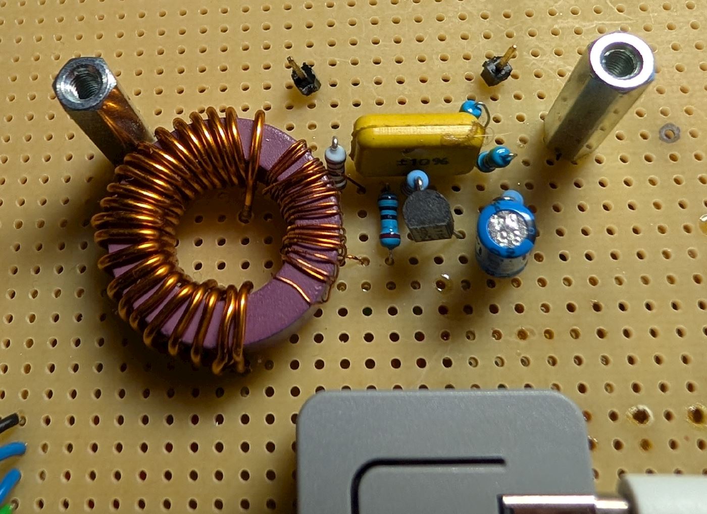

#18 Posted : 24 December 2024 09:32:34(UTC)
RCH
Joined: 19/12/2024(UTC)
Posts: 16
Location: Zuid-Holland, Delft
Hi Mark,
About the bits and pieces, I hear what you say and I'm planning to report this adventure on my website. But understanding MFX took some time, making the electronics, writing code and setting up a website will take some time too and I'm not retired yet.... So I've to divide my time.
I studied your coding work and alternative RDS decoding circuit. Kudo's! Your way of coding resembles my way of coding which made life much easier...
But I want to think out of the box and make decoding simple by trying to lose the RDS chip(s) and solve the decoding in software. Decoding from a controller standpoint is easier because you know whenever a decoder start talking. This means that (all) available resources in your processor can be used to decode. BTW I use a Wrover ESP32 but I'm thinking of switching to a ATOM Lite M5 to make everything nice and compact.
Coming back to the signal decoding. To be able to measure the signals which I generate with the software and the ESP32 I placed a resistor in between the driver and the track. The resistor value is too high to drive multiple loks but good enough to drive one lok and to measure signals going back and forth with an oscilloscope. Now the decoder uses a current source to talk back. The current from my DHG700 lok is 100mA. If I would change the resistor value to 0.2 ohm the voltage over the resistor, containing the feedback data, would be 20mV. Yesterday evening I was playing around with LTSpice, a free electronics simulator, and came up with the following circuit:
This circuit I created detects edges of digital pulses and outputs them to a 3.3V level suited for the ESP32. The simulation result looks like this:
The green signal is one side of the +/-18V signal on the track. After 250us I start to simulate a 1 bit feedback signal (should be 20mV and not visible in the simulation plot). The blue signal is the output signal on the collector of Q2 that should be used as a signal to the ESP32 for decoding. Simulation shows it should work but I'm not happy yet. First of all the feedback signal, when using a 0.2 ohm resistor, is very low and therefor sensitive for interference. Secondly the power in the series resistor, when pushing 10A, is 20W, which is a lot. Thirdly there would be a voltage drop of 2V.
So my thinking cap is still on how to improve on this.
U2 a Merry Christmas and keep you posted.
Greetings,
Roland
thanks 1 user liked this useful post by RCH

#24 Posted : 30 December 2024 17:21:04(UTC)
RCH
Posts: 16
Hi Mark,
the ferrite core looks like this:
The actual dimensions can be found in the schematic in the previous post. It was a core that I had laying around. I didn't any specs on it. I determined the induction by adding a parallel capacitor and applying a sine wave. Based on the resonance frequency I could calculate the inductance of the coil. Then plugging in core dimensions and inductance in a 'ferrite core calculation program' I found on the internet I could make an assumption of the ferrite core specifics.
BTW I managed to retrieve the ID of the DHG700 lok, being 7df8dd24 and from the LokPilot5 module f9ee151c.
I can also successfully ping to the lok.
I'm getting close now.....
Greetings,
Roland
thanks 2 users liked this useful post by RCH
Offline revmox
#25 Posted : 31 December 2024 03:57:48(UTC)
revmox
Joined: 26/05/2021(UTC)
Posts: 205
Thanks Roland,
I had a lot of toroids from various transmitters and receivers I designed but I thought I'd never use them again - they all went out in a clean-up earlier this year - typical.
I'm slightly puzzled by the resistor values around Q1 in your feedback detector - are you getting enough input signal to pull it out of saturation?
Cheers again, Mark.
Offline RCH
#26 Posted : 31 December 2024 16:26:12(UTC)
RCH
Posts: 16
Hi Mark,
bummer that you threw away a these life necessities... I know the feeling when you throw something away that you haven't used for years and the next day you need it.
About your question, the transformer has a ratio of 1:1. In the primairy side a current of 100mA will flow generated by the decoder. So you can expect this current also in the secundairy side. Together with the 10 ohm resistor this will give 1V. You can see this also in the simulation (green trace). The signal on the secundairy side is high enough to saturate the transistor.
For the number of windings on the ferrite core I used my gut feeling, since I didn't knew the specifics of the ferrite core. I would like to see less windings hence reducing the inductance but I don't know how many windings I can reduce.
Also the 1-bit feedback signal has a higher frequency than the regular data feedback from the decoder. I don't know this for sure yet because data feedback is another challenge to figure out.
Hope this helps.

I would reduce the windings on the primary side. The 10 ohm on the secondary will be reflected back as a 10 ohm series resistance in the primary, and that is far too much. I would reduce the primary to about a quarter of the turns you currently have, then after the 10 ohm load resistor put about a 1k series resistor to the base of the transistor, and a 1N4148 or similar small signal diode in reverse across the base-emitter of the transistor to protect it from the higher voltage it is going to see.
You could probably reduce the 10 ohm to somewhere around 3 to 5 ohms as well without affecting the secondary side operation, but will reduce the effective voltage drop on the primary side. I would do this as a second step after making sure the change in winding ratio works first.
Offline RCH
#28 Posted : 01 January 2025 14:53:58(UTC)
RCH
Posts: 16
Thanks for chipping in. You said I could reduce the number of windings of the primairy side to a quarter of the current number. Why not one winding? What would be the penalty?
And you did not mention the secundairy side. Do you think I should also reduce the secundairy side to the same number and keep the 1:1 ratio?
About the 10 ohms, I agree this value reflects back to the primairy side but keep in mind that during normal driving operation (=read when power is needed to drive the trains) the lowest frequency is 10kHz (100us). With a given current inductance of 28uH this means an inductive resistance of 1.8 ohms. The 10 ohm will be not dominant. And bear in mind that when reading out the decoder the track driver electronics is placed into a special state. The highest current is comming from the decoders giving feedback.
However I would like to see this the inductance value lower resulting in less losses, less windings and a smaller ferrit core. But, again, how many winding would still be feasible?
At this moment it's working (but could be improved) and made big steps in understanding the MFX protocol. Perhaps even more then I show...Drool .
I'm looking forward to your answer.
