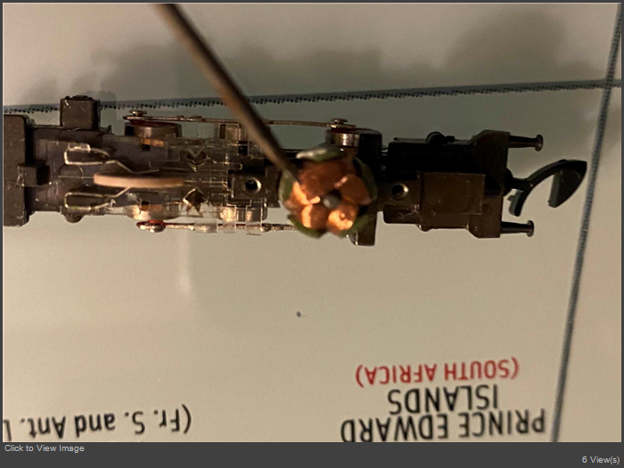

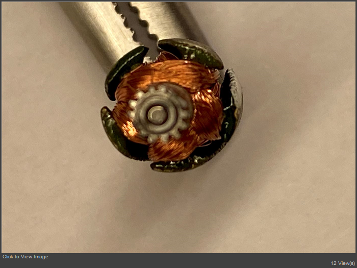

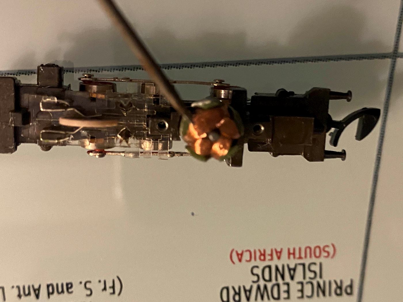

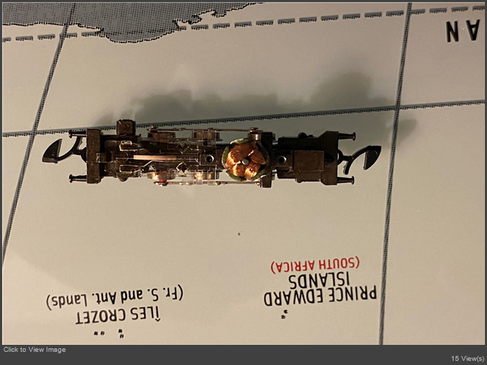

Hello again
I followed your sugestion but nothing happened.
I noticed that despite the engine being a 5 pole, only 4 windings (i don’t know if this is the correct word) were present. Photos below. Is this normal?
Sorry all, i am writing this from my iPhone, so i think the uploading of the photos didn’t sent well.
I’m on shift tonight, so maybe only tomorow i’ll be able to upload them again.
No, that motor does not look right to me.
I would expect it to look more like this:
Carim

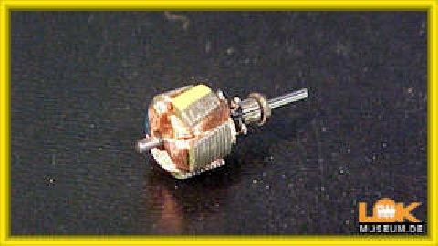

I have not used Lok-Museum, but I have only heard good things about them. It is likely this COVID-19 stuff that is causing their delay in contacting you. Just wait a while longer you will hear from them.
I have been looking for a photo of that armature. I seem to recall seeing one view from the top, so it can be compared. I have not seen nor had an 8864 type locomotive with the five pole so I am not sure it is defective. I will keeping looking for that photo, perhaps I can find it.
I cannot say how successful you would be in attempting a rewind.
I am sorry to say that I have not been much help. I did find used parts with the frame and armature together. Let me know, they were not functional and would need to be rewound. Unfortunately they were 3 poles. This might give you some experience with this process. They only cost about 5 Euros.
Don’t recall if you had it together completely but, when looking at the armature in the magnetic case, is it free spinning or do you think this defective winding is contacting the case and preventing movement? Take a toothpick and carefully try to give it a spin. It should move freely, but may offer slight resistance as it move thru the magnetic fields. No movement would strongly signal a defective piece and strengthen your case with Lok-Museum.
I sure like that little locomotive, and can understand your dedication to it.
Hello again
I just took a look at a motor I remembered I have and it is just the same. It was working until I tried to improve it so this must be normal.
I don't know if you can make it out from this photo. If not, you'll just have to take my word for it!

Hello, just another consideration. Did Lok-Museum mention that the magnetic cage should be ungraded to the new version matching the 5 pole motor?
Did you check, and make sure the armature turns after the magnetic cage is attached. It is not easy, just pinch the worm gear at the bottom and give it a twist. It should move and not be bound up.
Just trying to figure it out.
