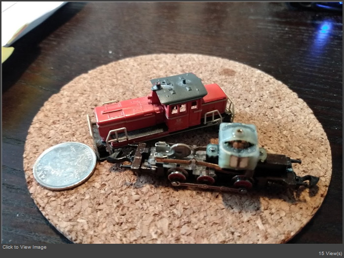

I have a little 260 diesel loco that came with Marklin 8134. It's been running like a champ, but all of a sudden tonight it's not working. I saw a little puff of smoke. I wouldn't say it's seized up, but seem to just get warm and not run. Did I fry something on it? Should I open it up and have a look? Can something like this happen to a loco, and what would be the cause? Should I try to get it to run again, or would i just end up making it worse by putting current through it?

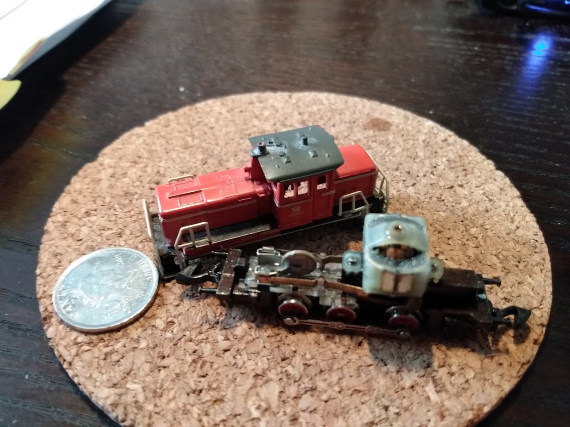

Managed to get the top off. Put it on the track again and get a few spins in either direction. But the motor itself gets very hot. Could I have a short right in the engine housing itself?

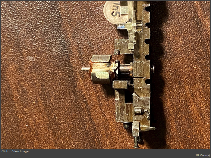

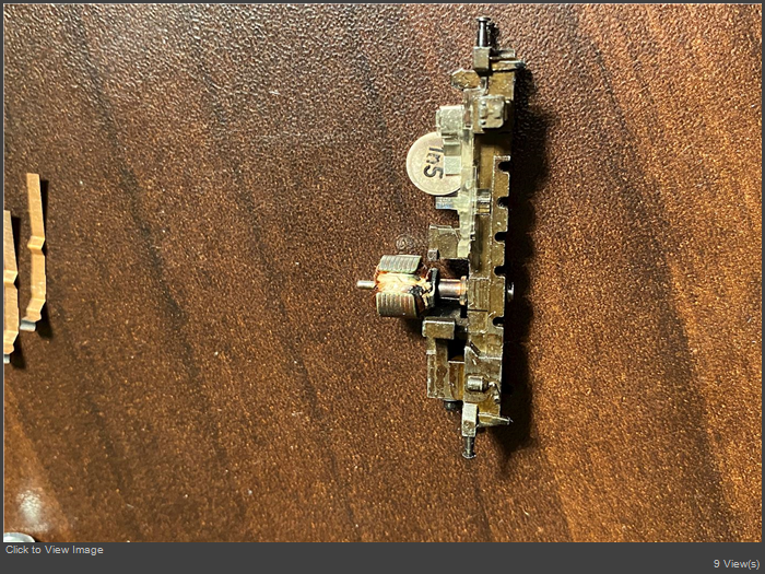

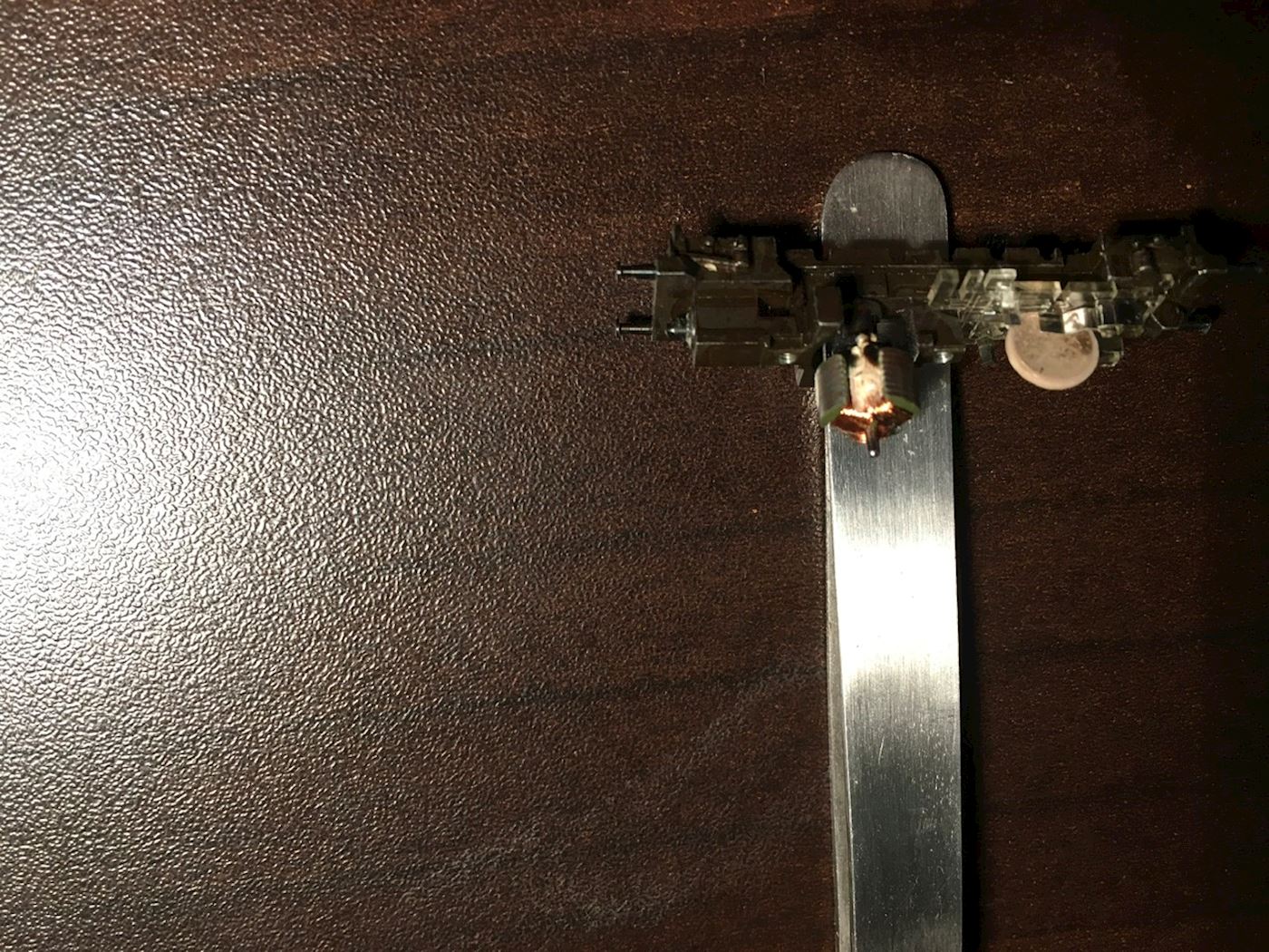

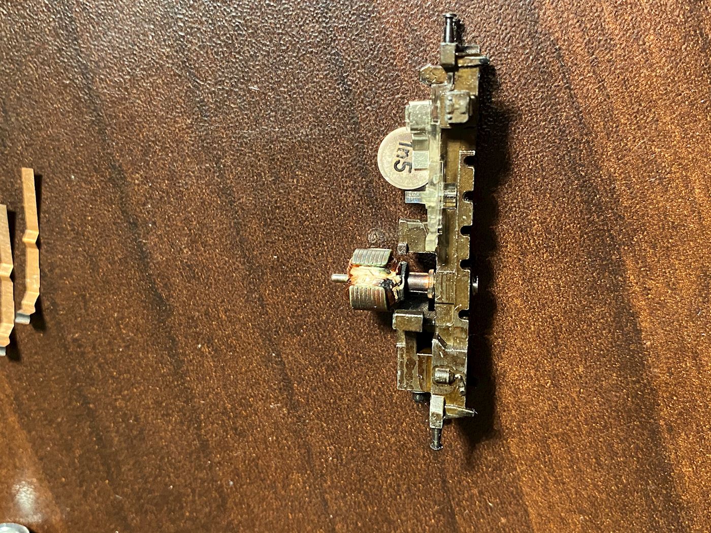

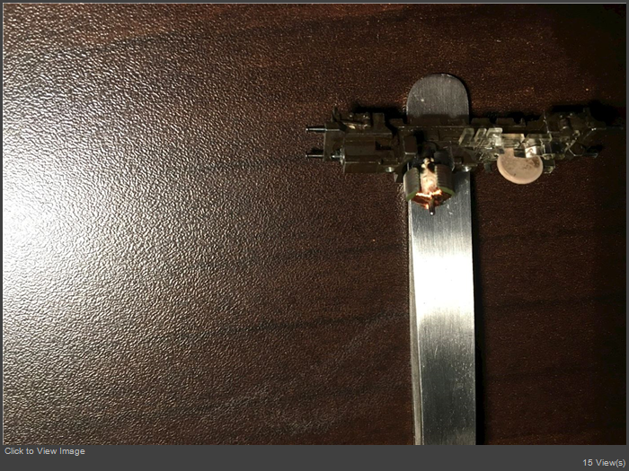

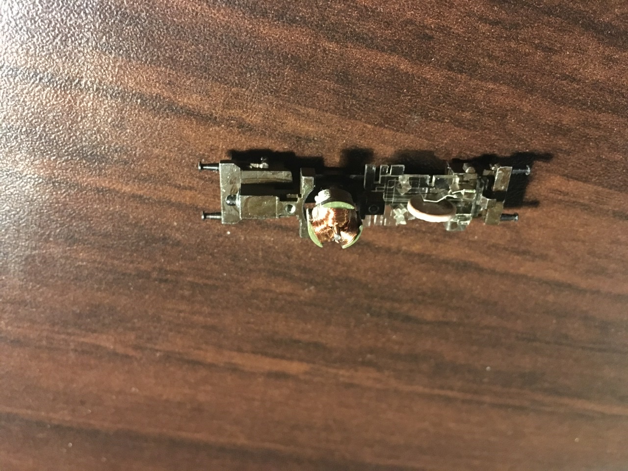

#31 Posted : 23 October 2020 23:16:09(UTC)
Rickmann
Joined: 22/10/2020(UTC)
Posts: 49
Location: Guarda, Guarda

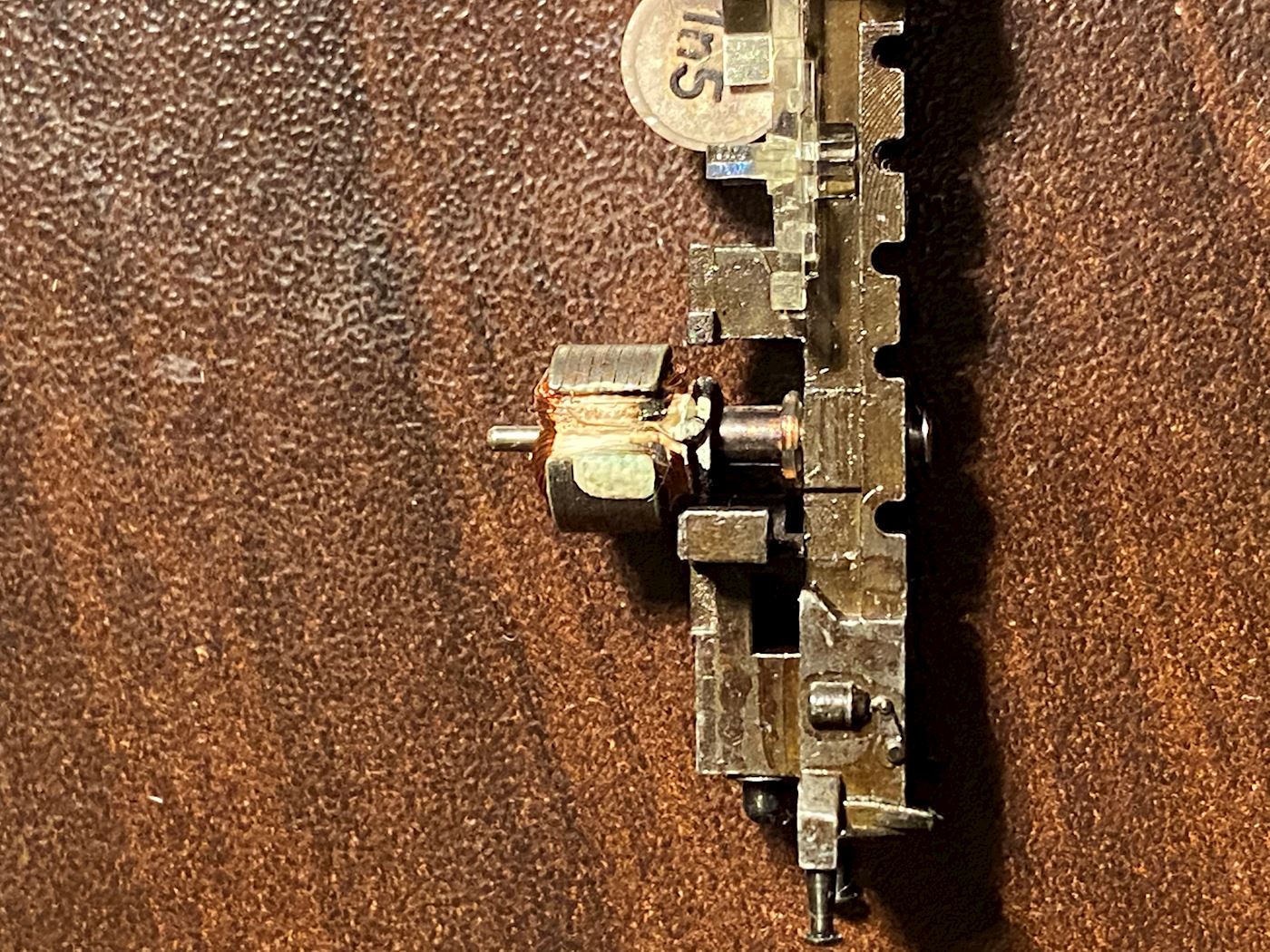

Hello everybody
So i took-apart my Märklin 8864 without any problem.
I did it inside a plastic bag (Wise move).
The engine wiring seems ok (first picture), although it has a white “stuff” that i don’t recognize (second picture).
After removing cogs and weels, i can turn easily the axis of the engine, so it is not stuck.
I would like to test the electrical engine individualy, but both poles seem to connect in the same “neck “ (Tip of the tweezer in third picture). If my knowledge of electrical circuits is correct, that would short-circuit.
Questions:
1. Where are the poles of the engine?
2. What should i test next?
Thank you.

Hi. I recently got a “new” 8864 frame and it obviously has not been used and it has that white substance on it. I was wondering if it was a type of sealer to keep the windings in place.
Best wishes
Dwight
#36 Posted : 24 October 2020 15:22:11(UTC)
Posts: 8,650
Best wishes
Dwight
Are you sure it is not zinkpest? i haven't heard of this happening to Z gauge items, but it could be possible. As it is a 4 digit model number it will be quite old (it is around 30 years since Marklin started changing to 5 digit model numbers, but the change wasn't instantaneous).
Offline Zme
#37 Posted : 24 October 2020 16:47:57(UTC)
Zme
Joined: 02/10/2013(UTC)
Posts: 898
Location: West Texas
Do you think where the zinc metal frame and armature come together (or the armature itself)there is a oxidation of some kind?
It does seem rather larger than would be needed. I don’t think it could be easily cleaned off.
Best wishes.
Dwight

Hello, here goes two photos of the “white stuff”.181AB40C-1BEF-4C45-9063-4DCD637DBB86.jpeg0210A629-CBDD-461C-9B67-44885F678582.jpeg
Even without cogs and wells, with power attached to the brushes, it will not spin.
I assume the engine is fried.
Where can i find a 5 pole replacement? I will need dedicated brushes too, right?
How will i remove the engine from the chassis? It looks like it was bolted there.

Bad news
I need your help, last weekend, with the proper tools and a spare engine I ordered from Germany, I went to my first repair attempt.
Disassembled the locomotive, removed the old 3 pole engine, replaced with the new one, connected with a new worm gear and new brushes.
Assembled everything and ....nothing.
Went back to check, double check and triple check everything. Realized that the cogs and wells were a little stuck, so I removed them to test just the engine (without wells).
Still nothing.
A read that it was useful to hand crank the engine for a while to remove any grease from the brushes and the "neck" of the engine.
Still nothing.
With a very gentle file, I worked the brushes and the engine "neck".
Still nothing.
Did I miss anything?
I handle daily all sorts of ventilators, vital sign monitors, medicine automated pumps, etc, so I am quite skillful with these things, but I must confess I felt a little frustrated....
The new 5 pole engine had a white stain (zinc pest ???) in one of the sides. Is this a sign of some age???
I appreciate all the help you can provide.
