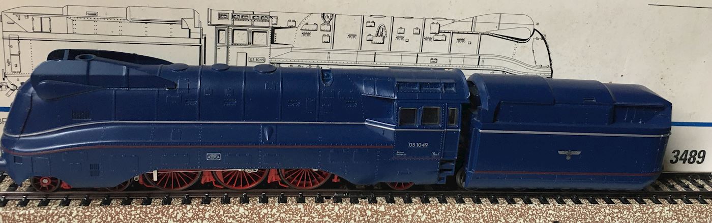

#3 Posted : 10 September 2020 18:52:50(UTC)
Posts: 3,694
I have a similar problem with this loco 3489 A streamlined BR 03 from the DRG. I have converted it with a 60760 kit
The loco runs very well but indeed, the metal casing acts like a bell to amplify the motor noise.
This is too bad as the loco looks very nice and I was considering to install a sound decoder in it but unless some of our friends comes with a suggestion to dampen the noise, it will stay like this.
Note: Yes I could set the sound to maximum volume but as I operate 31 sound locos at the same time it would be a cacophony (very un-attractive)
Please help

In this case the loco's metal body is shaped like a bell and is attached by one screw in the center with 2 resting surfaces:
- in front where the light conduit is
- at the rear (engineer's cabin) where the wires go to the tender
So I would try:
- to insert a dampening sheet on these resting places
- if this is not enough by inserting a plastic bar between the 2 sides of the body between 2 driving wheels (to stop the resonance)
Thanks to you all, you gave me great ideas
