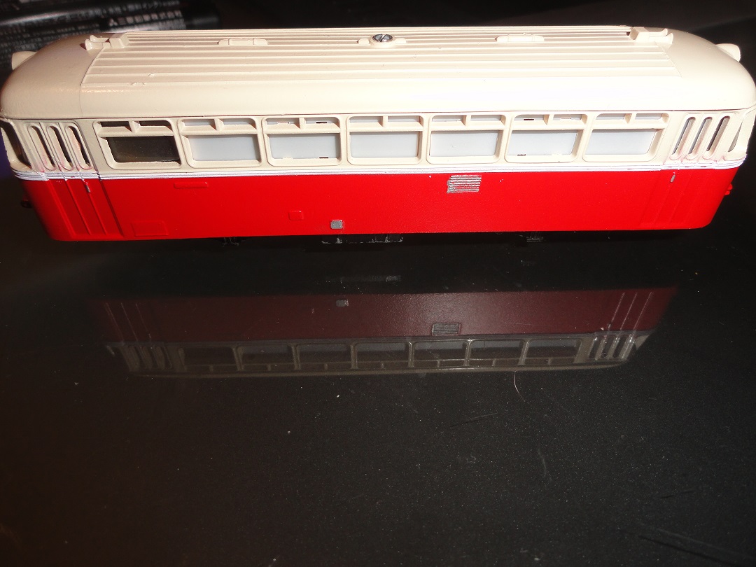

2. Plastic akku-treibwagen BR515 from blue/beige to red epoch III.

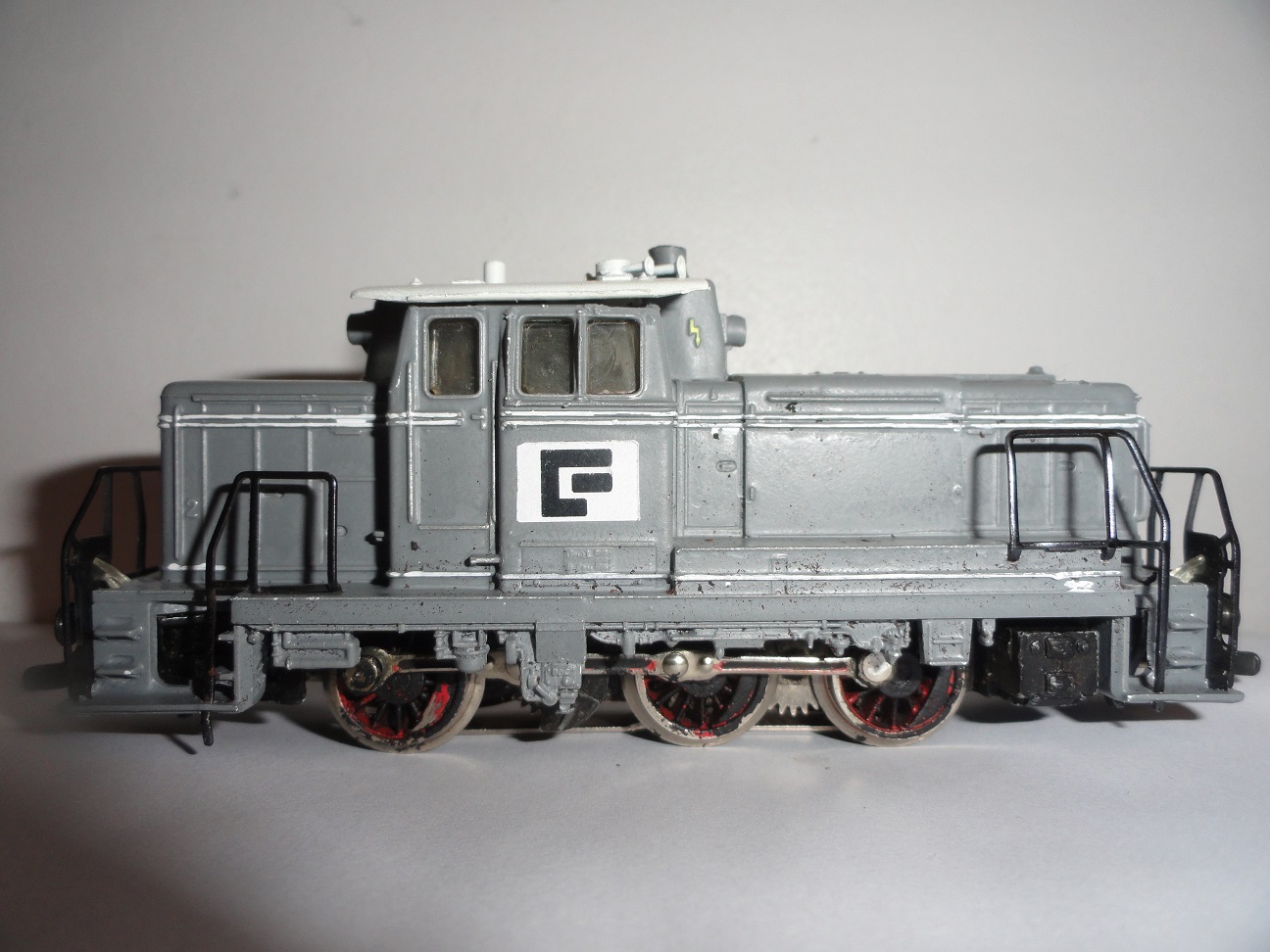

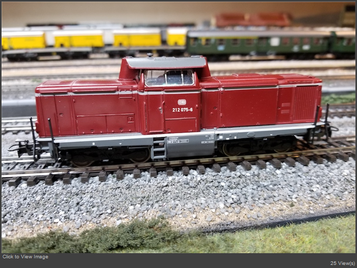

Can I see a photo of your V200 jobs, please?

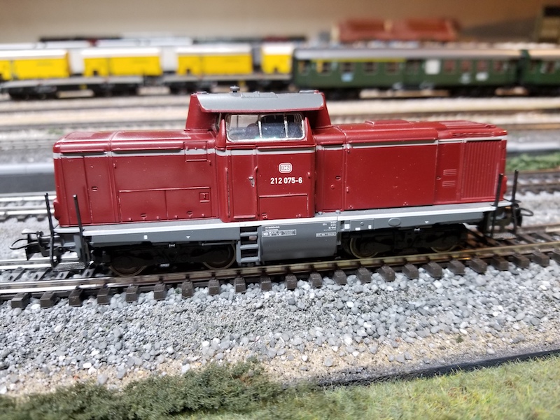

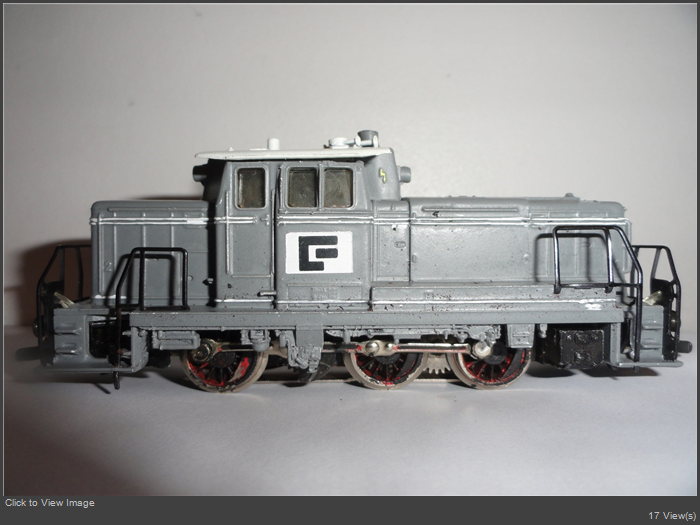

I'll post photos of the one I still have, the other one painted to blue-beige livery I sold some time ago and unfortunately I don't have photos of it - maybe I have but have to search my archives.
Best,
C.

Thing fish; The V200 is especially daring to paint. I cant really imagine how to paint the V-shaped design on the epoch III version?!
I mean... I´m only interessted in a completely professional look! lol
Oh, easy, use Tamiya masking tape; it is a bit flexible and holds pretty good. When you finish painting the body let it dry completely and apply masking tape. Make sure it adheres propery by rubbing with your finger. Once you're satisfied cut out the tape with a hobby knife with a fresh (very sharp) tip. This operation is relatively easy since the V shape line is embossed all the way. Then hand-paint the lining. That's it! Enjoy the new looks.

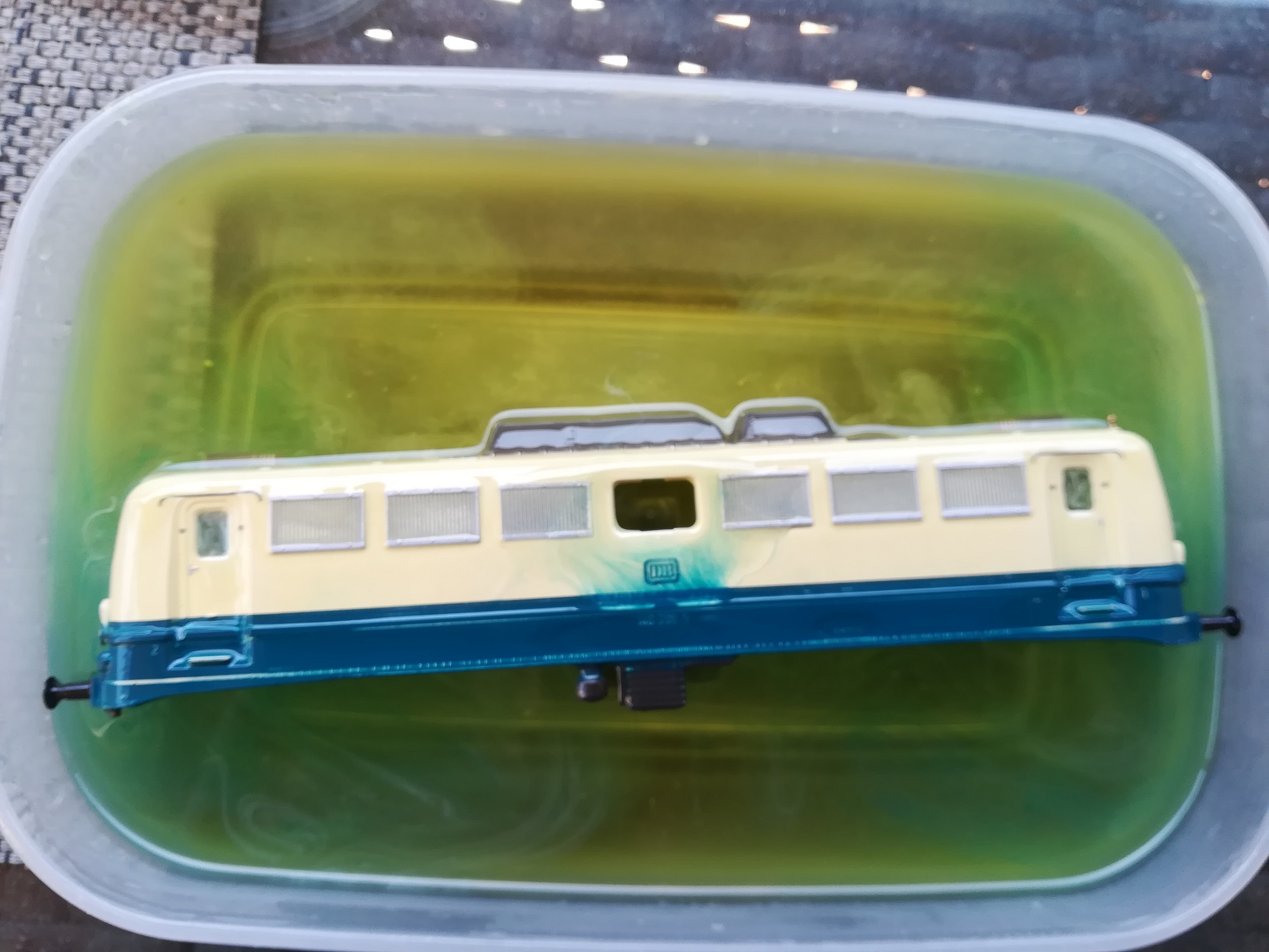

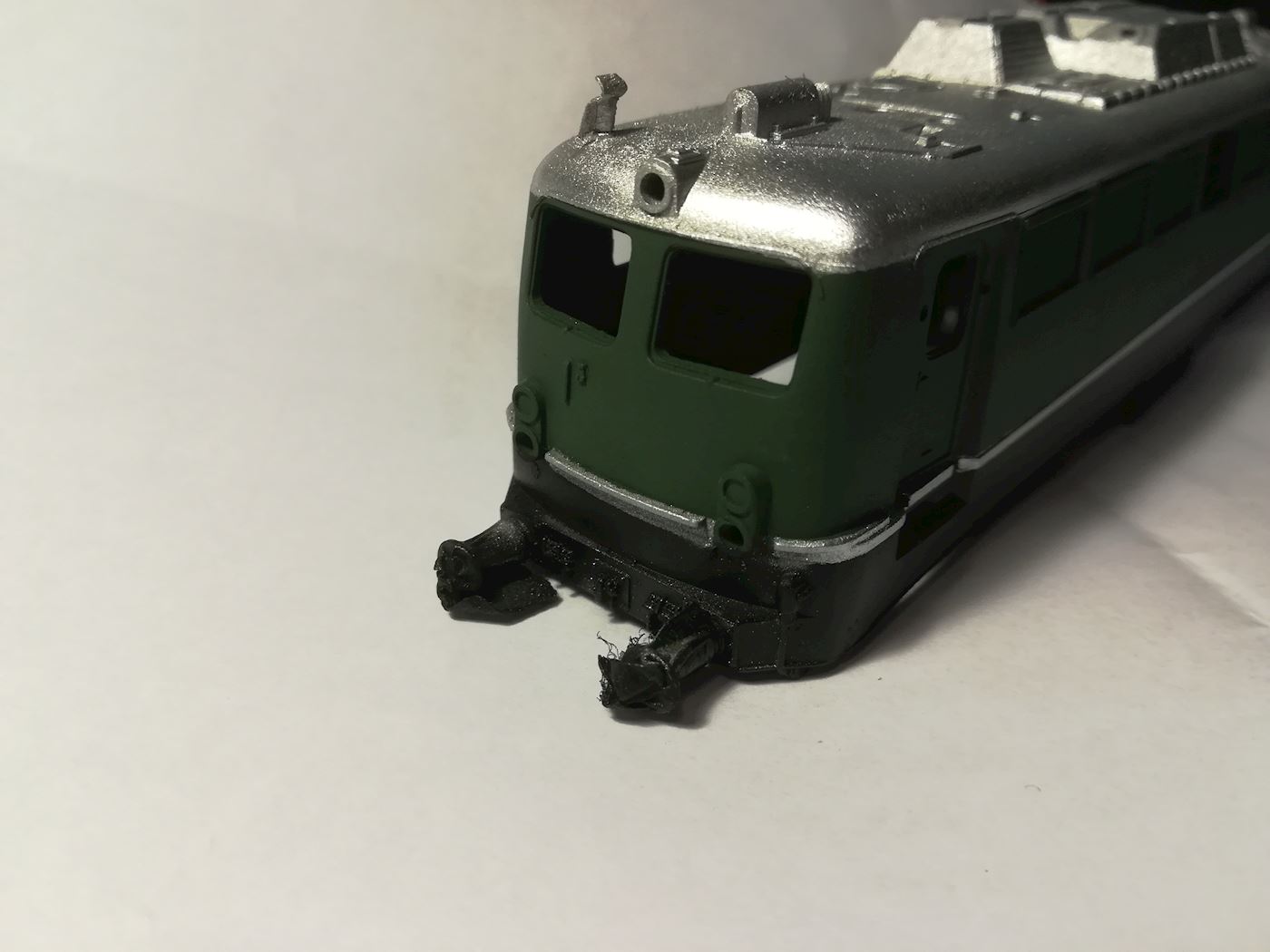

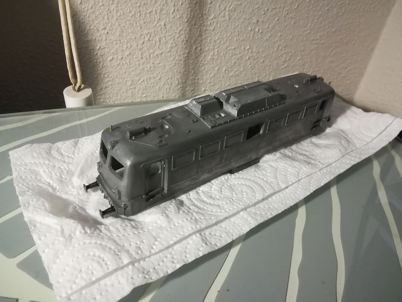

I´ve started with an epoch IV BR140.
It should end up being an epoch III E40.

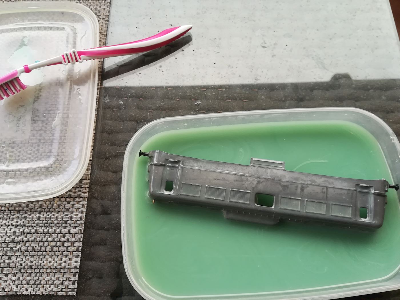

Some DOT-4 brake fluid;
This is after just a few minutes in the bath. It´s extremely effective!
After a couple of hours, and a light scrubbing with a toothbrush.
After a couple of more hours and scrubbing.
After that, a rinse in water, and then to dry;
Question; What should I paint first;The black bottom+silver roof or the green body?
I mean; If I paint it green first, I would have to use masking tape on the finished sides. Wouldnt that put the green in danger? -Any masking damage would probably be easier to fix on the bottom and roof??

So far I have painted 4 times.
I primed with a little thinner green, and then just masked and painted the green, black and silver/alu en that order.
Lots of touching up to do, as the masking didnt hold against the silver.Crying
First I will spray the ventilation grills though...

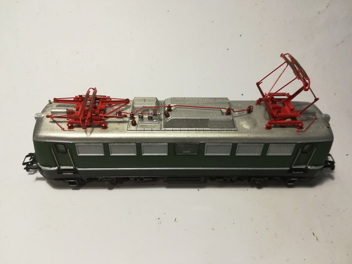

Posts: 3,660

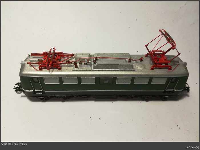

The side-vents was painted.
I think this deserves it´s own photo, as only NOW can you see some of the real E40´s character;
This time the masking withstood the silver paint. I only wish that I had known how-to before painting the roof...
thanks 6 users liked this useful post by hxmiesa

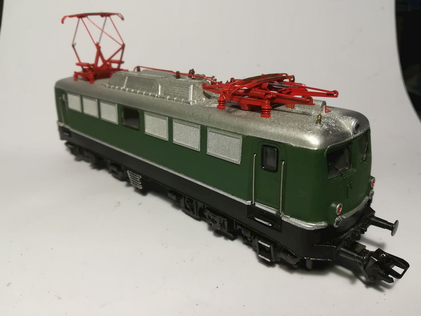

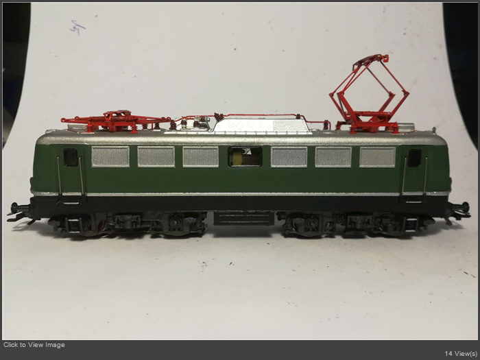

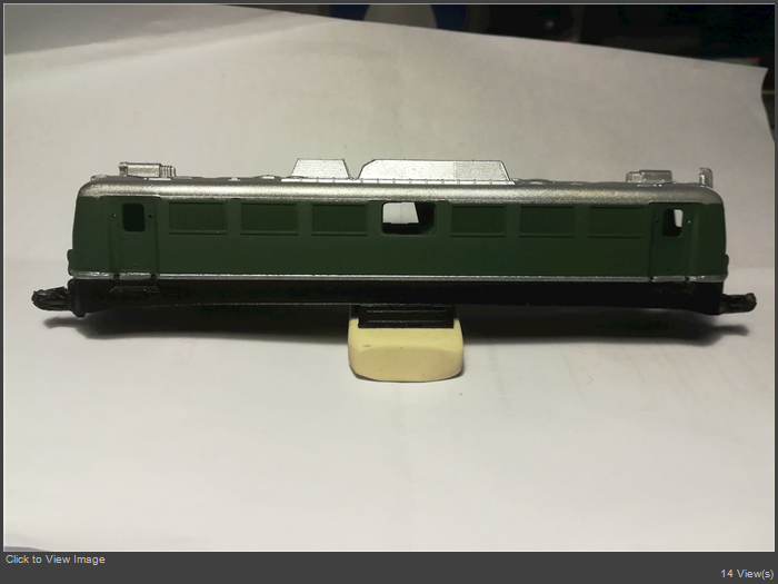

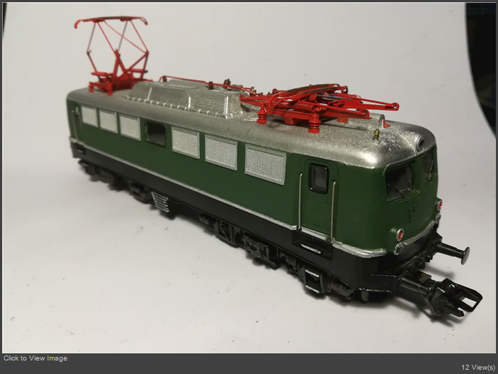

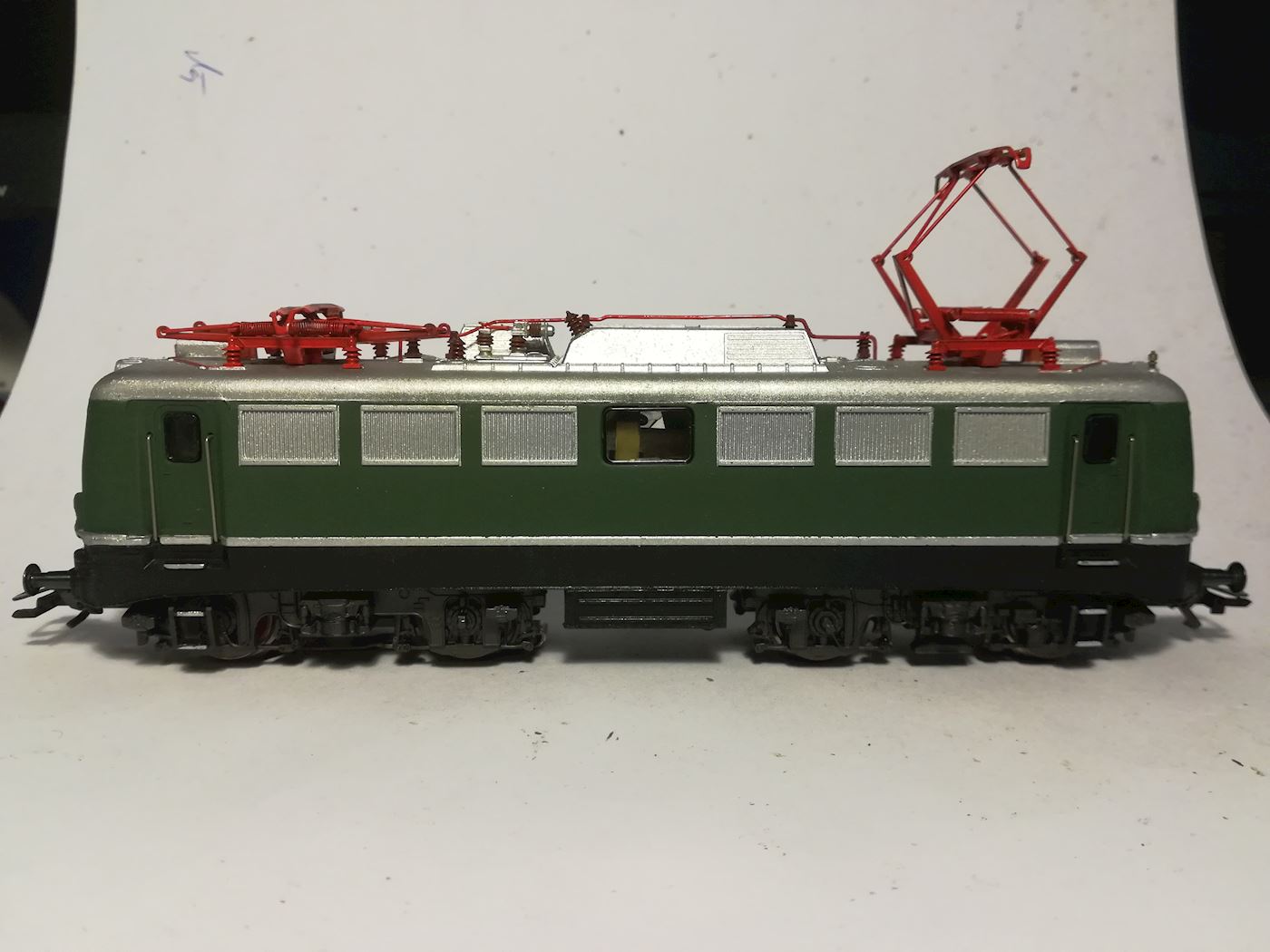

Repainting is finished.
I tried to touch-up a couple of areas, but it sometimes makes things worse, necessitating yet another touch-up to fix the touch-up Bored
Anyway, I have been able to paint a few more details, than is normally painted on the original model. (Of course we are talking about an older model here, 80´es like)
Here are some photos of the ready loco, but BEFORE decals and a final clear coat of satin-varnish.
I´m pretty happy with the result, although it is not as professional-looking as I had hoped for.
All in all the process went very well, only the silver/alu paint has caused practically all the problems visible in the photos.
Both black and green are easy to control with the masking and the airbrush pistol.
I might try to do the silver colour first, on the next model. (An even older Märklin E41)
thanks 4 users liked this useful post by hxmiesa

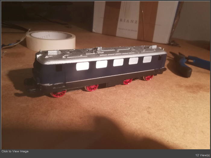

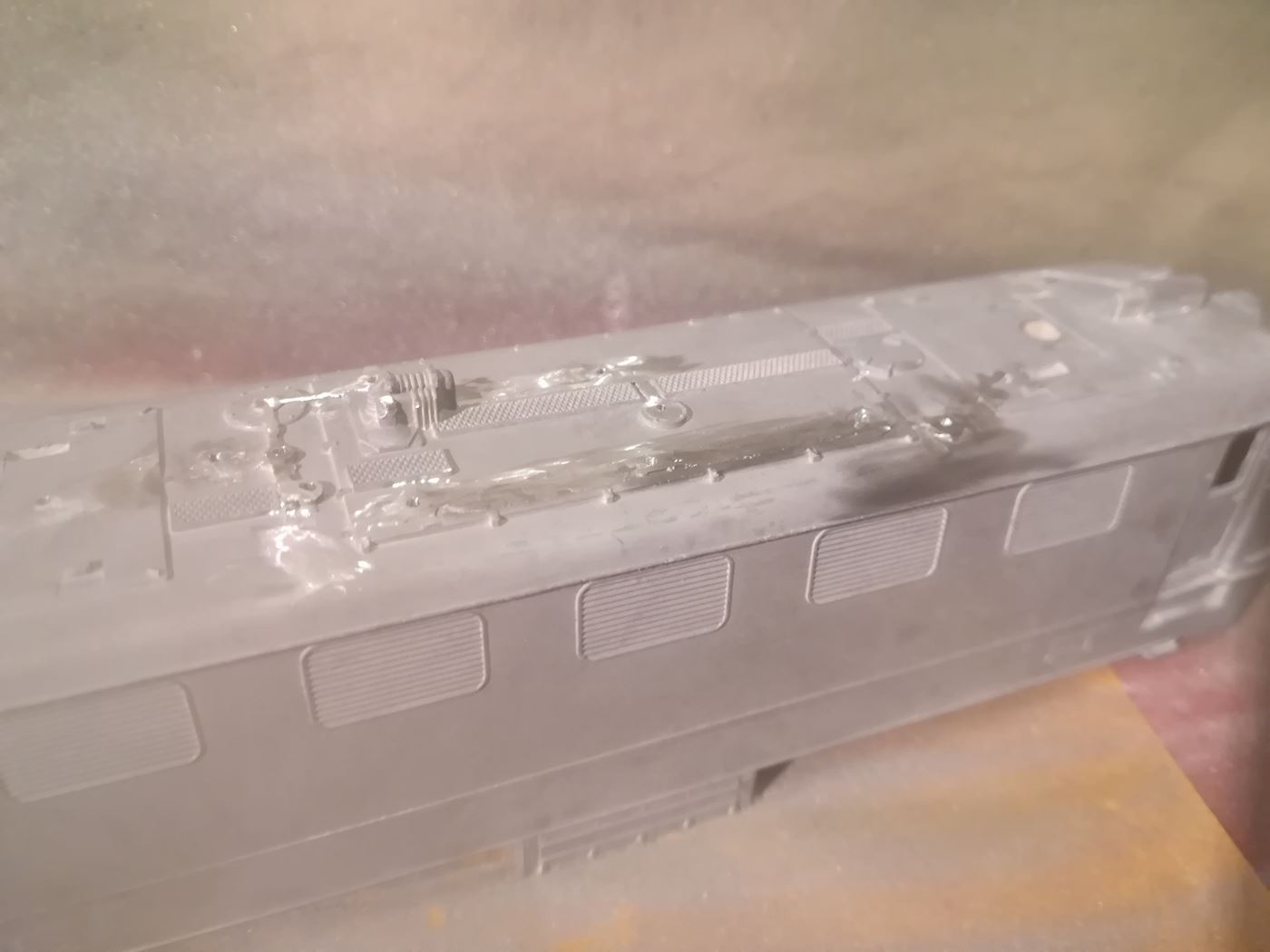

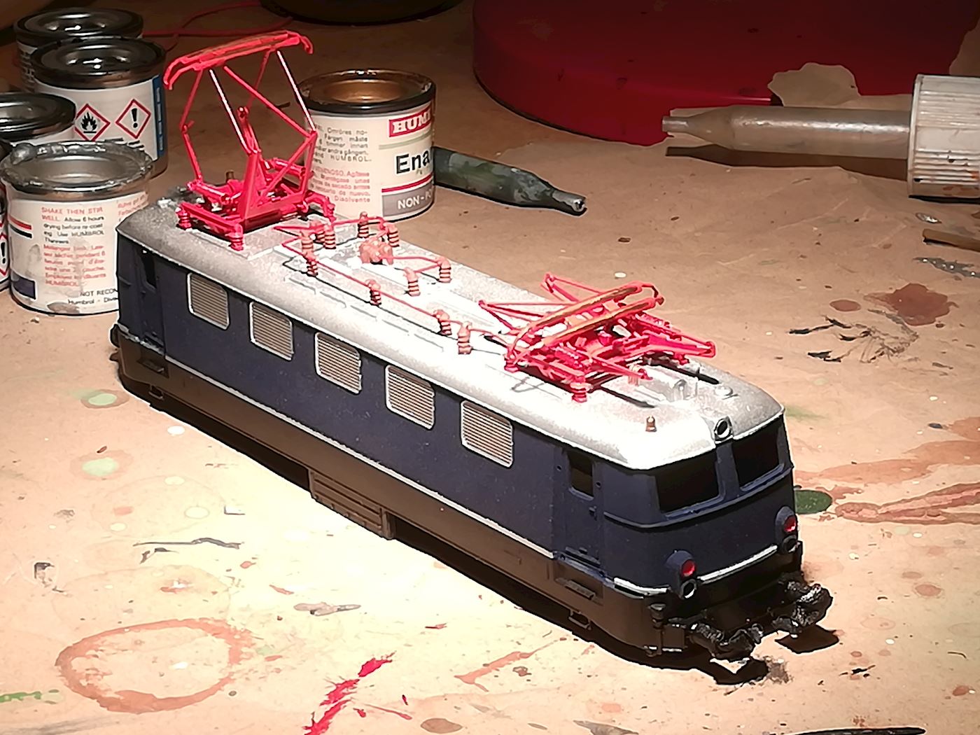

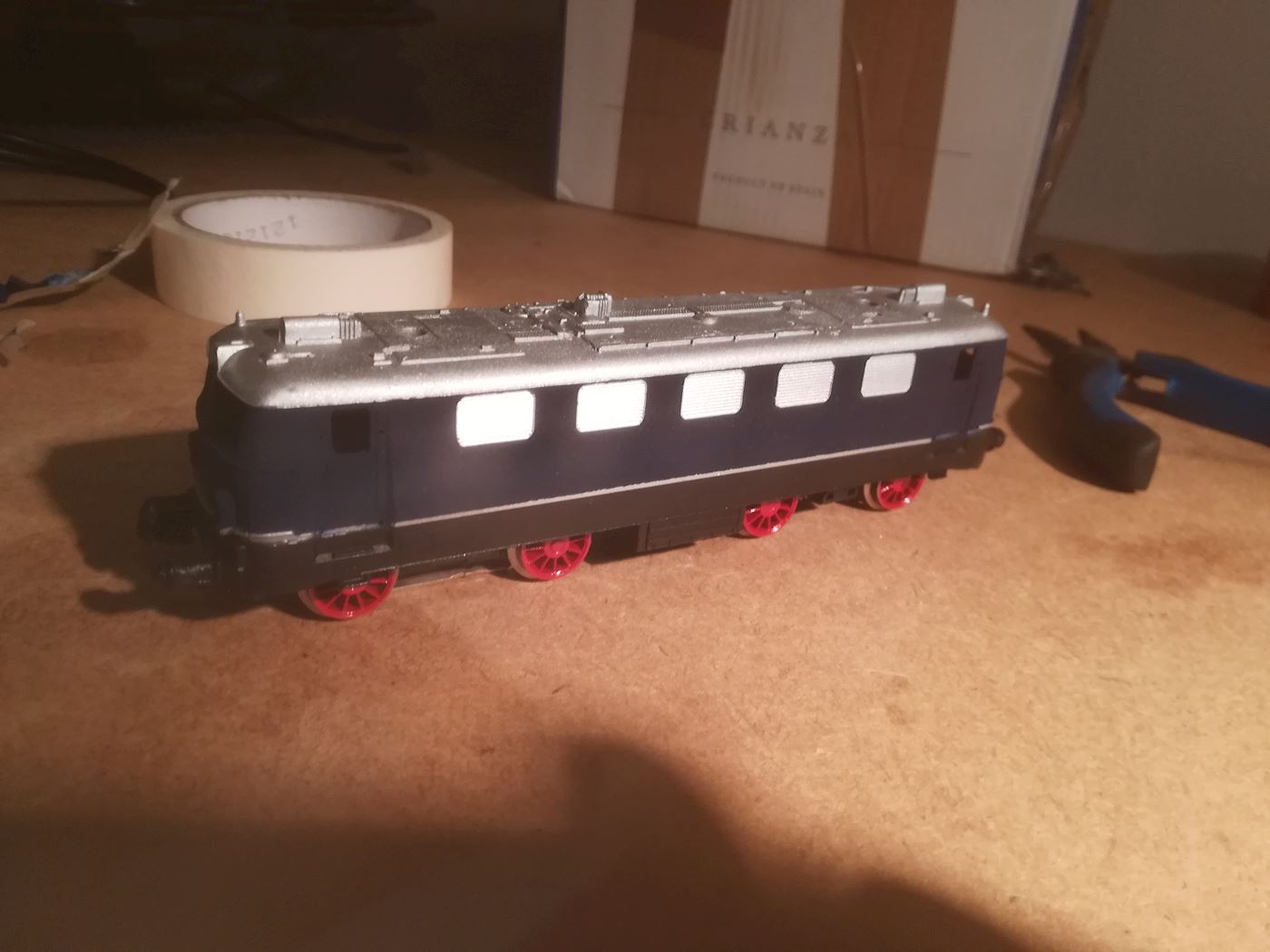

So... The next (E41) is already well underway!
Same procedure; A day (or two) in DOT-4 brake-fluid.

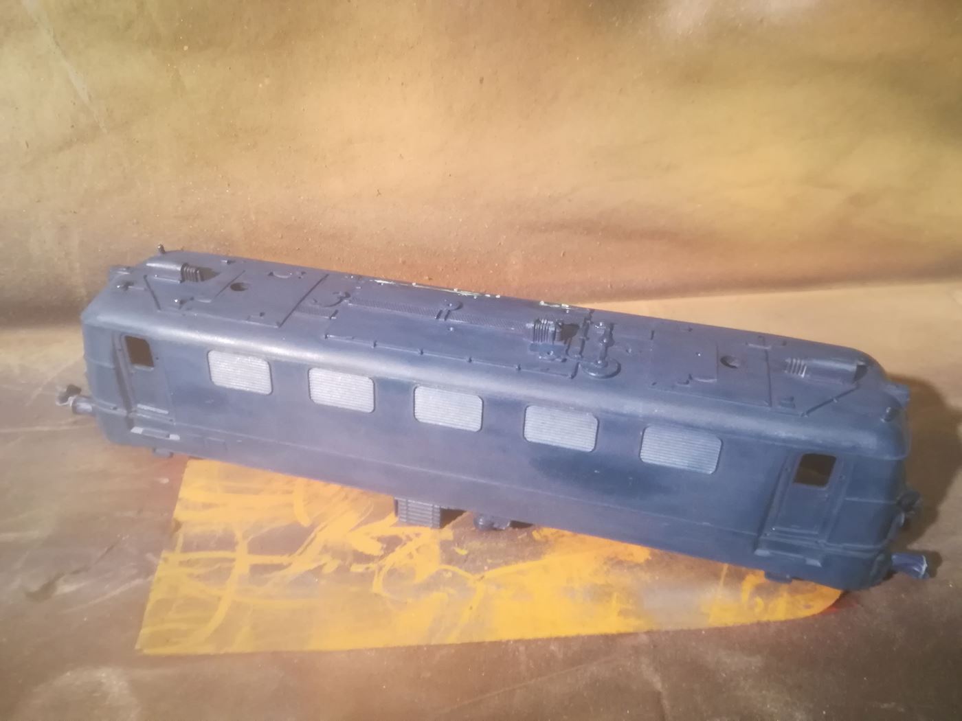

Then priming with a thin "cobalt blue".
Then doing the silver/alu colour first, as I had some problems with bleeding under the masking tape with the E40.
The old Märklin mold of the E41 has most electrical details on the roof MOLDED in metal, with very reduced detailing. This was ground away with the Dremel;
I will rebuild these details with accessories from the Hobbex catenary system, some 0,2mm wire, paint and superglue.
Holes for the electrical isolators has been bored out.
The rest of the loko gets the same treatment as the E40; Wheels and pantos painted red.
To be continued...

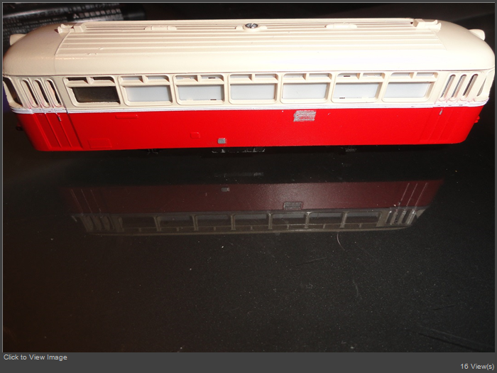

#24 Posted : 01 September 2020 21:38:41(UTC)
Posts: 3,660
Hey,
Yesterday's update wasnt really with the correct photos, so here's a quick re-update with a little more interesting photos;
Colour seems to be off Confused
The finish of the colour is matte. I tried to counter that with a coat of clear gloss varnish, but it doesn't help. It even seems to throw the tone of the colour a little off...
What to do?
Partly assembled;
Still to do;
Minor colour touch-ups.
Roof details to be scratch-built.
Windows, railings, etc. to be reapplied.
(Decals/lettering and clear varnish much further into the future...)

I got as far as this with a repaint and then, losing enthusiasm, I put it back together still in primer.
UserPostedImageIMG_3946 by dralowid, on Flickr
When restoring things I find it all goes well until the last coat!
#26 Posted : 02 September 2020 17:43:50(UTC)
Posts: 3,660
I´m sorry that you lost faith in it. The primer coat looks really smooth.
I am definitely NOT losing faith or interest. Especially after doing the E40, which I am very happy with.
I just don't know what to do to save the texture (matte) or the E41, as I need it to be satin or slightly gloss. I mean; I have both varnishes from Humbrol, but even a generous coat of gloss on the E41, didn't really help out.
Yesterday I ordered the decals that I need for both lokos, and so far I am very happy with Andreas Nothaft from www.modellbahndecals.de! ThumpUp

Reconstruction of the electrical roof-details; (Before painting);
The isolators from the Hobbex series of catenary (and their 0,8mm copper wire)
Most wires are from Faller Car System (guide-wire)
Everything super-glued together (Tried to solder it, but that was a failure)
Ciao
Offline Johnvr
#32 Posted : 07 September 2020 08:00:26(UTC)
Johnvr
Joined: 03/10/2010(UTC)
Posts: 1,307
Hello
If I can make a suggestion, would you paint the springs for the pantographs in black to stand out from the red ?
RegardsBigGrin
thanks 1 user liked this useful post by Johnvr
Offline Michael4
#33 Posted : 07 September 2020 11:04:28(UTC)
Michael4
Joined: 02/02/2017(UTC)
Posts: 708
My problem with repainting things is that my last and final coat of paint is never as good as the one before!
The OP's work is great but I agree with John regarding the springs though don't know what they would have been on the original..
#34 Posted : 07 September 2020 23:21:12(UTC)
Posts: 3,660
I made the springs of the pantos red, because Märklin and Piko does them in red too. I haven't even studied photos of the real thing...
It makes these home-painted loks look more like the rest of my loks.
Here it is again, with electrical details painted; red color for lights and brass for whistle;
Ciao...
