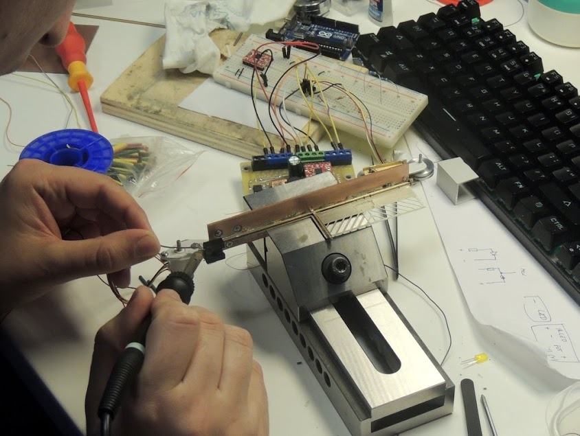

For now I can say that a high frequency of 82 KHz is selected and everything is rated at 34.5 volts (copper strips below the road)
On the underside of the vehicle there is a small conveyor in which a voltage is induced to start a small electric motor
The frequency is selected by experiments and must be equal to all parts of the road, which is aligned with many capacitors. The source of high-frequency power is self-construction
Frequency and voltage on the road are measured with a specially made instrument
All in all is not that easy to make the whole system, but if a couple of modeling friends came together it would pay off?
