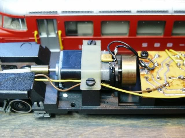

From this other topic about the ETE East show, you may know that I recently purchased a 3125 Roter Pfeil. In that thread there are also some pics of the loco and a shot inside it.
https://www.marklin-users.net/fo...ault.aspx?g=posts&t=7750
I would like to upgrade this loco with a ESU mfx decoder and changing the motor to faulhaber or maxon. Here is a shot of the motor as it is now
SB Modellbau offers a kit for 90.- Euros, which I assume includes motor, flywheel and connection to the other side to the spindle that then drives the crankshaft.
http://www.sb-modellbau.com/pro...ucts_id=488&cPath=27
By further research, I could buy ONLY the motor: if it's a Faulhaber is priced at 48.- Euros.
http://www.sb-modellbau.com/pro...ucts_id=992&cPath=67
Or I could buy the same from Maxon for 46.20 Euros
http://www.sb-modellbau.com/pro...ucts_id=985&cPath=67
My questions:
1. is it correct to assume that, in the first case, I only get the motor and the flywheel and connection at the other end or are there other items included in the complete upgrade
2. does the price difference justify buying only the motor
3. If I buy only the motor, is it relatively easy to un-plug the flywheel and the connection from the existing motot and re-use them on the new one.
I think once I do that, the installation of the decoder is straightforward. Any recommendations are welcome!

From my experience with SB-Modellbau, they will supply you with everything you need to exchange the motor, but they won't tell you what it is until you've received it....
You'll get the motor with all the bits assembled to make it fit, including flywheel, transmission and most of the times a brass spacer for you to sit the motor on, since usually it needs some height adjustment for it to reach the original gears.
Sometimes loose items like a earthing lug and corresponding screw also come in, when the milling work you need to do involves removing the previous earthing arrangement of the model.

From my experience with other SB kits: more power (not a concern here), usually much less noise and much smoother running. However, this type of can motors as supplied in the original Roter Pfeil, ugly, primitive as they may look, are sometimes very good.
As a general opinion, SB motor kits are much better in the above three respects than a M 5-star motor, added by lower current consumption, which is always a good thing.
For instance, my 34880 has ghostly running characteristics: at low to medium speeds, you simply won't hear it, period. As to smoothness, their nicely dimensioned flywheels will do you wonders since even despite I have installed a Lopiv3.0 and controlling it with a CS or MS the speed steps are not noticeable at all. It is excellent.
