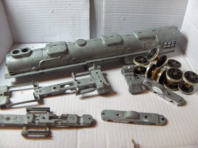

The kit has arrived (eBay off course...).Cool
We're talking the Challenger by Bowser + the super detailing kit.
the instruction booklet claims one can assemble this kit in 30-40 hrs.
We'll see about that...

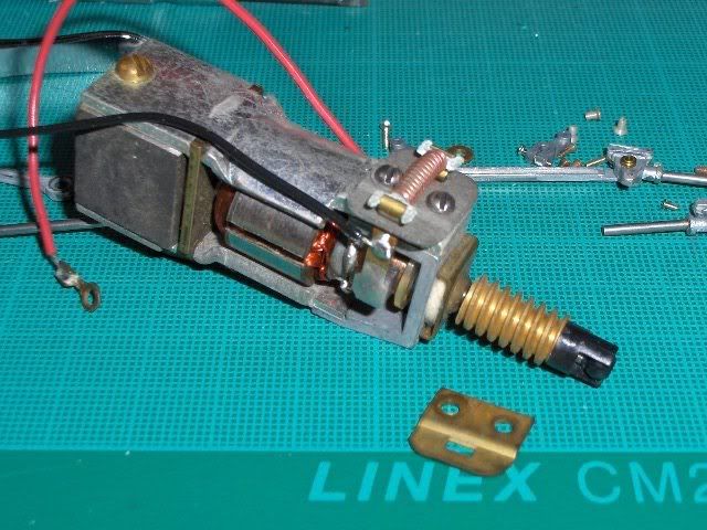

The motor is to be replaced with a DCC version of Bowser's pittman DC-71.
Hopefully there is a suitable (Motorola speaking)decoder for this motor + a sound kit.

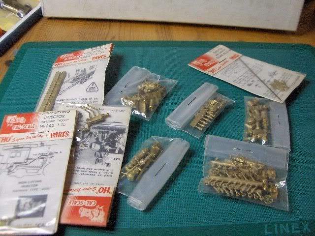

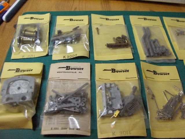

Lots of pieces!
Motor
Super detailing kit (many brass parts)
Tender (Varney)
The parts need some work done before we're ready to assemble.

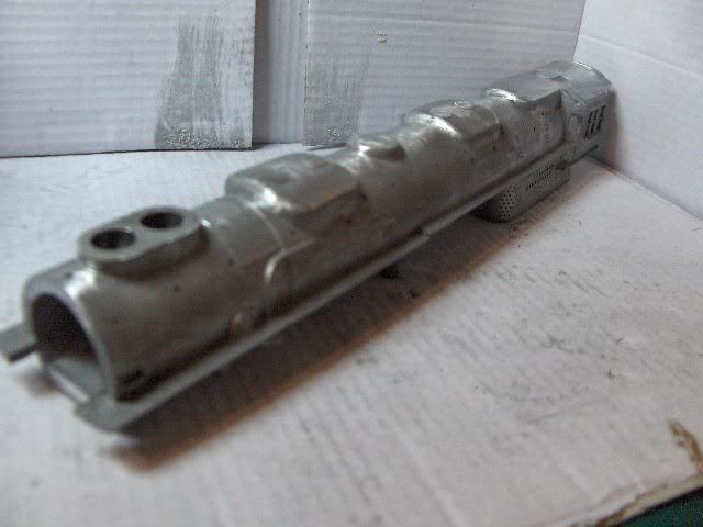

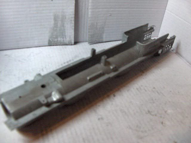

Here is a "before and after" Dremmel picture:
The shell (almost the length of the Big Boy).
So far I've spent 3 hours working with the Dremmel, files and sandpaper.

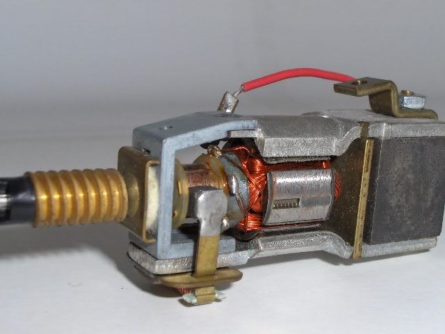

I've done some investigation about the motor and decoders for it:
Bowser states that the motor uses:
stall current is approx 1.8 amps
running amps are approx .2 to .3 amps
Based upon this information, Uhlenbrock recommended their 77500 decoder.
I've also read that (http://www.steamlocomotive.com/model/HO-steam.shtml) NorthWest Short Line has a kit that can be used as a replacement for Bowsers noisy open frame motor. I got a reply from NWSL explaining the stuff needed. Now I'm trying to figure out what they mean [:I][:I]...
Offline ulf999
#10 Posted : 26 February 2007 19:47:31(UTC)
ulf999
Joined: 12/05/2005(UTC)
Posts: 1,908
Location: Stockholm, Sweden
Information from the NorthWest Short Line model maintenance shared information databank
BOWSER RE-motor/Regearing
Driver axle size on BOWSER HO locomotives is 1/8", therefore, select a
1/8" axle gearbox that fits the reduction ratio you desire and the locomotive drive layout. In most instances of HO locomotive, the idler style provides an easier installation by getting the driveline up making connection to the motor easier. The 0.4mod size (can be difficult to install due to large size) is recommended for heavy HO locomotives (available in only 28-1 ratio) and the 0.3mod size for smaller HO locomotives although modelers report them satisfactory in all sizes HO locomotives. The 28-1 ratio provides a higher speed than the 36-1 ratio which would be desirable for 'drag' locomotives. The 2032 size motor is the most commonly used motor for mid to large size HO locomotives with the 1630 being commonly used on smaller engines such as the 4-4-2. In any event, determine the space available to make sure the motor will fit.
Installing a new (NWSL) gearbox in your Bowser locomotive does mean that the axle gear must be replaced (with the gear in the gearbox kit). This requires marking the driver location on the axle so you can be sure to reassemble the (removed) driver at exactly the same location (quarter). This can be accomplished by scribing an (off-center) line across the axle end and driver center so that you can line these marks up when re-assembling the driverset. Scribing (scratching) can be done with a razor blade or other (fine) sharp instrument.
Motor most commonly used in the K-11 is the 2032 size Sagami. This size can be used in other Bowser locomotives or the 1833 or 1836 size motors can be installed if more power is desired. One easy method is to use the single shaft (20322-9) and mount the gearbox directly on the motor shaft.
Consider installing a flywheel on the motor shaft also. For faster speed level common to a Pacific, use a 28-1 ratio gearbox. Your axle is 1/8". Select the appropriate style from the enclosed catalog sheets - you could use an 0.3mod size (#142-6 or #143-6), but if room permits (it should) you might prefer the heavier duty 0.4mod size (#242-6 or #243-6). An idler style is usually preferred because they are generally smoother running and because it permits rather horizontal motor mounting which is usually easier to fit. Fitting the gearbox into the frame may require some filing of the gear slot to make it larger.
If you decide to only re-motor, the original worm would probably fit as the original motor shaft is 3/32" while the replacement 2032 (or 1833 or 1836) has a 2.4mm shaft which is almost the same as 3/32".
As long as you're into it and have the courage, replacing both the gearbox and motor should provide the most desirable results.
See also: MODEL RAILROADER, Dec 1985, pp 94+
CHALLENGER
Original gearing: OD=0.289"-7.35mm; bore=press to .0930 shaft; L=.50" with .082" boss on each end. Axle 31T WG = .657" OD (16.7mm) x 1/8" bore x 1/8" face phenolic.
"The #159-6 HiLo really does improve the Bowser 'Challenger'. Its a pity that Bowser doesn't include it as standard. I'm now fitting the #20325-9 motor (lots of room for it) and anticipate that I will have a steam engine that runs as well as my diesels." N L-M, NY NY 1-7-87;
Installed 22401-9 motor, great improvement JN 10-7-96
Due to width of axle bearings and axle gear (both wider than usually encountered), 44-4 QUARTERER cannot fit without thinning the bearings from .160" to about .120" but this then requires adding fiber washers (split so they can be added after wheelset is assembled) to retain the bearing in proper location. RH 62927 950130 (note: use the newly released #64-4 QUARTERER II which eliminates the above described limitations).
TRUCKS, TENDER TRUCKS
Although the Bowser axle has a pointed end, they are effectively a shouldered style - replace with shouldered style (axle) wheelsets (#37107-4,
#37108-4, etc.) Depending on truck, may have to (1) shorten axle slightly (file ends back) and/or (2) file back of sideframe slightly to thin journal boss on back of sideframe.
All NWSL motors are DCC compatible.

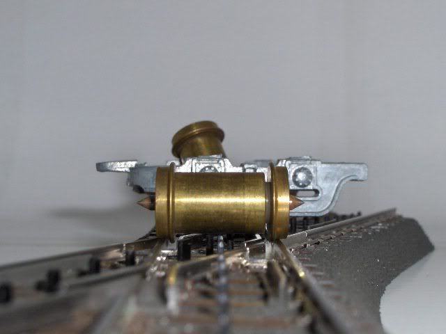

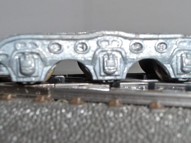

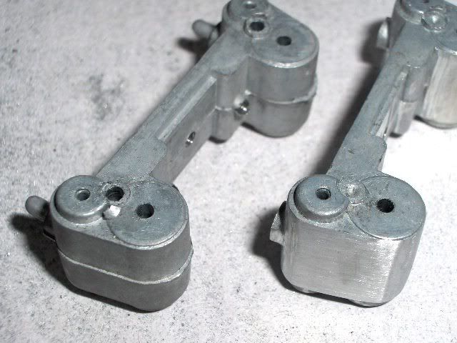

2007-03-03 - Low profile
I had some concerns regarding the low profile of the underframe:
No problems on straight rails, but what about crossings and switches where the pucos stand tall 'way' above the rails?
Argh.
Dremmel time again Smile
And we're all set: Smile

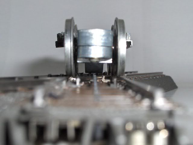

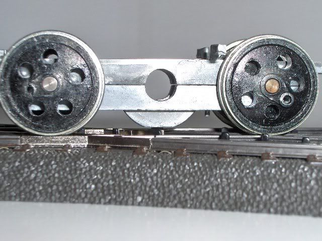

But it doesn't end here:

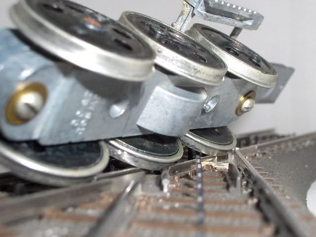

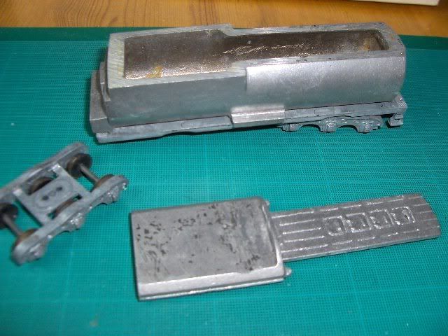

The trail trucks have massive brass wheels:
Them I'll have to replace. They are all over the place [B)]
Also the tender, a Varney, where I figured I'd try to mount the pickup slider. Has a rather low profile as well:
The bottom parts of the sides hit the tallest studs in crossings. I'll have to figure out something here as well. Larger wheels? hmmm we'll see.
#18 Posted : 05 March 2007 15:37:52(UTC)

Good progress ! I suppose the slider can only be installed below the tender.
These heavy trailer axles are amazing, never seen this before. Their large weight might be important in order to keep the wheels on the rails, and to prevent derailments. It seems there is no spring tp do that.
Hans Martin

That might be the reason!. Without heavy wheels or some other weight the trailer might derail. Didn't think of that!
Thanks Hans Martin!
I've been googling quite a bit, but still haven't found examples of conversions to Märklin. After just a few hours working with the kit, I can see why...[:I]

Why not use the casting as your pickup shoe???

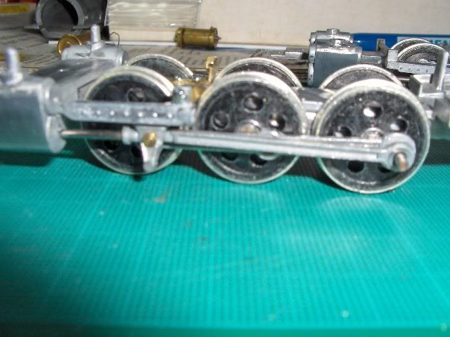

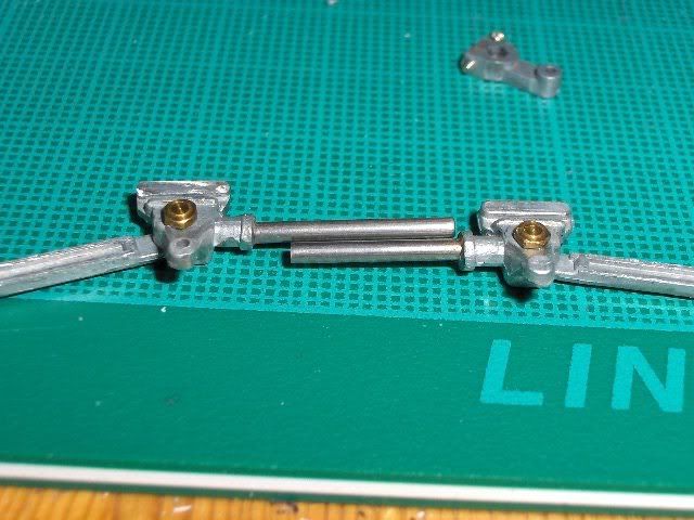

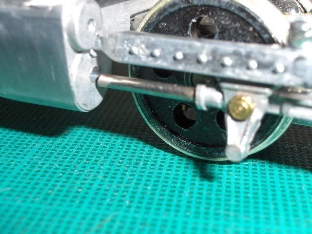

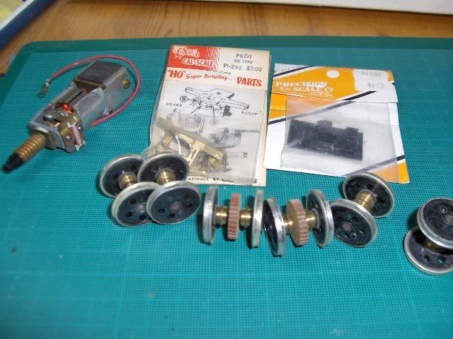

2007-04-12:
Project update.
Disappointment
I've spent a few more hours on this kit.
The greatest challenge with this kit are all the parts that doesn't fit[:(!][:(!]
As you can see here, the rod pops out of its hole over a full revolution of the wheels.
Will I ever finish this kit confused[V]
#30 Posted : 12 April 2007 19:54:13(UTC)
Posts: 31,696
Do you have any spare long rod in pack?

Hmm, that's a problem indeed.
Could it be that the gear valve from the other driver truck fits better ? AFAIK they are not completely the same.
Another idea: if you turn the driver wheels such that the crank shaft is in its front position, is there still some space remaining between the crank shaft head and the cylinder ? If so, I wonder wheather it is possible to shift the cylinder block 1 or 2 mm backwards.

I have to admit at close view the castings look very crude - not sharp at all. You can get the lionel HO Challenger on ebay and convert it with a lot less labor. This looooks very difficult.

I give you a great amount of credit for trying to build this model. It doesn't seem to be a project for those who can't spend many hours working on it. The close detail photos re great but they show many flaws in the castings. I hope your efforts will payoff. Maybe its not ment to be run on your layout. It might make a nice piece for the scrap iron yard you will build next.

Steventrain: sorry no extra rods [:(]
Hans Martin: The other driver truck is ok (it has a much longer rod)
The Cylinder block (and most other parts) have pre-drilled holes. I Guess your solution could work if I use glue instead of the screws to fasten it.
Edited:2007-04-13 : No, they're not switched. the other set has much longer rods. It was related to fabrication errors.
Frostie: I'd go for the Lionel... This kit is from Hell I believe...[}:)]
Stephen: Good idea! in a scrap iron yard or as a wreck in a loco terminal...[B)]

where your rod is popping out is there a possibility that you have the cylenders flipped 180 degrees around.
DT
#38 Posted : 12 April 2007 23:52:23(UTC)
Posts: 3,594
[size=1" face="Verdana" id="quote]quote:Originally posted by ulf999
Sorry for my ignorance but... Isn¢¥t that what Hans Martin said; could you have accidently switched the two sets of rods, and simply must switch them back again?!
Offline dntower85
#39 Posted : 13 April 2007 01:58:57(UTC)
dntower85
Joined: 08/01/2006(UTC)
Posts: 2,218
no I'm saying that the front of the cylinder could be at the back if the part was installed in reverse, the holes for the rods may have even been drilled on the wrong side from the factory. Its hard to tell from the photos, I can't see if the mounting holes are drilled on the centerline or if they are off set a bit.
DT

2007-04-13:
I took the whole thing appart and compared the pieces:
There are a few missing mm here [:(]
It seems that I once again will have to place an order to replace broken/missing/failing parts. [:(!]

Motor dcc ready:
As described at bowser-trains/dcc. I ordered the new brush plate #22193 (and a few more parts...) and installed it.
Before:
After:
#42 Posted : 13 April 2007 15:55:47(UTC)
