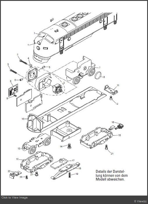

Marklin 60976 Diesel sound decoder install to Marklin 30601.....
Have the new Marklin F7 #30601 that has a digital MFX decoder for headlights and directional control already factory installed.
This is an AC motor of course so no conversion kit would be necessary.
Looking to add sound using the Marklin 60976 Diesel sound decoder.....
Has anyone done this... thanks....

"It has a dc motor, not ac"
Well, it has the slider pickup for the center 'rail'.....which would be for AC.....

Just received the diesel sound #60976. Looks like thr mother board on thr 30601 needs to be swapped with the 60976 mother board.
It is NOT simply taking the 21 - pin decoder and pressing it on the existing mother board on the 30601....??

You don't have to swap the boards if you find a way to connect the speaker.
That's the issue....the 'new' mother board has 2 connectors mounted on the board to plug the speakers to.....but the 'new' board isn't connected/wired to anything if just plug in the 'new' 21 - pin sound decoder into the existing mother board.... ??
