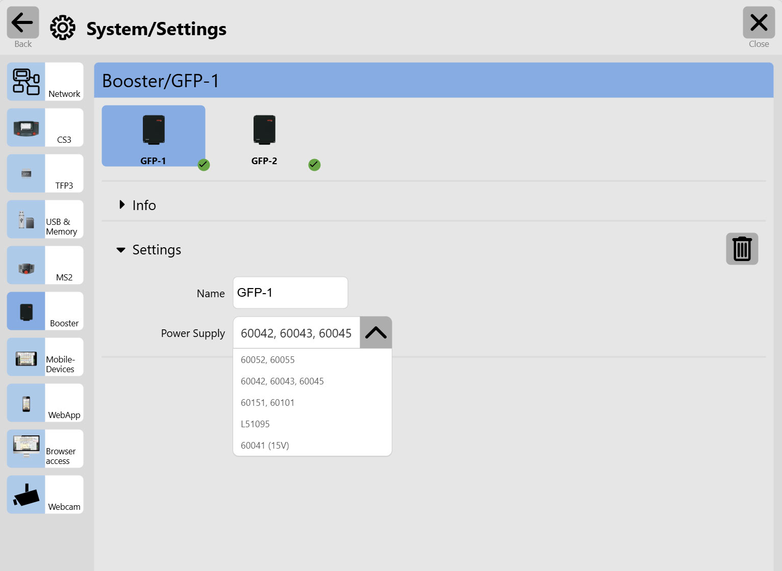

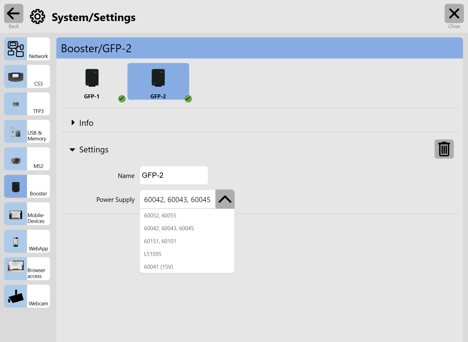

I believe that if you correctly set the Transformer/PowerSupply setting to match what is actually connected, the appropriate threshold will be used
My observation is that a booster driven by a transformer will readily provide > 22V in the early (no/low load) stage of the V/Load curve.
With the CS3 having set such a connection as for a Transformer (60052) there is no short message
If you set it to a PowerSupply , you will get the message.
Noting that there is also a 15V setting - for use with the 6004x when the Switch set as such.
As an example the following images show the same booster with a) 60052 defined b) 6004x(not 15v) defined
Note that the voltage reading is about the same, BUT the scale and red threshold changes
This may not be the only refinement with the new code,
For example in my case The product code has been courupted randomly.
a 60173 now shows 6017
a 60213 (internal booster) now shows 6021

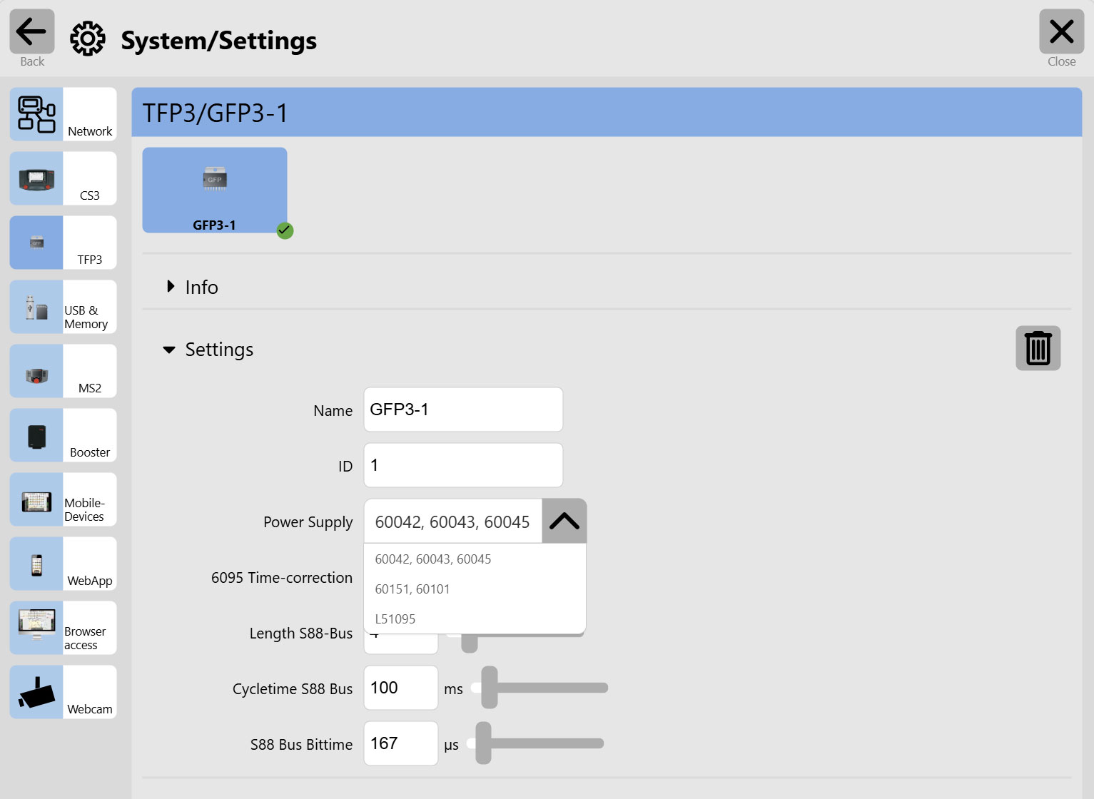

Posts: 2,464
Why is the correct article number not entered in the lists?
The CS3 (GFP3) does not support a Transformer
So I can understand the 6005x not being present.
Similarly, it is designed for traditional H0 (1) digital operation
i.e. 19-22V
So the 15v option being missing is understandable.
but I agree it is hard to conceive a layout configuration controlled by a CS3 delivering 19V
AND a booster set for 15V.

Hi MSanches,
I will recommend that you are looking at how your power supply is configured for your CS3, and for boosters, if you have any.
I have heard that others have fixed the problem by updating the power supply configuration.
If you want to go back to the original version 2.5.2(6) software, you should download the software from Märklins homepage, and load it to a USB stick.
To install it, I recommend to remove the network connection and remove the CAN bus connection, and insert the USK stick into the CS3.
To load the software, hold down the left speedknob and the STOP button, until it starts to do the update.
After rebooting, you can connect the network an the CAN bus again, but you should avoid to do updates when the red dot shows up.
Per
