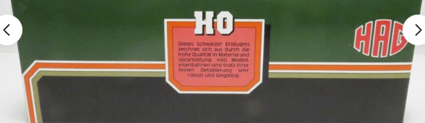

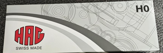

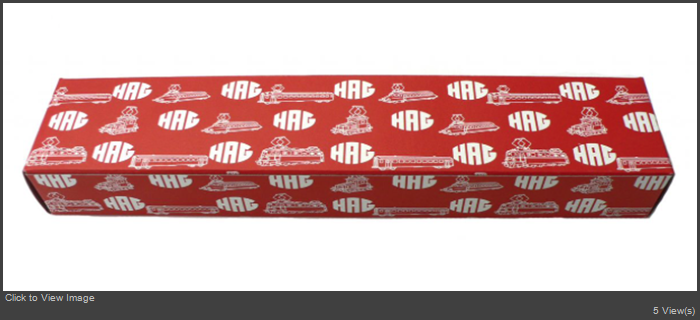

To all HAG enthusiasts: Here is an additional bit of general advice when you are for instance standing at a flea market and see a HAG box on a table. These are the most common box types in chronological order from old to new. The first three should usually contain a "traditional" HAG product from the good old days, whereas the fourth one signals "caution!".
Of course, this only applies as long as nobody switched boxes, for instance because the foam inlay had deteriorated:
thanks 4 users liked this useful post by Unholz
Thank you very much, Stefan, this is also a very good and usefull information
