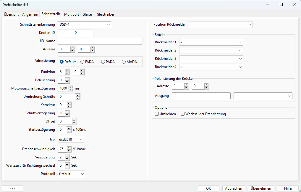

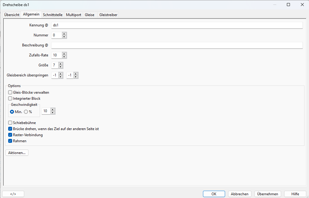

Here is how the configuration is
Allgemein (General)
Schnittstelle (Decoder)
Gleise (Tracks)
sse the first attachment
all other DS1 tabs are left alone

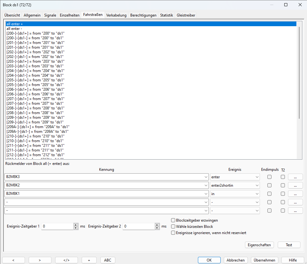

The separate DS1 track
Allgemein
Fahrstrassen (Routes)

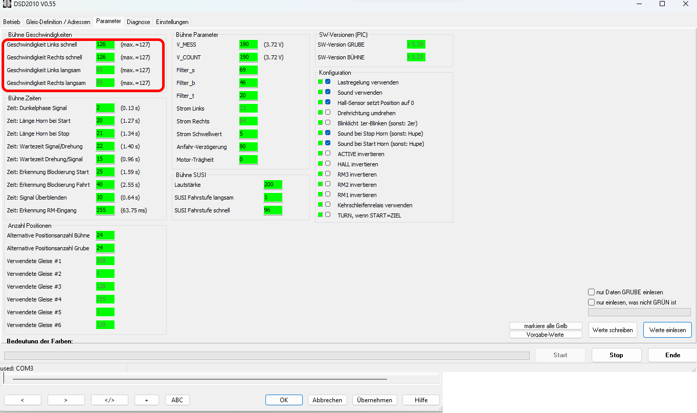

Here is in the DigitalBahn the screen to adjust speeds
Don't forget to write the changes on the TT memory
and the values are changed here (table of all parameters

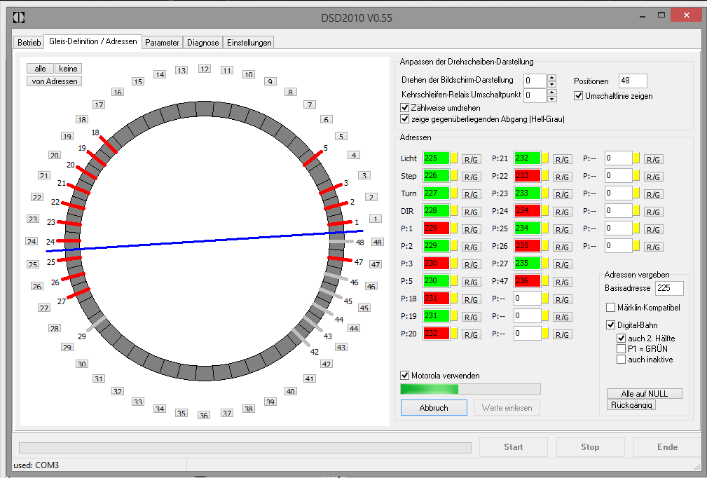

On the 2015 version I have (but cannot transmit through this forum, here is a picture of the 48-position report (later version than mine but probably applicable to yours
If you are interested by the full pdf copy, I think I need your email address by PM .

The DSD2010 offers a convertion table to allow those 24 positions to be converted to the 24 track position really used (one uses rarely al 48 positions
Here is one assignment of really-used tracks into codes
One important thing to remember is a route sends order to switches also here so why not test with a swicht (turnout) programmed at the same address 229 for track 1 and 2, etc)

Hi Jean, thanks again for the quick response on my post. Do you know what is best to use for the dsd2010, Motorola or DCC protocol? Using the adresses 229 and so on, does work, I use it in the outputs (track 1: 229 red, track 2: 229 green etc). The strange thing is that when I right click on the TT symbol and use the command 'goto 2' or an other track, nothing happens.
Cheers Eef
#21 Posted : 16 September 2024 19:58:32(UTC)
Posts: 3,586
Hi Eef
Driving my DSD2010 by MM2 works very fine for me and it is highly probable that using DCC will do EXACTLY the same (in your case working with Routes and not working with the GoTo command.
I think, in your case, because you drive the TT only using turnout commands, the way to fill the TRACK table is different to my case
You should check this
https://wiki.rocrail.net/doku.php?id=turntable-tracks-en
One possibility (I have not verified it)
- as Rocrail indicates the standard mode is 24 track (in absence of the RS232 link)
- in the interface TAB indicate the TT type (DSD2010). The address is implicit.
- in the track table left column you start with Track 0 until you last REAL track (e.g.: 6)
- in the track table Decoder Track column you start with Track 1 until (e.g.: 7)
In this case, you must have configured the DSD2010 (Track Definition tab indicating:
- where is track 1
- what tracks are used
- where is the pole change (used only for 2 rails but you must indicate where is the pole change)
Then I assume that RR will send Turnout commands in accordance with the TT DSD2010 track definition table
Offline Boegies
#22 Posted : 17 September 2024 13:58:57(UTC)
Boegies
Joined: 23/10/2021(UTC)
Posts: 14
Location: Overijssel, Deventer
Hi Jean,
Thanks for your remarkes. I will tryout your options and let you know.
A little question about 'goto', is there a reason why in my case the goto option doesn't work?
greetings
Eef.
#23 Posted : 17 September 2024 16:24:46(UTC)
Posts: 3,586
Hi Eef
Sadly I don't know why the GoTo does not work. I started using the DSD2010 without an adapter (10 years ago) so it MUST work. Just a question of how. Maybe ask the Rocrail forum?
I have a question: since you should (must?) adjust the DSD2010 parameters using the RS232C Link ,(I think there is no other way. Is there?) Why not get yourself an RS232 / USB adaptor similar to this one?
https://www.ebay.de/itm/33431880...D%7Ctkp%3ABlBMUO7H2YXAZA
Using this, you can do all your testing and adjustments andc drive the TT much more precisely (all 48 tracks)
Offline Boegies
#24 Posted : 17 September 2024 19:26:11(UTC)
Boegies
Posts: 14
Hi Jean,
I have a RS323/USB adapter and used it to install the DSD2010. I read that for CS2 and Rocrail you ditnot need to use it, so I configured the DSD210 in CS2 and Rocrail. As I told earlier, everything is working accept the 'goto' command and tat is what you need in automode as far as I know now.
I no decided to try if it is possible in a schedule to use a switch command with a TT adres to make the TT go to the right adress.
I keep on searching and trying.
Greetings
Eef
