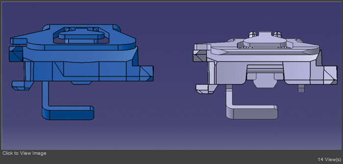

What are the new Märklin close couplers?
#7 Posted : 05 May 2024 23:00:08(UTC)
Posts: 3,739
They are the 72000 (pack of 50) and 72010 (pack of 10) and 72025 (current conducting, pack of 10)
They look similar to the previous ones but are flater (they squeeze into less room which allows the buffers to be in the prototypical position
Here you can see a front view of the previous coupling on the left and the new one on the right
They are compatible with the previous ones (can be mixed w/o problems) AND they are compatible with the current-conducting ones
Apparently Märklin has also increased the vertical tolerence between couplings
thanks 7 users liked this useful post by JohnjeanB
