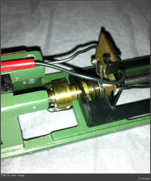

The early TT800 had a schleppkontakt (trailing contact) to switch on either front or rear lights. Later TT800 had no trailing contact. Instead, lights were connected to each of the inductor coils.
I don't have a picture of a TT800 Schleppkontakt but I have one on my DL800 from 1951. Here it is
Principle on a rotating axle, a spring and clutch force a contacting lever to turn in one direction or the other.
This was later replaced by a cheaper system connection the headlights to one of the inductor windings (usually wired at the Perfekt reversing unit).
