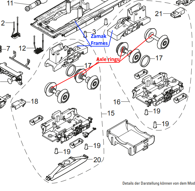

I may be wrong, of course but seems to me Märklin ground return, on most (huge majority of them) is made by wheel axles.
Regarding the 39212, the ground return goes through a number of parts (see the exploded diagram below):
- the wheel pair
- its axle rings
- the bogie Zamak frame
- the loco Zamak chassis
Ground contact must go through all these parts and if any is unclean (old oil) / sludge then there is no contact
39212 bogies.png.
Ideally removing the bogies and cleaning using RS24 (Noch) and then drying / lubricating makes wonders.
Sometimes, only a little "practice" (let the loco run on a loop for a little while) is enough to restore a good contact.

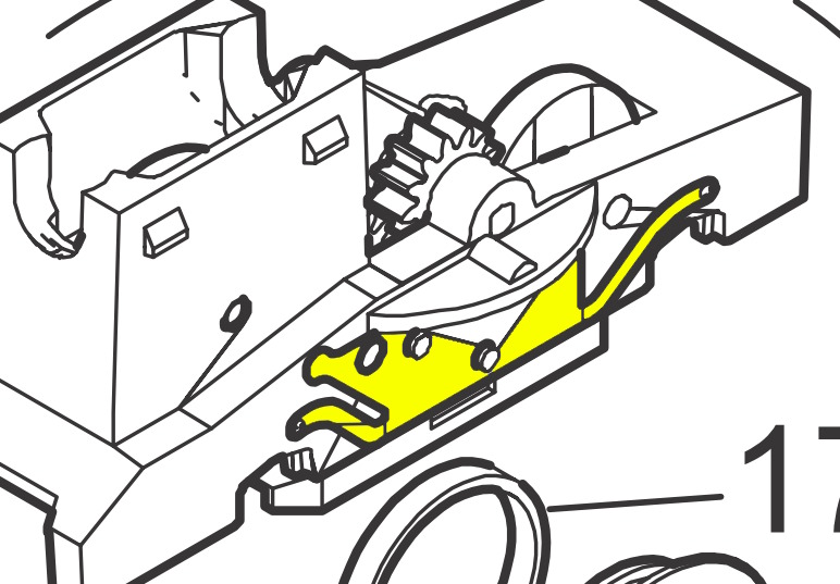

This model (at least the later ones like mine) is a bit different as I believe it's basically a "DC" model. It, therefore, has two "track" pickups on each bogie. And on the AC model the left and right track pickups are just soldered together, making it 4 wires going together as ground. (2 wires from each bogie)
The track pickup is a small copper slide on the inside of each wheel. In the picture below I have coloured it yellow.
so it is these contact areas that need to be cleaned, if they are dirty.
and of course, the cause of the problem might also be something else....

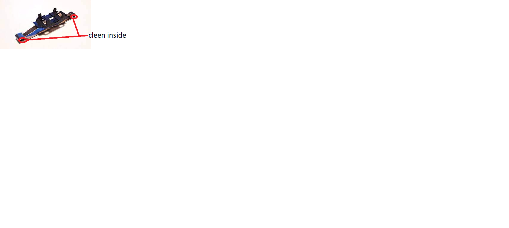

I had this problem my track 3rd rail was low so pulled up with pliers and i was not cleaning inside slider
hess
hess
Yes this is one of the problem that is often miss.
